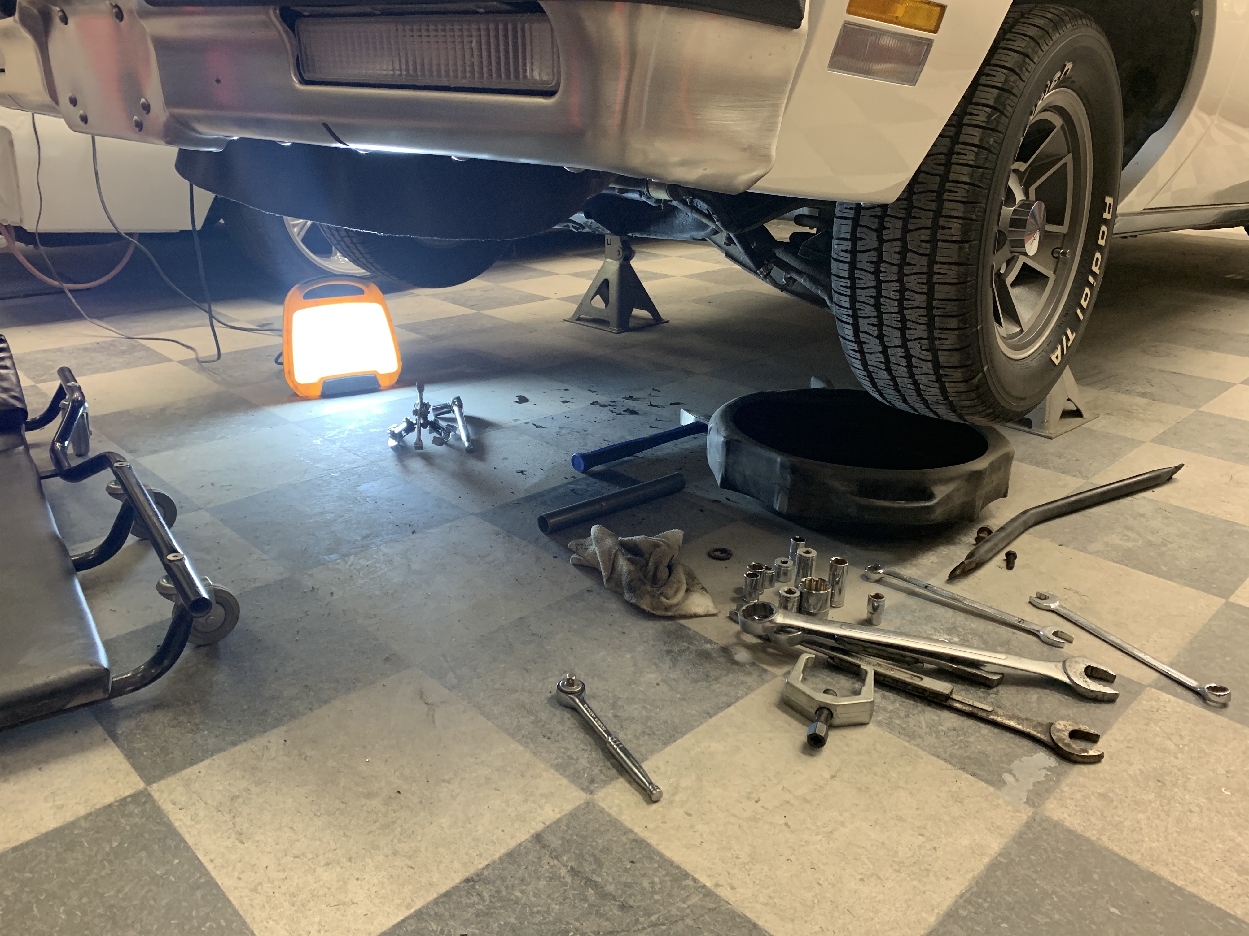

I spent the last couple nights doing the steering box swap with the good condition original one out of The Juggernaut. I got sidelined early Monday night due to the fact that I had forgotten that I’d modified my Pitman arm puller, and it no longer worked for actually pulling Pitman arms.
:blam:
Got all of it completed last night after borrowing a friend’s puller, but was unfortunately denied the sense of completion and subsequent road test due to running out of power steering fluid.
Picked up a quart of Lucas power steering fluid today, and after bleeding the system and topping it up a couple of times, I was finally rewarded with the end result:

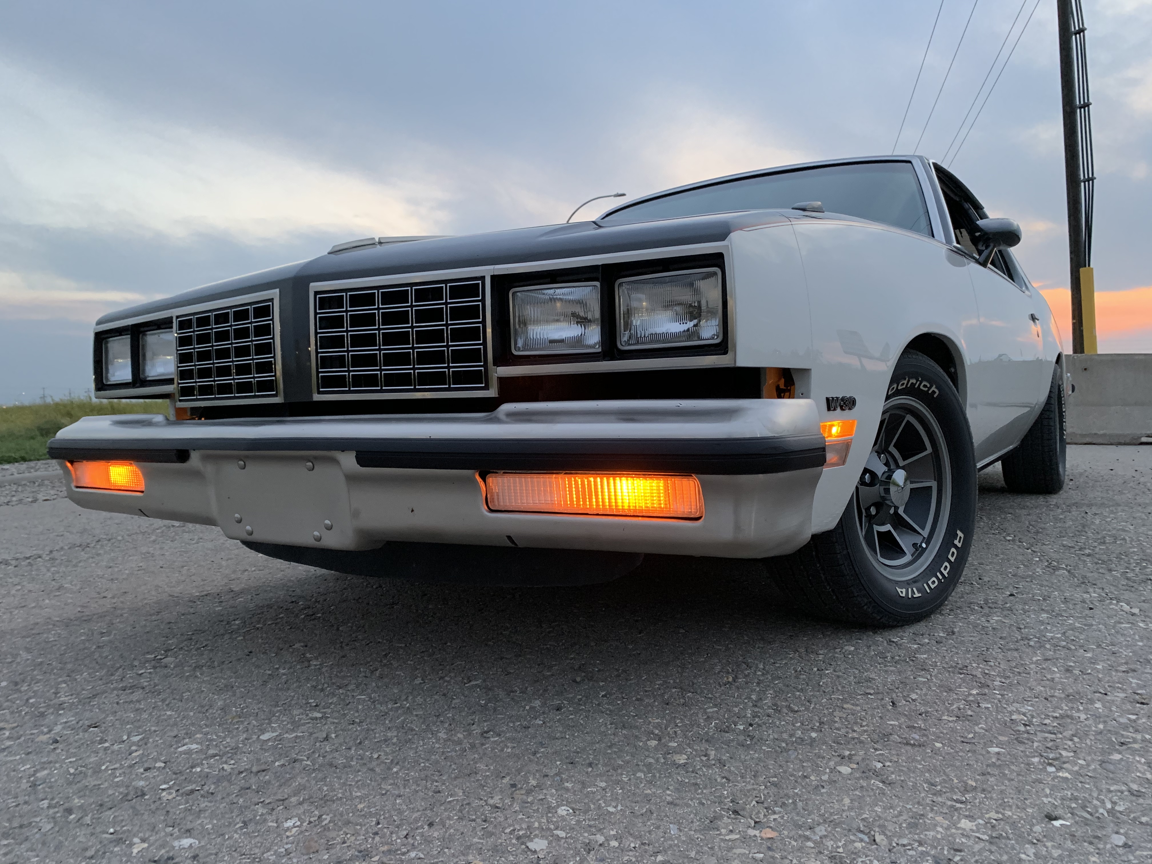

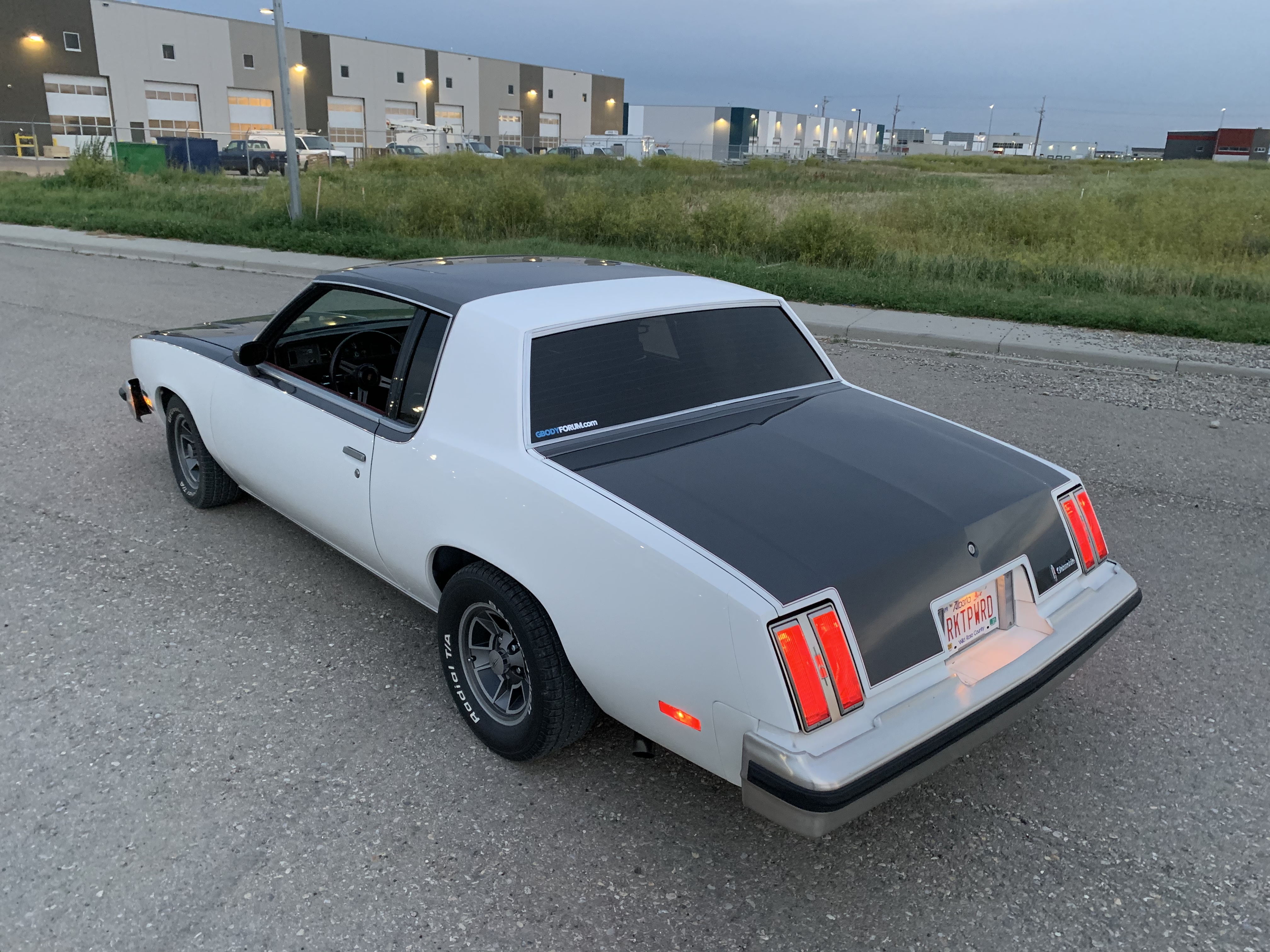

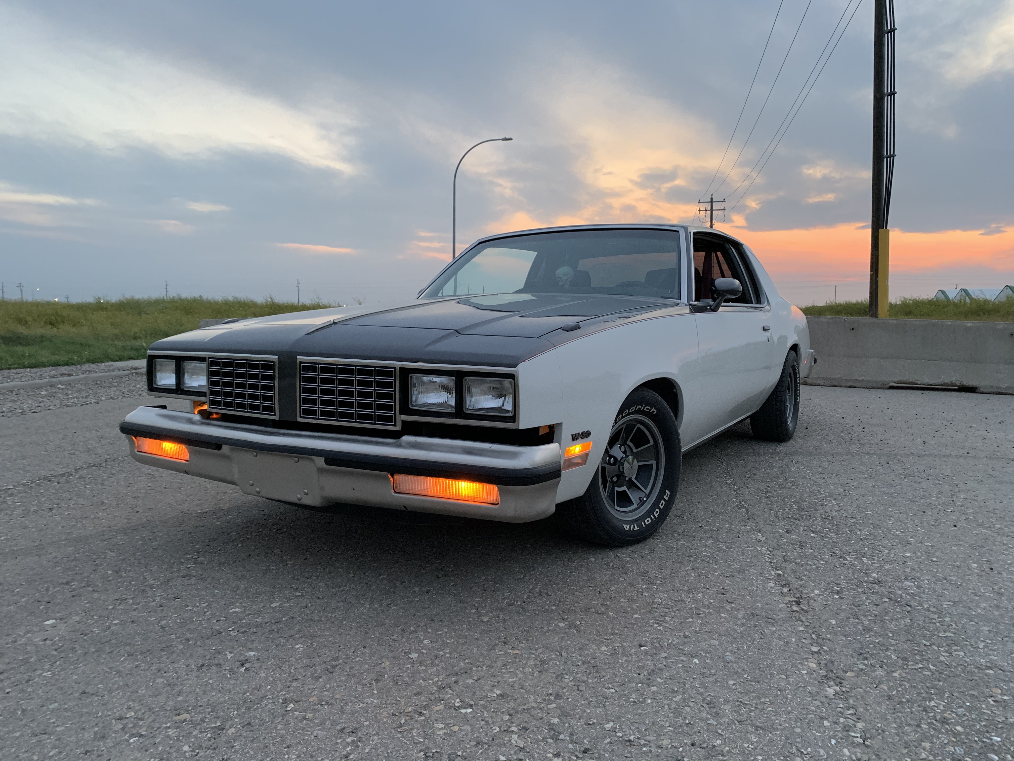

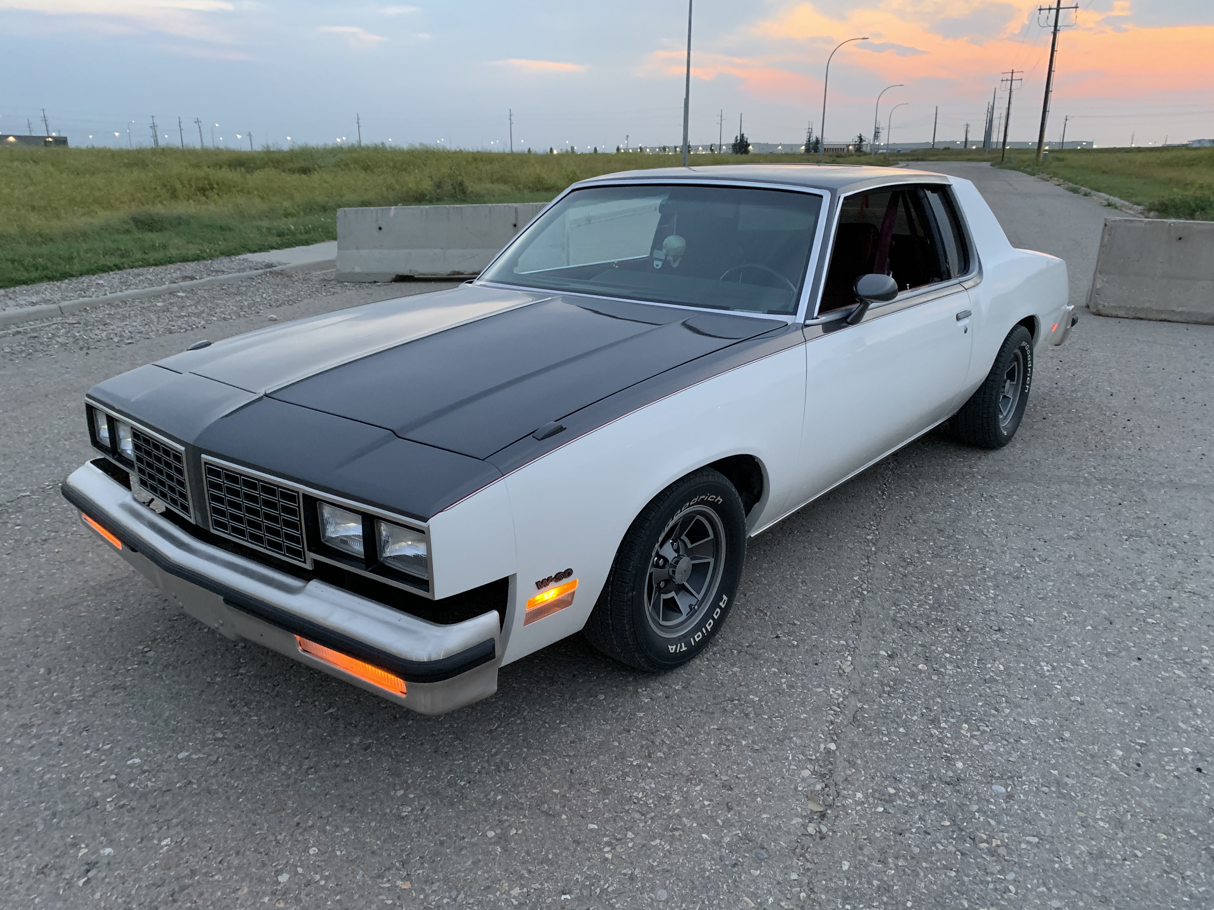

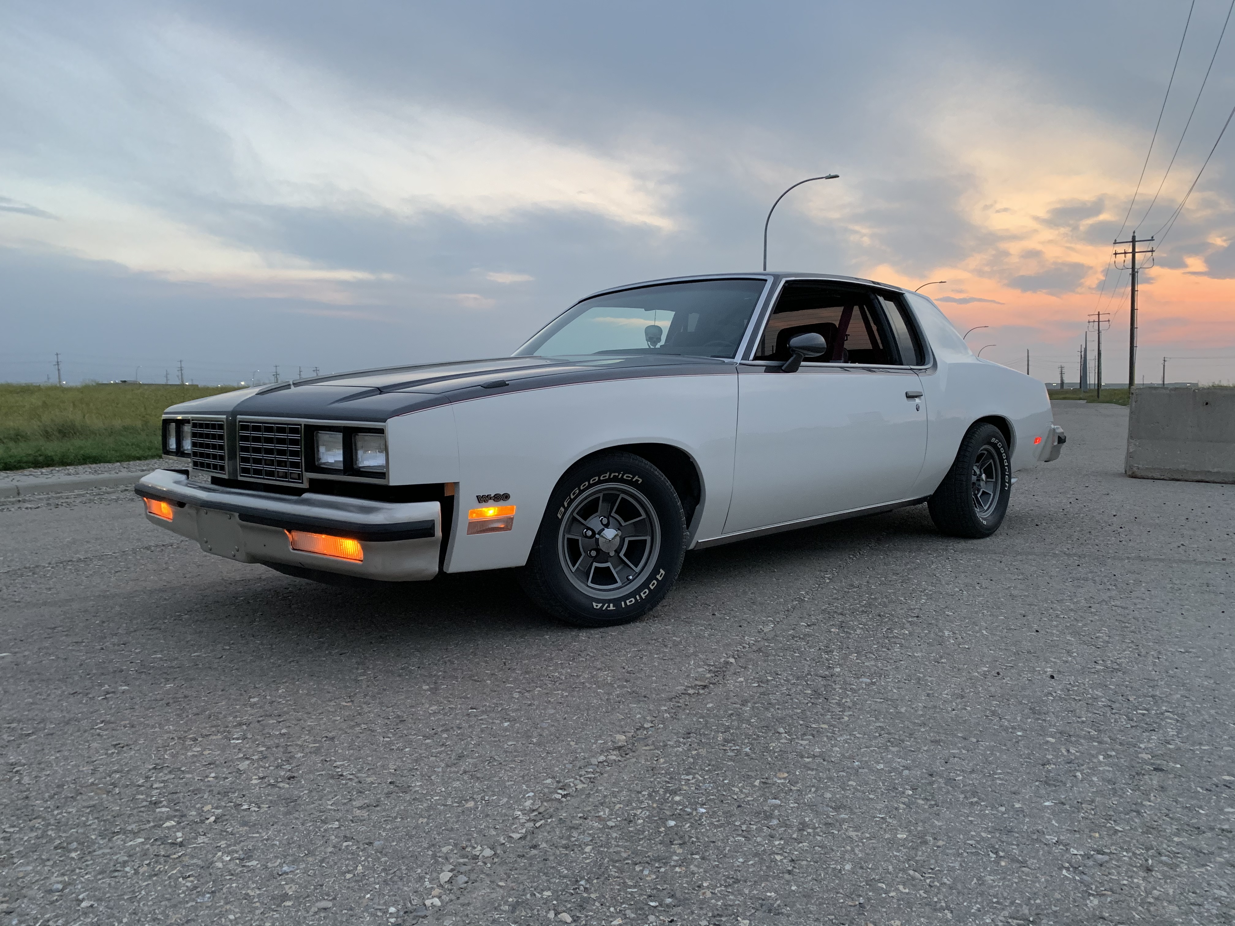

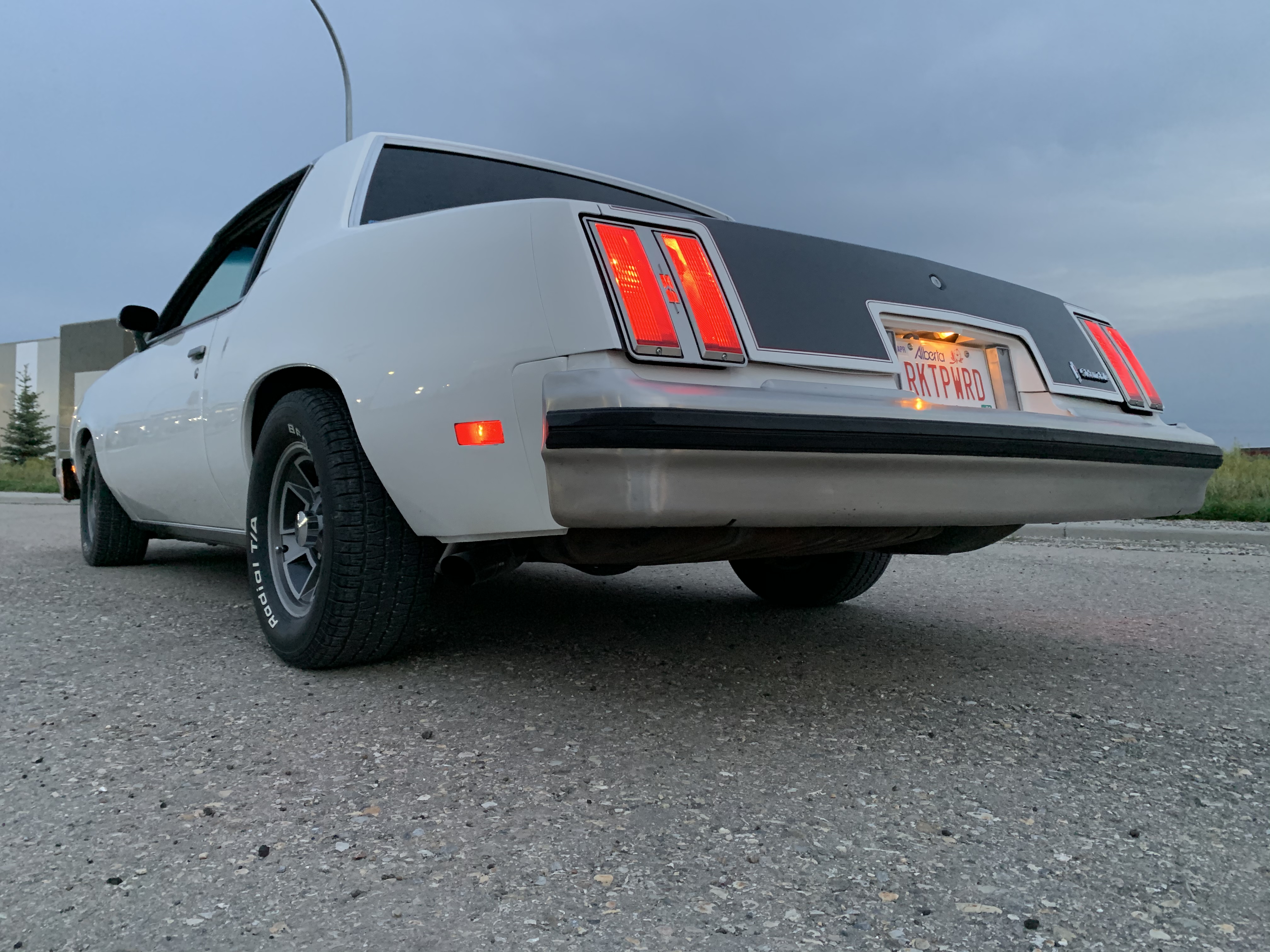

At the end of the road test, I found myself at pretty much the right place and the right time for a nice photo op against the backdrop of the setting sun. Here’s some shameless glamour shots for your enjoyment.

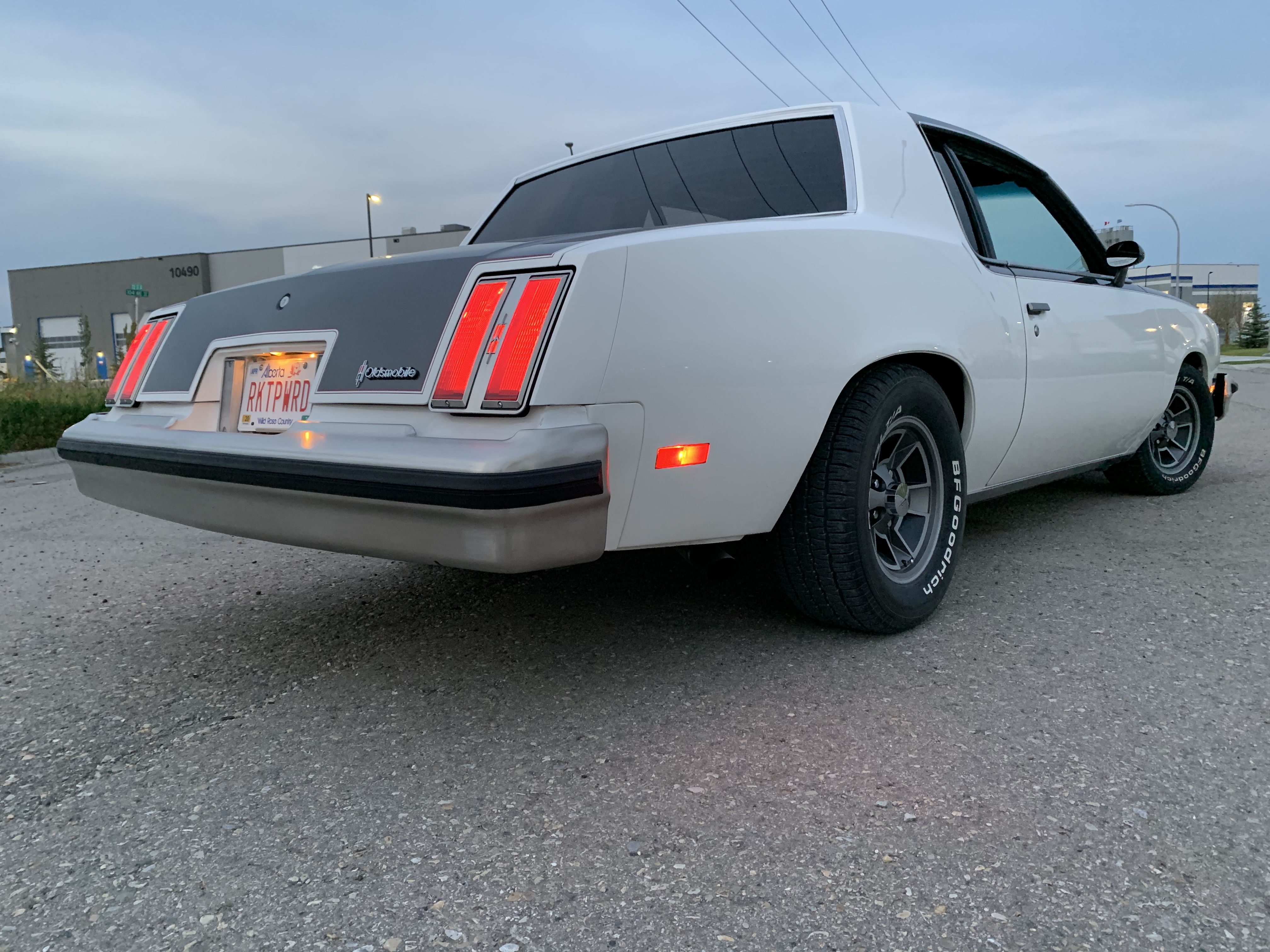

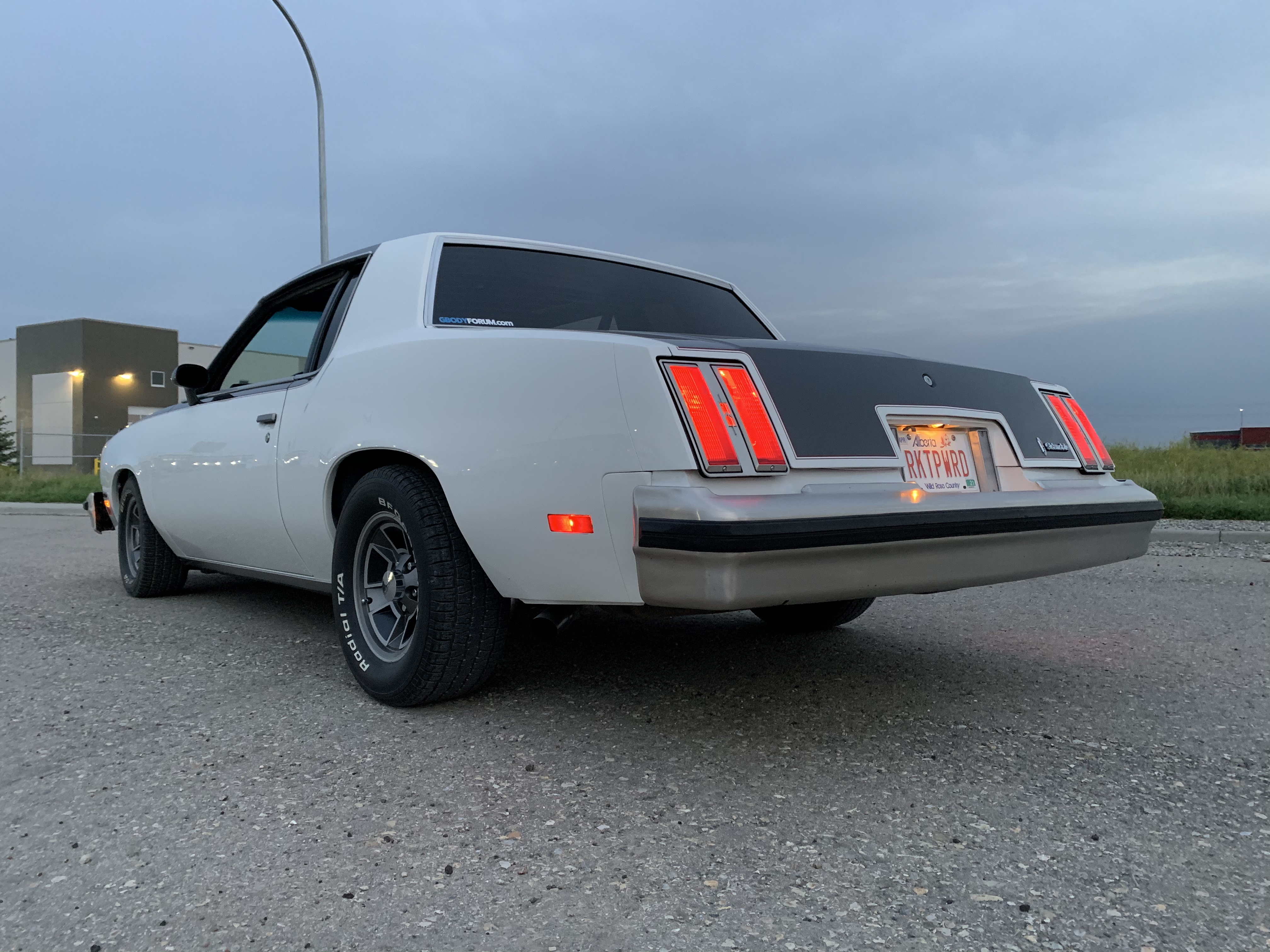

After all of the work I’ve put into it up to this point and of all the zillions of pictures I’ve taken, I still didn’t really have any decent pictures of the car that weren’t in the garage, up too close, etc etc.
I just happened to find myself at the right place and the right time for what I thought might make for some nice overall shots and from different angles.

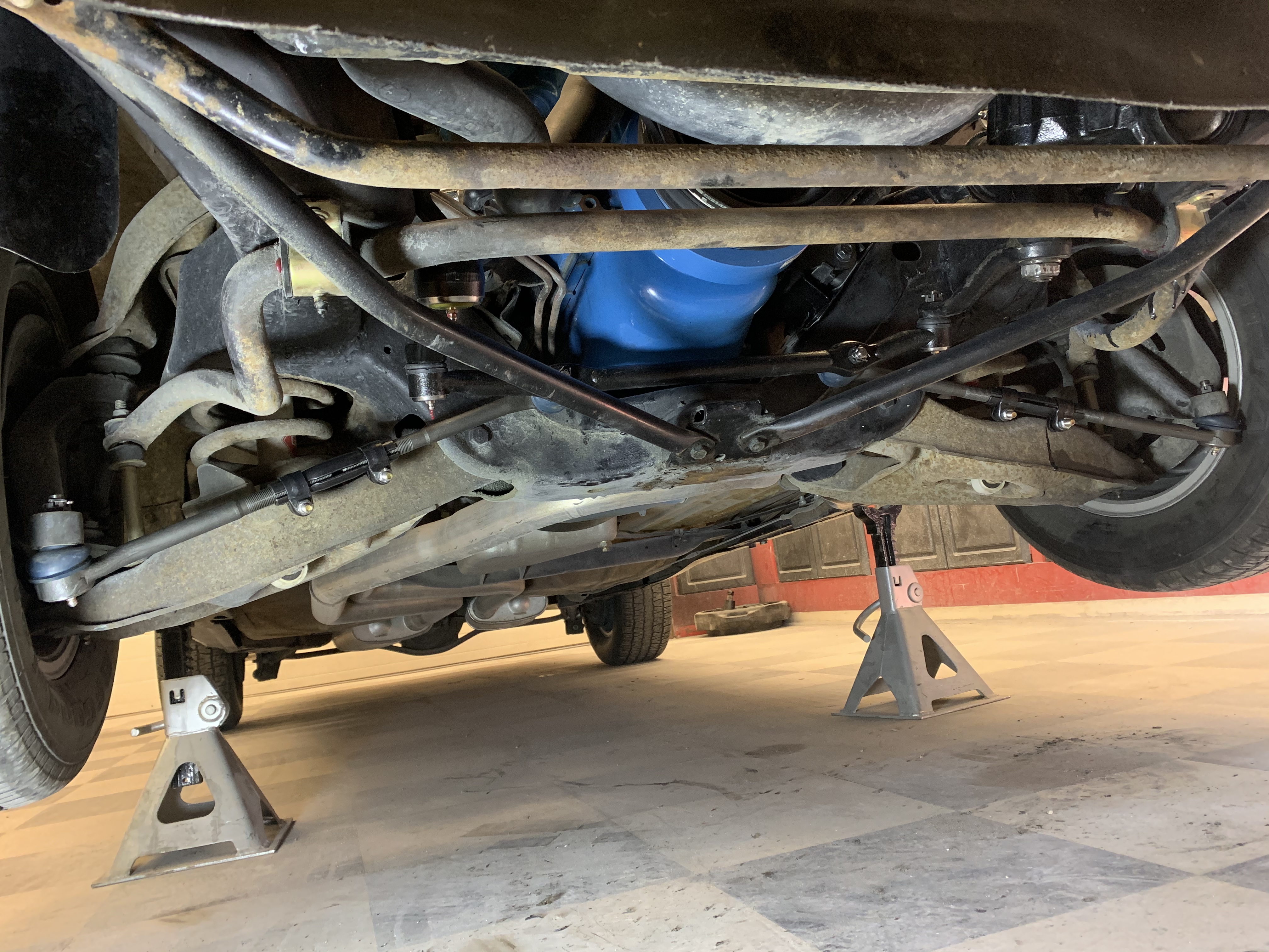

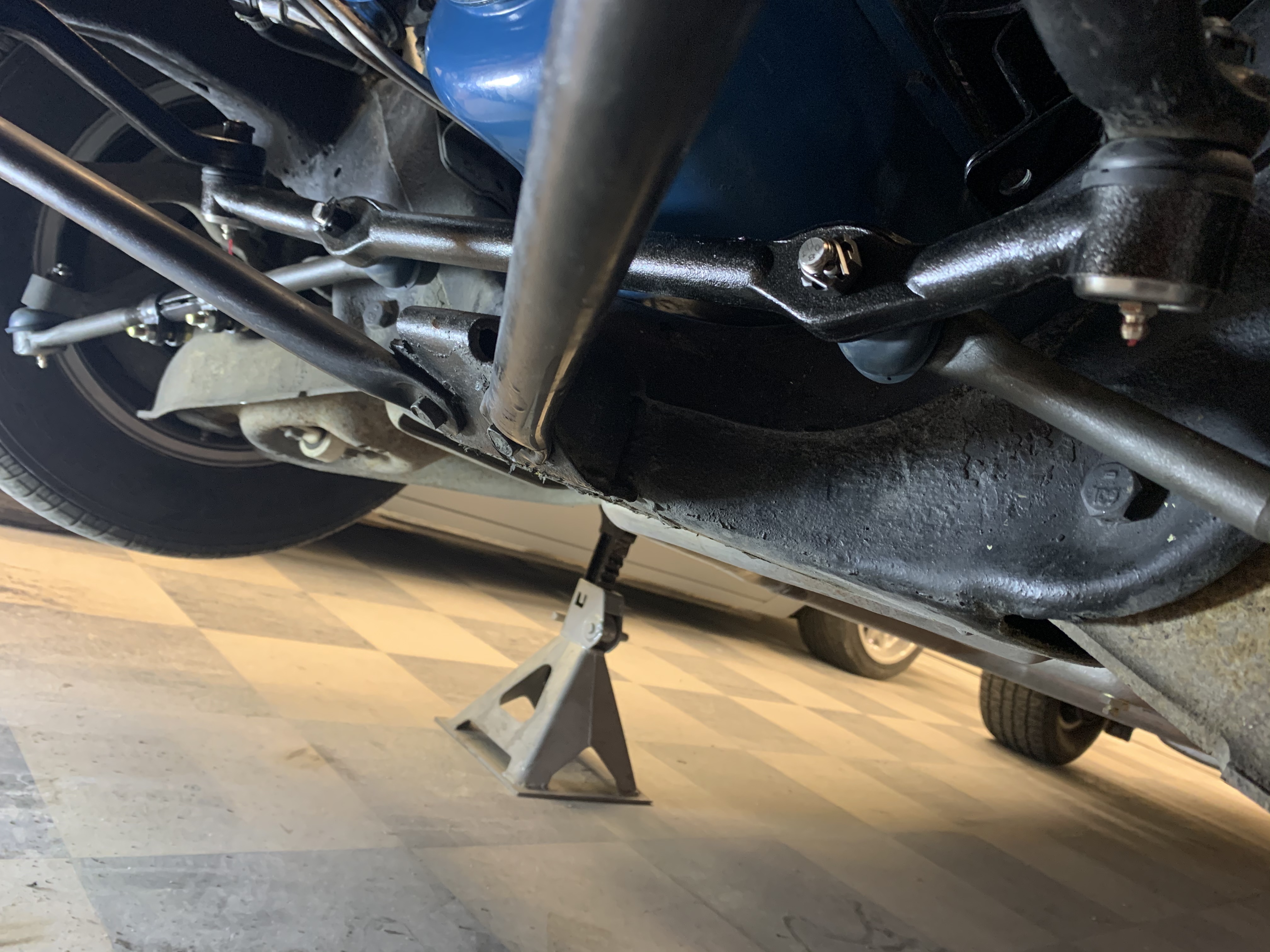

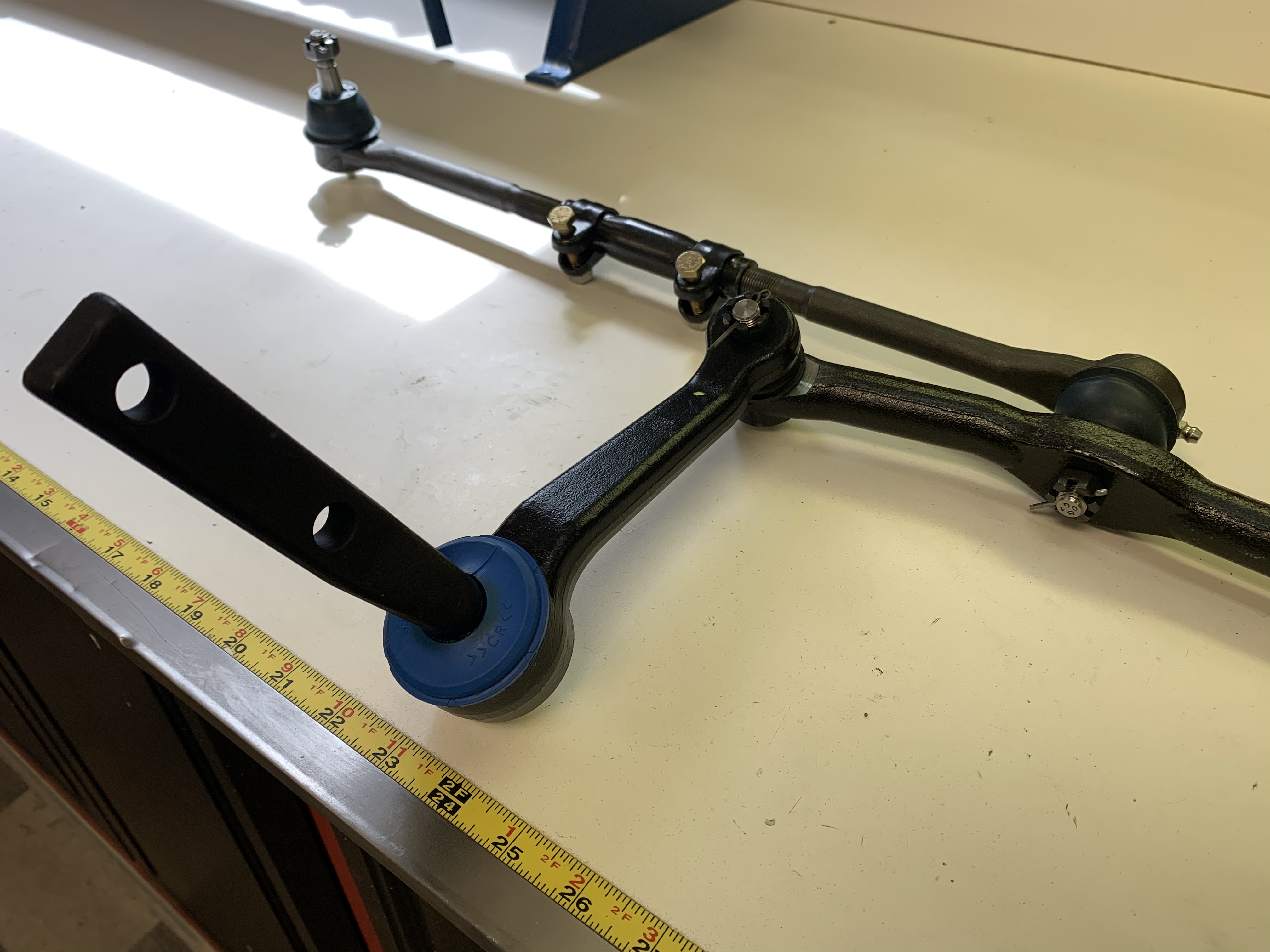

Well, I got my delivery of steering parts a couple days early from Rock Auto. Friday after work they were sitting on the porch instead of Tuesday as originally promised. WTF, that never happens!

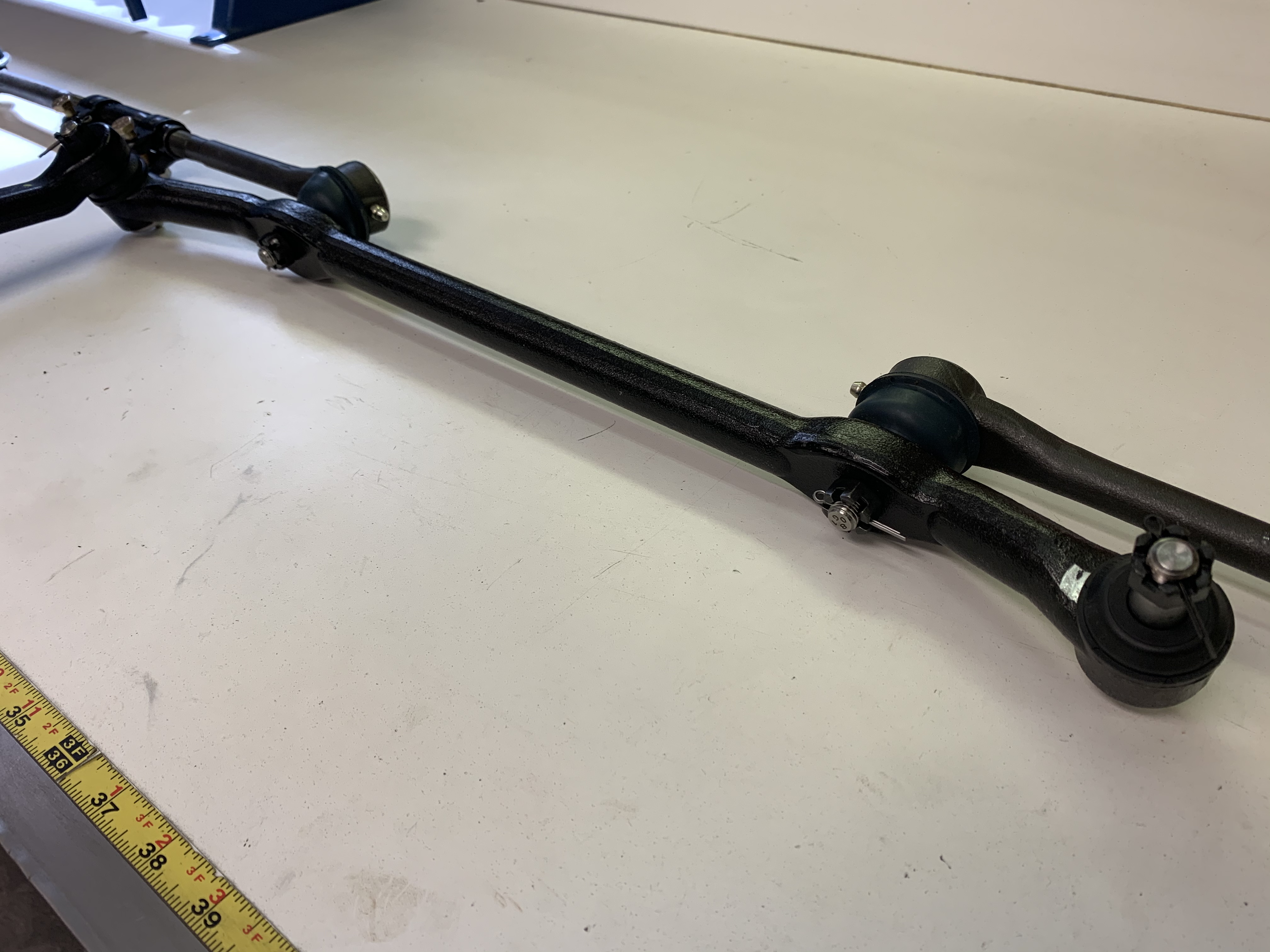

All new AC Delco replacement steering parts, center link, idler arm, inner and outer tie rod ends, adjusting sleeves, plus a new speedometer cable.

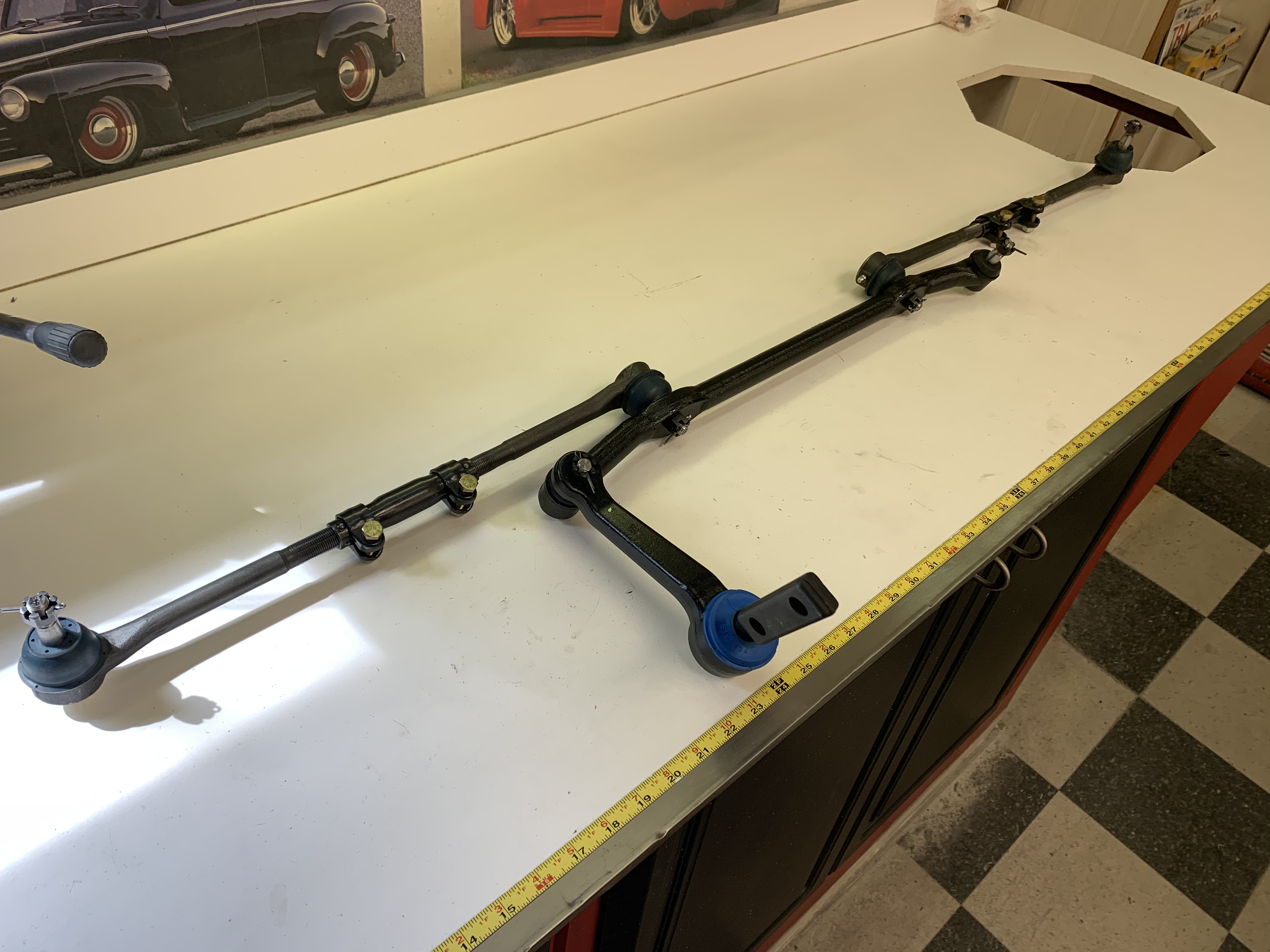

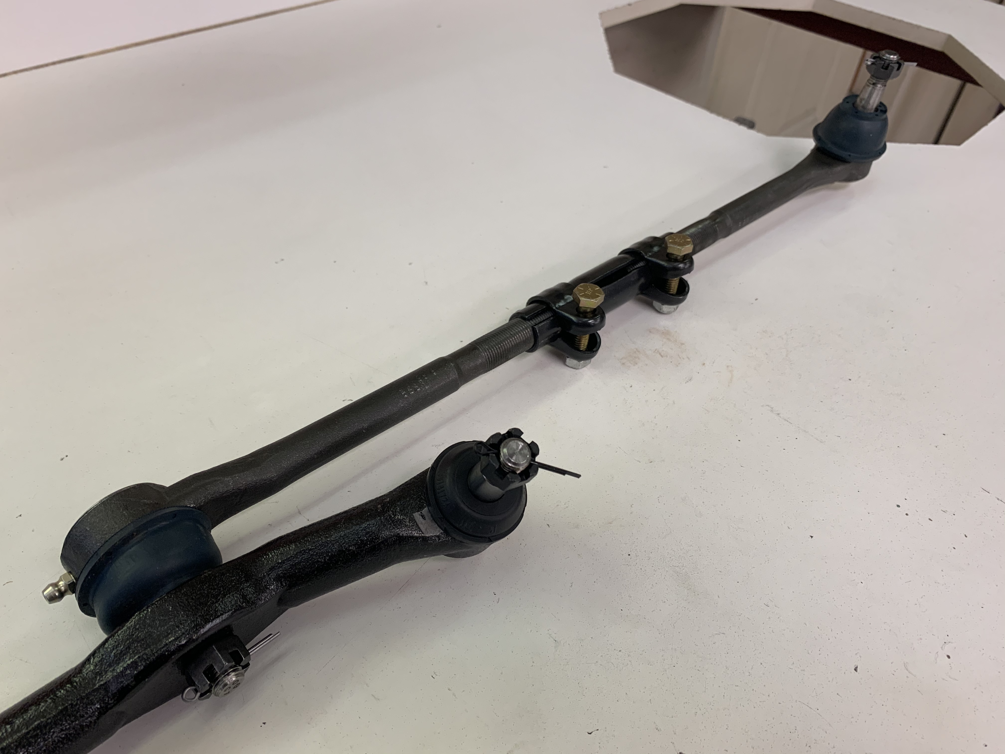

So early this afternoon I decided to start pre-assembling everything on the bench in preparation for it all to go in:

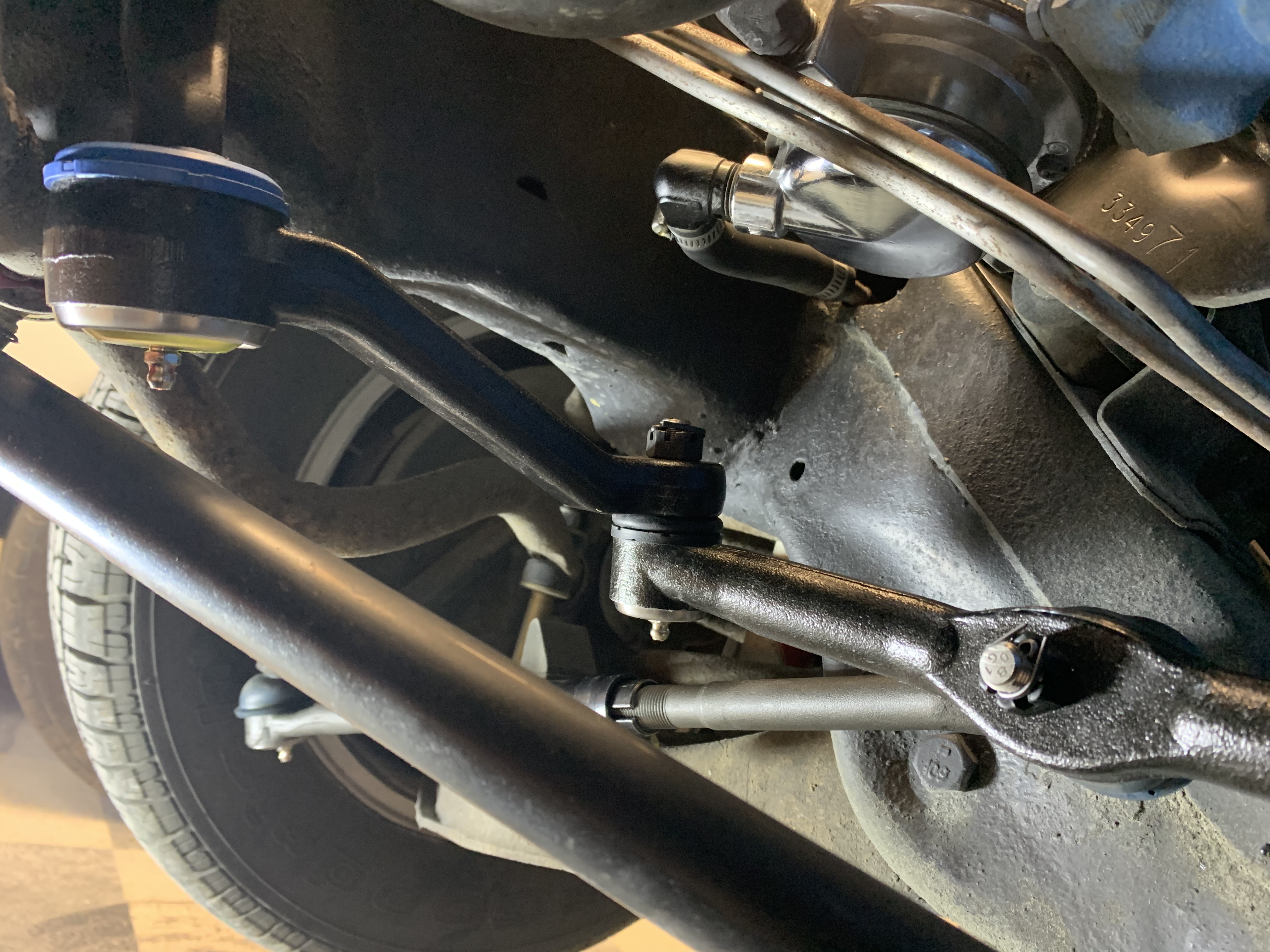

Disconnected the idler arm from the frame and the pitman arm from the center link, then popped the outer tie rod ends from the spindles and dropped the whole old assembly out:
I measured up the old tie rod assemblies and set the new ones to the same length, then installed and torqued everything but the adjusting sleeves. These I just snugged up temporarily. The steering wheel in the car had previously been cocked slightly to the right when travelling straight, so I lengthened the right hand side by two turns and shortened the left hand side by the same amount. Then took it for a short road test to see what further adjustments it might need.
The wheel was definitely more centered but still needed a little more bias to the left, so I quickly raised the front end, made one more full turn on each and road tested it again. Almost perfect now. I readjusted them one last time, only a quarter turn each (this time to the right) then set up some straight edges on the wheels and set the toe-in. Once I had my 1/16” (give or take) toe-in, I locked down the adjusting sleeves permanently.
The car steers and tracks quite nicely now, and is definitely tighter and more responsive than before I swapped out the box. I might make a slight adjustment to the sector shaft in the steering box, it seems just a hair too tight to move off center, but that’s a super easy adjustment.
Speedometer cable is next, quite possibly tomorrow night. Other than a lil bit of futzing around with the routing, that should be pretty straightforward.
