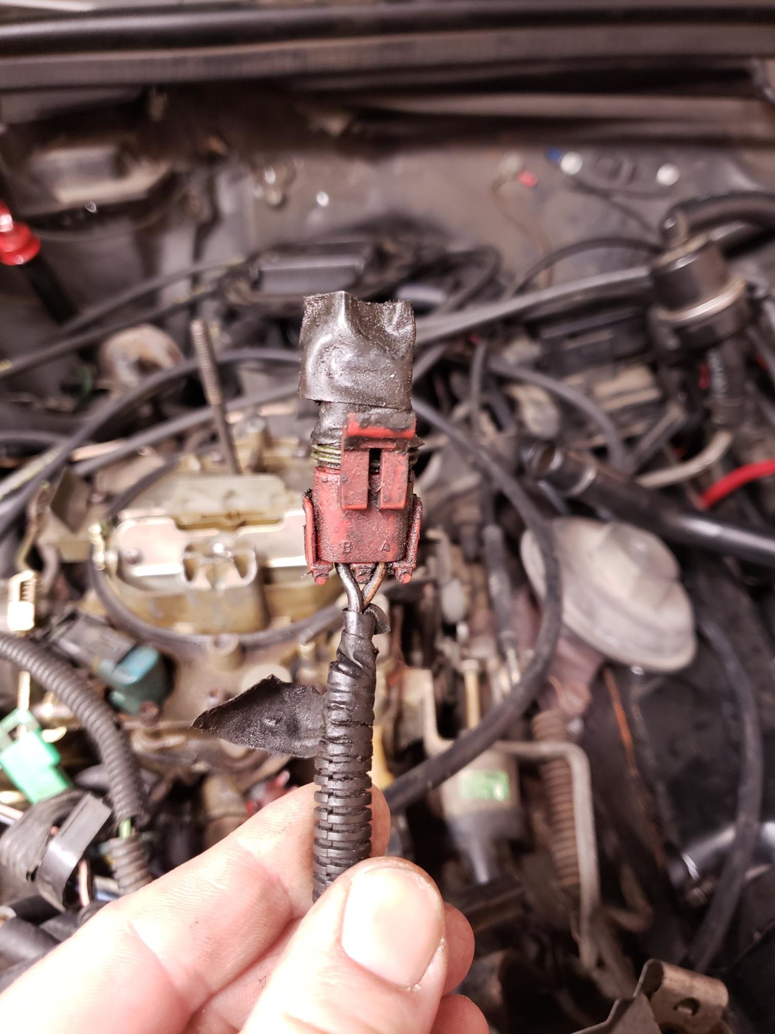

Anti Dieseling plug , is it green?
-This is the plug in question. Pink/Black wires. It is not the dwell meter connection.
My 87 has this same plug and I have yet to figure out what it's for. And mine is definitely a real original 442.
If I get time tomorrow I'll look under the hood of my 87. See about that red connector thingie.
According to the manual, Vin Y cars had the solenoid, Vin 9 cars didn't. Would they have used 1 wire harness for all the cars on the production line?
My 2 cents ,I would expect GM to use as few different part numbers as possible on the line ....less to inventory ,less space used on the shop floor.
So to answer your question ....yes .but I could be wrong.
That's true in some regards. Like on some years you will find the plug for the underhood lamp already there, even if the car didn't come with the lighting package option. I can't speak for all years but '87 I think is one of them.
