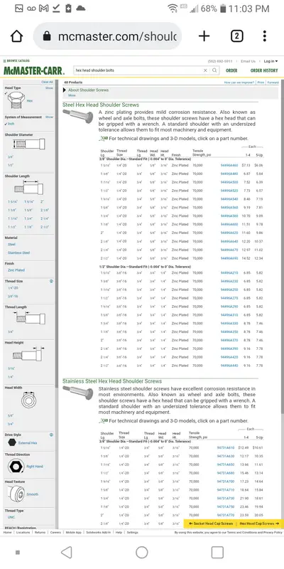

ACE Hardware has the Allen head ones, might have the hex head.
McMaster Carr has all of them, Grainger too.
