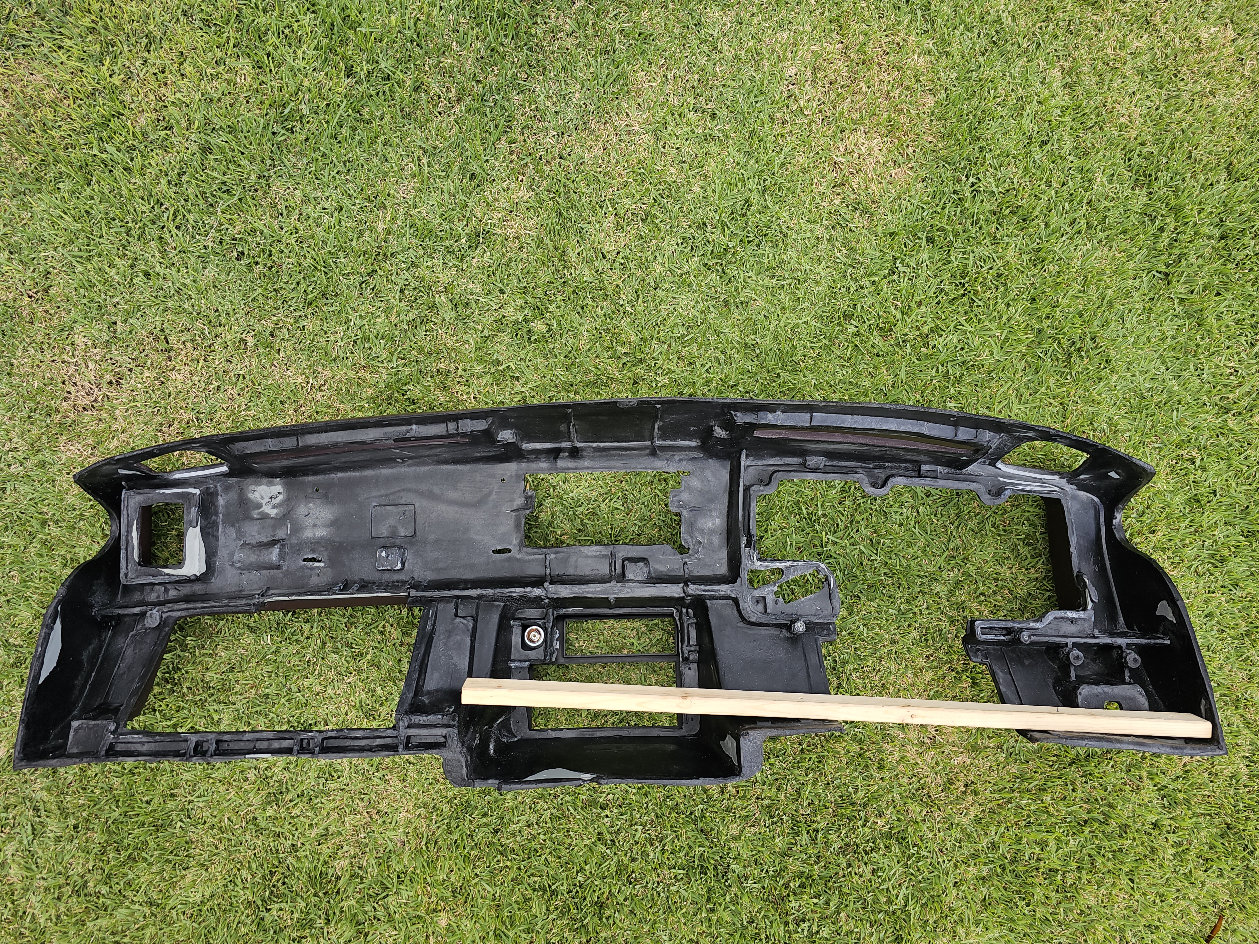

ck80, I've been trying to locate this thread in order to respond to your questions about the inner structure. Honestly, I don't know what is inside so will let you decide by posting a few pictures. The first one was a test fit and has a few of the stock pieces installed--gauge pod, radio/AC bezel, and glove box. As you can see, the color matches very closely between the dash replacement and stock pieces. The second picture shows the back side--the stick was part of OPGI's shipping setup.
I haven't decided when I'll start the installation as I will need some assistance to pull the old dash out, remove the harness, and re-install the dash.
View attachment 229938View attachment 229939
So this is what I'll be getting when ever they get mine in to ship my way (was originally to be here next week, the middle December, currently middle April, next ???).
Ordered in black cause they don't do dark maple.
