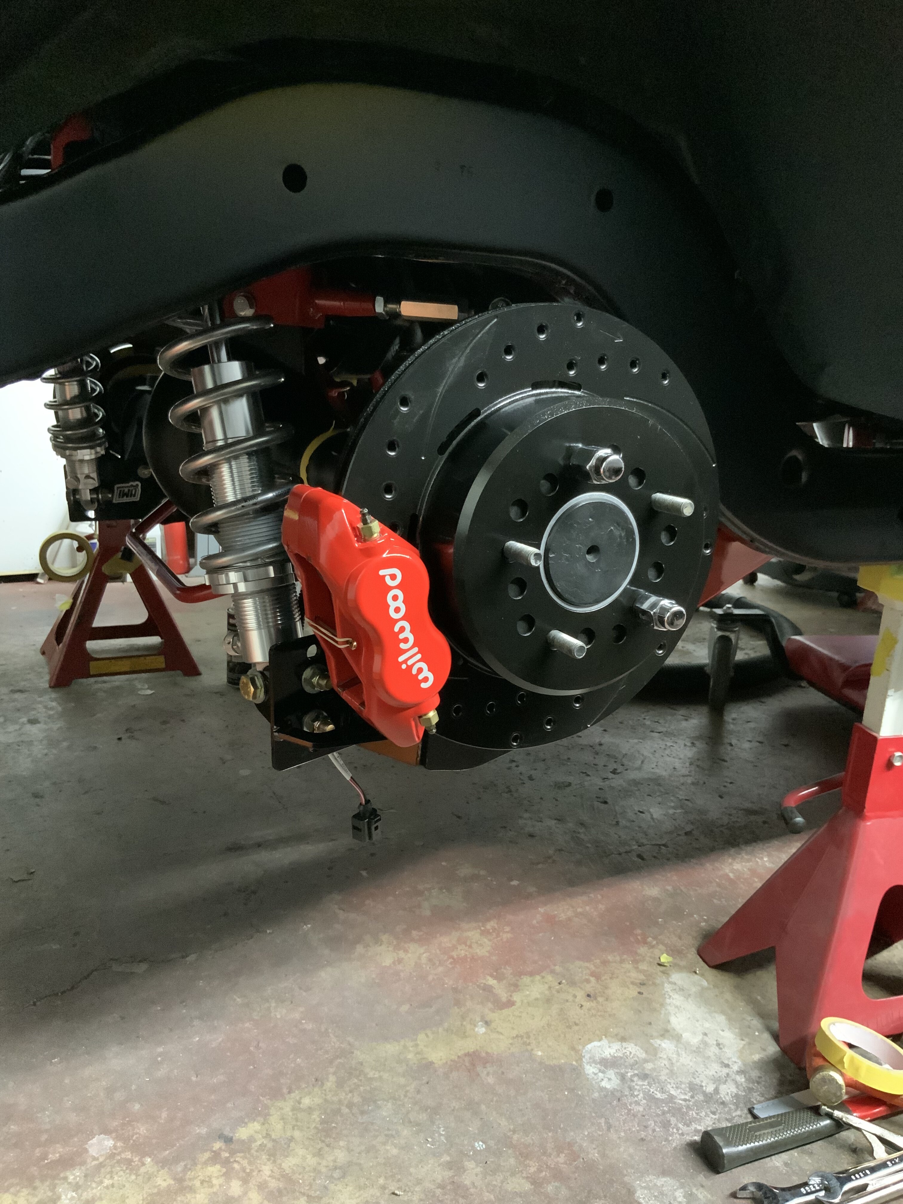

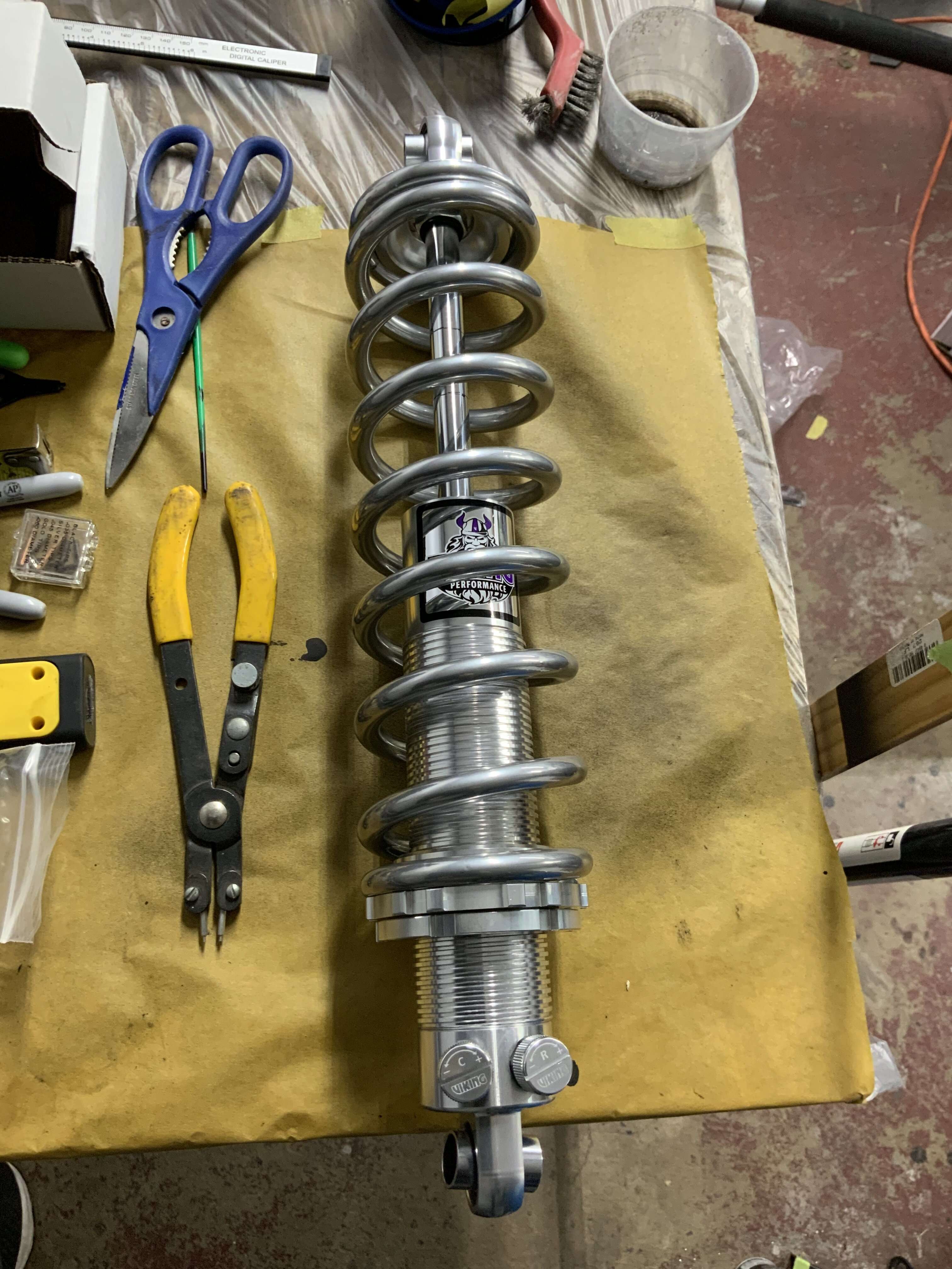

I put the rear brakes together. I had a long ,kind of frustrating week trying to get the electronic parking brake to fit. In conclusion they will not fit . They extend further inward and hit the frame ( in the front) and hit the shock in the back. I thought It might have been a mistake installing the coil-over shock setup that it was the issue but realized this setup will not work on gbody’s with factory shock and spring setups. So a fair warning for anyone thinking on buying willwoods EPB system it won’t fit on gbody. I’m going to post a question what have other people been doing for parking brake on manual transmission cars with rear disc brakes?
Or do I not worry about putting any parking brakes on the car, keep it in gear and maybe carry a set of wheel chocks
