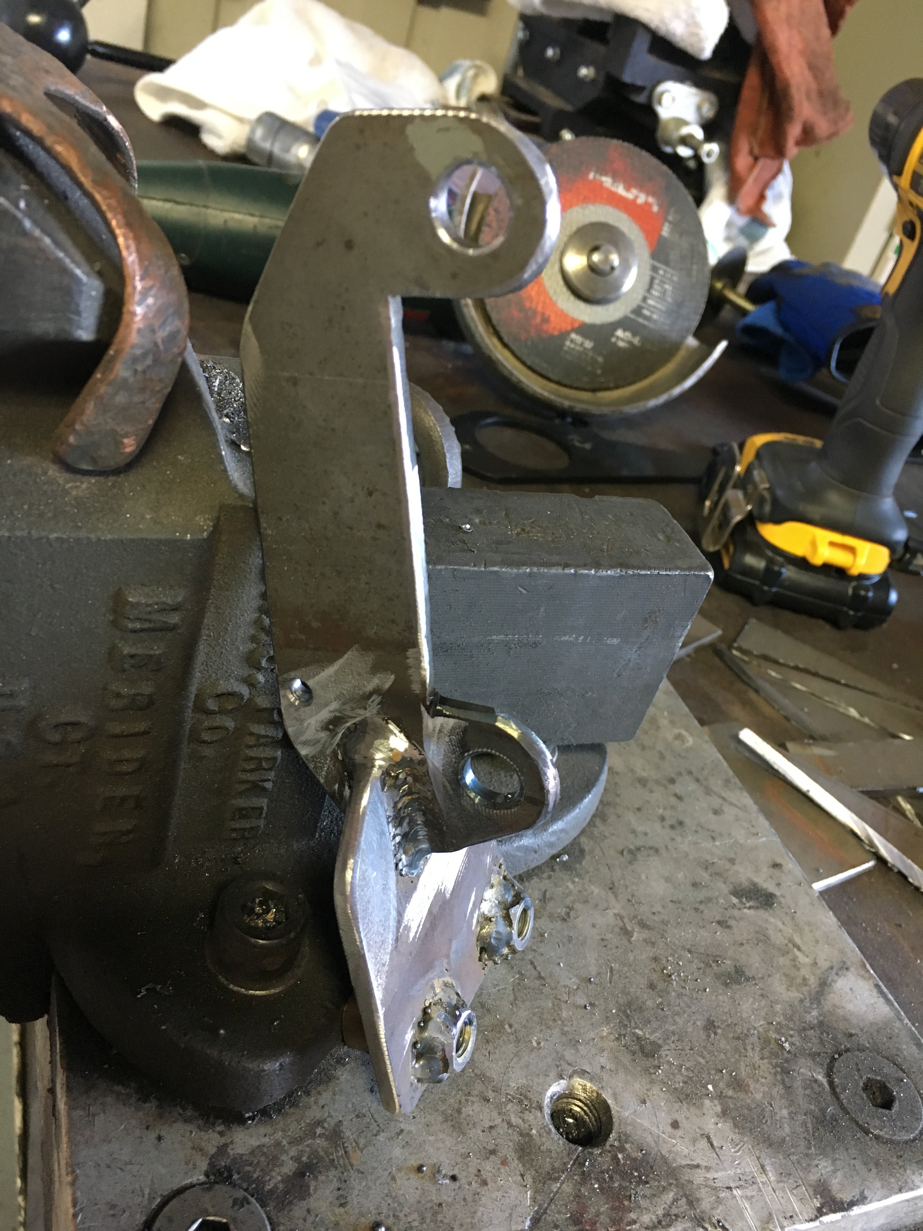

This on a T56 with a mechanical bellhousing for a SBC. It’s a Toyota truck slave cylinder. I just picked up a brand new one and they are less than $20. A little fab work and feels great. It does put the bleader pointing at the oil filter

This on a T56 with a mechanical bellhousing for a SBC. It’s a Toyota truck slave cylinder. I just picked up a brand new one and they are less than $20. A little fab work and feels great. It does put the bleader pointing at the oil filter View attachment 97628 View attachment 97629
I use the F body reservoir and it is mounted up near th mater brake so it sits so much higher than the slave it bleeds itself, the air makes it way up to the reservoir.
