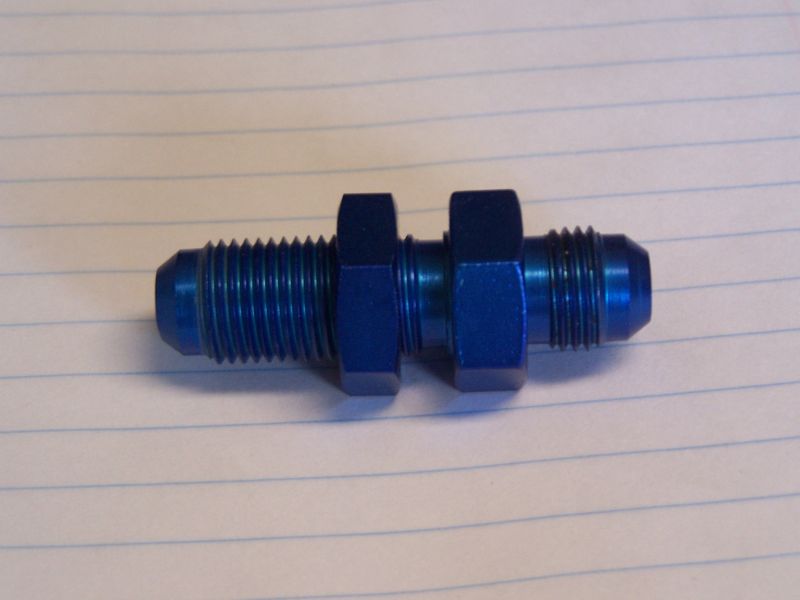

I really would like to put a solid an fitting into the engine area. Any ideas on how to put one in this spot with out just a grommet..i want a solid connection. Make sense?

For fuel line? For “AN” style fittings?
How about a bulkhead connector?
That’s what I did on The Juggernaut.
Pass the main part of it through the front and thread the jam nut on the inside. That’ll provide a fixed connection point. It might be a bit of a pain attaching the line to the inside, so the other way you could do it is to pre-attach the inside line to the short side of the connector, then pass it through the opening. It just means you’ll have the longer portion of the connector and the jam nut visible from the outside. That may not be a big deal, but if you’re as anal retentive as I am, you’ll want it the other way.
You’ll have a second and separate line from there to your fuel pump or carb (or throttle body), but that’s not necessarily a bad thing. Gives you a place to conveniently drain the line if need be.
Just a suggestion.

Thanks! That's exactly what i needed. And yes I'm going to be anal lol..i want it as clean as possible.
