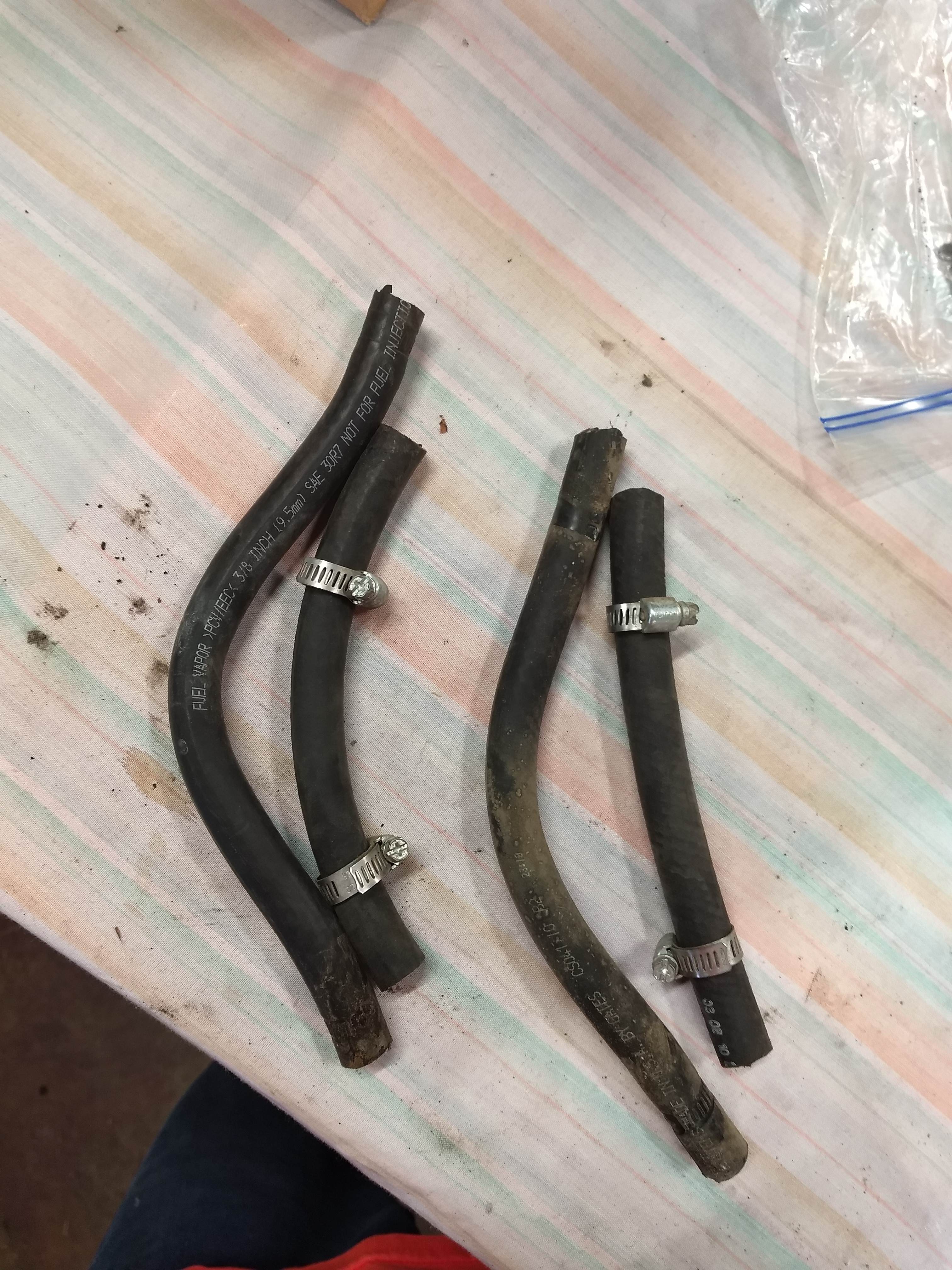

I owe you an apology SoFloG, because I kind of lied to ya. I did inspect the rubber hoses I saw but they were only 50% of the ones up there- I guess I forgot about the others even existing. The easily visible hoses looked to be good in condition but were a little too long, and the feed line sure seemed like it wanted to collapse at a moment's notice. Here's a pic of those old lines vs. the new shorter ones I replaced them with. The feed line is on the left.
Following that I proceeded to drop the tank using a scissor lift style transmission jack from Harbor Freight because it offers a much larger platform/pad to lift and lower with. It also goes straight up and down instead of following an arc like a traditional floor jack, and that's exactly what you want in this scenario. I remembered the sending unit wire but forgot about the ground wire until the tank was halfway out and that made the strap into a slight obstacle to removing the small screw holding the wire on. I should've taken that off sooner but it was no big deal to do it now.
Once I slid the tank out from under the car I saw something that made me proclaim "Well there's your problem!" to absolutely nobody at all because I was alone, and then laugh maniacally. Check out the following pictures and I think you'll immediately see what's been causing me so much grief.
These just may be the original hoses from 1978, and they sure look like it. They're so incredibly deteriorated that I'm surprised the pump ever got gas up to the engine bay, and I think I'm lucky that there wasn't a constant puddle of it under the rear of my car. I used brake cleaner and Grime Away wipes to clean the top of the tank and all the hard lines but forgot to snap a photo.
I replaced those hoses and used other longer ones in front of the tank to temporarily hook it back up to run the engine and see if it would die. Part of me wanted to open the tank and have a look, but another part of me wanted to avoid doing that unnecessarily and tearing a rubber O-ring that I had no replacement for. I've pulled the fuel filter 4 times to check it in the last 2 days and it comes out squeaky clean every time so I'm inclined to believe that fine sediment was not part of the issue. Maybe there were flakes of rust but with so little gas in the tank they'd make their presence known quickly. Gina stayed alive like the Bee Gees, the filter remained clean, and I detected flow when I squeezed the rubber line feeding the new Carter pump so I felt confident tucking the gas tank back into bed.
The tank went back in smooth as silk and I didn't even get sand in my eyes which is a miracle considering the conditions here. Things were going very, very well. I once again let the engine idle, both in Park and in gear, and everything was copacetic. I then took Gina for a drive on pavement where I could "put it to the wood" and that went well too! She didn't peel out but she didn't try to buck me off either. I was able to actually floor it from a standstill and hold it there through all the gears without a single cough, sputter, or issue at all. I then let out a Phil Swift style "WAHOOO!!" and returned home to clean up.
View attachment 231677View attachment 231679View attachment 231678
I replaced those hoses and used other longer ones in front of the tank to temporarily hook it back up to run the engine and see if it would die. Part of me wanted to open the tank and have a look, but another part of me wanted to avoid doing that unnecessarily and tearing a rubber O-ring that I had no replacement for. I've pulled the fuel filter 4 times to check it in the last 2 days and it comes out squeaky clean every time so I'm inclined to believe that fine sediment was not part of the issue. Maybe there were flakes of rust but with so little gas in the tank they'd make their presence known quickly. Gina stayed alive like the Bee Gees, the filter remained clean, and I detected pressure when I squeezed the rubber line feeding the new Carter pump so I felt confident tucking the gas tank back into bed.

They look from 1878. Good stuff!

Yeah, that sounds about right. I'd say you're a step ahead in the sense that you already know that you've got to drop the tank. Since I'd been driving the car for weeks I just took it for granted that I had no issues back there. Ya know, like a dumb dumb.

I originally thought that the 3/8" feed had a braided covering on it until I went in for a closer look. I've seen some bad rubbers before but that's impressive.
