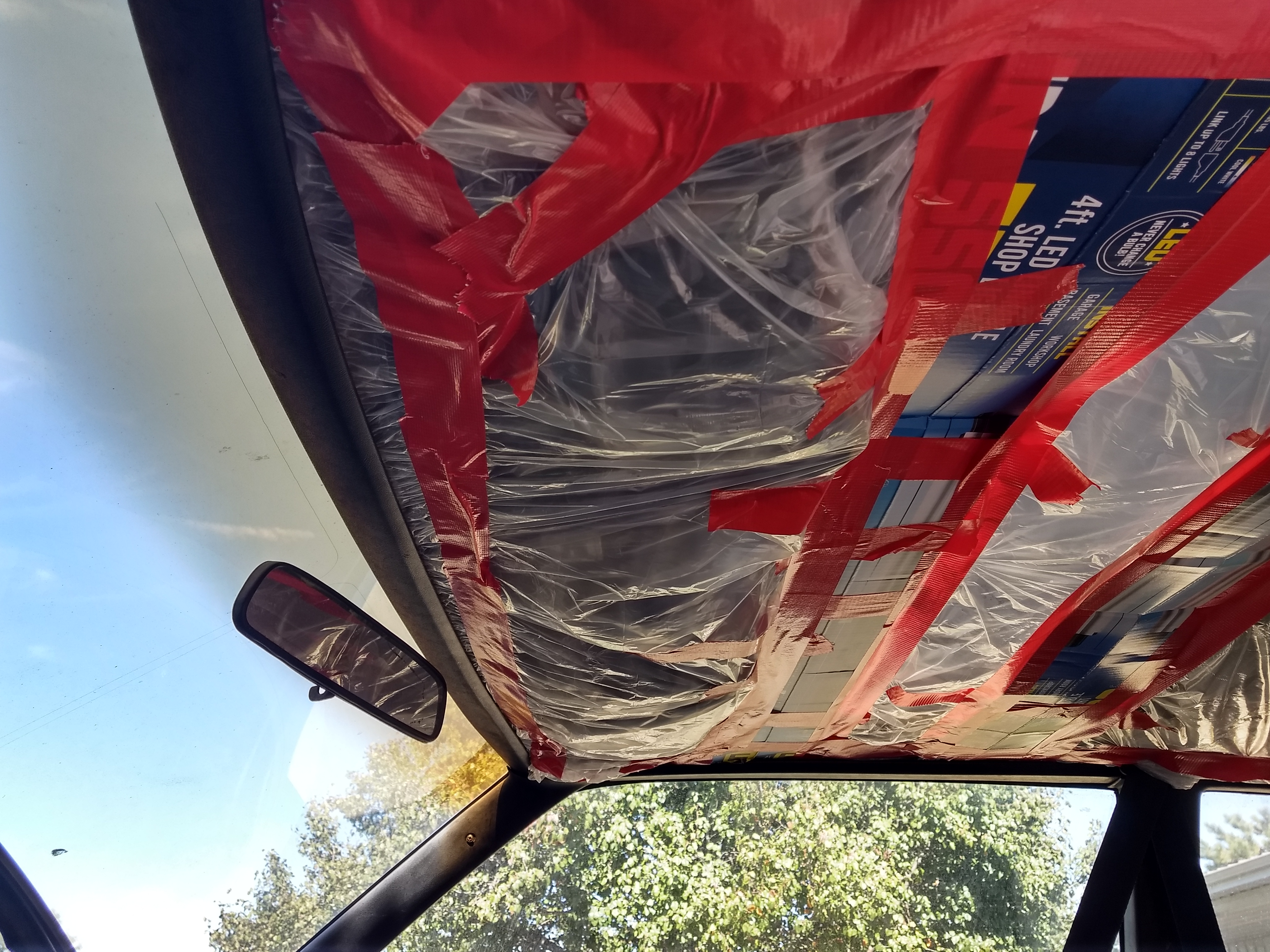

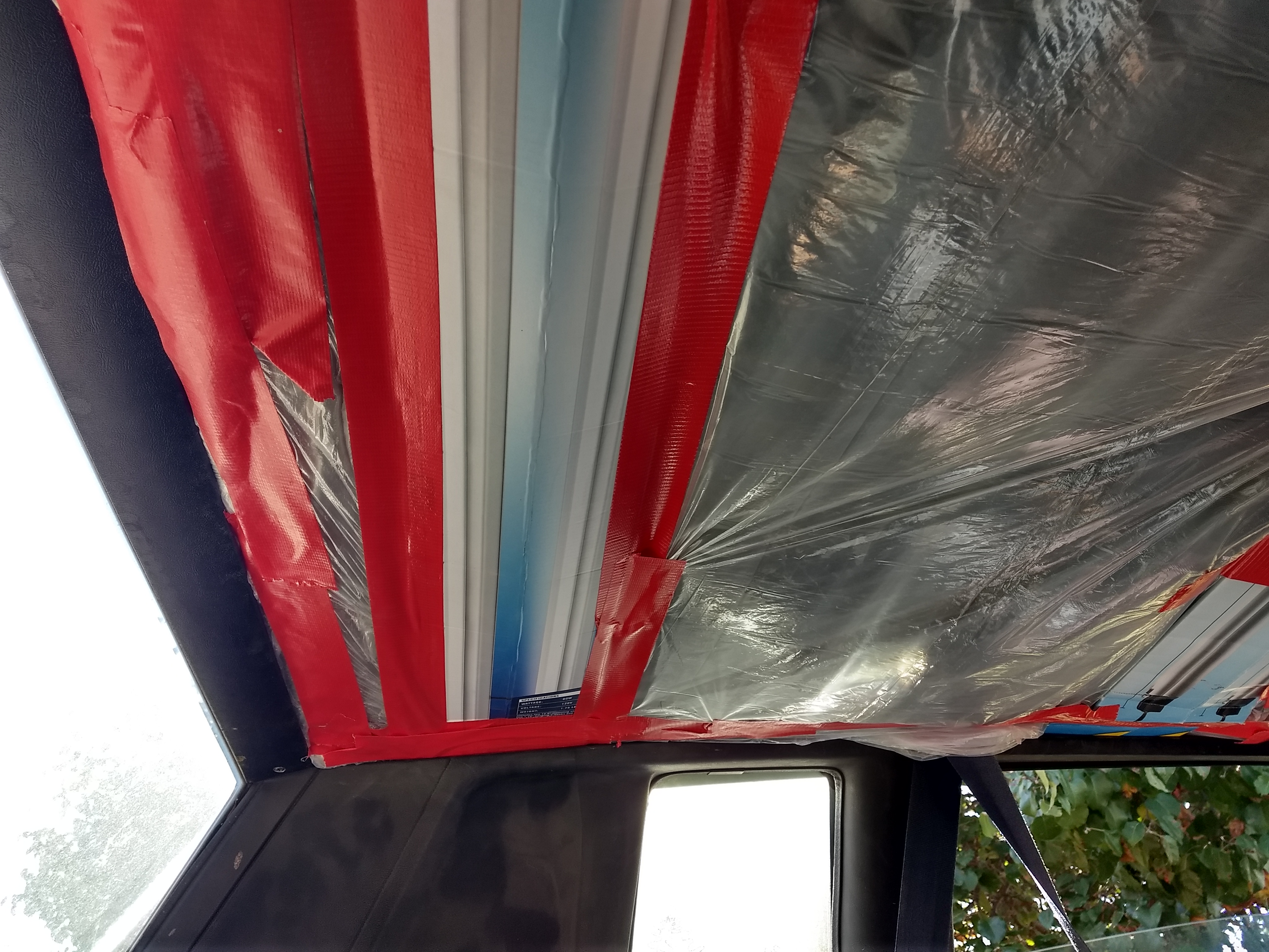

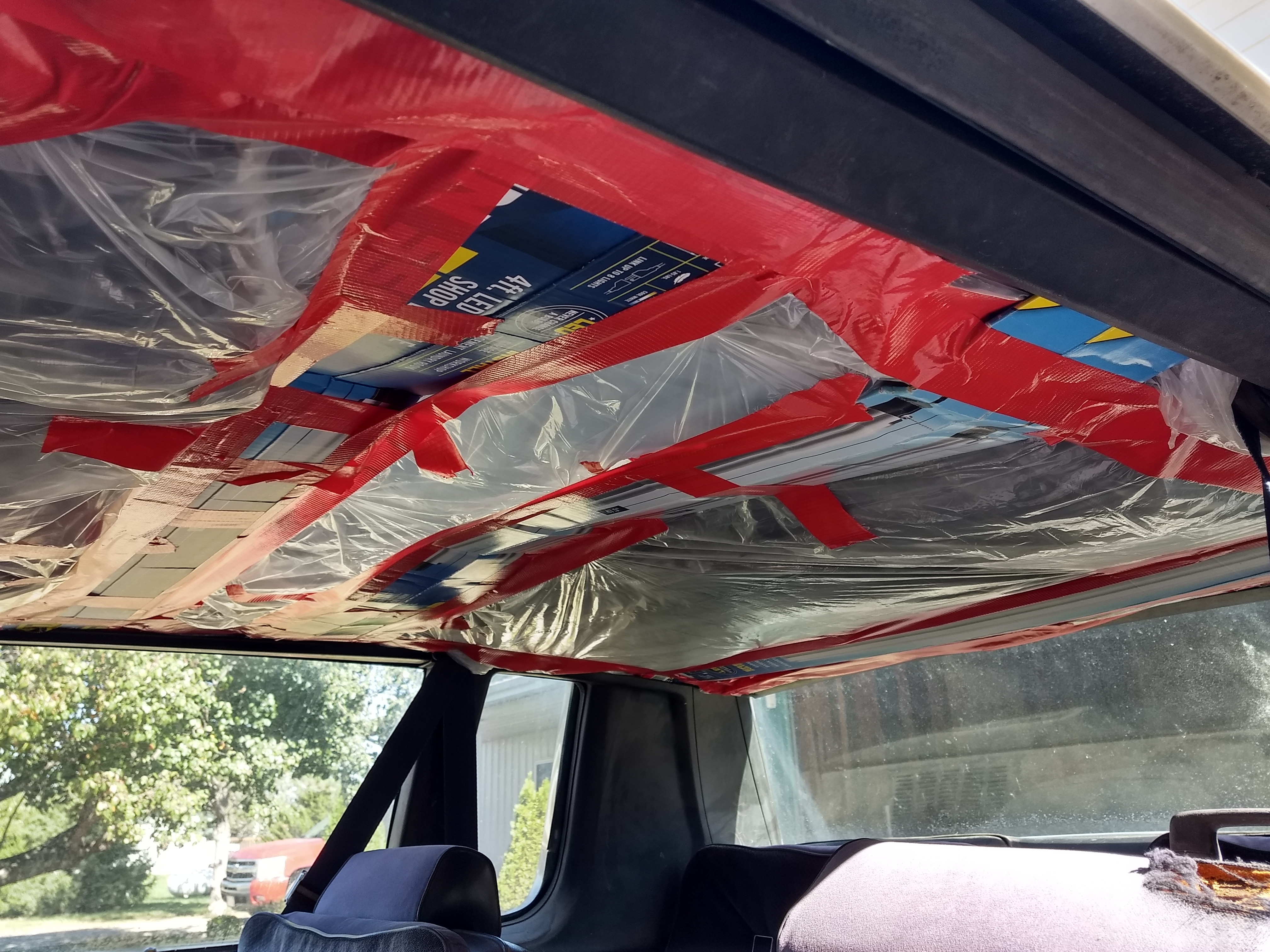

Here's my quick fix for the headliner. I ended up adding black duct tape to make it look better but the tape added too much weight, especially when I drove on the turnpike with the window down. So I bought some spring loaded curtain rods at Dollar General and they solved the sagging issue. I know it's a ghetto job, but remember this is just to get it mobile. I'll replace the headliner with new foam and custom fabric when I eventually fix the sunroof. Fixing the sunroof, actual roof, and floor pans are important to me but not as important as being mobile- I'm living in someone else's basement with my truck in pieces.View attachment 230875View attachment 230876View attachment 230878
Again, this was done for the sole purpose of containing the headliner foam particles so they wouldn't blind me as I drove.
Tear the fabric off and vacuum all the foam off until it’s white. Job done.
