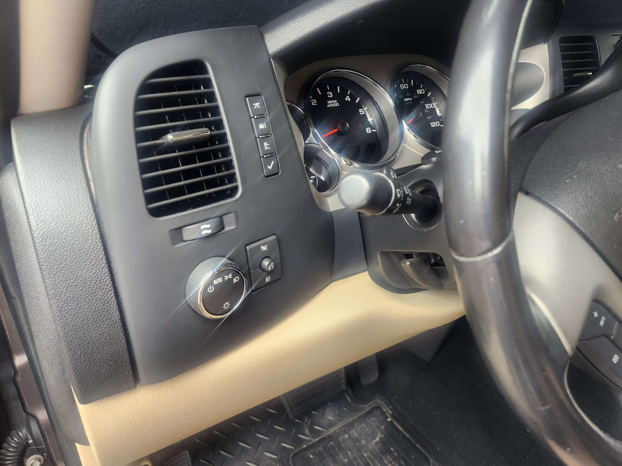

In the course of researching what to do on the dash, I learned that I could easily add the Driver's Information Center buttons to my truck. My truck, being an SLE, not a SLT didn't come with them. I learned that the wiring harness is there and the module has all the functionality, GM just put a different panel with no buttons in the mid and lower level trim trucks. Thanks GM. Putting in this functionality is something I've long wanted to do, I just didn't realize it was this easy. I put it in today. You can get a cheap aftermarket panel with the buttons but I went ahead and bought the Genuine GM unit.
Before.....
After.....
Almost 6000 hours on the engine. That figures to roughly 7.7 hours a week....
I figured something like 12k-14k gallons of gas burned. It doesn't go that high....
This one surprised me. I didn't think it would be this good....
It shows other things like individual tire pressures and you can adjust entry and exit lighting, chime volume, etc. Not a big deal but it's kinda neat to have this functionality. I wish I had know about it sooner.
The DIC buttons should of been standard at all levels. When I got my '08 Silverado Z71 it took three months to say hell with it & grabbed GM unit. One thing I didn't like was I couldn't reset the engine hours after the original 5.3 was replaced.

No I haven't. I can't say I'm out on the forums for that truck though. Also, the exhaust system on my truck is too loud for talking on the phone. We put an inexpensive aftermarket Kenwood stereo in my brother's 02 Sierra and it has a mic and pairs with his phone for hands free calls.
I totally agree. I guess it was just one of those GM marketing deals. I didn't know everything was there except for the buttons themselves or I would have done this a long time ago. When I bought my truck in 08, the work truck trim level trucks didn't even have oil pressure and volt gauges. Very cheeseball. Thanks GM.
