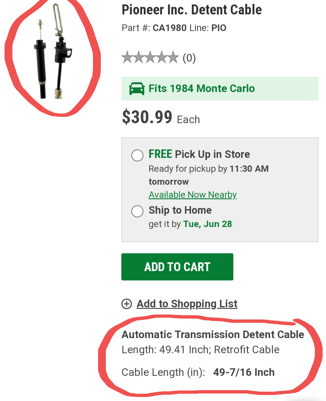

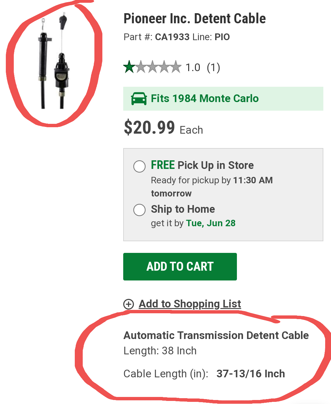

From my research it looks like the kickdown cables for a th350 transmission come in two sizes... 37" and 49"... they also have different style clips that connect to the carburetor kick down connector..
How would I know which one is the correct size for my car?
Tynan918
Aug 2, 2021
1,136
249
View attachment 201122 View attachment 201123
I think I found the solution...
B&M Universal Adjustable Detent Cable 30287...they want damn near $65 for one...
