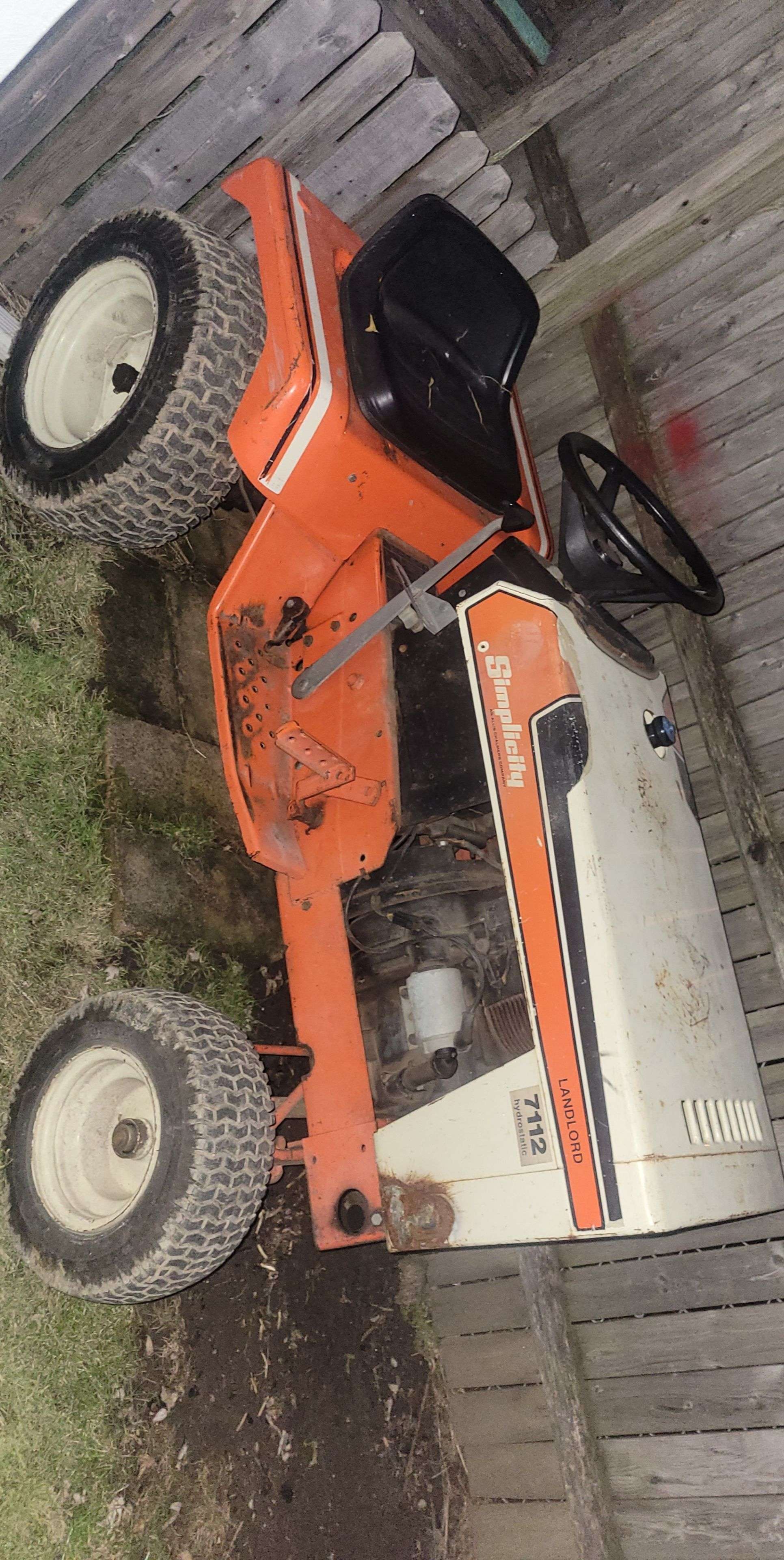

The ‘Landlord’ - live it! No one would dare give a piece of equipment a name like that now!I may be young but I was bitten by the lawn tractor bug too. Thanks Grandpa for the Allis-Chalmers obsession! (cough cough and the Oldsmobile obsession) View attachment 211926 View attachment 211927

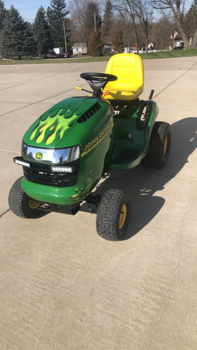

Fun thread! Here’s my contribution to saving a junk tractor. Put in a 27hp twin, better trans and obviously added some visual flair. It doesn’t look as nice today as when I finished it 3+ years ago but it mows and blows.
Yes, it’s a K57 with I believe 28:1 reduction IIRC. It’s a little slower at top speed than stock, but it’s almost unstoppable when snow blowing. And it does sweet wheelies when pulling weightWhat trans did you go with? I assume it had a K46 originally? I swapped several of those for K57s. Pretty much a direct swap and a much better transaxle.
They should've had K57s when they were new. The K46 is good for mowing a flat lot and that's about it.Yes, it’s a K57 with I believe 28:1 reduction IIRC. It’s a little slower at top speed than stock, but it’s almost unstoppable when snow blowing. And it does sweet wheelies when pulling weight
Simplicity had some of the best lawn tractor names from the 'Landlord' to the 'Sovereign.' I think that's when your property was still your actual "castle." 😂😂The ‘Landlord’ - live it! No one would dare give a piece of equipment a name like that now!
Yeah the entire tractor was junk in factory form. The k46 was about dead and the motor was run without oil, which is why I was able to pick it up for free. Found the Tuff Torq trans for relatively cheap and had connections to a brand new B&S twin that failed inspection because of a bad head gasket. I think I spent more on the paint and graphics than everything else It’s quite the workhorse now.They should've had K57s when they were new. The K46 is good for mowing a flat lot and that's about it.
