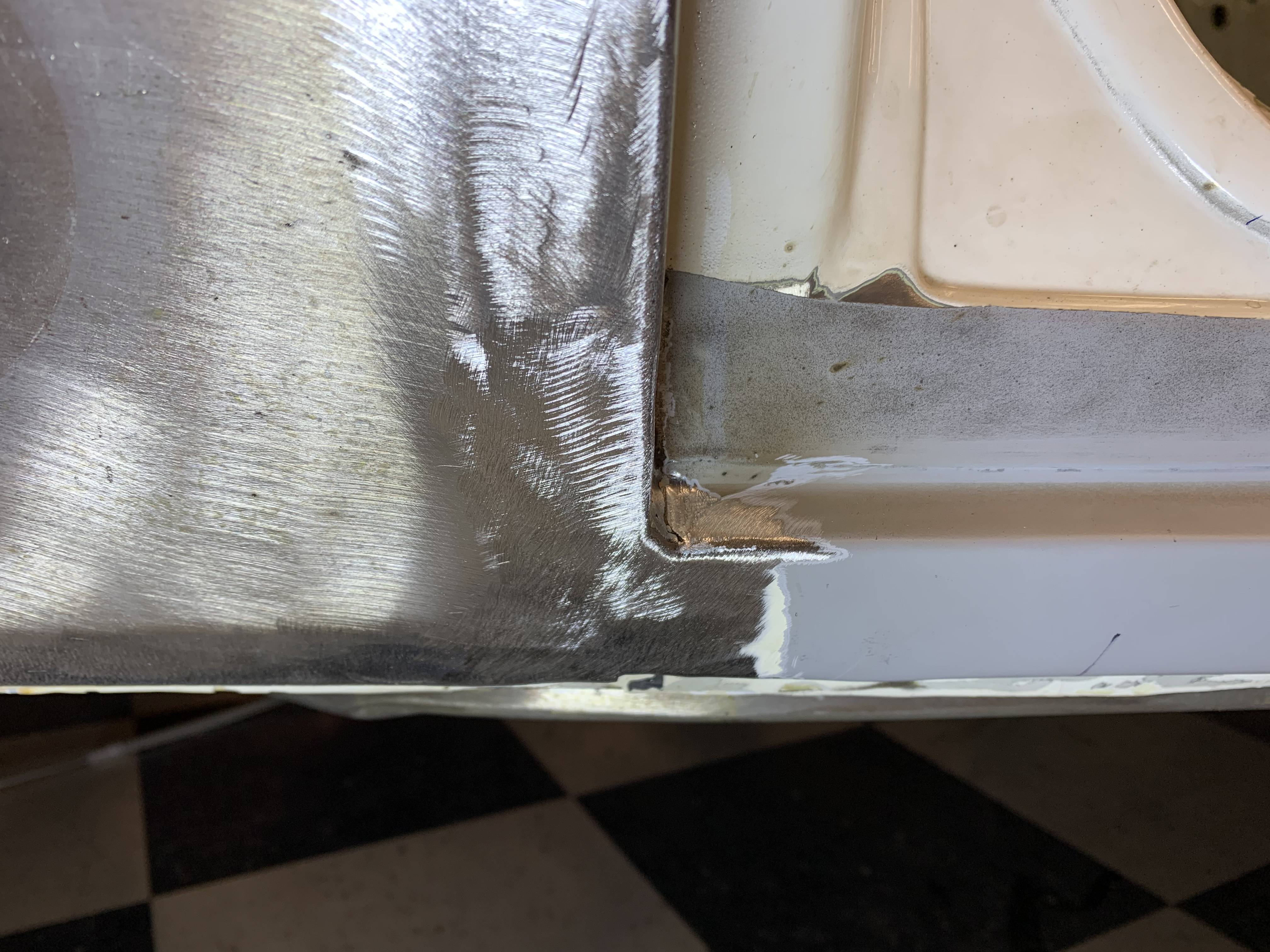

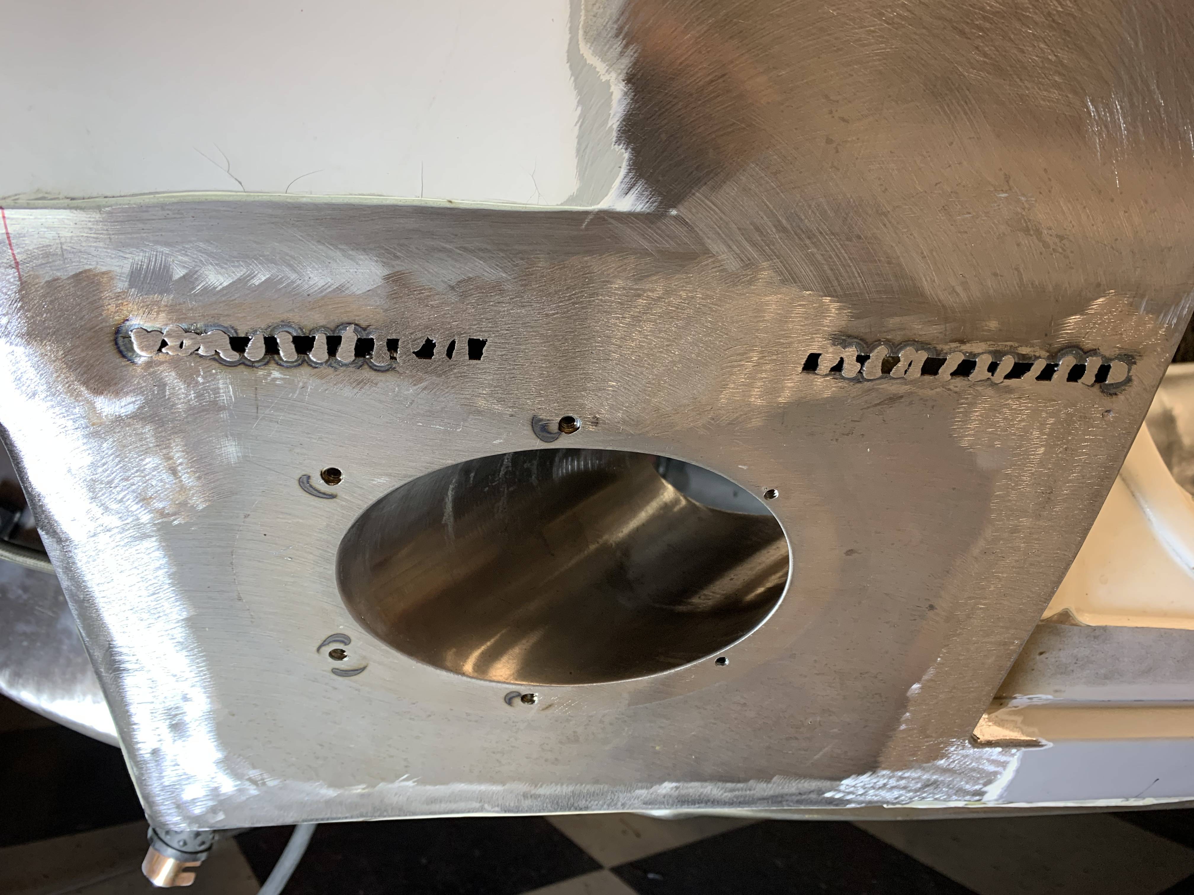

Started off by knocking out the rocker panel seam delete…
…then dove right in to fixing the ugly upper joint between the two panels. I had put a flange on the bottom edge of the quarter panel thinking that it would make it easier to locate the pass-through insert, and while it gave me something to Cleco to, it royally screwed with the straightness. It had flattened out the area, and to make matters worse, the top half of the insert was quite short and bent inwards at a bad angle.

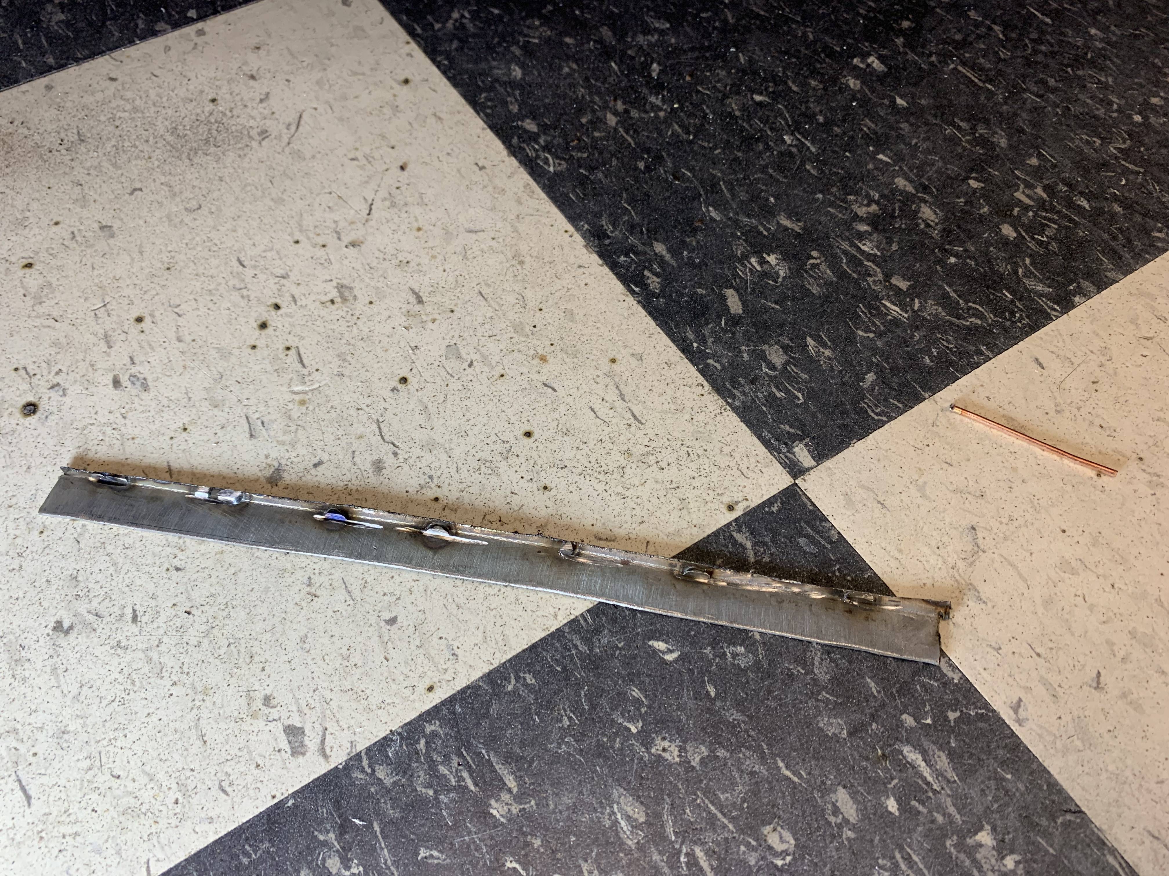

So to correct this, I cut the upper tack welds and the flange completely out.

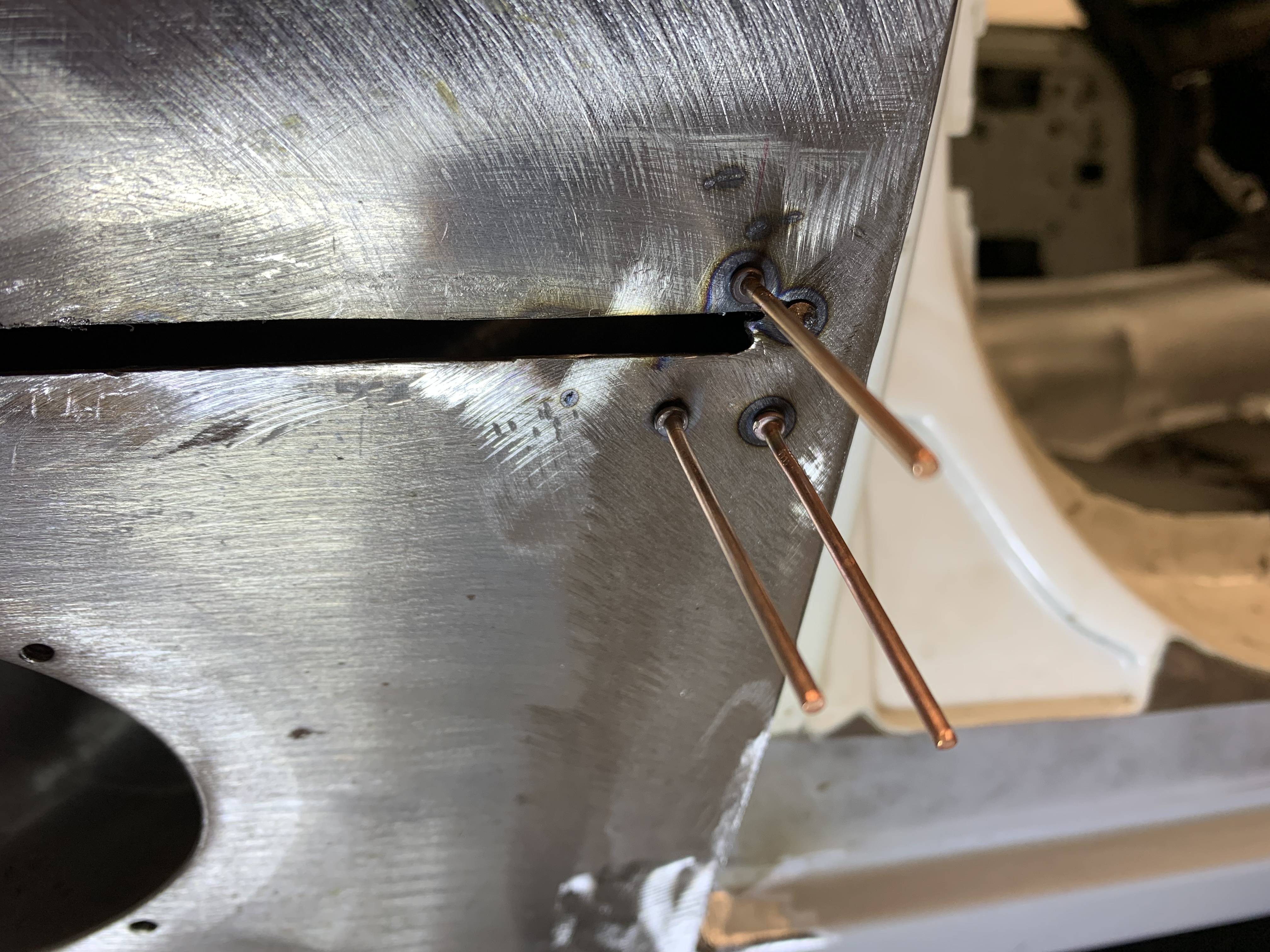

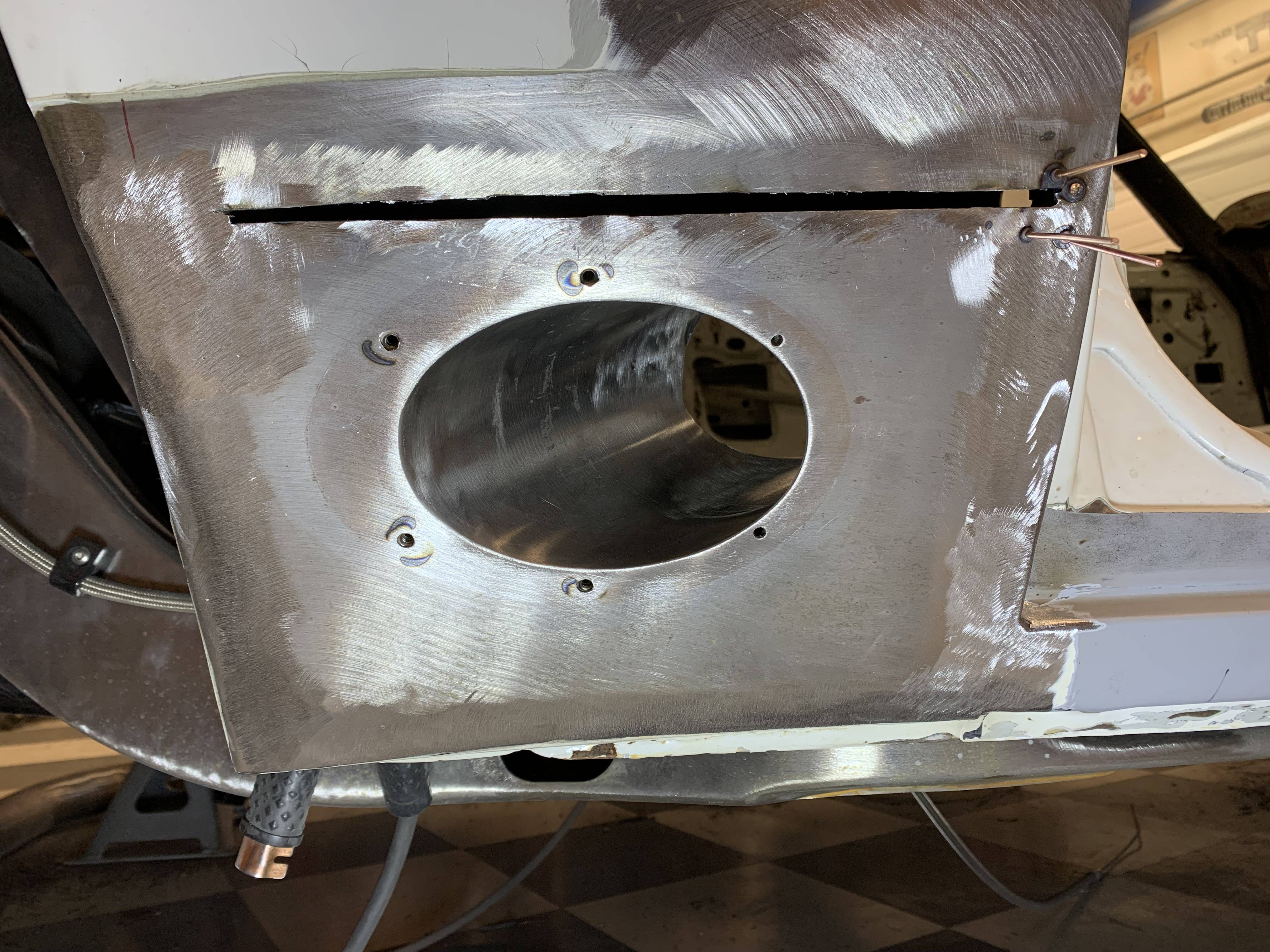

This left a sizeable gap between the two panels unfortunately:

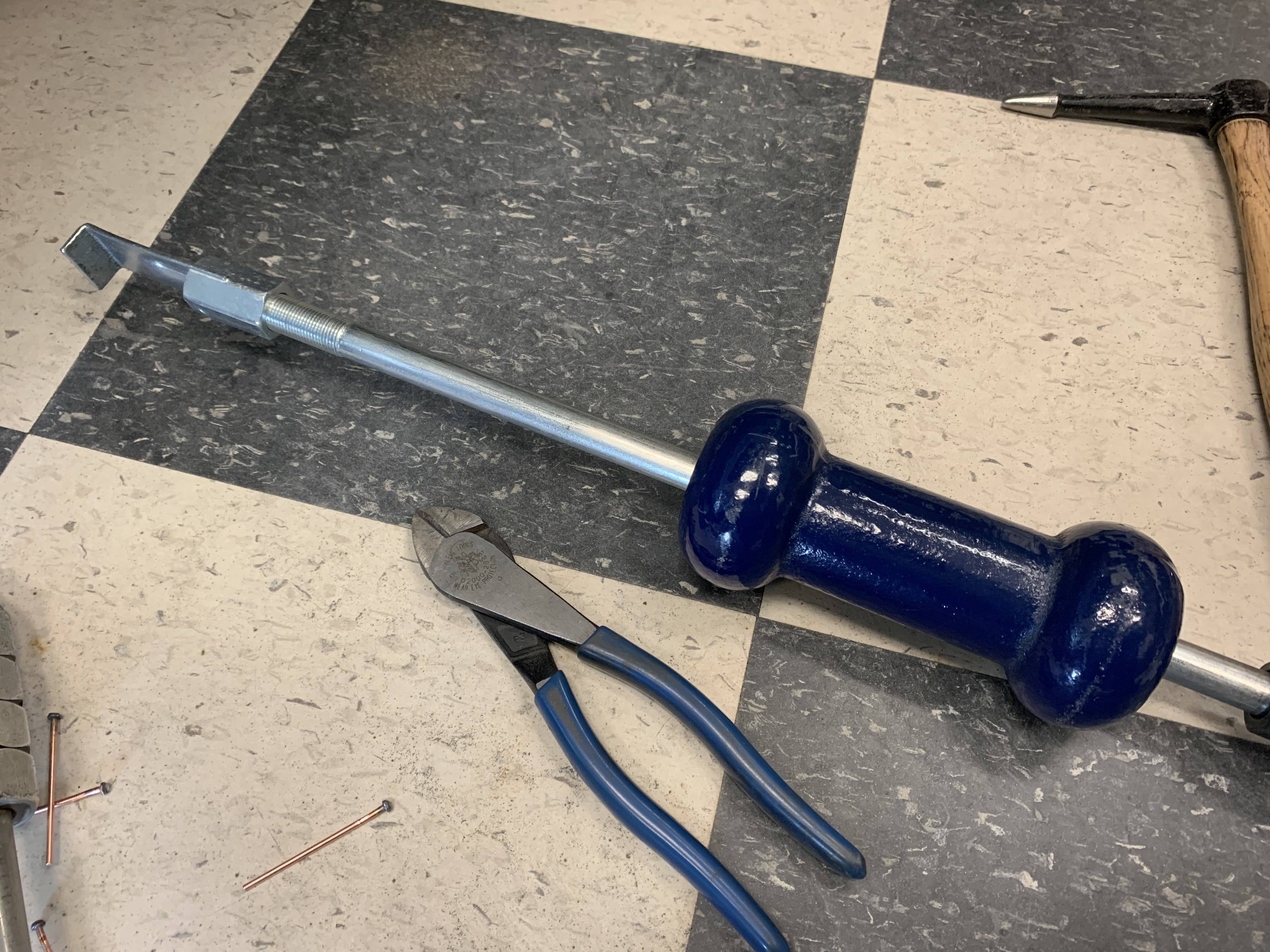

I broke out the UniSpotter and the slide hammer with a large flat 90 degree hook on the end, and started straightening things out.
Once I got things aligned properly, I then began to weld the gap up. DISCLAIMER:
I definitely DO NOT recommend doing this the way I did, usually trying to weld up a gap this large between two panels of the same gauge will result in it pulling inwards and leaving a nasty valley between the two.
However.
I had a couple of things working in my favour, the insert is much heavier gauge steel than the quarter, and the proximity of the upper edge to the welded pipe meant that the area was very strong and wouldn’t move a whole lot.
So I started doing what I call “bridge tacks” (because they bridge the gap), and continued doing so until I had only a 1/4” or so between them. Once that was done, I knocked the tops of all the tacks down almost flush and started welding in the gaps working from the center out.
Again, definitely not usually recommended unless you know what you’re doing. Weld, cool, grind, repeat. Weld, cool, grind, repeat. Over and over, probably in the neighborhood of 40 or 50 times. After a couple hours sitting cross legged on the floor repeating this process over and over, I finally had it fully welded.

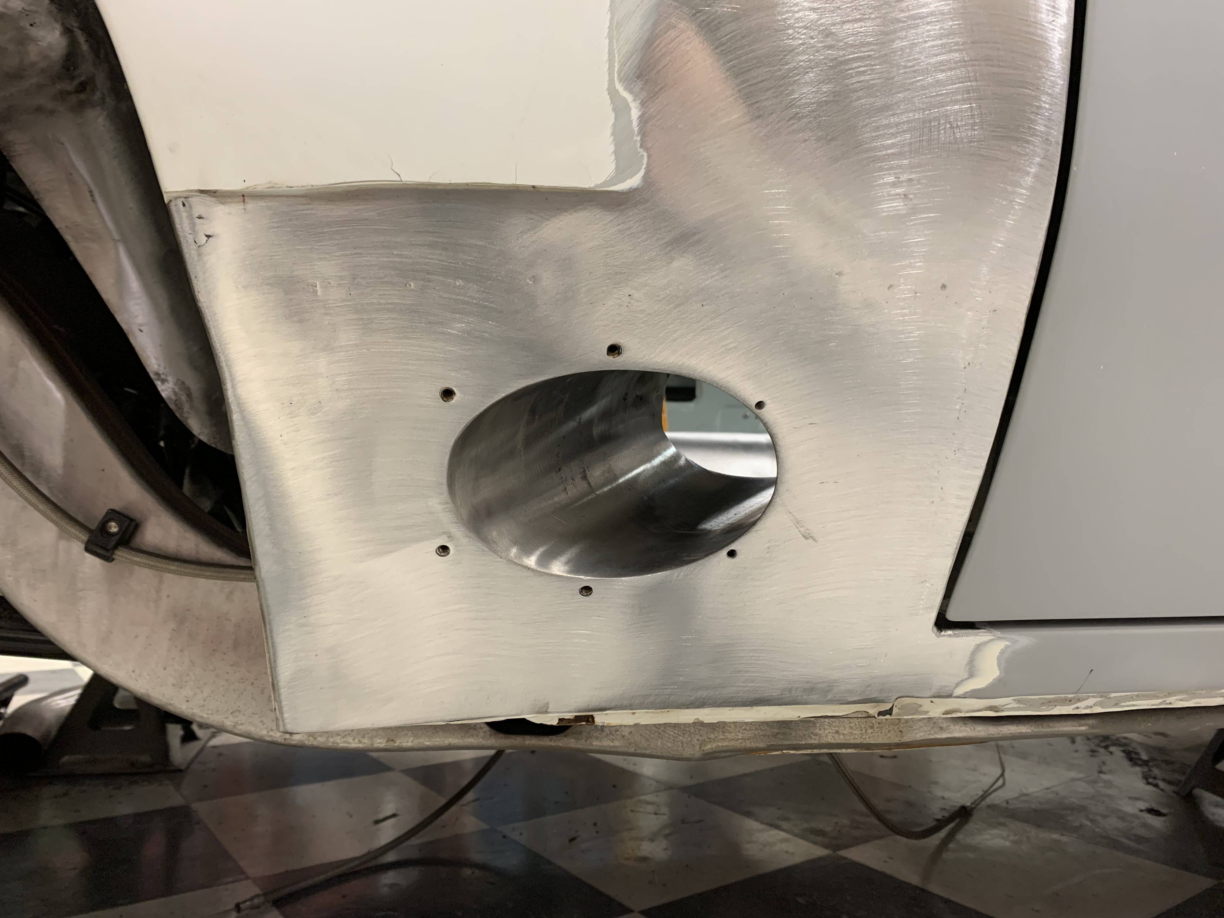

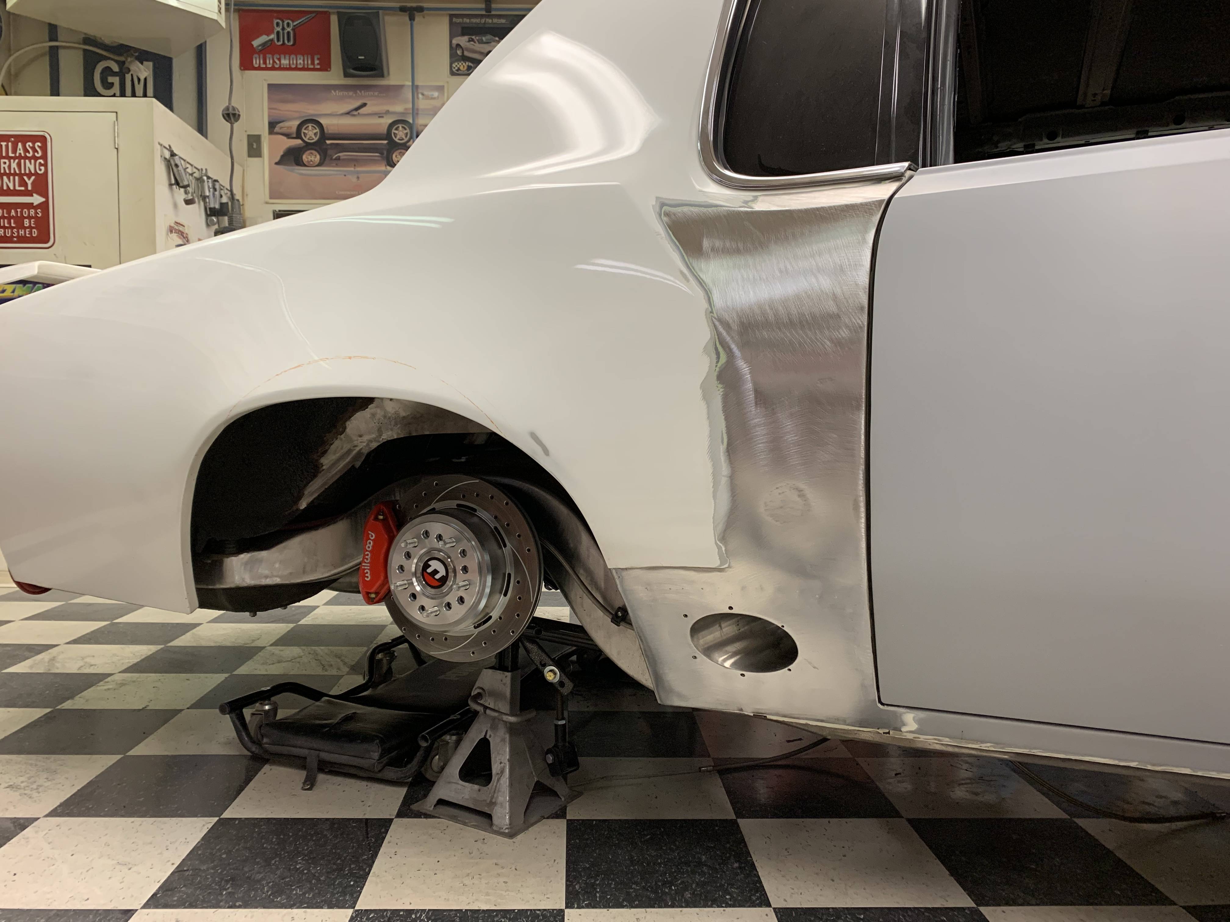

It had still pulled in a bit (I had anticipated that), so I stitched on another row of porcupine quills in the valley and pulled it out with the slide hammer. A little dressing with 40 grit on the big wheel 8” grinder, and voilà. One side completely done!
I think it looks killer, and that’s even without the trim bezel or the exhaust pipe back in there yet. This has been a long time coming, and I’m so glad to see it all coming together.
It was another good day.
D.
Damn dude... I would have thought a small strip of 16 gauge would have been the preferred method to address that wide of a gap. I know it works, and being talented/disciplined (is key as you demonstrated/described) - but that seems like a lot of time and material wasted.
I've only ever bridged tacks that wide on exhaust. But, I am a ham-fisted ape.
Understanding that this is a rare instance, and it may never come up again, you may want to look into a TIG as resources allow. The precision afforded will compliment your skills remarkably.
