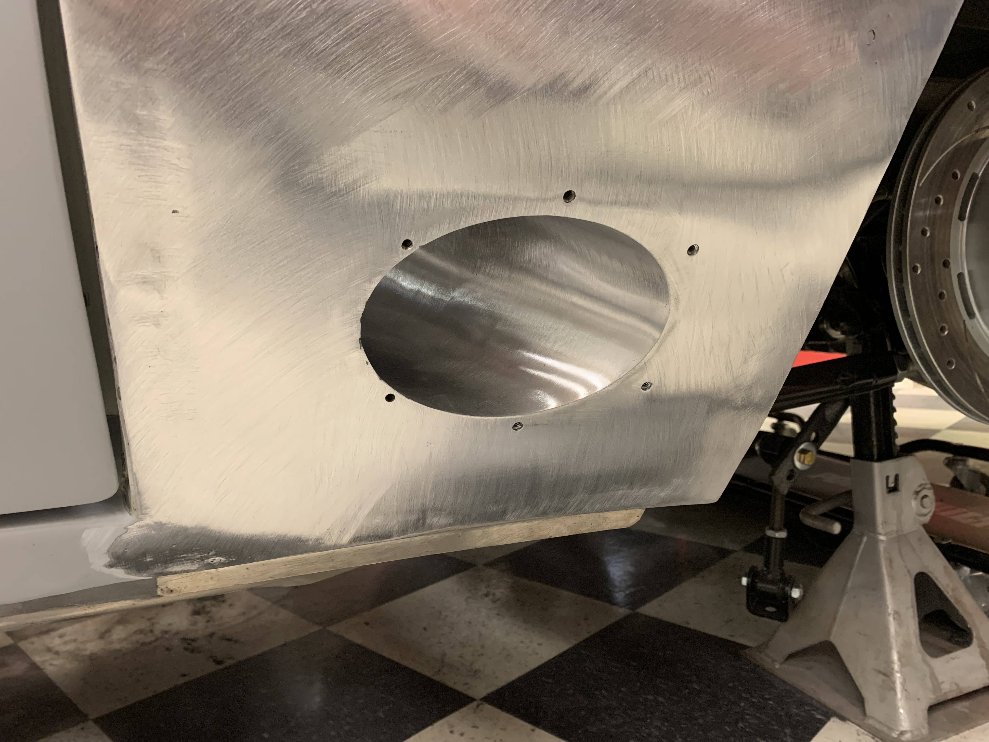

Continuing on in the spirit of wrapping up loose ends and crossing things off the list, I next installed the driver’s side tailpipe and popped the new floor crossmember back in.
Other than the white epoxy that sticks out like a sore thumb, it looks nice to see everything done and in place now.

Just so I can get this straight in my head, is this the full time exhaust where it comes out in front of the rear wells (making room since it's bagged)? Or are these cutouts?
And you're simply letting the exhaust pipe enjoy the surrounding air gap? This would be a plus as when the car is moving, air would flow up the pipe channel from under the car and be pitot-tube siphoned right out the exit hole around the pipe, to help evacuate the exhaust away from the car while providing a heat buffer. Genius move.
Yes, this is the permanent home of the full time exhaust now. I have electric cutouts too, but they just dump off to the side underneath the car. You are 100% correct on all your comments and postulations.

Donovan, I'm assuming that there will be some kind of cover over the area where the tailpipe passes through the car, and out the exit in the quarter panel? With some insulation maybe?
Jeff, this revision I’m making to the exhaust routing has it now staying entirely underneath the floor boards. The exhaust pass-throughs that are visible from inside the car now will soon be underneath the floor. So no, there will be no need for any kind of cover or anything. No ways for exhaust or outside weather to make its way into the car, that’s why getting all the pinholes caught and welded up was so important.
Or perhaps you were meaning insulation from heat?
