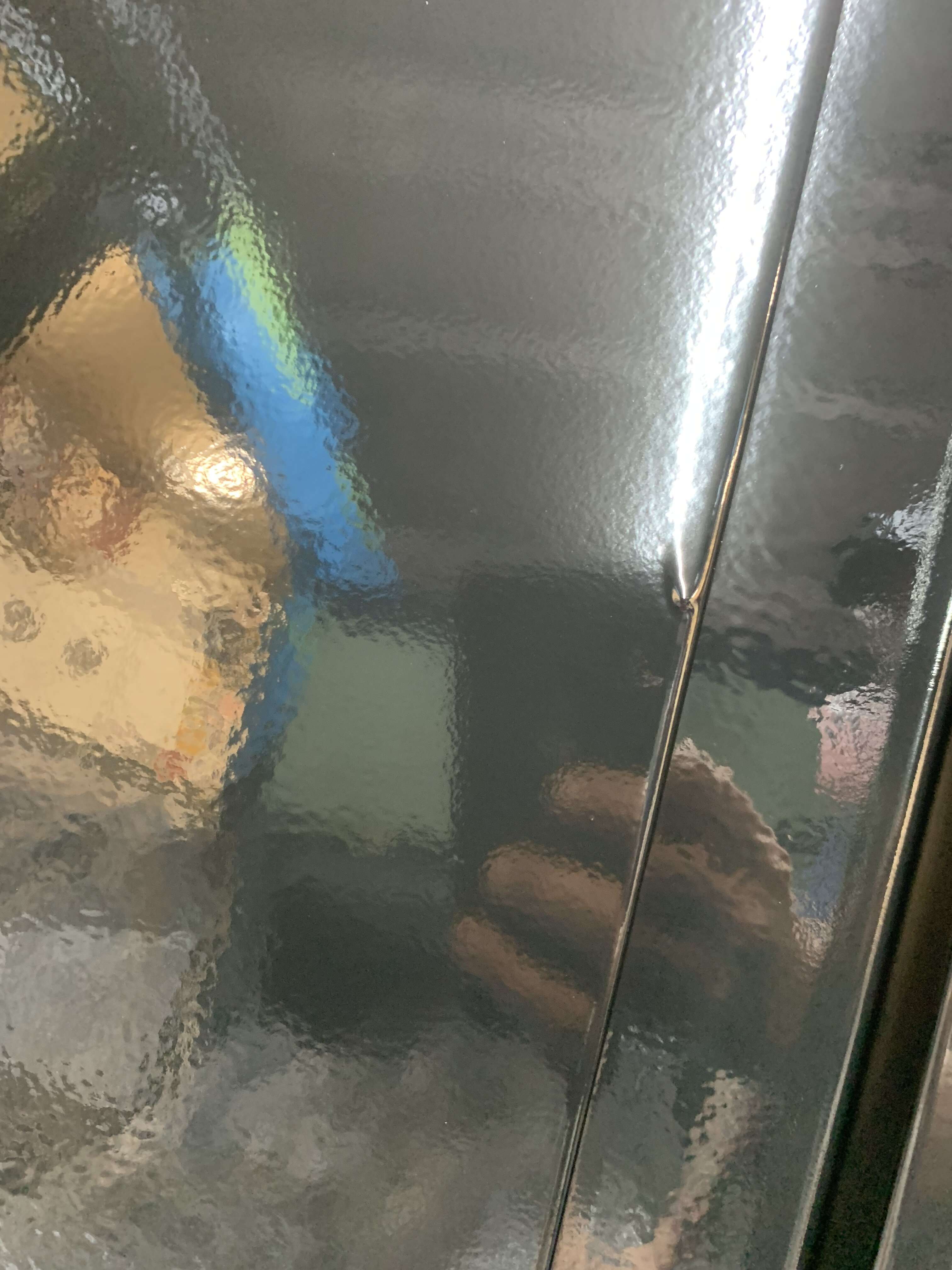

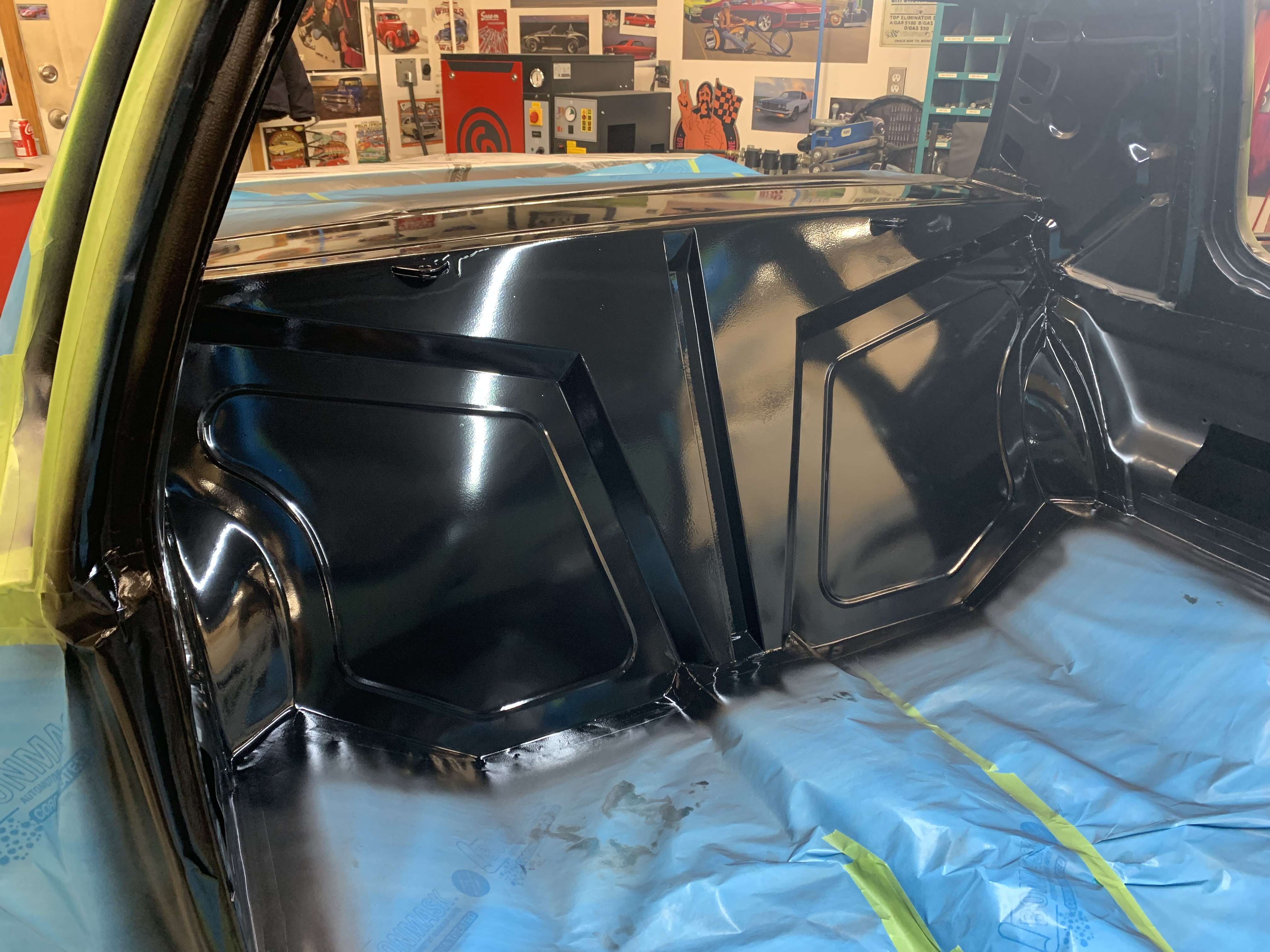

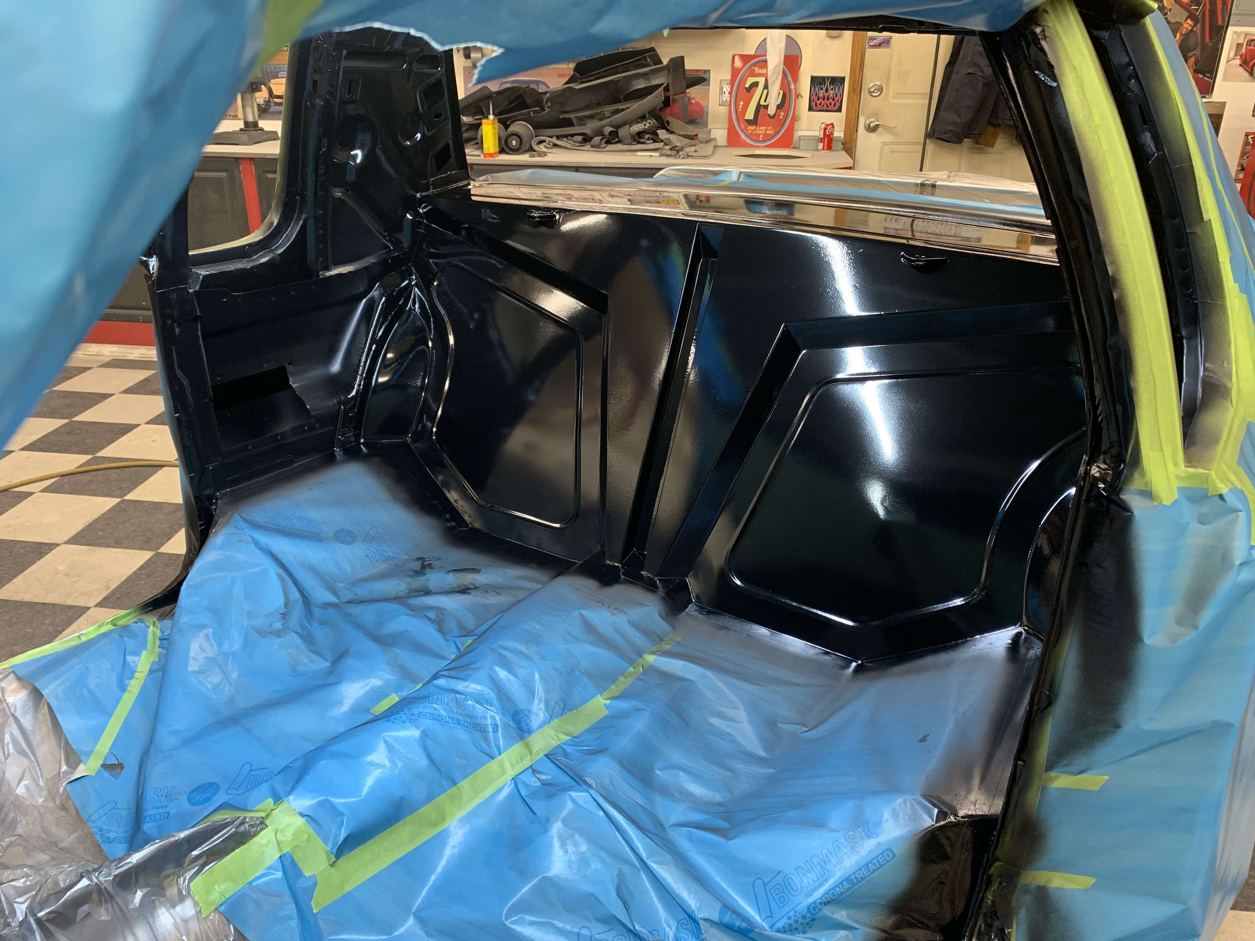

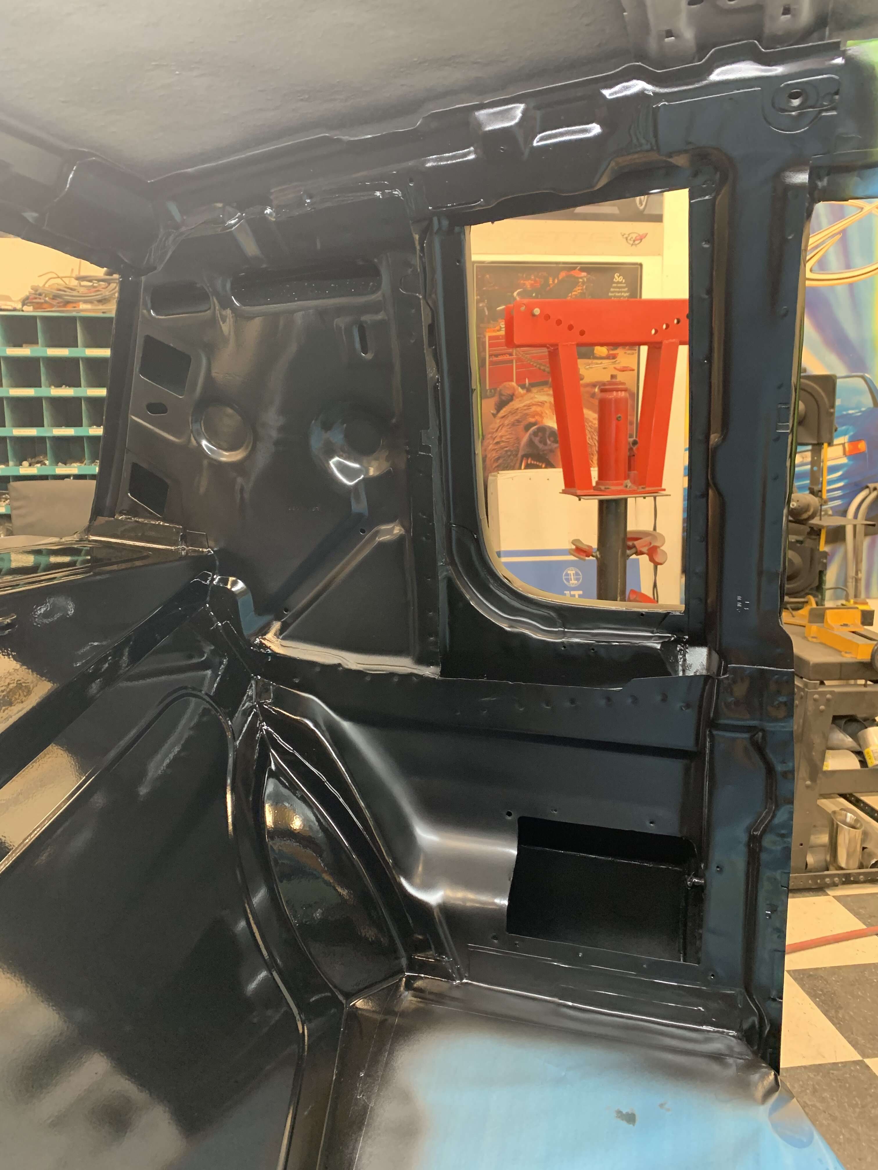

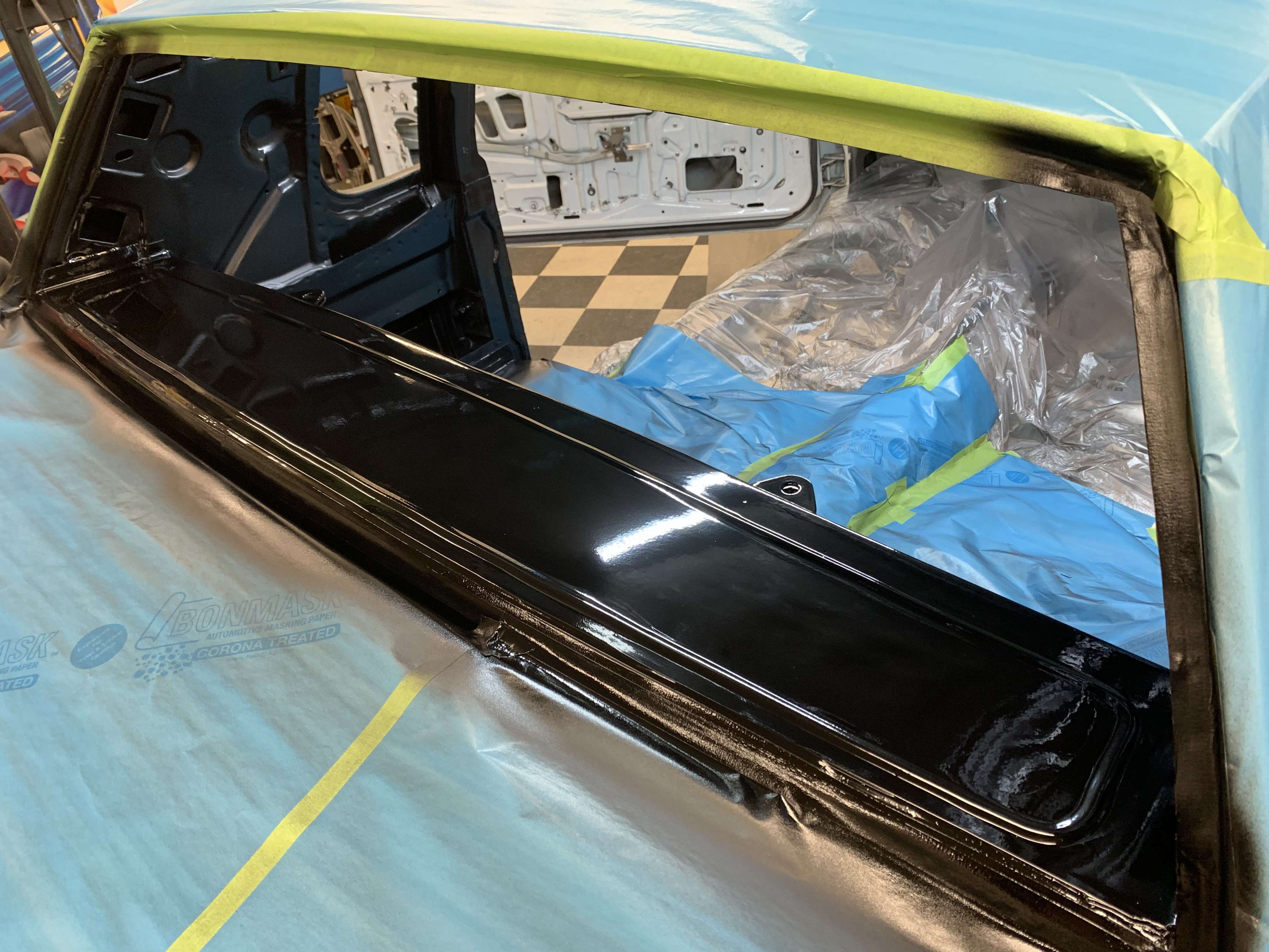

Well the deed is done.
Don’t get too excited, I’m not all that happy with it. In fact, I decided before I was even done cleaning the gun that I’m going to redo it.
The seatbelt boxes and the sides turned out fine…
…it’s the firewall itself that I’m not satisfied with.
The package tray portion of it is ok, not great, but ok.
The front face of the firewall is where I’m the most unhappy with. Lots of little pinholes that developed when the epoxy didn’t flow out well enough…
…and a couple of runs that I got when I tried to compensate for it with slower and heavier coats:
Now I know I should temper my expectations, afterall this isn’t paint, it isn’t even paint quality, and honestly was never intended to be. It is epoxy primer afterall.
But still.
The perfectionist in me knows I can do better, and quite frankly, doesn’t want to spend the next umpteen weeks/months/years looking at it in this state. It’ll grate on my nerves every time I look at it.
It actually doesn’t look too bad in the pictures, which for once is odd, it’s usually the other way around.
But I’ve already made up my mind. I’ll give it a couple days to cure then block sand it out in 180, maybe even step up to 220, and shoot it again. I’m not even going to unmask it yet. I don’t think it’ll take all that long to tune it up, I should be able to shoot it again by the weekend.
A bit anticlimactic guys, and I apologize, but that’s the way it goes sometimes. I post my successes, but I also think it’s just as important to post when I come up short too.
