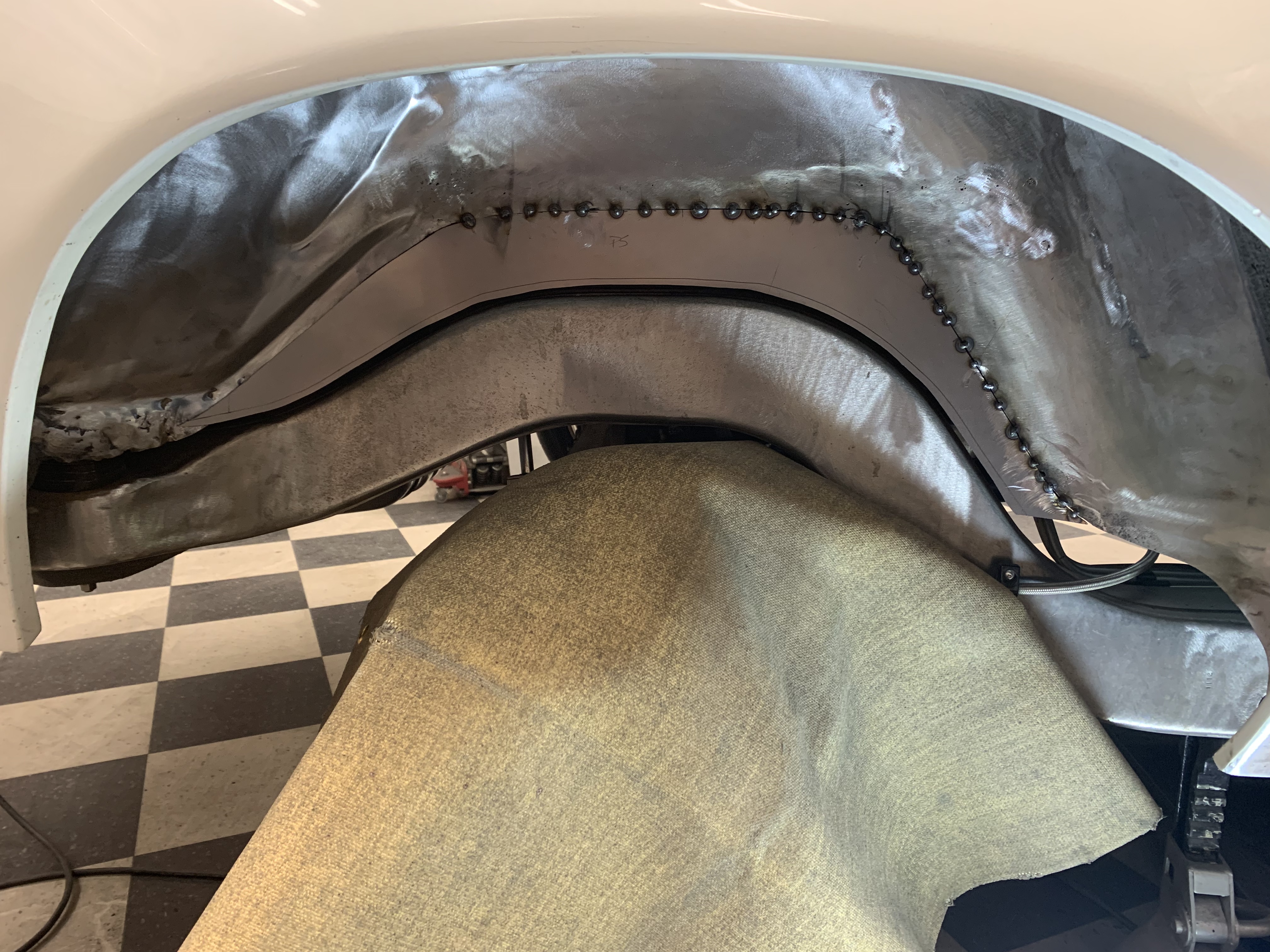

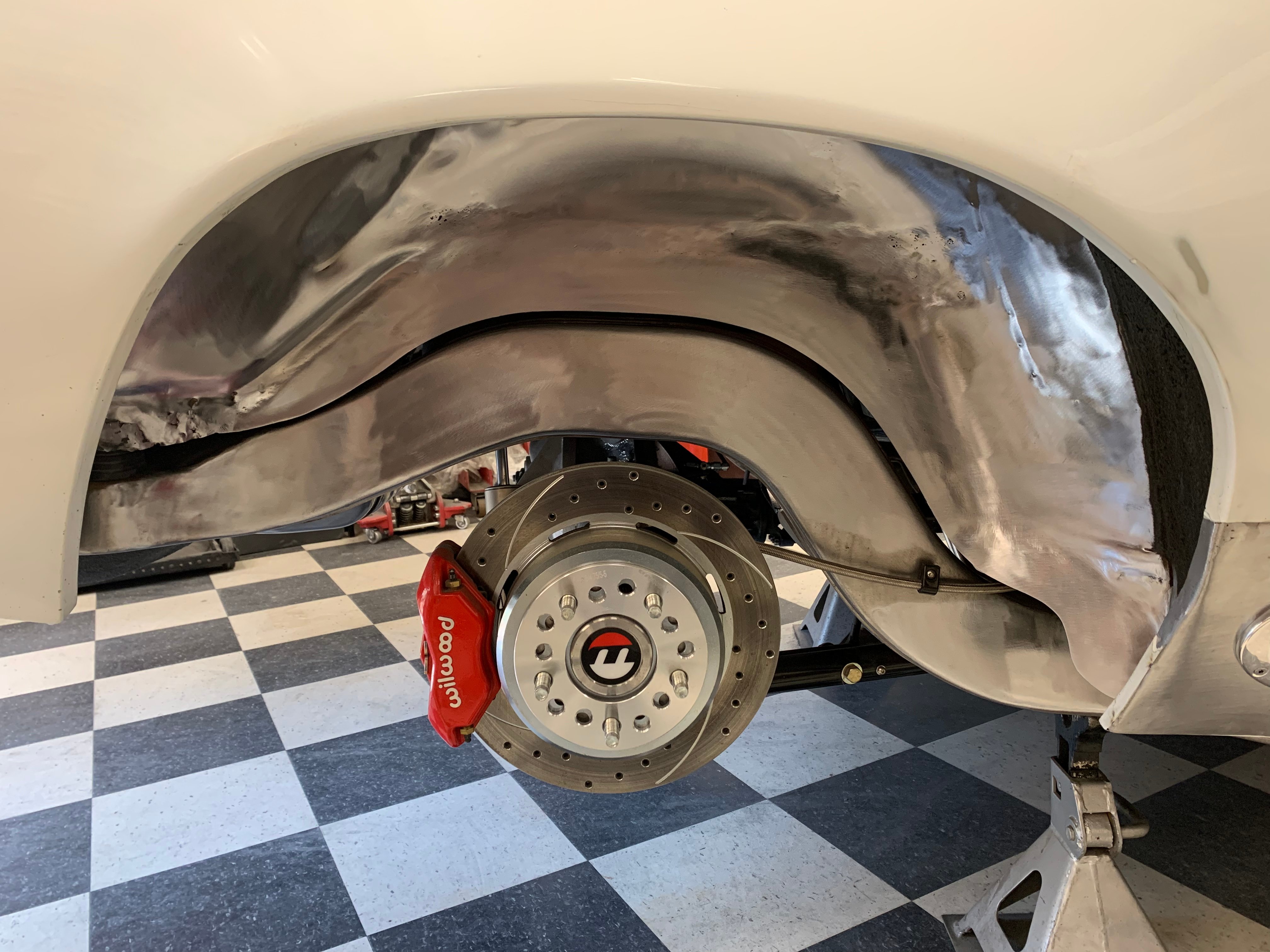

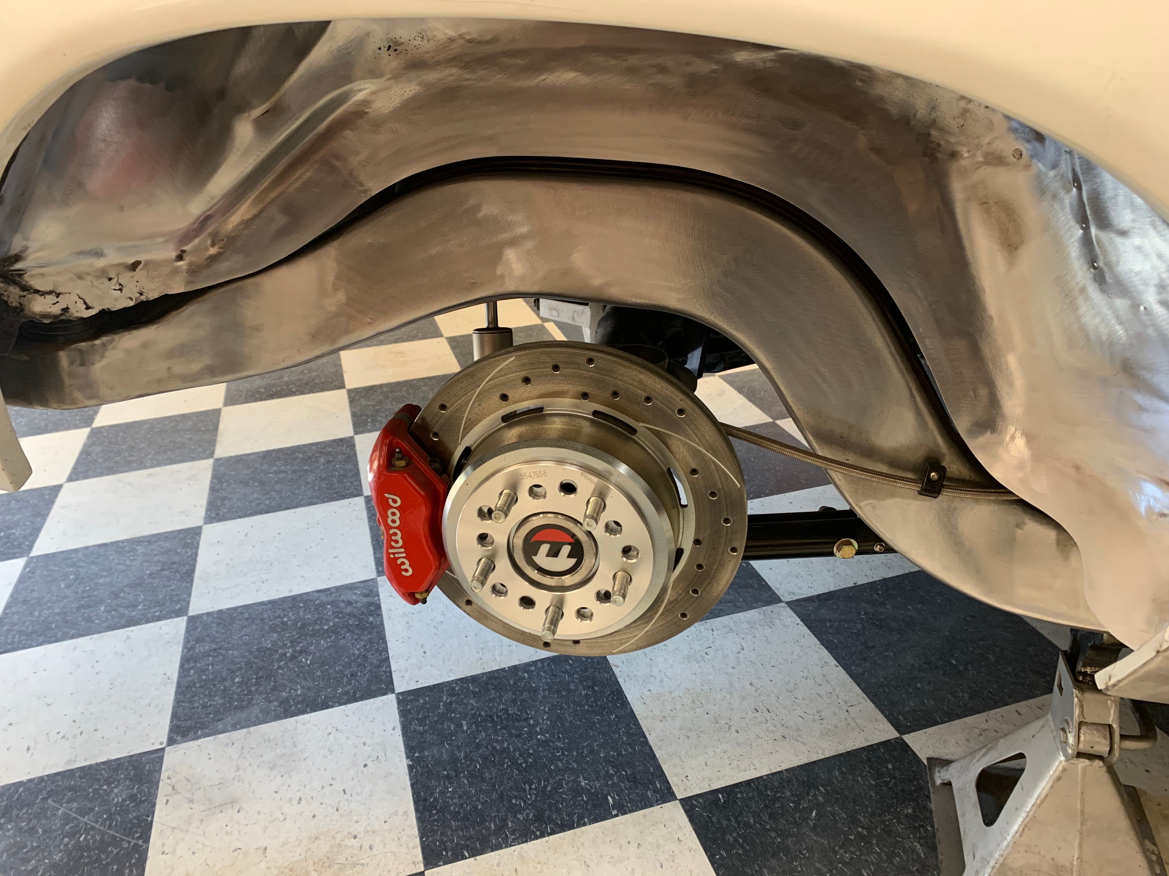

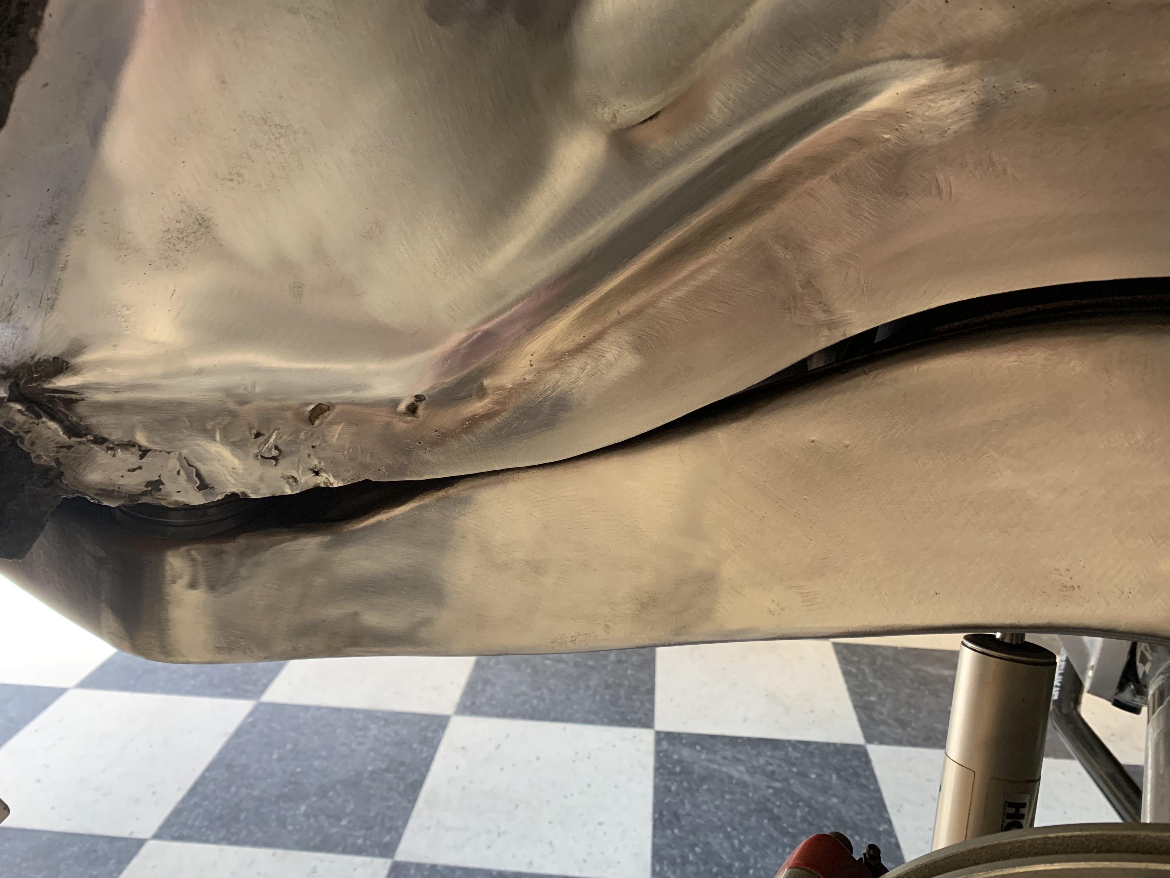

With springtime upon us and nicer weather, Mike and I are pretty much done with our co-shared garage Sundays. Whereas he’s content with not looking at his car again until fall, I keep going, especially during times of crappy weather. So this weekend, I logged in appropriately 10 hours over the last two days and knocked out the rest of the passenger’s side wheelwell closeout panel.
This is the only picture I have of when he started, but it gives a good idea of what we started with:
And now today, after I finished it up:
This front bottom corner is good, I templated off the other side to ensure both sides looked the same when I was done:

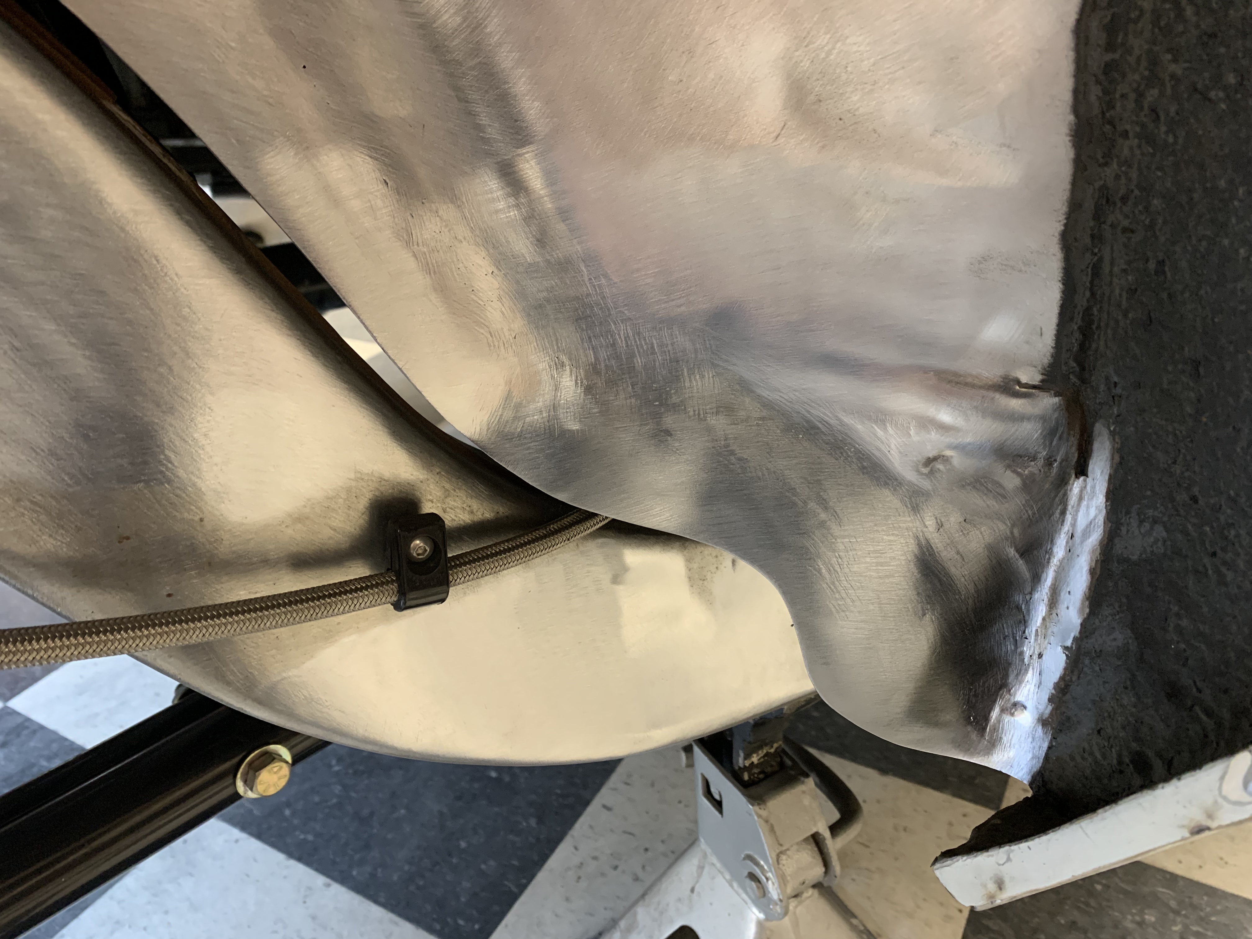

The backside corner however, will have to remain somewhat unfinished for now. When I welded in the crudely made body mount repair panel on the underside of the trunk floor back in my 20’s, I kinda made a mess of the wheelwell flange with a lot of heavy welds:
So the remainder of this area will have to wait until the body is on the rotisserie and that repair is cut out and fixed properly with the correctly shaped aftermarket kit.
But for now, I’m extremely happy with the end result. It looks so much better with that large gap all filled in again.

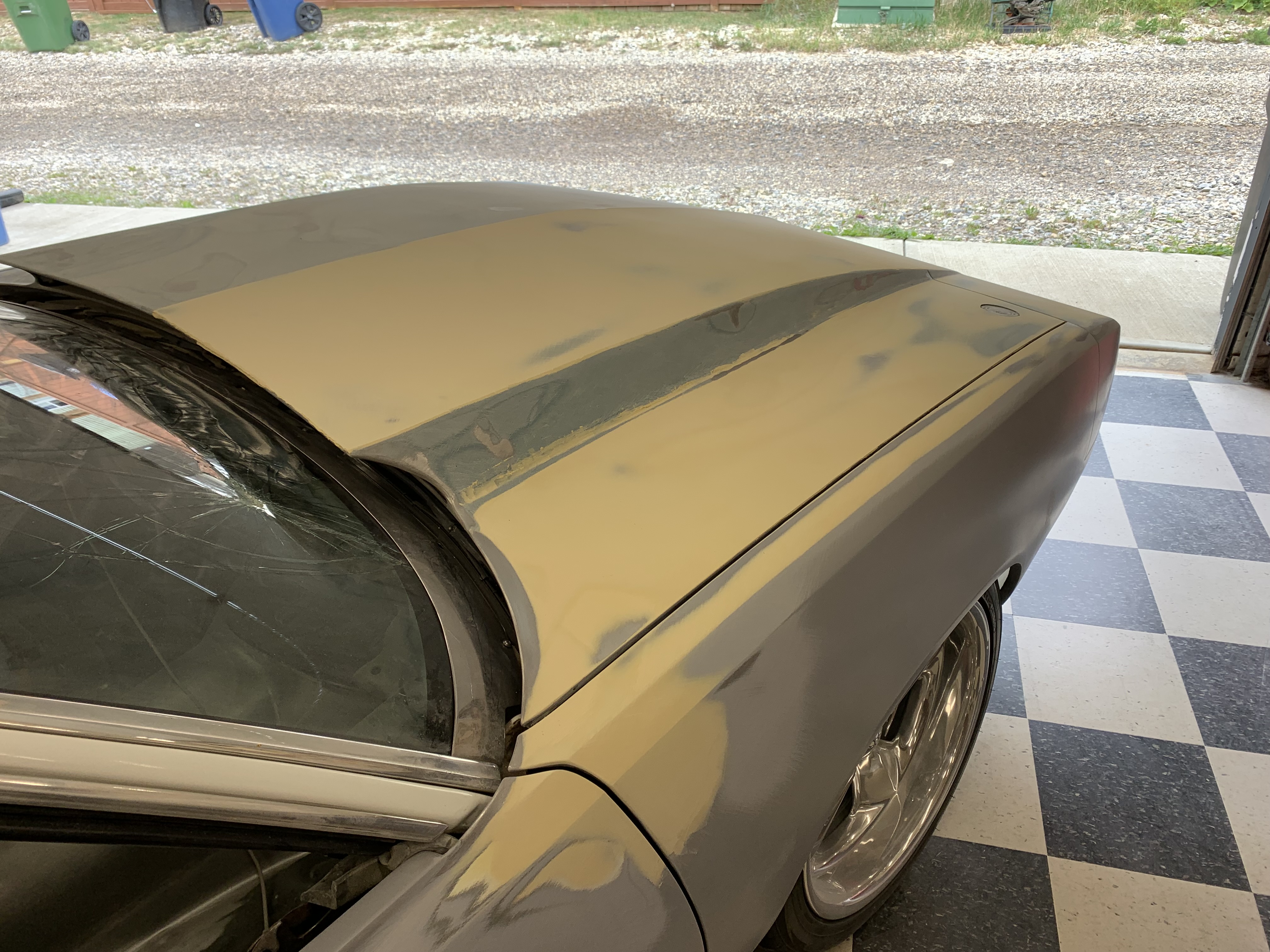

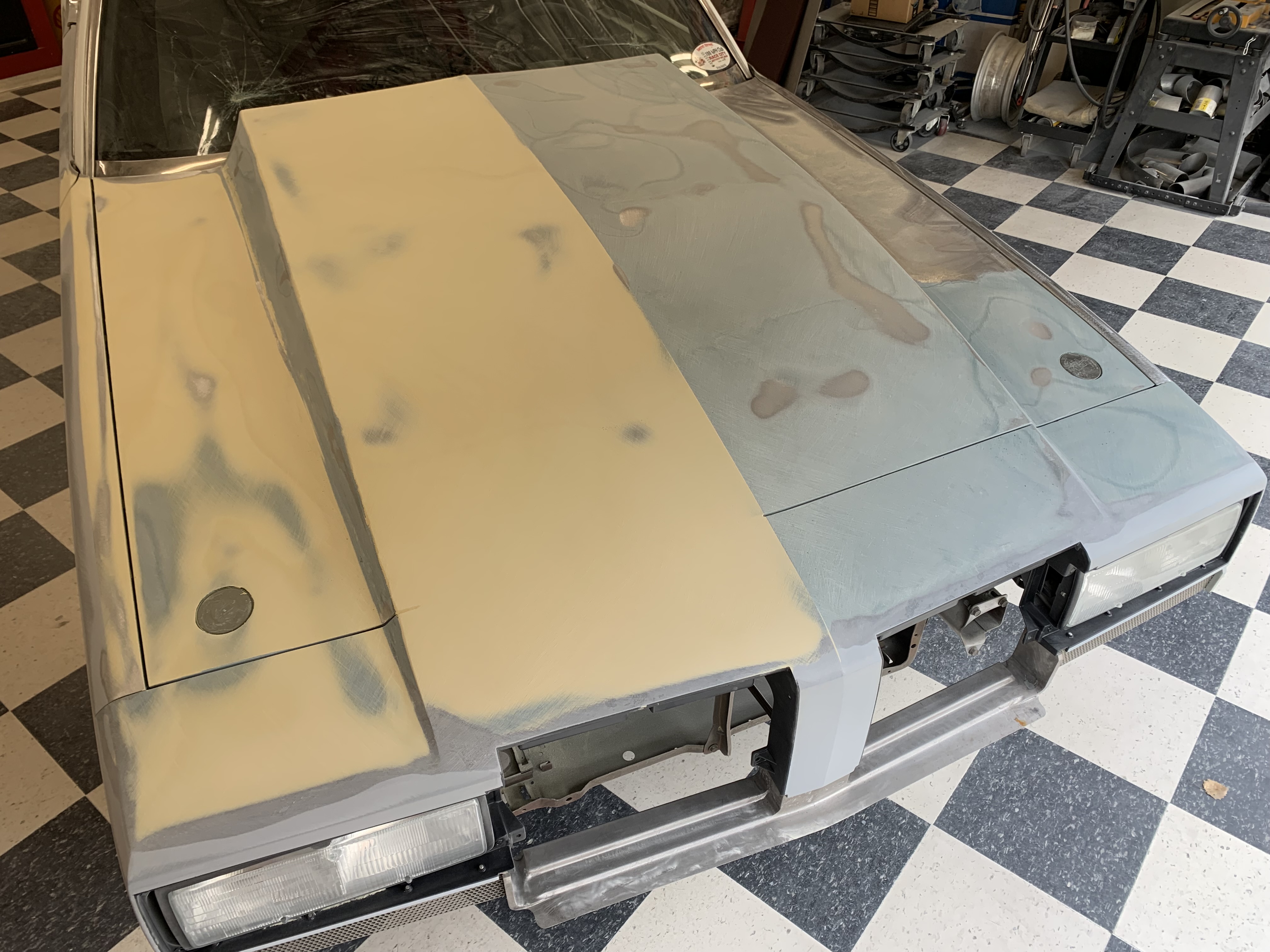

Been busy this summer tackling a huge, loooong overdue project: the bodywork on the hood.
The hood, for those of you who might remember, was scratch built from 3 stock hoods and designed to flow out of the factory body lines on the header panel. After the fabrication was done, the hood sat in bare metal for several years as I concentrated on other areas of the car, and even restored Olds Cool.
The Juggernaut has never had an actual finished hood on it ever since I dropped the big block in it, so to say this is a major milestone is a massive understatement.
Unfortunately the pictures don’t really do it justice, but the passenger’s side is very flat and straight, so nice to finally see. I have a bit more to do on this side yet, but soon I’ll be onto the driver’s side. It’s just roughed out in short strand fibreglass filler right now.
Still a ways to go yet, but it’s shaping up quite nicely. Suffice to say I’m very pleased to see it all coming together.

Edit... don't know if you told us already but what type of hood pins (not really looking like pins) are you using?????
Can't believe someone hasn't asked already.
