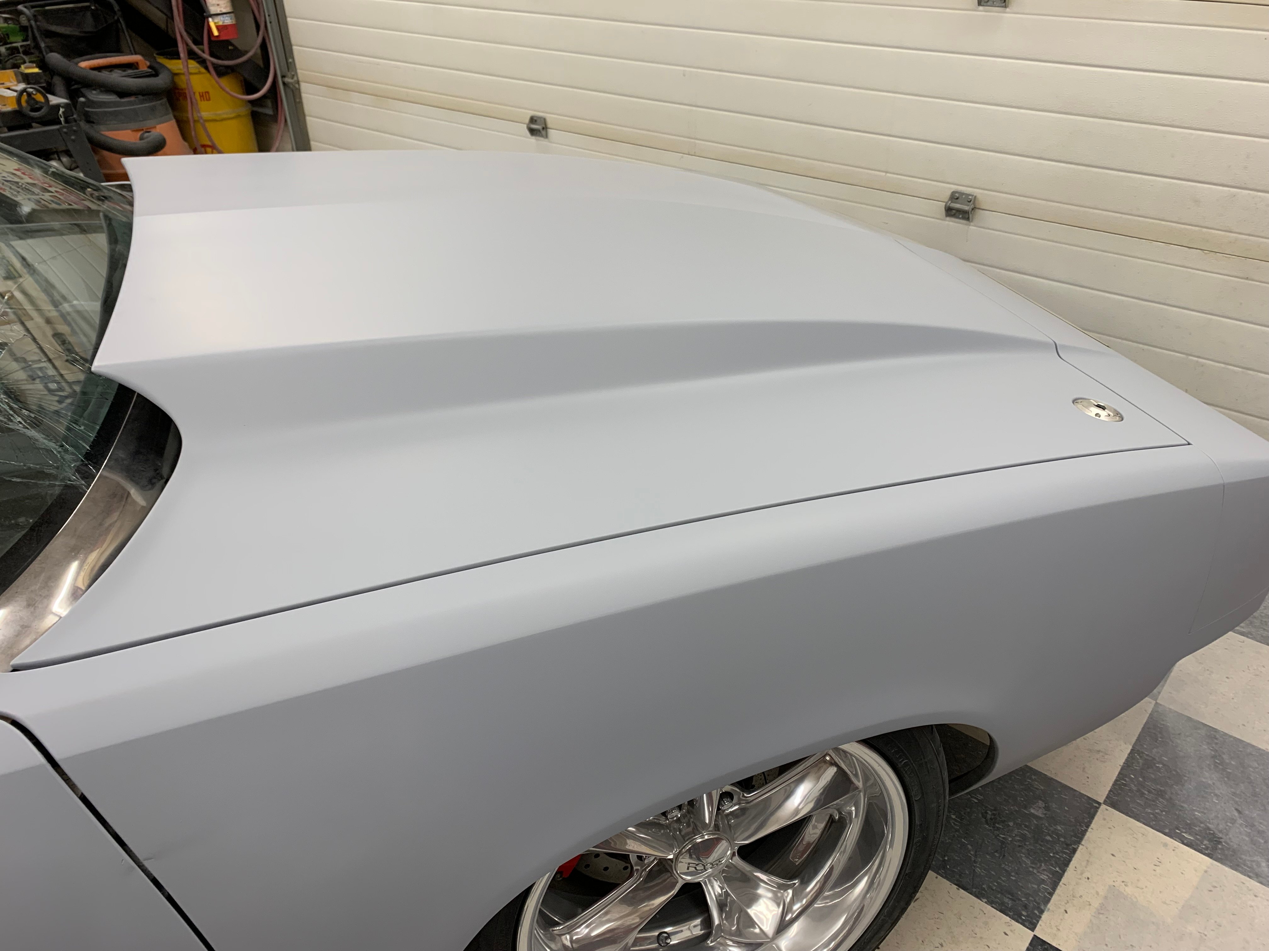

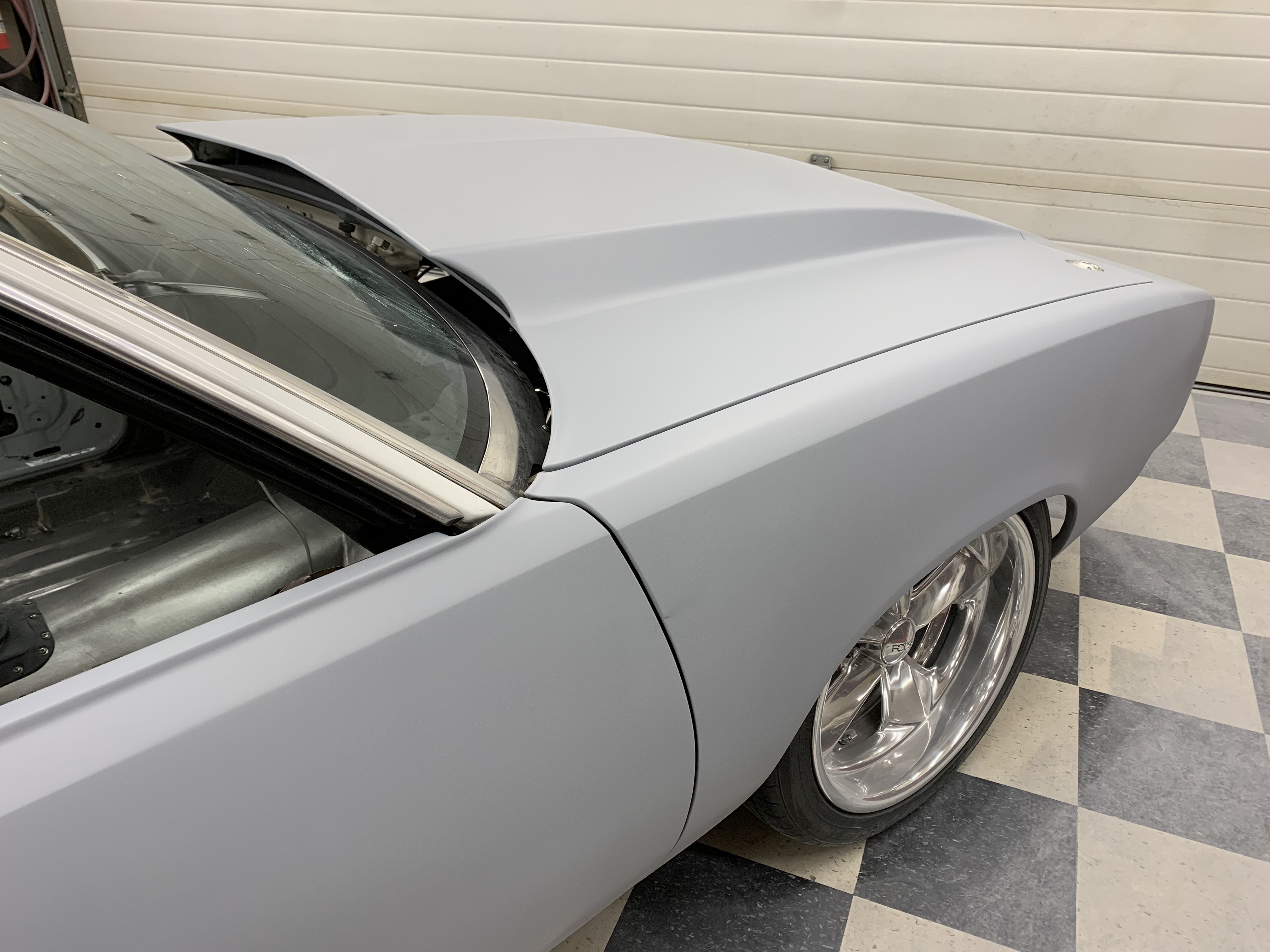

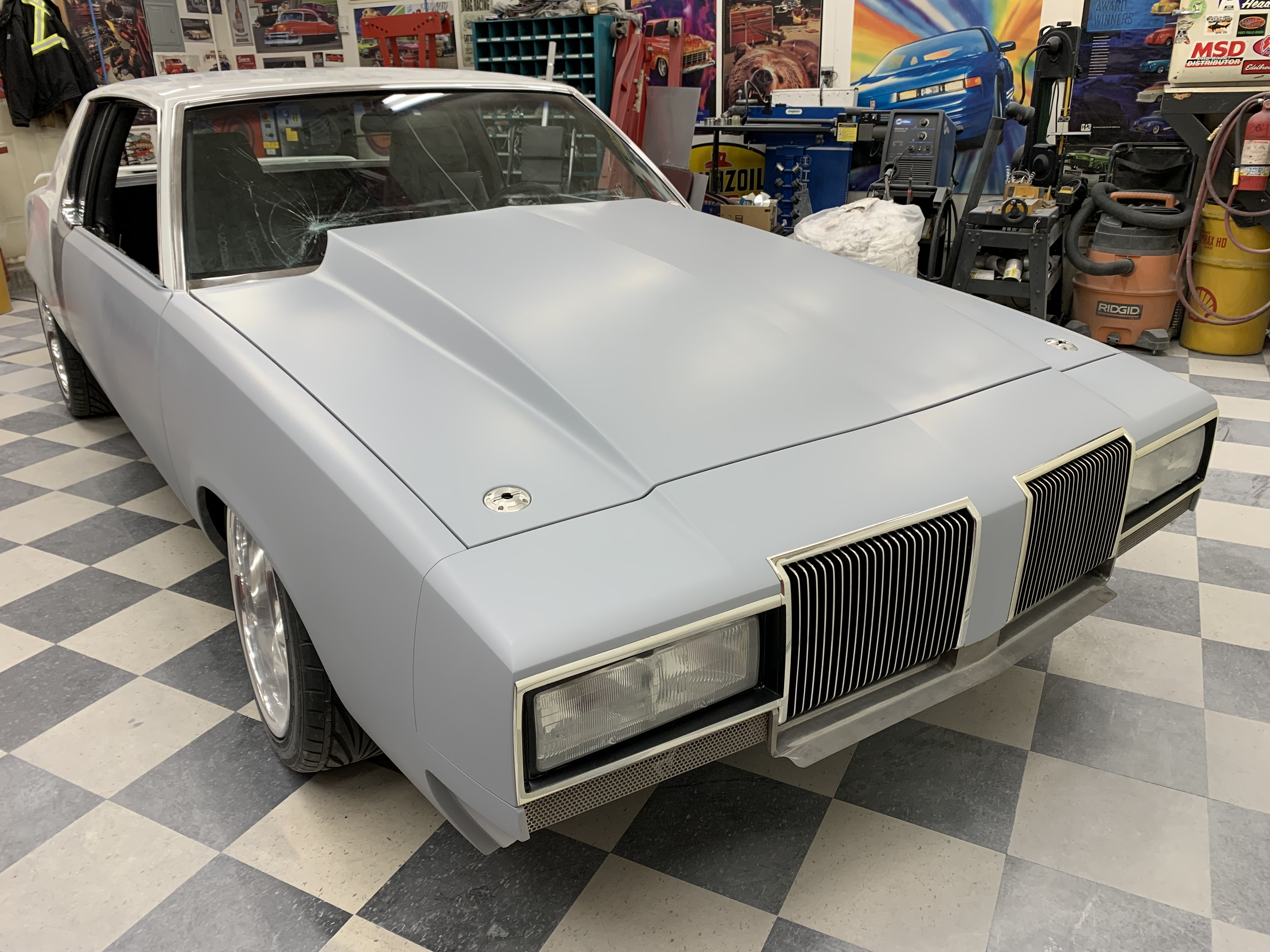

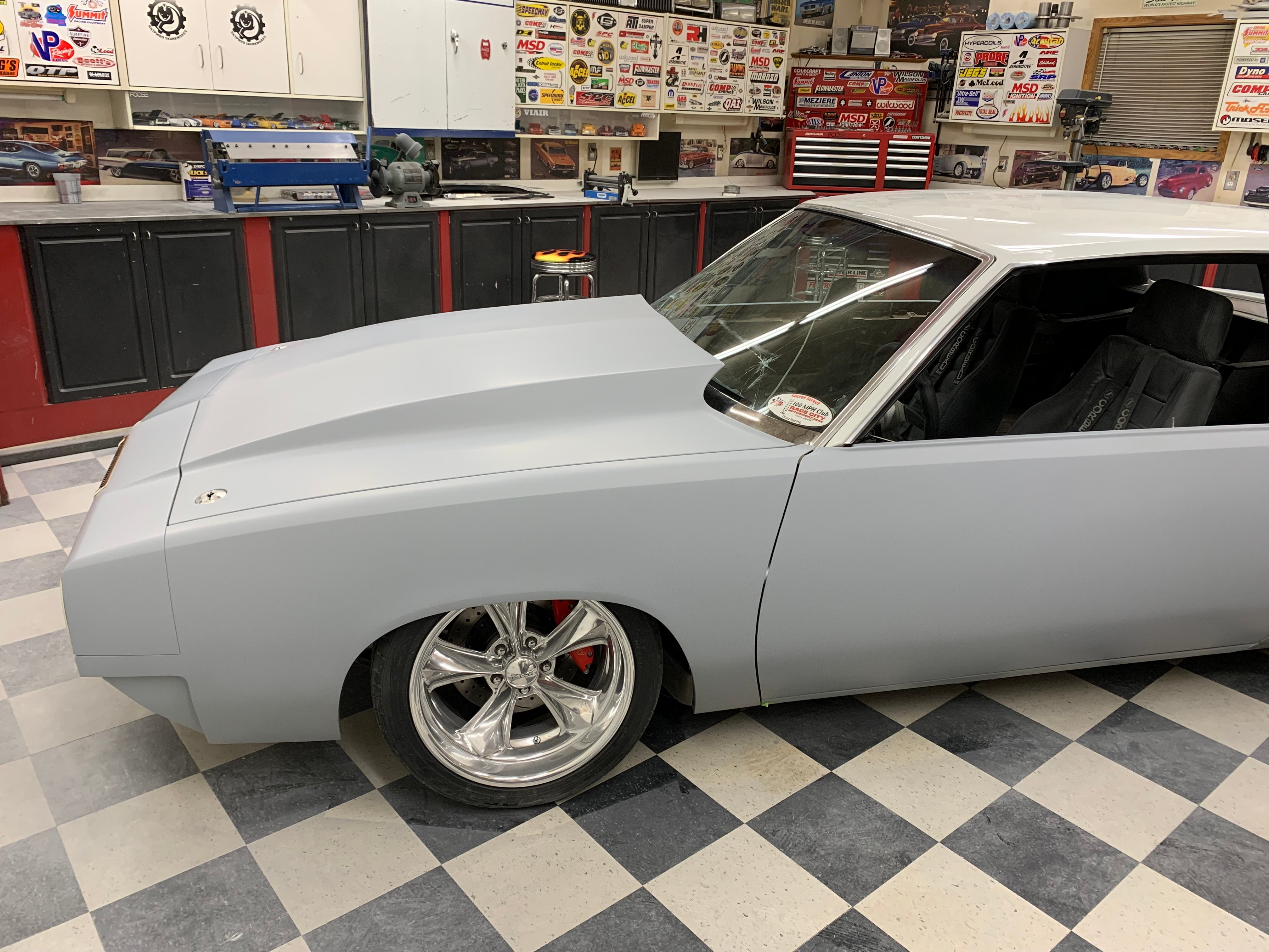

It’s almost anti-climatic at this point, but tonight I FINALLY finished the bodywork on the hood and header panel. It’s been an epic odyssey, taking the entire summer, plus September, October, and now exactly half of November.
But it’s done for now until final prep for paint.
Tonight I laid down 2 coats of epoxy primer, let it set for an hour, and backed that up with 2 coats of regular high build primer surfacer. After it cured for a few hours, I unmasked it and installed the grille, headlight, and hood pin jewelry just to get the full effect.
That’s it for words, I’ll let the pictures do the rest of the talking. Feel free to let me know what you think.
Oh, and btw, don’t mind the weird little something you see on the passenger’s side door and fender, I’m not done there yet. The fenders are going to receive a little something special next, so the bodywork isn’t finished there yet.
D.
Crisp. The hood looks like it was manufactured, it's so good. Awesome work, as always.
Terrible as always😉🤣🤣🤣🤣. Obviously just kidding, as I looked at the flap disc swirl marks I am going cover with more primer on my 70S. Is the rest just strip, level and prime or is there more custom touches for the Juggernaut?
Looks great. How bad are the quarters and deck lid? Although I’m sure you have some more custom work to do on the rear as well.
Thanks Chris.
Neither are bad at all, in reality both are very good condition for their age actually. But yeah, you nailed it, I have more custom touches planned for the rear. The quarter panels especially are going to be the most heavily modified and labor intensive to almost rival the hood.
Thank you Jared. That’s very high praise indeed!
Much appreciated my friend.
Definitely more custom to come. Starting almost immediately, I’m going to be carving into the front fenders again. But I assure you, it should be interesting and well worth it.
That looks just perfect. I cannot believe how great of a job you do. Are you a professional body man.
Thank you! Your comments really mean a lot and I appreciate them. I’m no professional, but I did stay at a Holiday Inn once. 😂
Seriously though, I do have formal training in automotive refinishing although I haven’t done it for a living for many many years. It’s relegated to hobby status now, on my cars and very good friends, and that’s the way I prefer to keep it.
The best way to enjoy doing bodywork, is to do it as a hobby. Or at least on your own terms.
I couldn’t agree more. No deadlines, no overbearing bosses, no micromanaging, no clock watching and no creativity restraints.
I could go on and on.
Of course if anything goes wrong, you’re the one responsible for correcting it, but that’s all part of the game.
