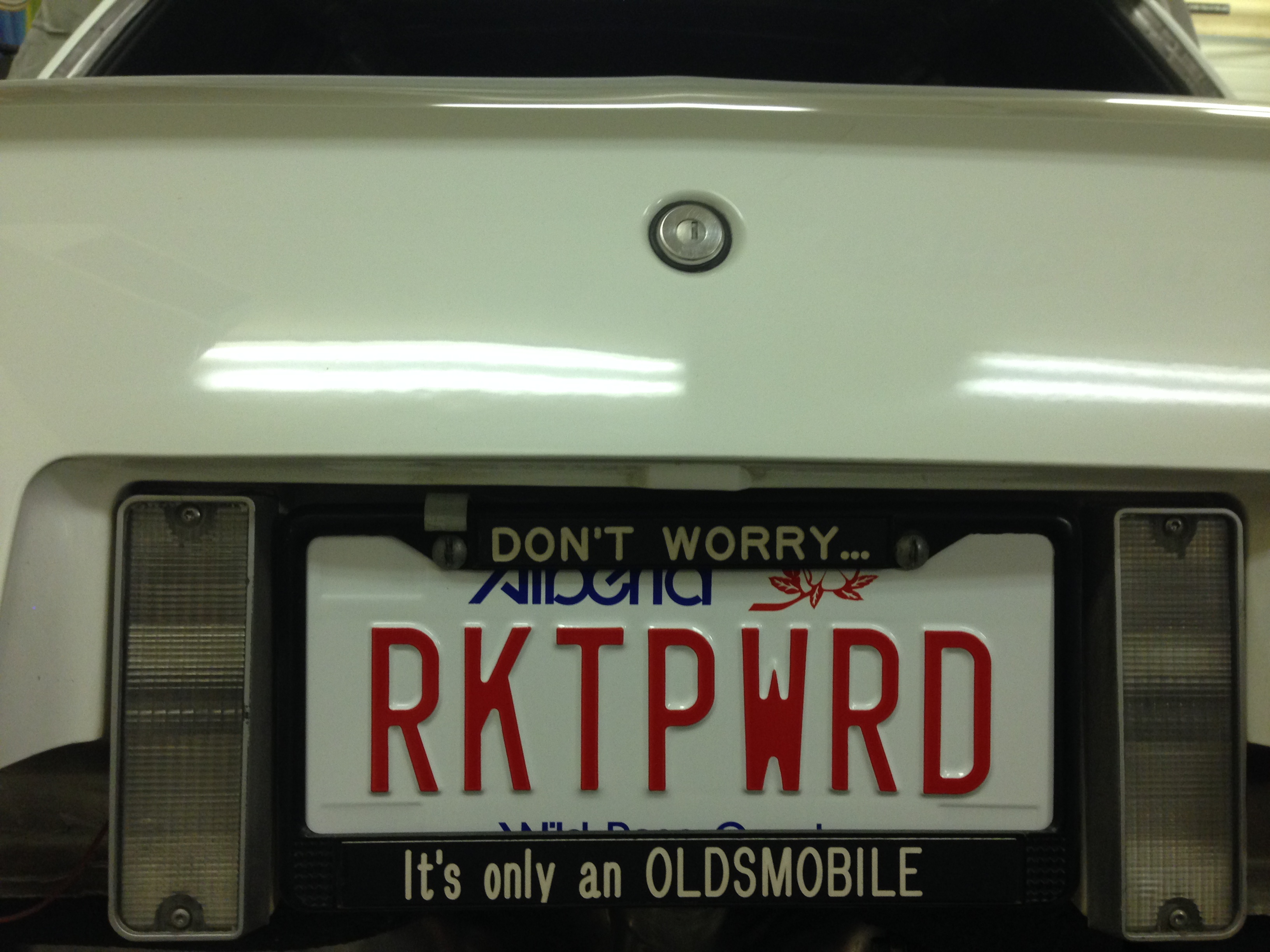

Just had this little gem show up in the mail today...
So now I guess it's official!
I am...
:mrgreen::mrgreen::mrgreen:
In case it wasn't already obvious, this is the plate I've always wanted for the Juggernaut, and refers to the 455 Rocket that powers it. It also just so happens to match my "handle" on here...
My backup choice in case this was already taken was "6SPDRKT", but this one was available so I went for it.
Completely frivolous and unnecessary, but what the hell! Just wanted to share, thanks guys.
Later, Donovan

Donovan, love the plate! I've been trying to think of something creative for years to have made for mine. However, here in KY i can put historic tags on the cutlass now, and i can modify it by paint matching it to the car without the law throwing a fit!!! As long as i leave one plate untouched (they give us 2 tags for historic cars, but we only have to use 1 of them).
Where did you get that plate frame at?
Thanks Scott.
I wasn't aware that you were allowed to paint match your historic tags down there, that's a really cool idea. Up here it's strictly a no-no, you're not allowed to modify any tags in any way.
As for the plate frame, I've had it for years and years now. There's a little story behind that as well.
I originally saw an old Hot Rod or Car Craft magazine article about a plain jane looking 421 Super Duty Pontiac that was absolute sleeper. One of the photos the magazine crew took was a close up of his plate frame that said "Don't worry, it's only a Pontiac!" I thought that was perfect. At the time, Oldsmobiles and Olds motors were considered to be kind of the "red headed stepchild" if you will of the performance world, and got no respect, especially locally around here.
So I figured that would be the ideal way for me to thumb my nose at the nay sayers and skeptics with my combination, good naturedly of course! It made at lot more sense to the competitors at the track when I put them on the trailer!
Lol
I had it made for me at the local World of Wheels show one year by a vendor (don't recall who it was now), but I think they've long since gone defunct. I haven't seen anyone making them anymore in quite a while.
Donovan
