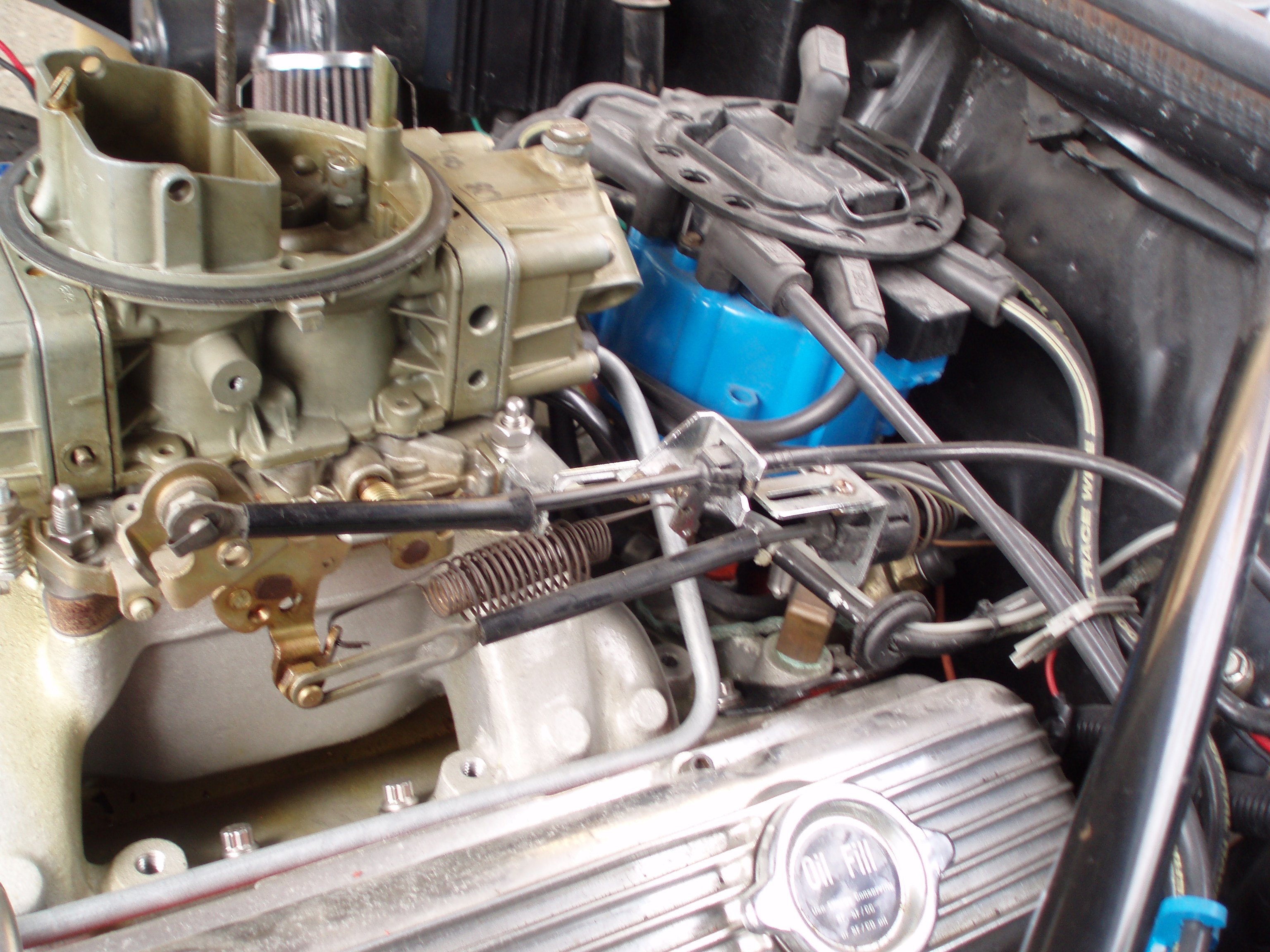

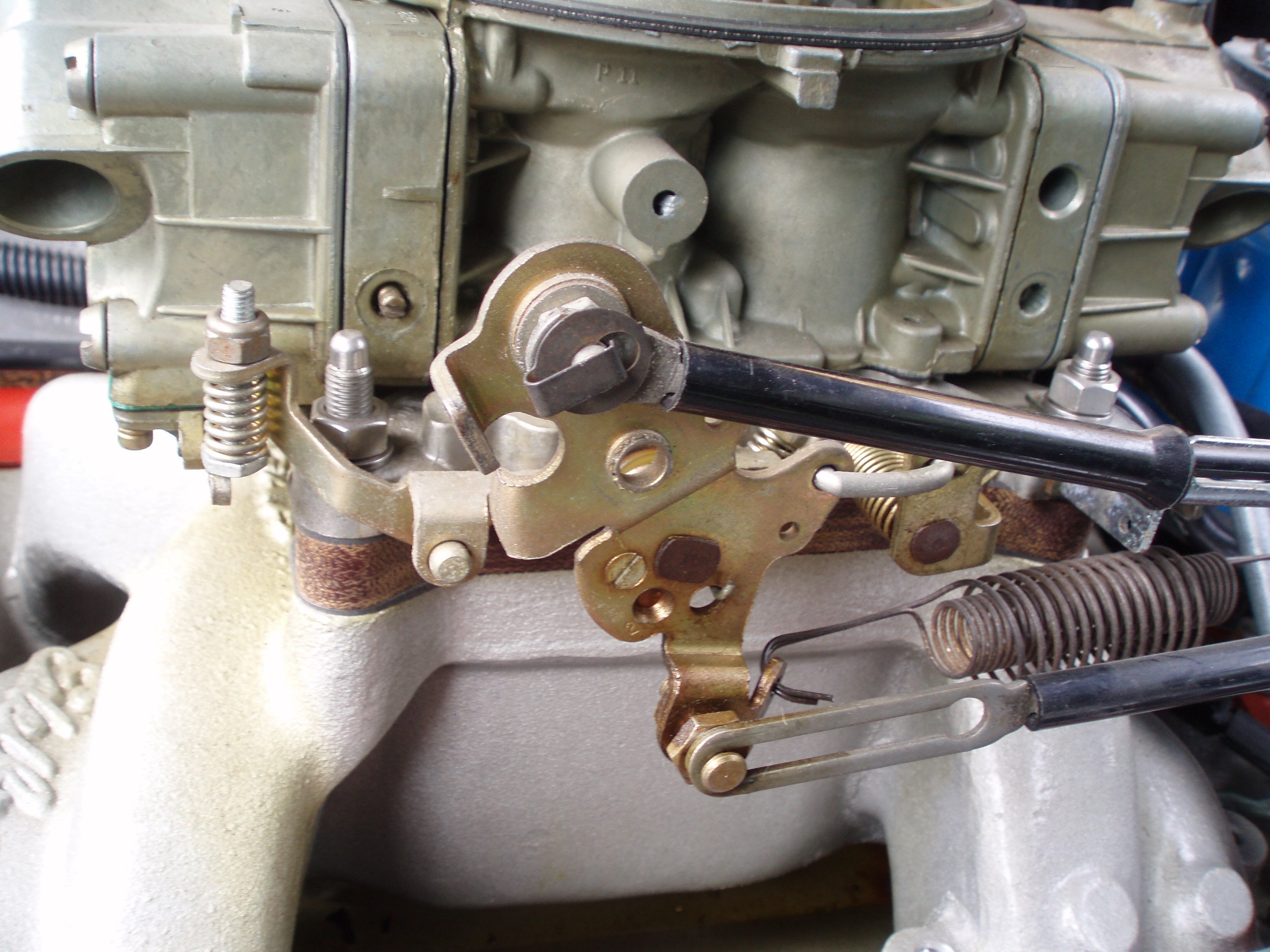

This is the set up I've had on my 406 Chevy in my 79 Monte Carlo for years.
Accepts the stock throttle cable and TV cable for the transmission.

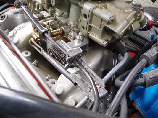

For small blocks I have always used this one.
Completely adjustable
