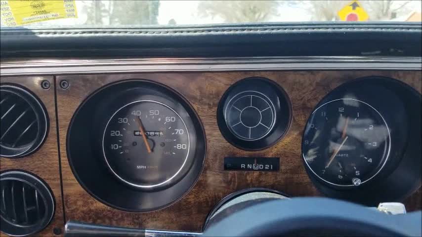

After crunching some numbers , I think I figured out why this thing eats convertors. with this bonneville salt flats inspired 2.41 gear I seen the engine RPMs at 65 mph is only 1282 rpm and only 1068 RPMs at 50 MPH LOL so he was more than likely driving it around town in OD just lugging the sh*t out of the engine. So the 3.42s i pulled from the S10 will be a welcome relief for the transmission.
