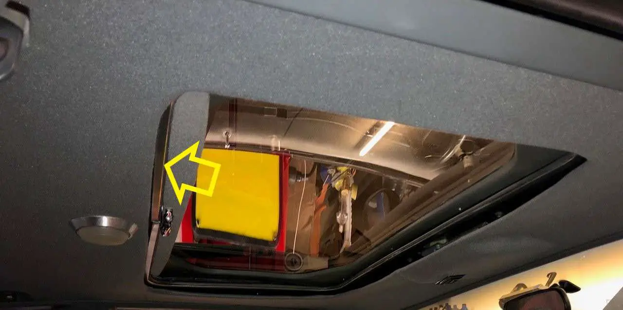

My headliner was everywhere, and I ruined the stock thin foam piece that the headliner glues to during removal, so I bought a new setup of ABS plastic from Highway stars, and the headliner sags in the front near the opening. I'm not sure what I did wrong, but maybe there is a piece I didn't get right or put back together correctly. Take a look at pics and share your thoughts if you've done headliners before

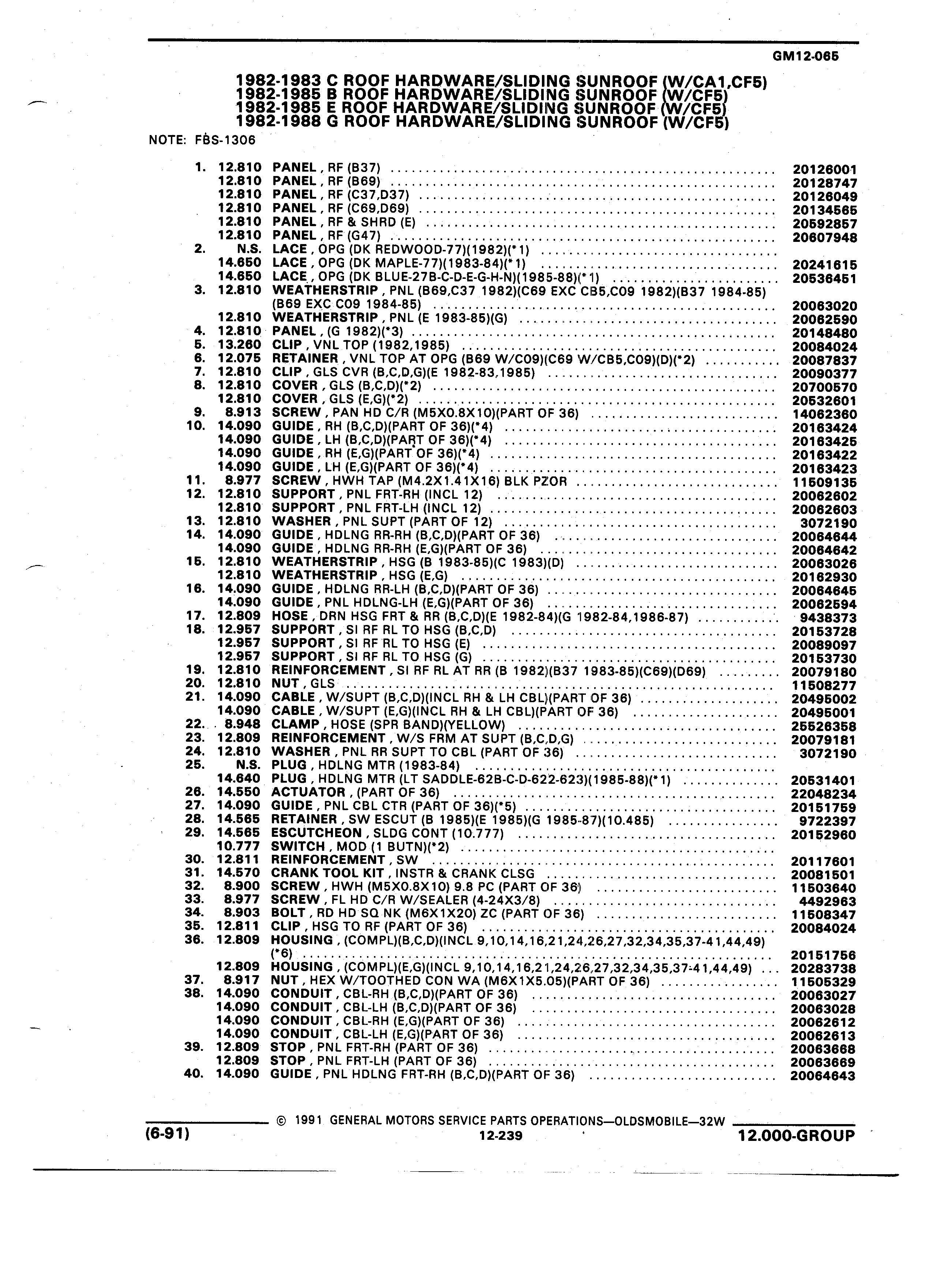

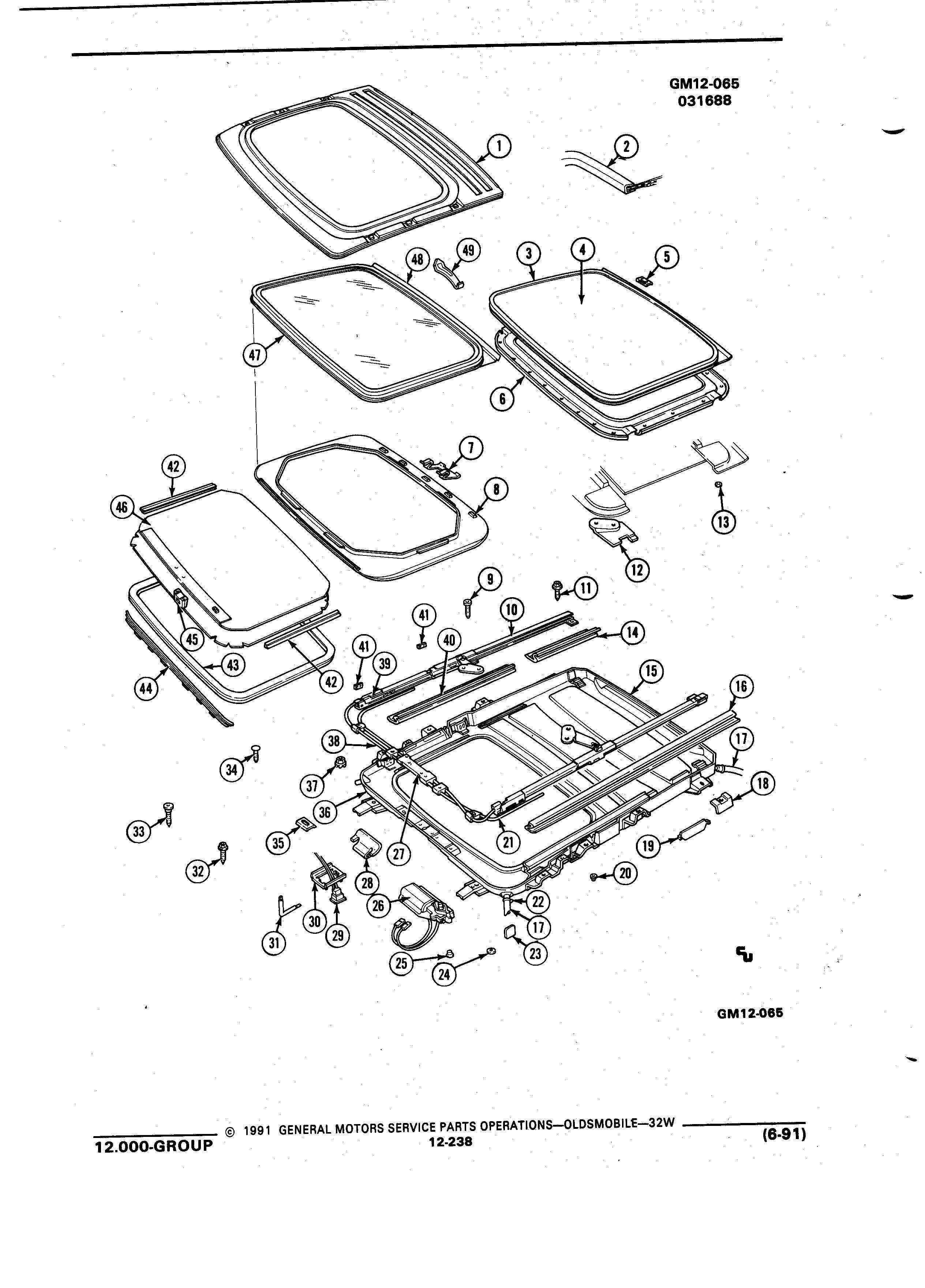

The black Retainer with the arrow pointing to it, needs to come off before the headliner is installed. It is what supports the headliner.
See number 43.
Edited to add: also see number 14, 16 and 40 the Guides for the headliner so it does not bind up the window.
