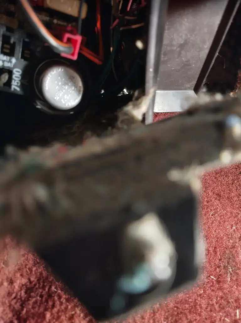

Went ahead and extended the original wiring for the Turn Signal Flasher from behind the radio, over to the open unused space on the Fuse Block. I don't know when or why they moved the Turn Flasher out of the fuse block and just hanging off the dash harness but I like it better in fuse panel for easier access. To be honest, it's not like flashers go bad all that much so it was probably a waste of time, lol.
I'm guessing the metal retaining clip on the metal frame of the dash maybe made it sound a little more tickety ticky, and louder but I never cared how loud or quiet the flasher was.
