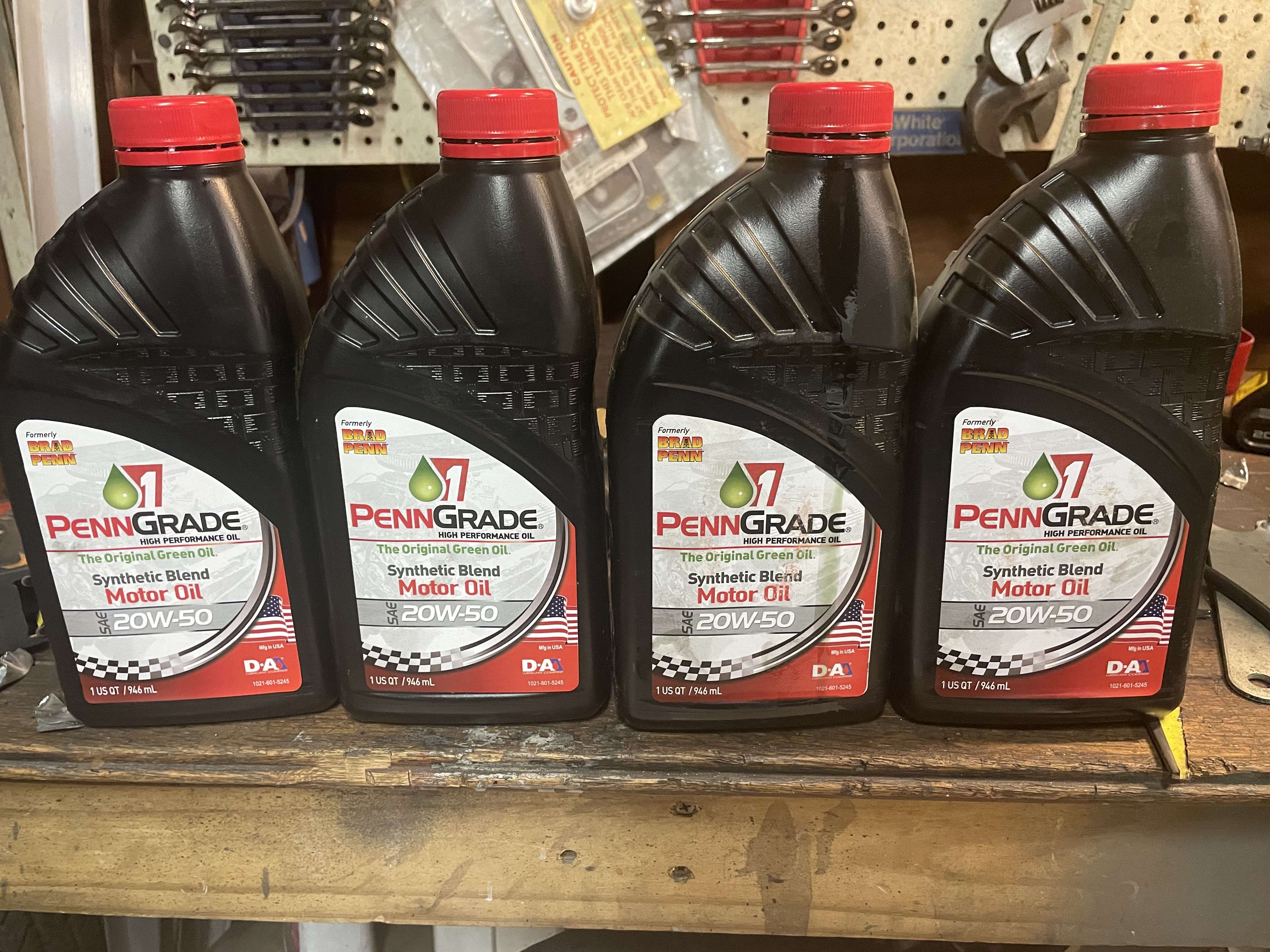

I’ve dove into the deep end. From $22/5 quart Amazon oil to $100/case. I guess I’m going to show this beech some love (against my better judgement.)View attachment 215221

Perhaps. It made it through 15 dyno runs at 6500-7800 and never let out a peep. I figured I ought to give this dog a bone.

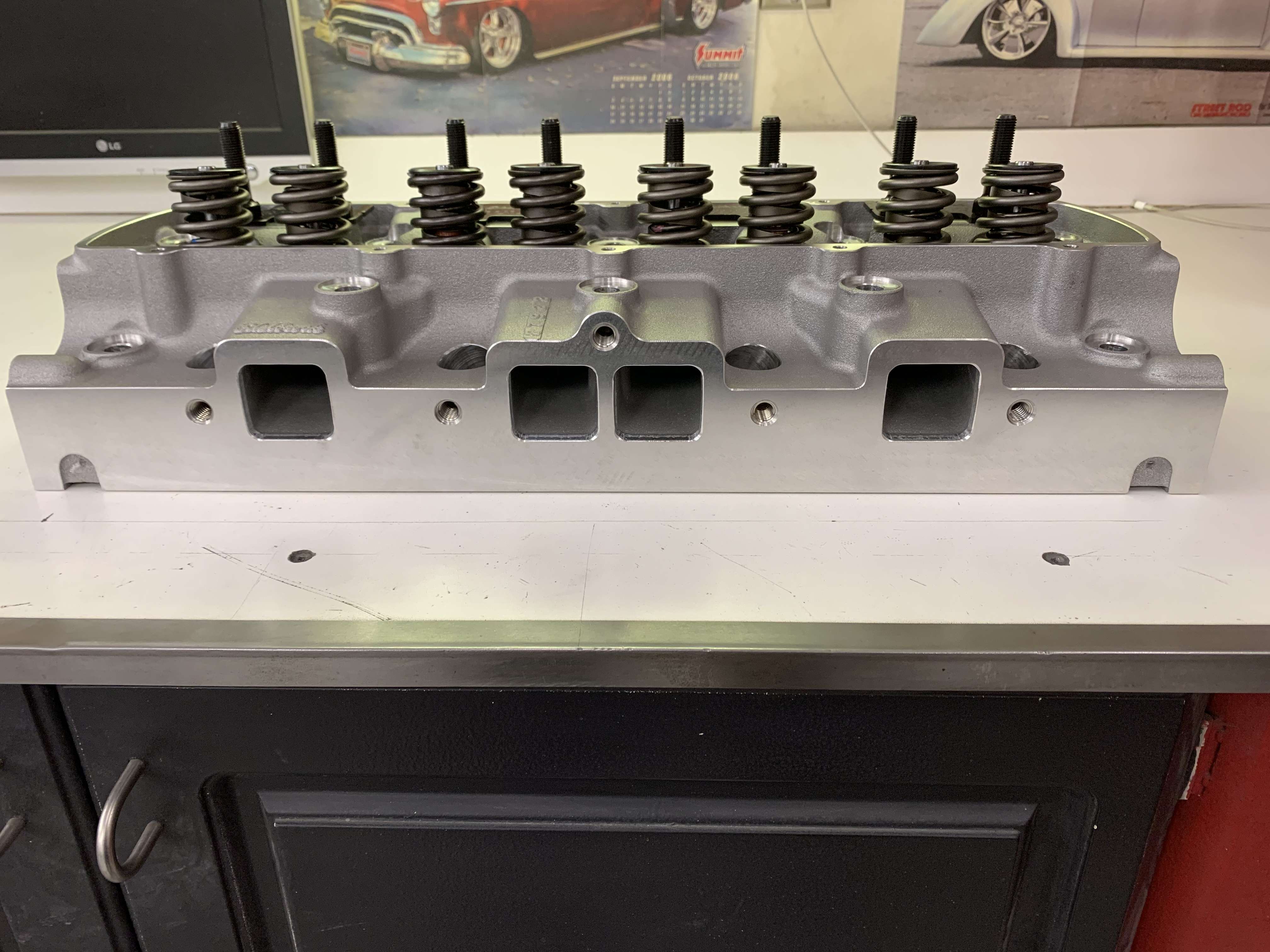

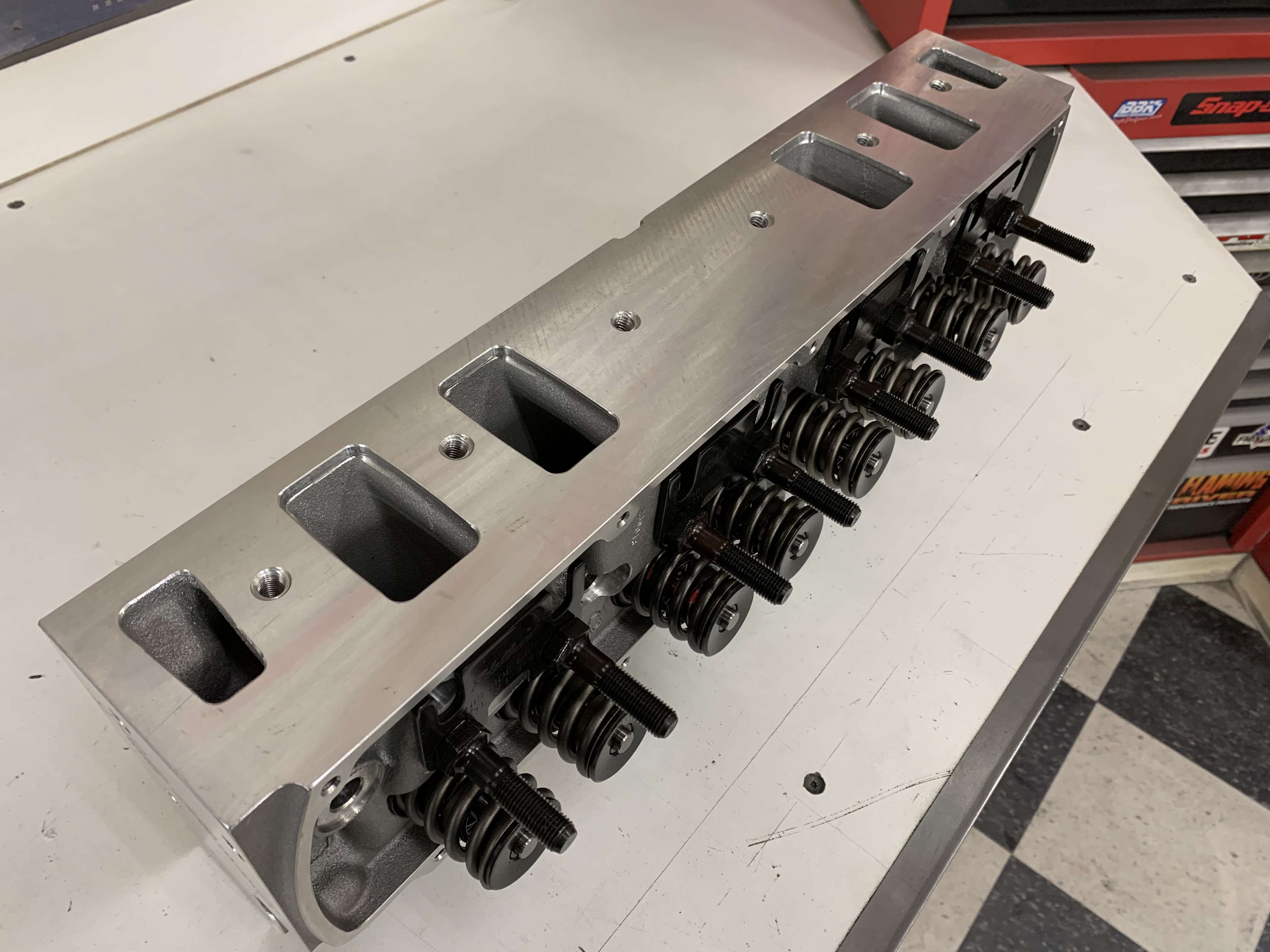

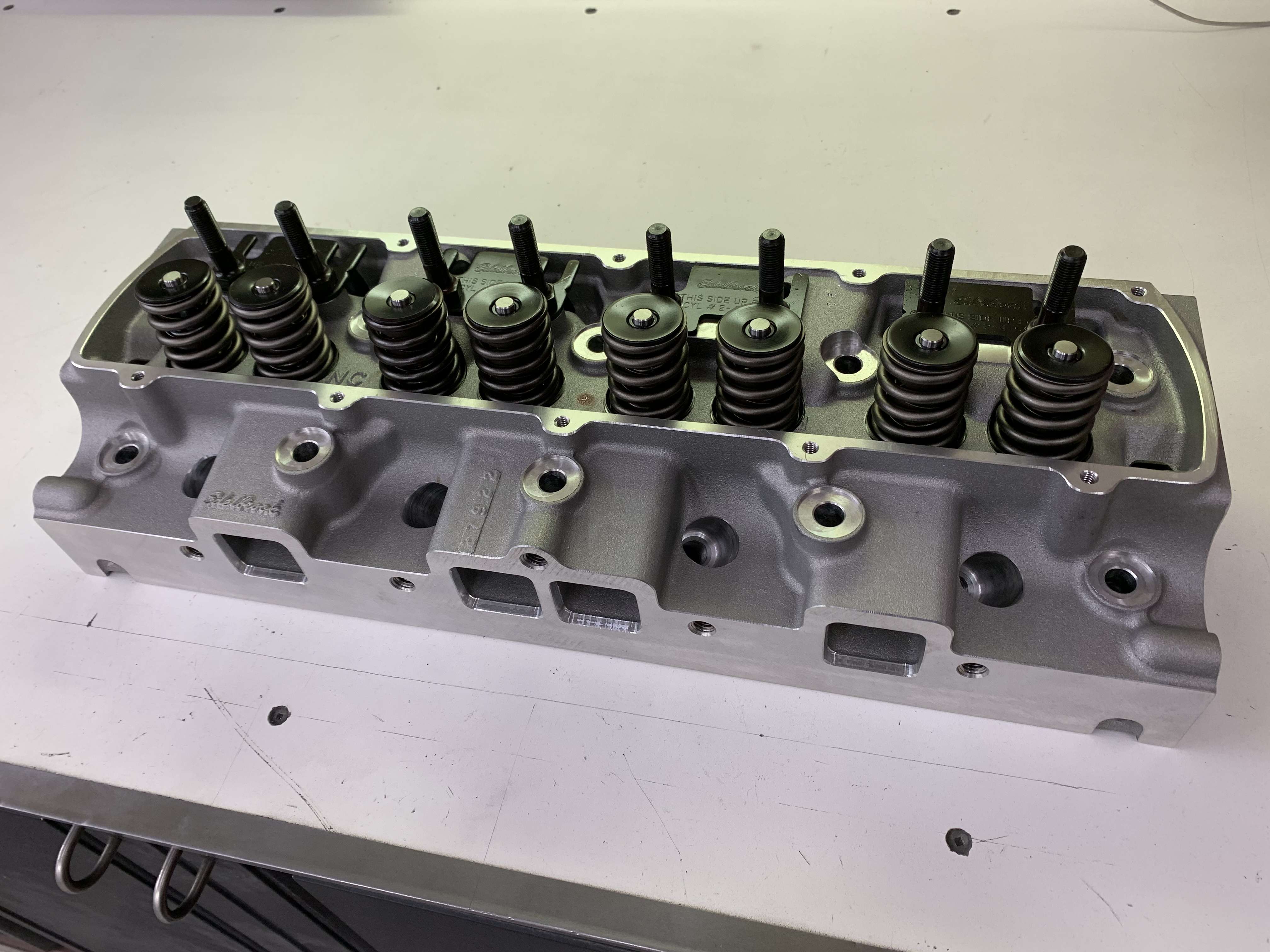

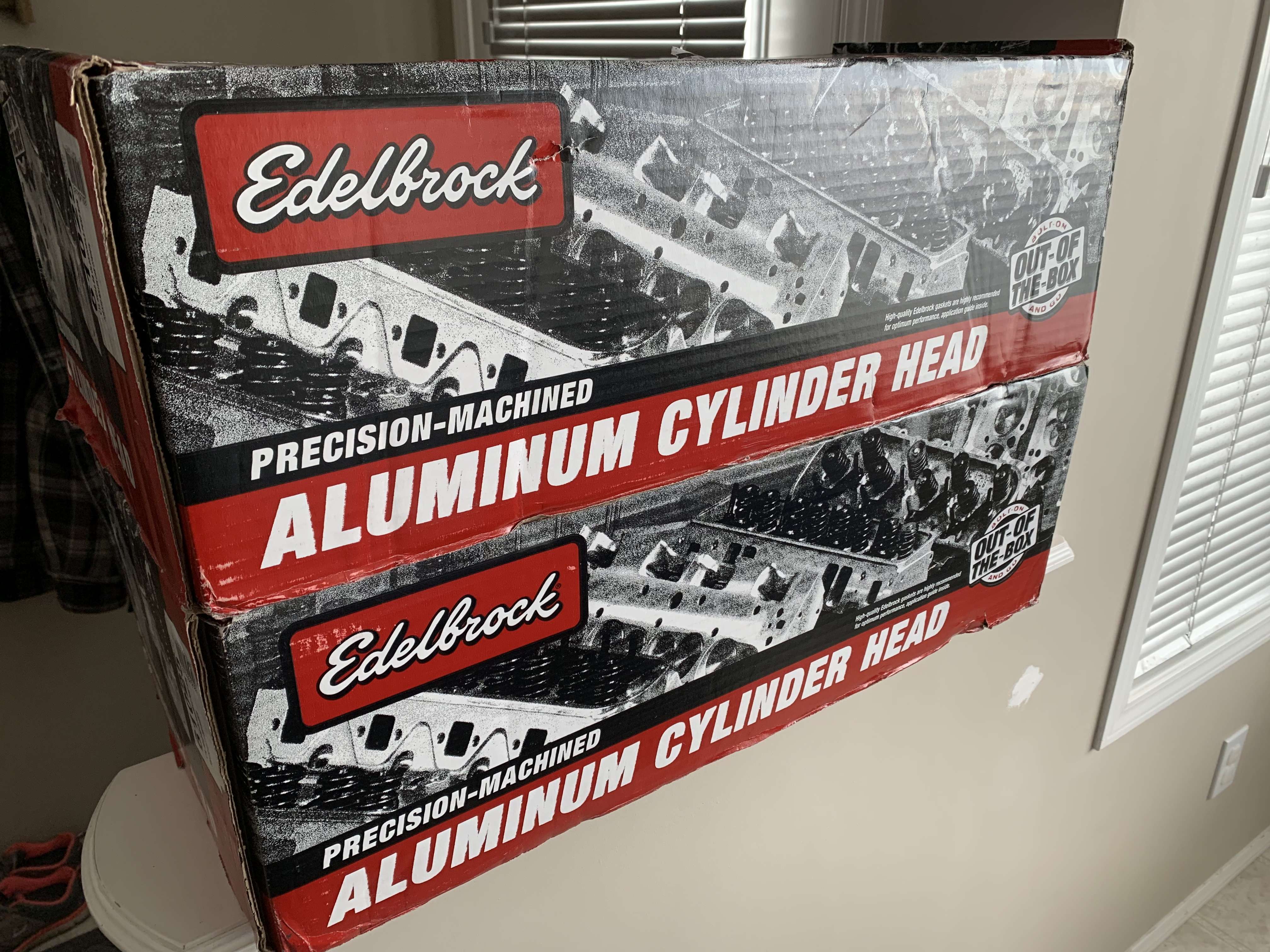

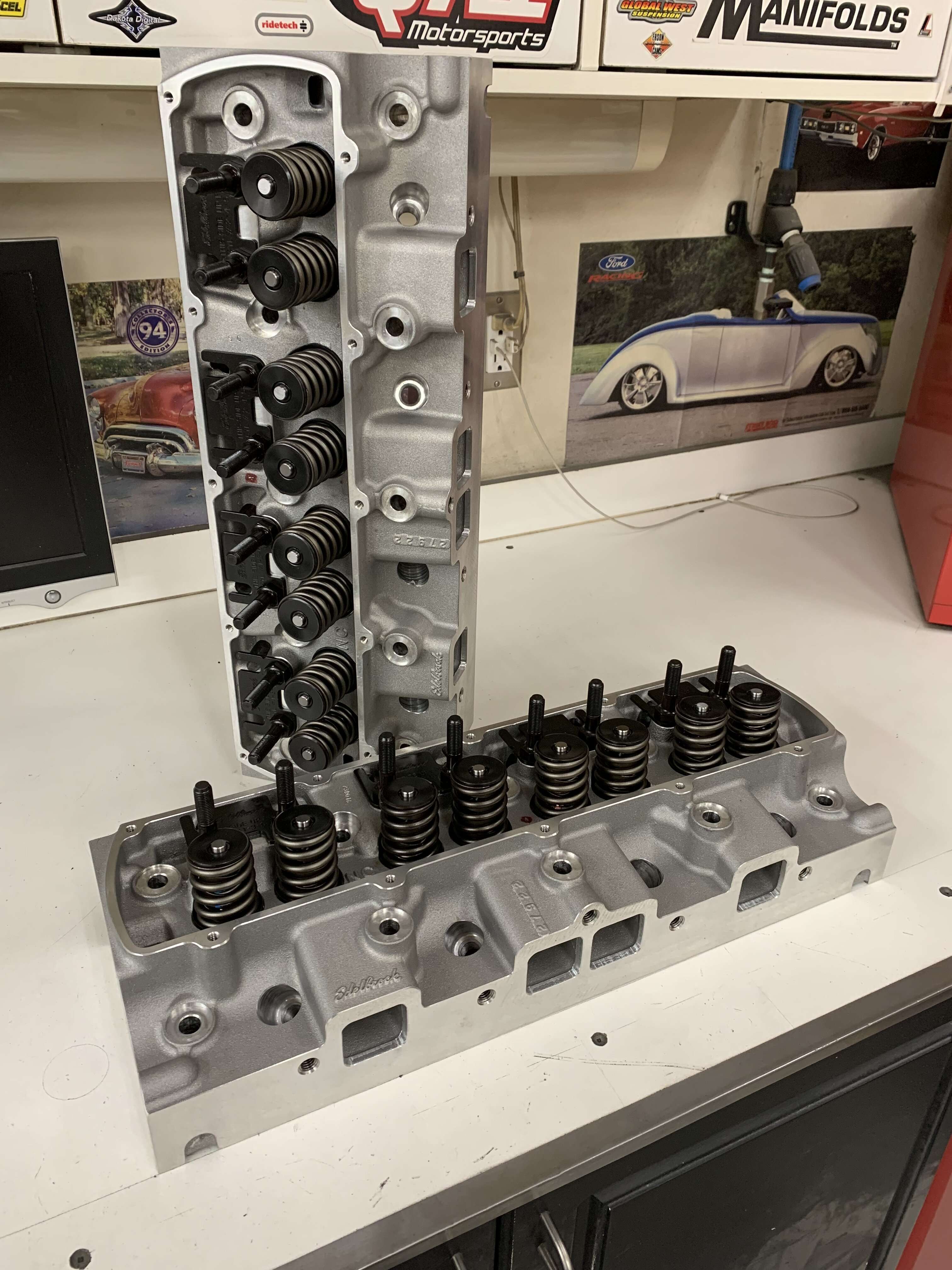

Cross-posting here (is it even considered cross posting if it’s from your own build thread?), but I don’t care. After 20ish years of waiting and wanting, the day is finally here.
Big block Olds aluminum cylinder heads, the newest redesign with all the upgrades.
If you’re a performance Olds guy, you’ll understand these improvements.

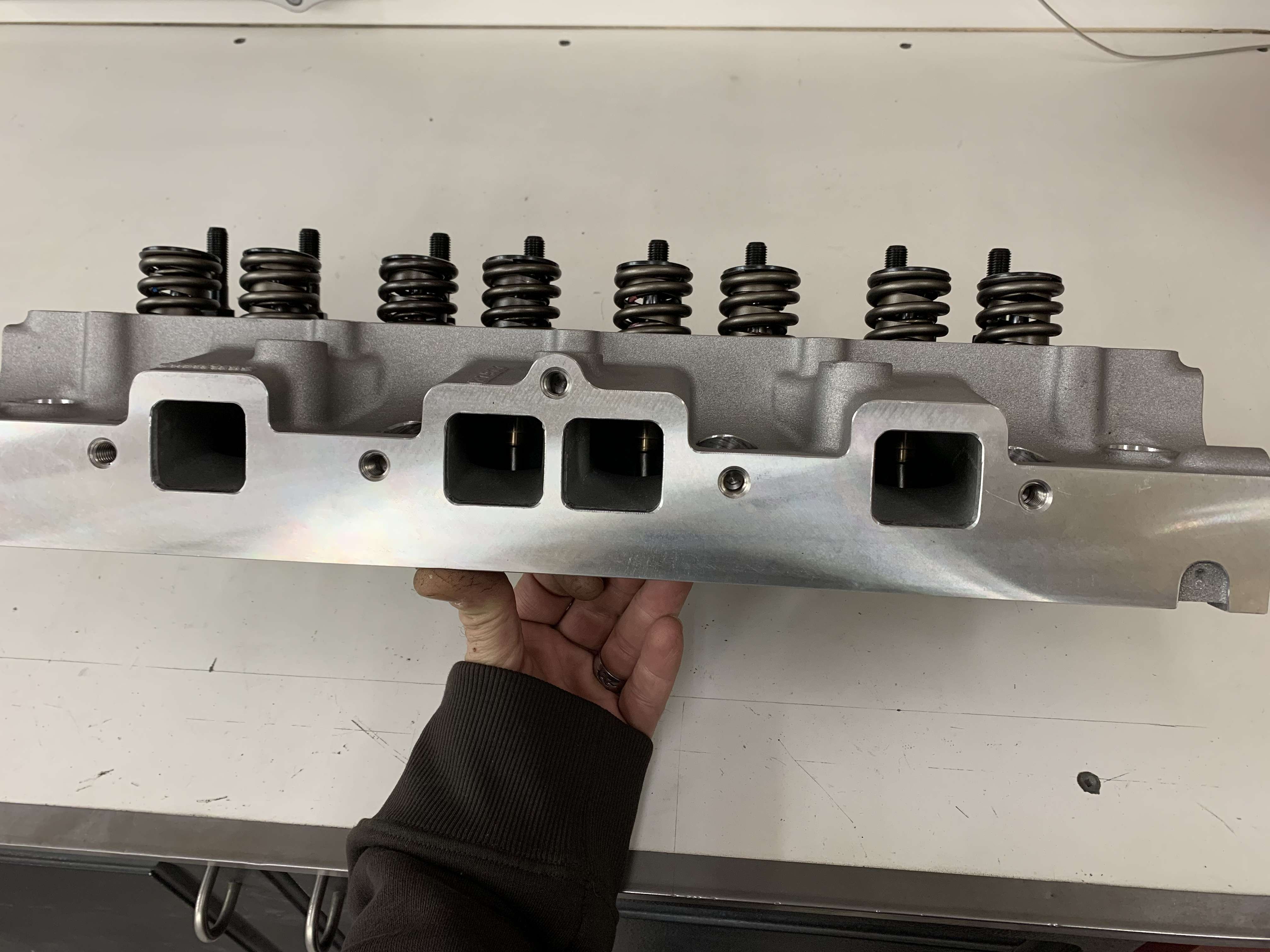

Actual proper fully divorced center exhaust ports:
Relief pocket for mechanical fuel pumps:

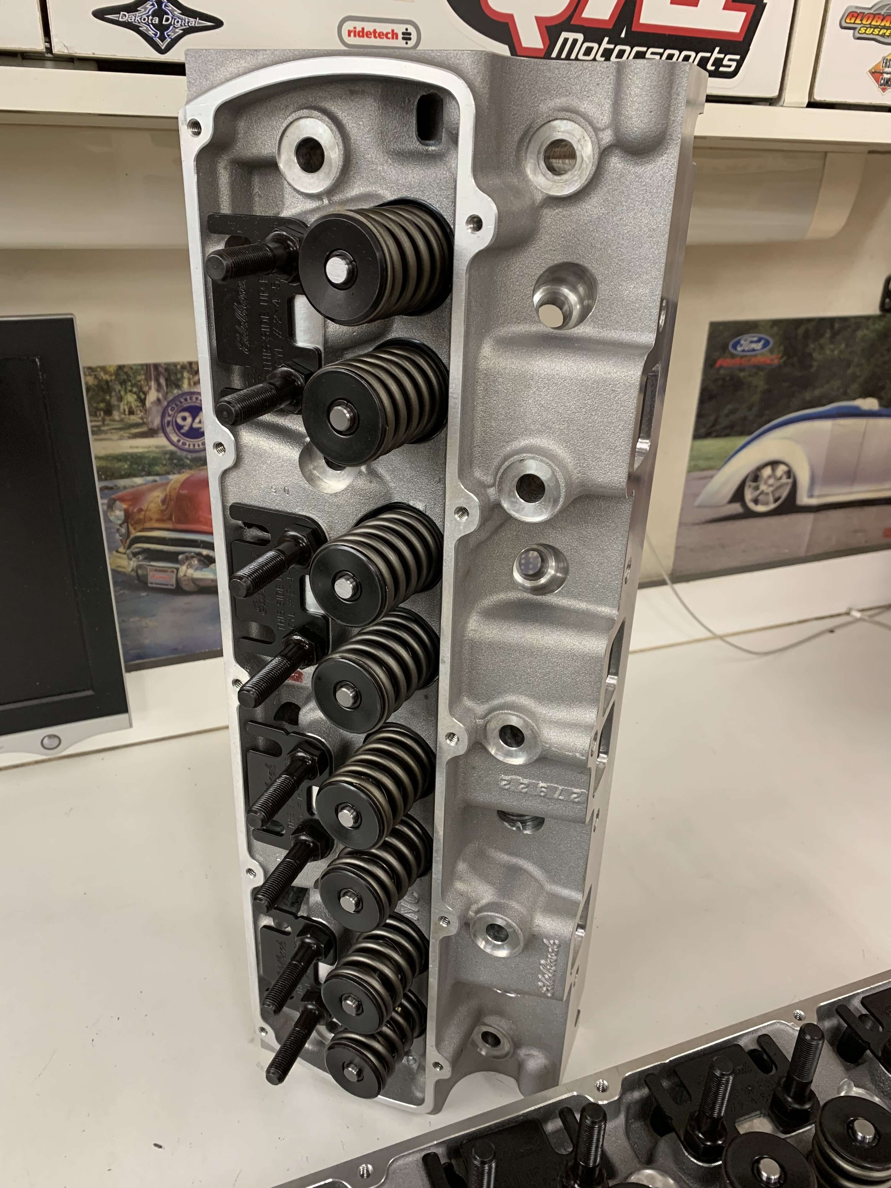

Fully assembled, ready to run with valves, springs, keepers, locks, seals, guide plates, and screw-in 7/16” studs:

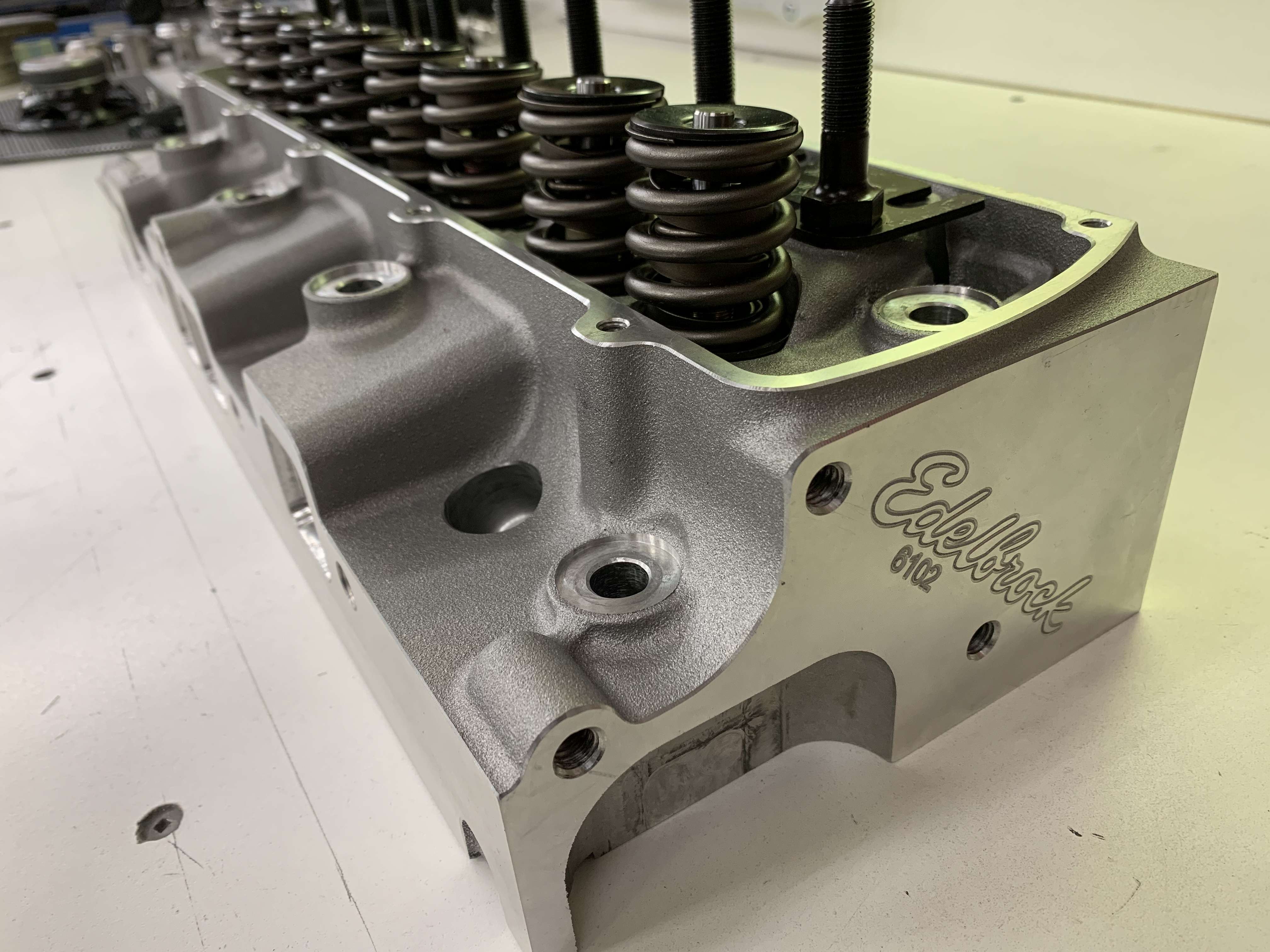

Heat riser crossover passage eliminated, and raised intake runner floors for a better shot at the valves:

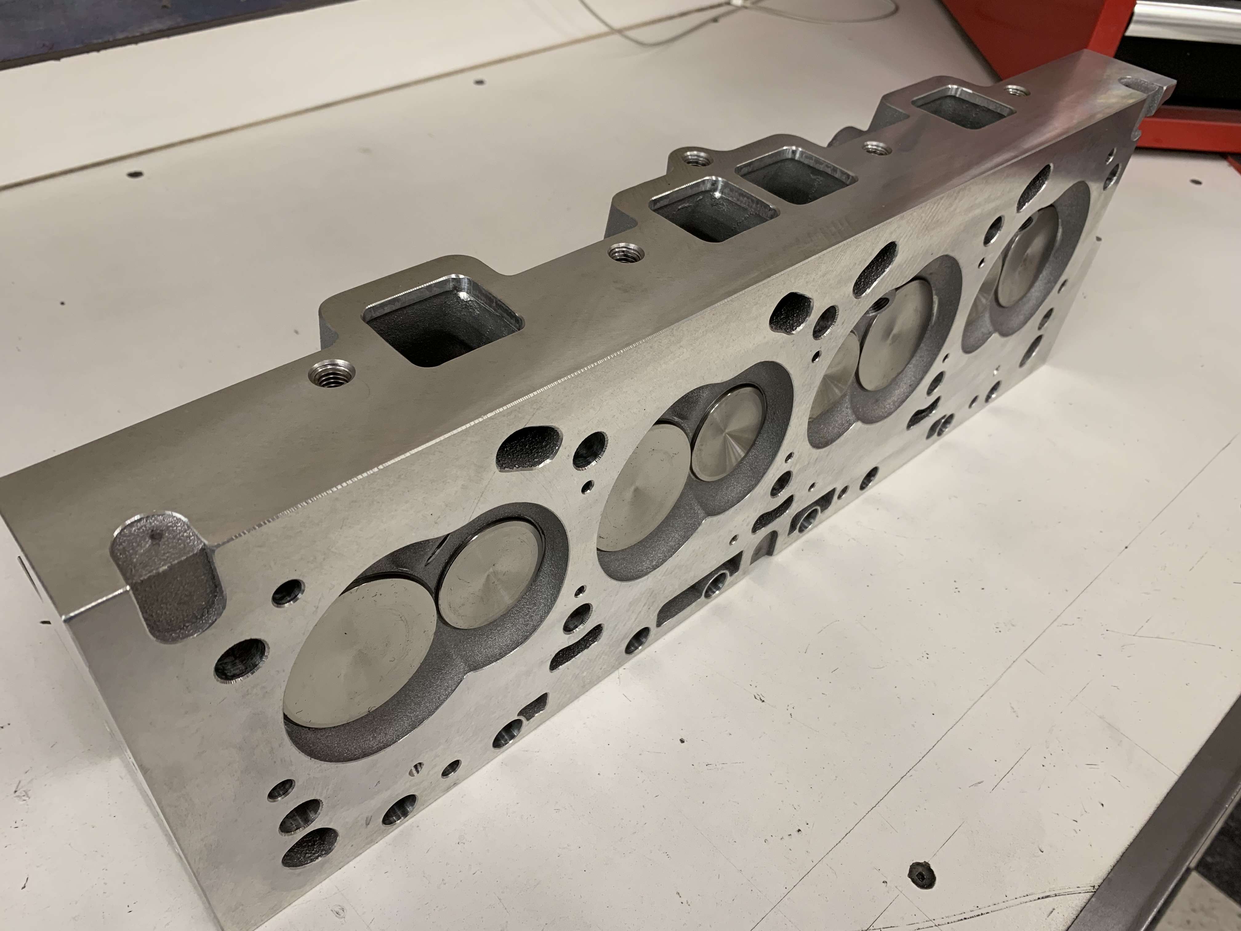

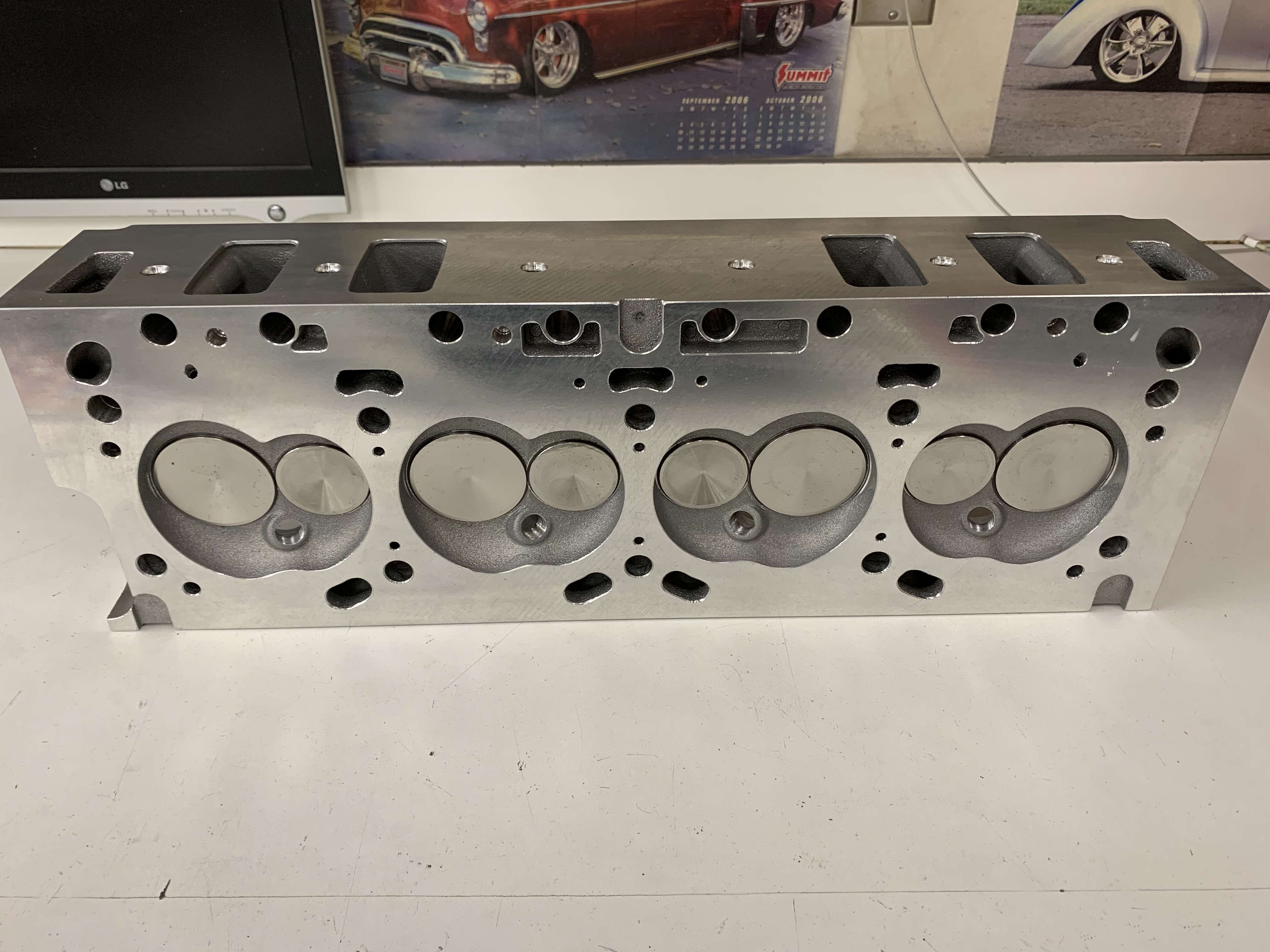

Improved smaller heart shaped 77cc combustion chambers:
Spark plugs angled towards the intake valve:
And weighing in at only 37lbs each, fully assembled. Compare that to 99lbs bare for a factory cast iron head.
I’ve officially died and gone to gearhead heaven.

I hear if you leave them lying around 565bbchevy 's garage, he picks up and polishes anything aluminum he gets his hands on. Just go back for em in a few weeks.
