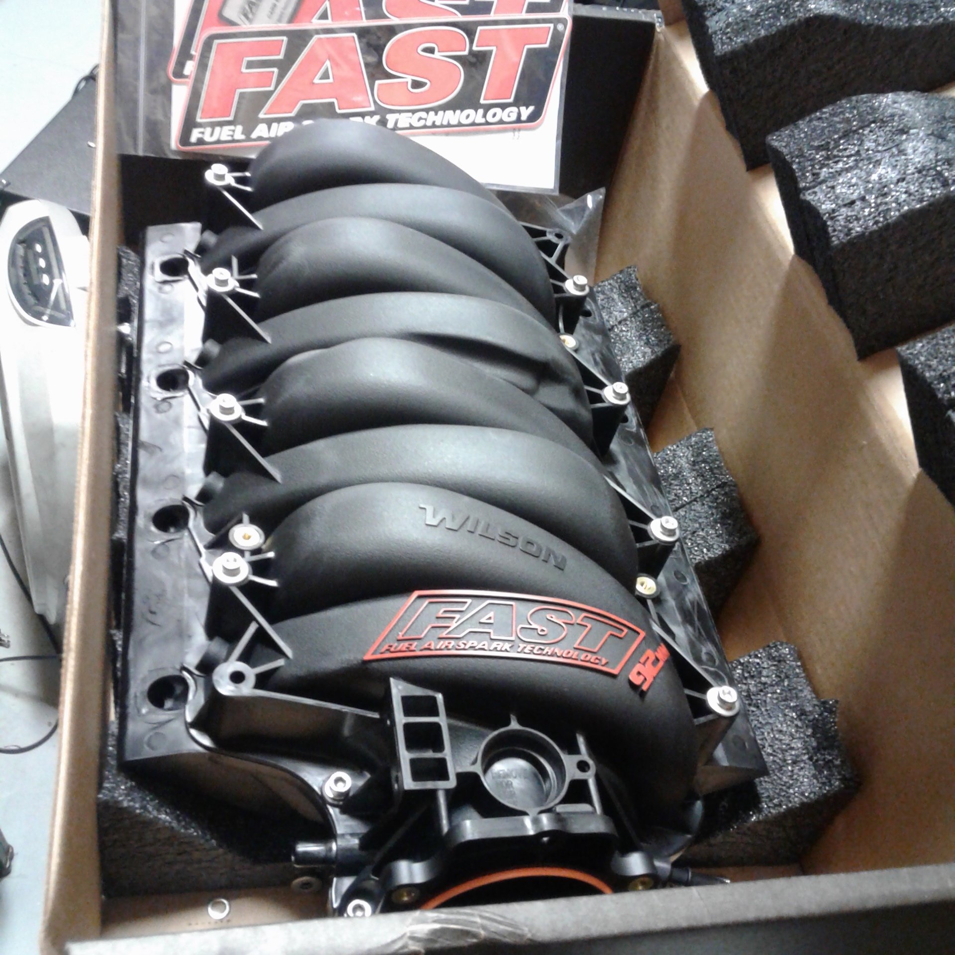

Got my rods back from the machine shop. Reconditioned and new pistons. Popped one in (sans rings, feeler gauges to center piston in) and came out to .0945 in the hole. That with a .042 headgasket will give me 9.69:1. About the limit on pump gas with how dumb of a design factory heads are what with their 55cc open chamber. Gonna use the same model cam I used before, but retarding it to 0*. Worth about 20-30hp. Also bumps DCR down to 7.45:1 by retarding it. (7.67:1 at 4*) so i could easilly run mid grade if i wanted/had to. Curious to see how much more, if any, power this engine makes than my old one. It's basically the same build but with a tighter bore (about 30k less miles), cam retard, and will have headers by the time I dyno it. Oh, and the AL intake. And not a 10.8 afr. And more than 30* of timing.
