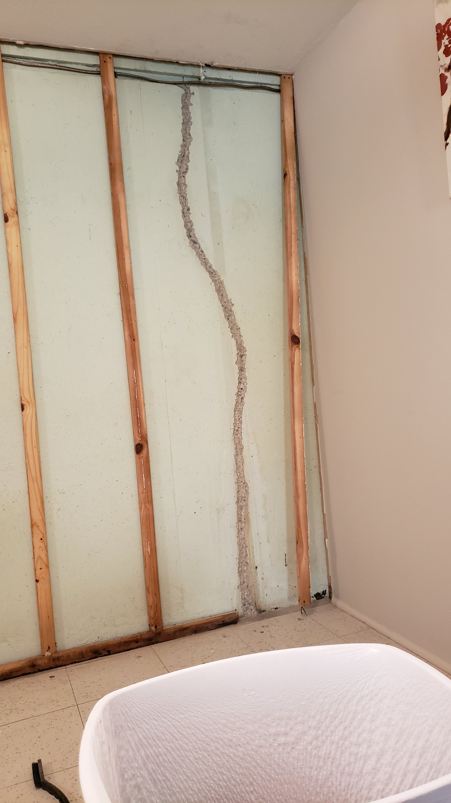

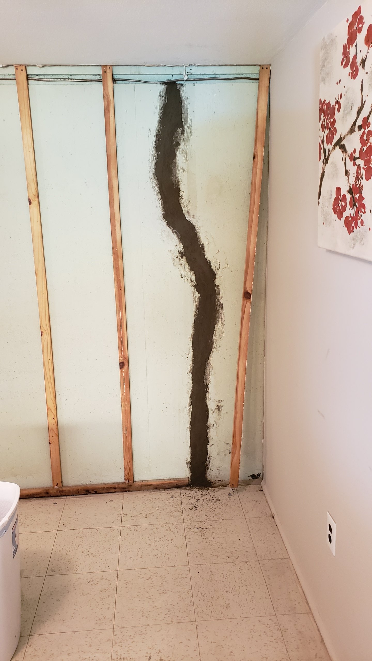

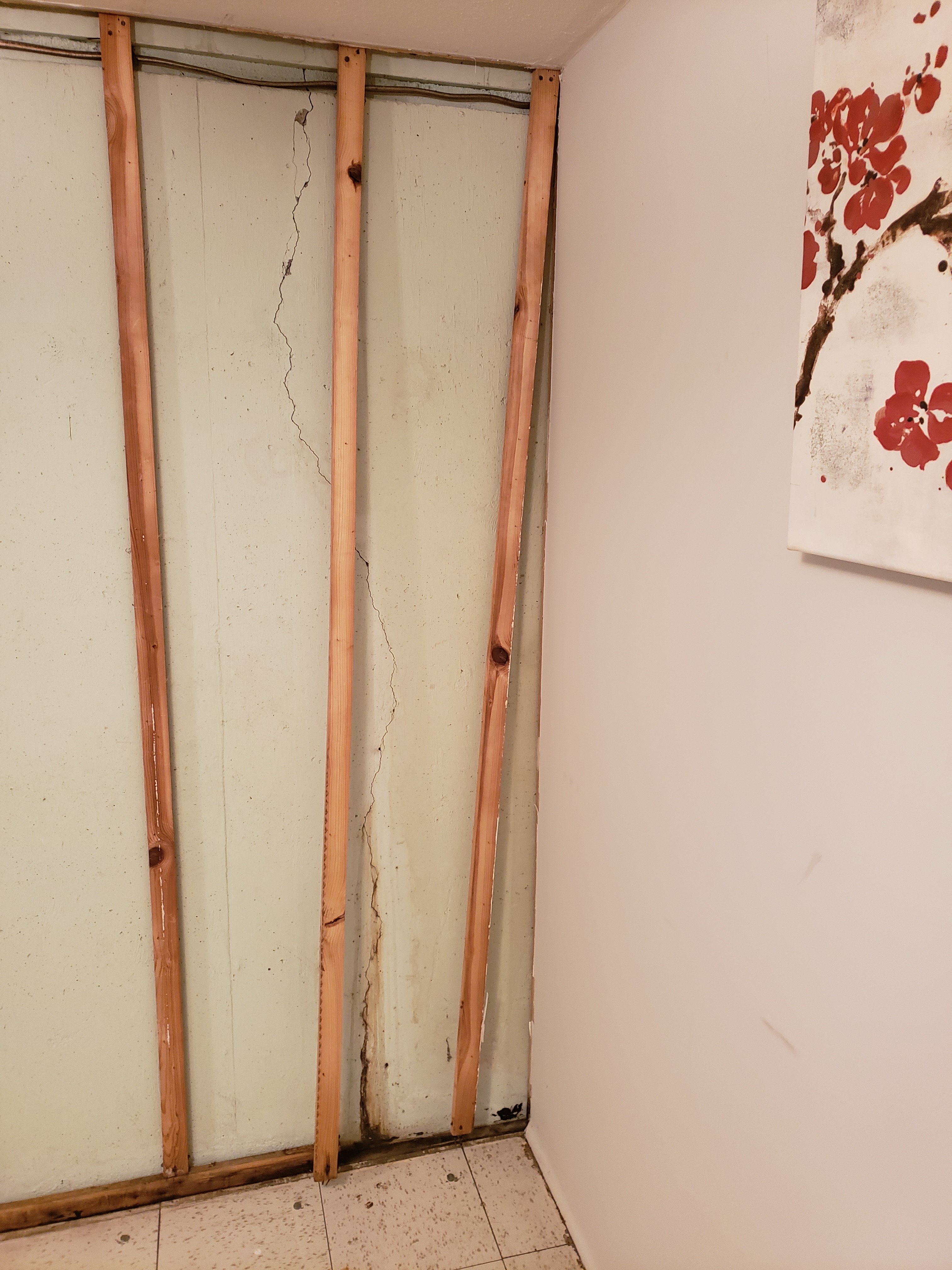

More house fun. Since spring time if it rains really hard we would get water in our basement. I knew it was inevitable we'd have to pull paneling, but have been hoping it would just quit lol!
Thursday it rained really really hard to the point the gutters were overflowing, and water showed up again. Sooooo, the wife pulled a couple pieces of paneling yesterday after I told here where the leak might be. Sure enough, small crack running all the way down to the floor.
This morning I got to it with a hammer and chisel, and opened up the crack for the hydraulic cement to adhere to. We mixed up a couple small batches and got it done. Hopefully it works,but have some wood and paneling to replace now yippee!!!View attachment 153415View attachment 153416View attachment 153417
Keep an eye on that. If it cracks again, you may need to see if the foundation is settling, or the ground below is moving.
