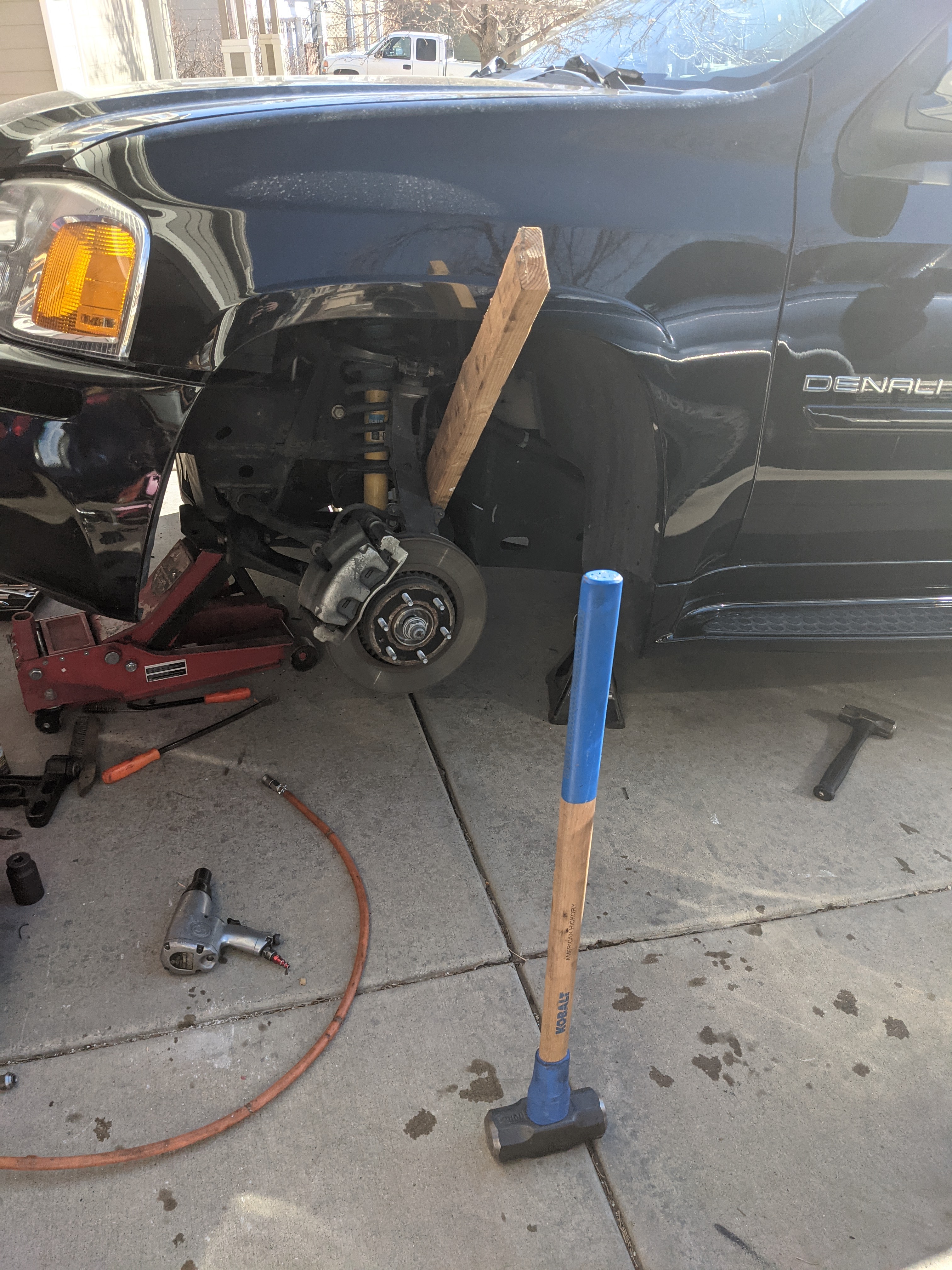

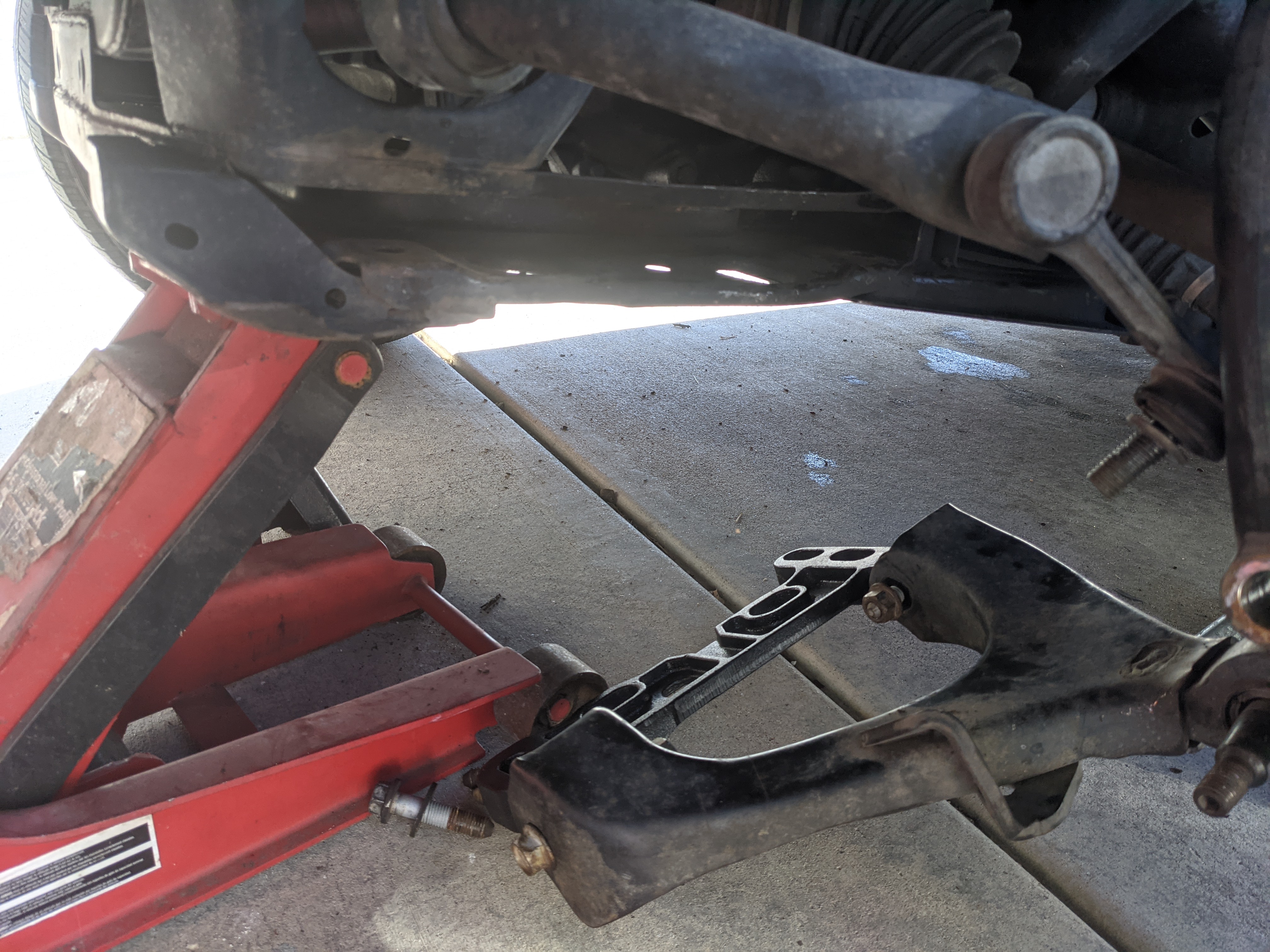

So been fighting a condition in the wife's Envoy where you hit the brakes and the steering wheel rotates. I started with the 7 year old in the driver's seat and me underneath. First thing I saw was hammered outer tie rods. Did those and set it at 1/16" toe in. Wife complained it drove weird. A day or 2 later I drove it and it was weird. Turns out I'd set it at 1 1/16". Whoops. Next I found worn lower ball joints and had it aligned. Still garbage. Next I saw the upper control arm bushings were hammered. Score! Upper ball joints were nice and tight too. Went for a drive and STILL garbage. By now I was facing ankle surgery and the tires were pretty bald on the outside so I was dead in the water. Today I swapped out the lower control arm mounts as that's where the lower control arm bushings live. First one was a pain, second went much much quicker. Bask in the cleanliness of the non-rotted 2007 Envoy Denali those of you who hail from the rust belt!
I caused some undue asspain by trying to pull it straight out. Turns out the trick is to pull the front straight out and the rear forward and out. Reinstall in the opposite order. The prybars come up a bit short on leverage when sending these things home so a little more loving was required.
If brute force isn't working, you're not using enough. Just a couple whacks here and it was home sweet home. When I got it back together it had way too much camber and north of an inch of toe in. I got toe close to 0, went for a test drive, and it went straight and didn't rotate the wheel under braking. Good enough to rock until it hits the alignment rack this week. After that, the tires I'm hoarding go on and we can face winter head on.
