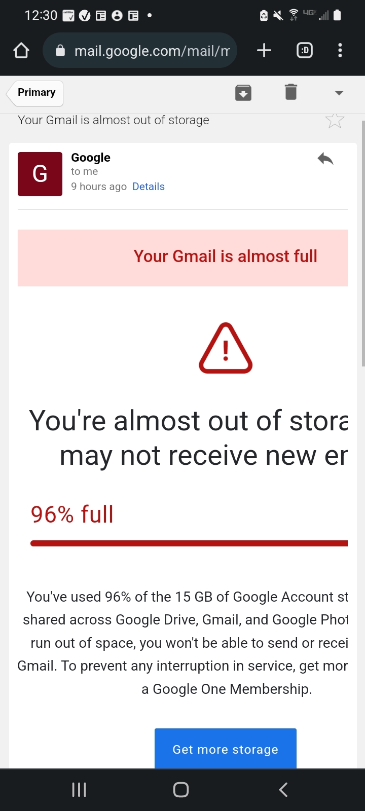

So, it *should* be a project, but, I can't make myself care enough yet to deal with it.
Got a Gmail warning:
Now how does one get there?

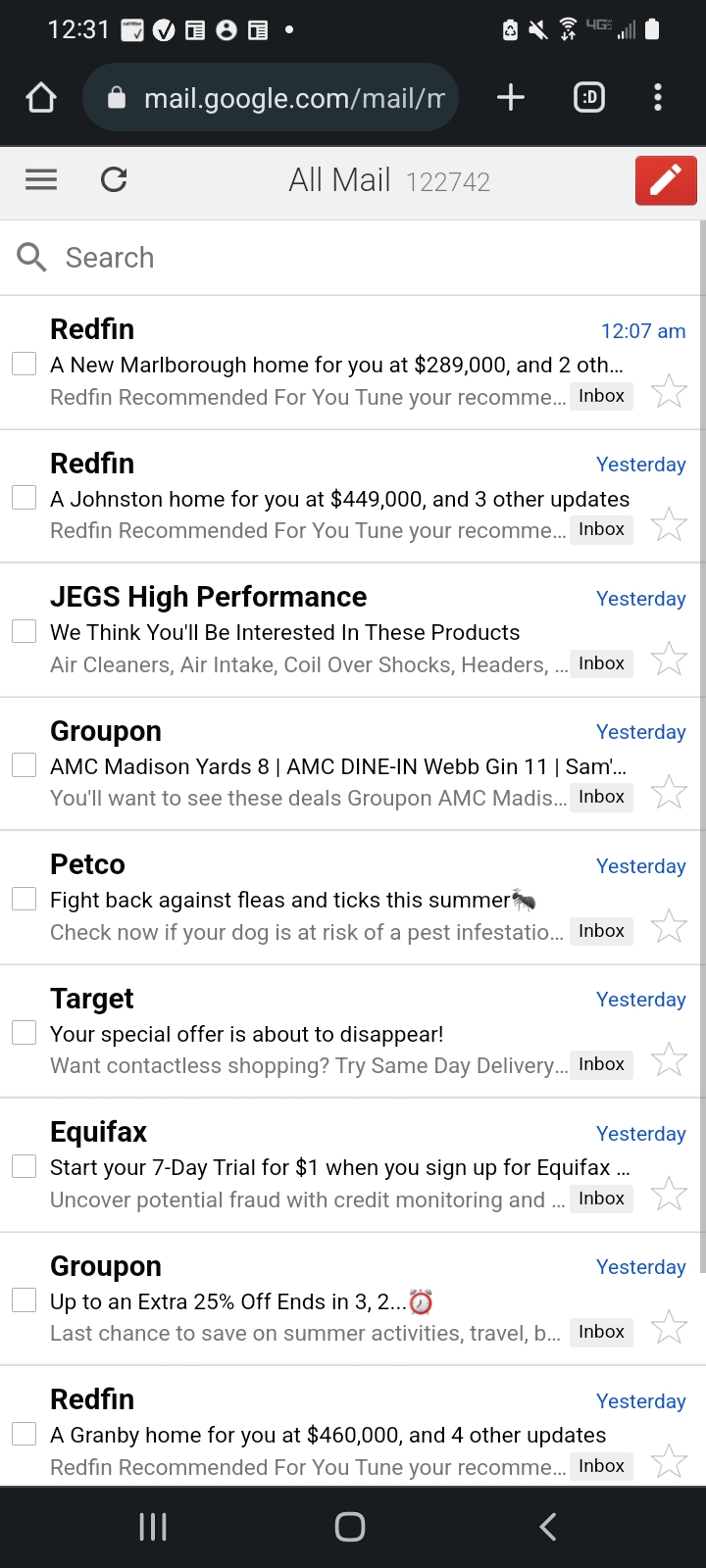

Just under 123,000 unopened emails in the inbox. I hate email almost as much as social media.
So... if someone tells me in person or on the phone they sent me xyz, I'll look for it. Otherwise... meh, I generally don't care. Maybe there's a way to pick like a 15 year window worth of 'new' messages to highlight and delete en masse? Dunno. Maybe when it gets to 99% I'll do something about it. Or make a second one and put in automatic forwarding, that should be a thing.
Think about this. At 1 second a piece to click delete, you get 60 a minute, 3600 an hour, 12600 in 3.5hrs, and 126,000 in 35hours. So, accounting for dinners, hygiene, and sleep, I saved almost 3 days of my life by not dealing with that B.S. if it's 2 seconds to get rid of an email that's almost a week of lifespan.
Think about that and how much time of yours that gets wasted by 'modern convenience'
Right click on the inbox- delete all😏
