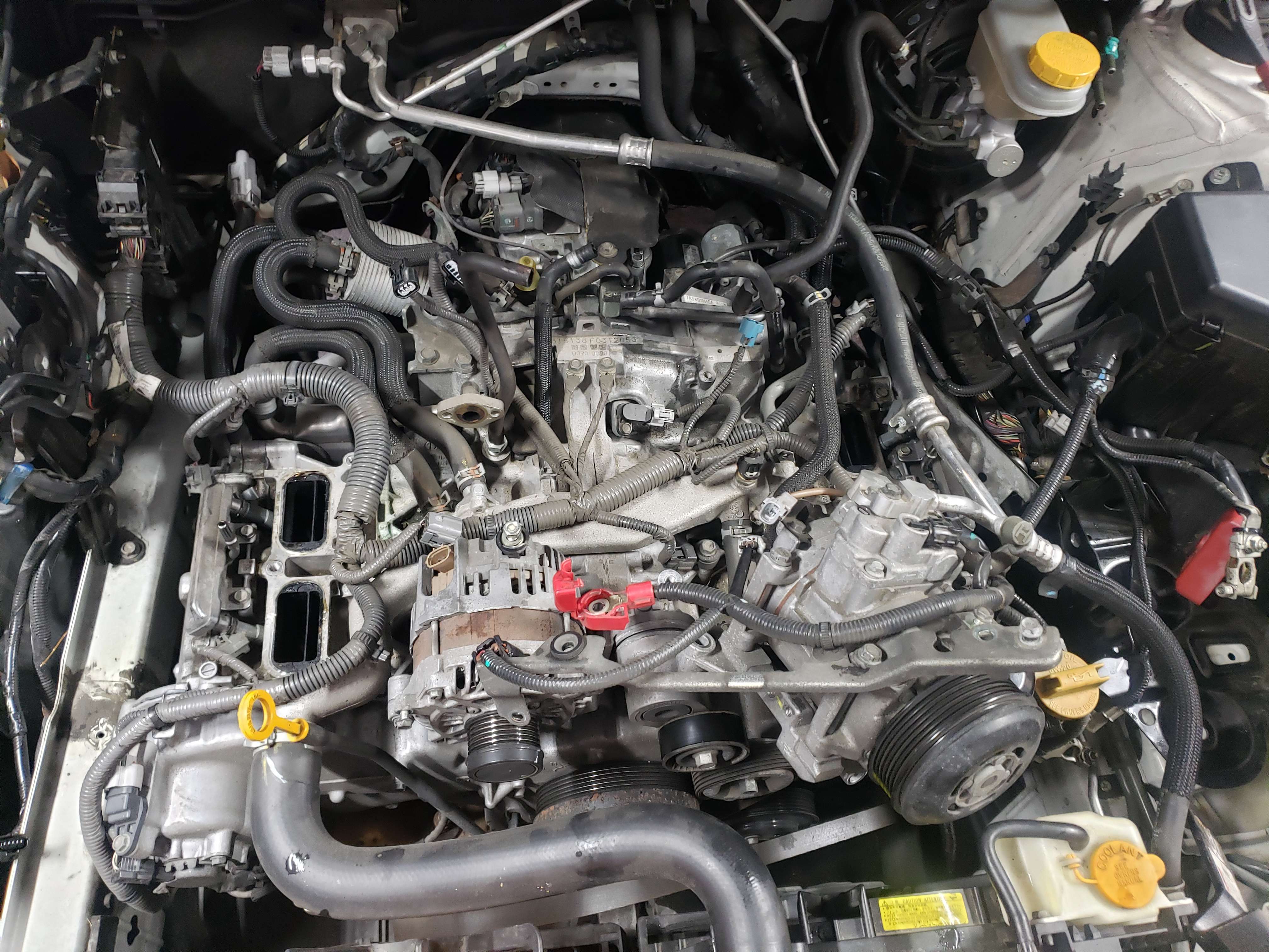

Worked on my mom's Subaru. The coolant crossover pipe was leaking and to replace the seals you need to remove the intake. Not a hard job, just a lot of stuff to disconnect. The valve cover gaskets were also leaking so I replaced those as well. Subaru valve cover gaskets can be a bit of a pain being a flat 4 since the valve covers are right up against the frame rails but it can be done in the car with the right tools.
I was pleased to see that even with 120-ish thousand miles on it the engine was spotless inside. There was some carbon buildup inside the intake runners but that is to be expected and there was not enough to be problematic or concerning. Plus the car is port injected so it doesn't matter much anyway. The inside of both heads was super clean as were all of the coolant passages. The old coolant I drained out was so clean it could've been reused.

There is a lot going on in there.

It looks very busy but I think that is mostly because Subaru puts EVERYTHING right on top. With the exception the valve cover area, the engine bay is very roomy and it is really pretty easy to work on.
