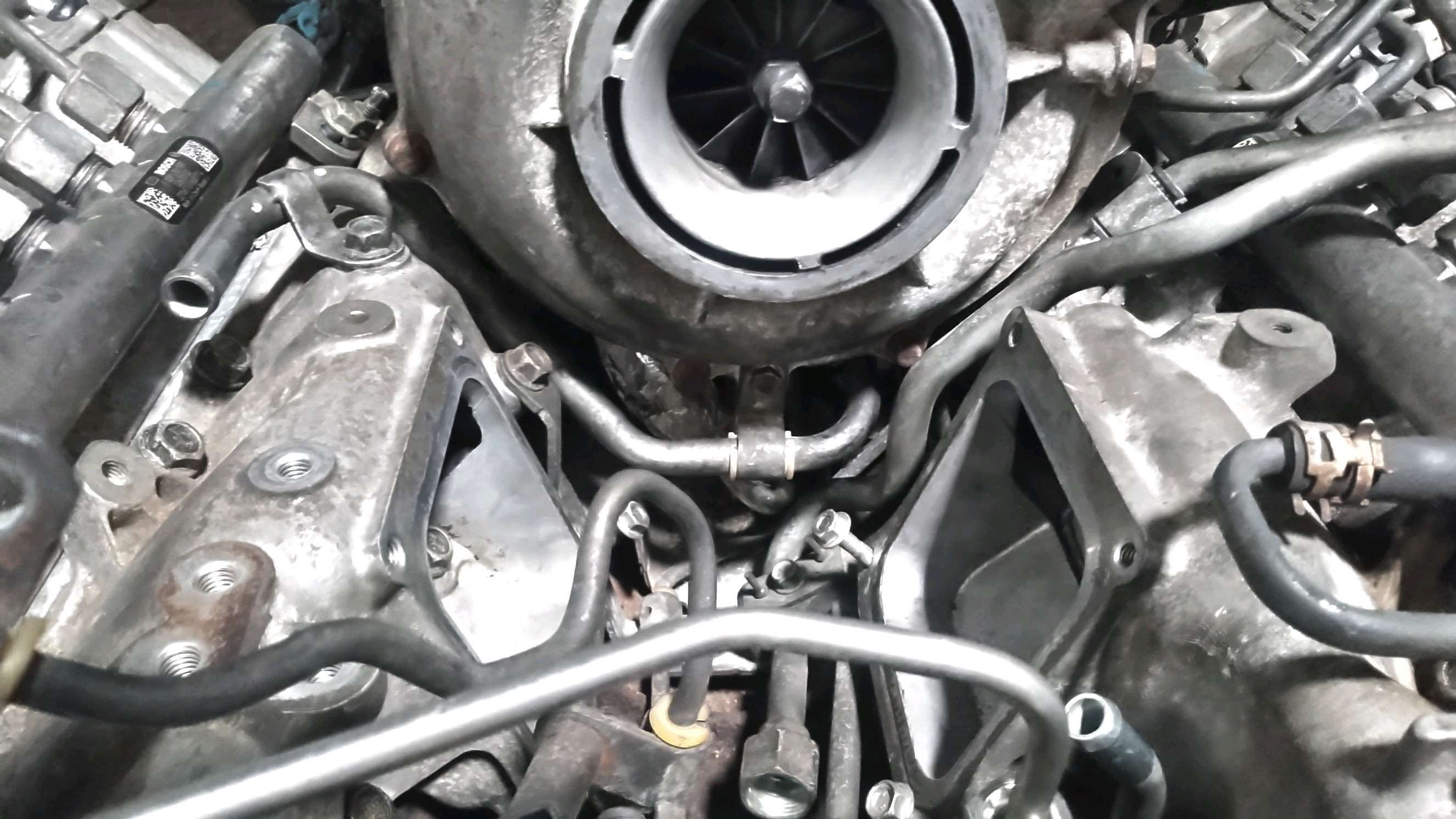

Well I got home at 10:00 again. So much for an early night. There's so much on the top of these motors it's very difficult to get the assembly process right when you've never done it before. I've been deeper in cars and trucks before but never something this intricate. It literally reminds me of a BMW or Mercedes. So my process is I'm kinda mocking it up and only tightening things I know I absolutely won't need to remove to install something else. I did hit a few snags tonight I've been so worried about getting the fuel system right that I forgot to put on the coolant line for the turbo. Fortunately leaving things loose I was able to pull back out a few loose bolts and sneak it in. It's the line bolted to the bottom of the turbo and the top of the passenger intake manifold in this picture

And of course that's a banjo fitting and the bolt had to go in with gasket where you see it.not fun with big hands.lol. another snag was I somehow mixed up the lower valve covers. Not that big of deal they are the same but there studs and bolts for accessories that ended up on the wrong side and made assembly confusing. But the only snag that got under my skin was that I ordered the wrong filters! Oh and forgot to order barbed hose fittings. The new dipstick tube fits perfectly and definitely answers some questions I had about where it was supposed to go. The old one was bent and the mount bracket was broken off. And now that's solid.

Well I got home at 10:00 again. So much for an early night. There's so much on the top of these motors it's very difficult to get the assembly process right when you've never done it before. I've been deeper in cars and trucks before but never something this intricate. It literally reminds me of a BMW or Mercedes. So my process is I'm kinda mocking it up and only tightening things I know I absolutely won't need to remove to install something else. I did hit a few snags tonight I've been so worried about getting the fuel system right that I forgot to put on the coolant line for the turbo. Fortunately leaving things loose I was able to pull back out a few loose bolts and sneak it in. It's the line bolted to the bottom of the turbo and the top of the passenger intake manifold in this picture View attachment 204288

And of course that's a banjo fitting and the bolt had to go in with gasket where you see it.not fun with big hands.lol. another snag was I somehow mixed up the lower valve covers. Not that big of deal they are the same but there studs and bolts for accessories that ended up on the wrong side and made assembly confusing. But the only snag that got under my skin was that I ordered the wrong filters! Oh and forgot to order barbed hose fittings. The new dipstick tube fits perfectly and definitely answers some questions I had about where it was supposed to go. The old one was bent and the mount bracket was broken off. And now that's solid. View attachment 204290 View attachment 204291
