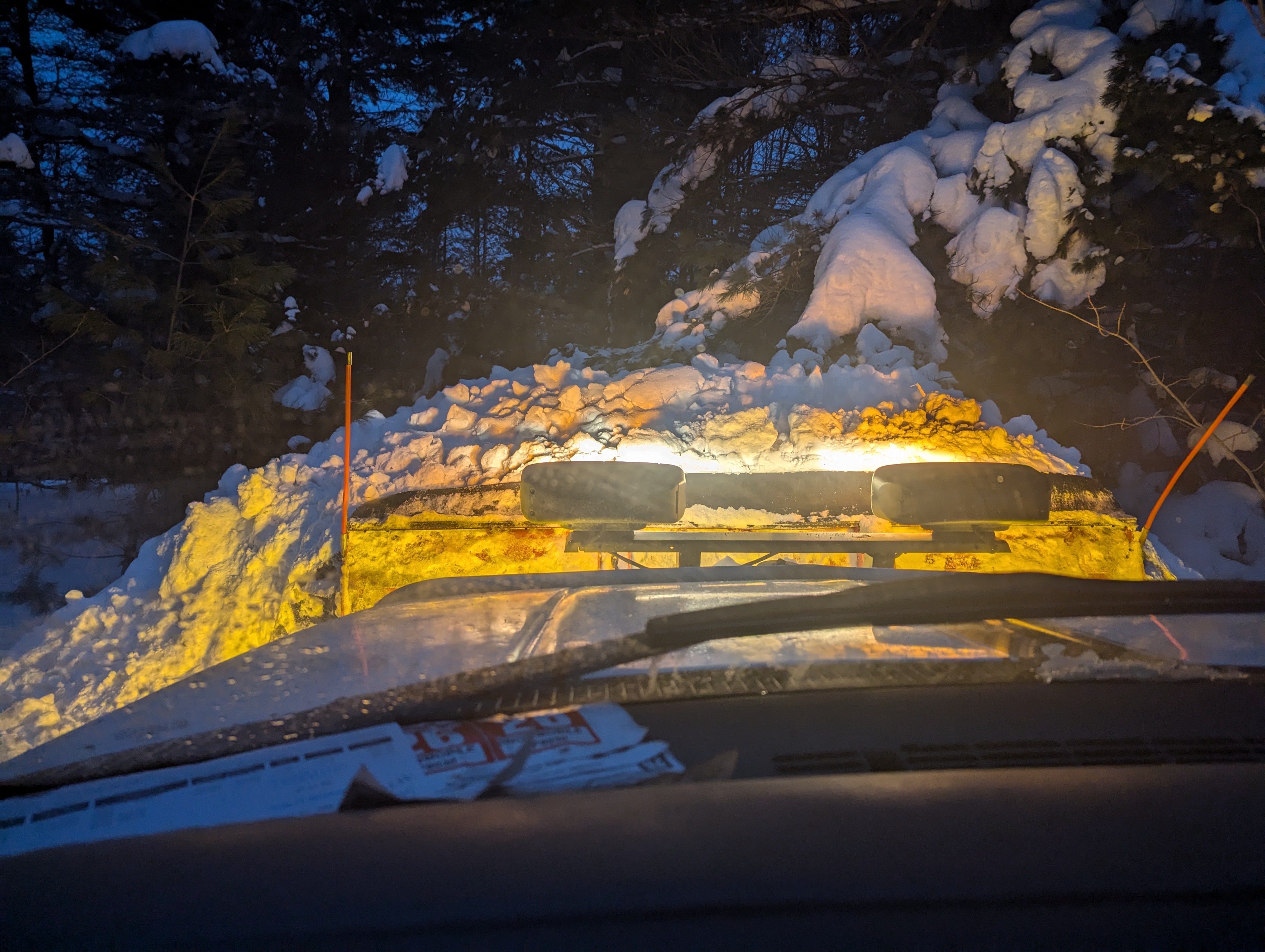

Plow quit working, water got into reservoir and froze around the pump pickup. My fault for not putting a gasket under the new motor I installed last year. Hopefully that solves the issue.
Oops.

Hopefully it didn't crack anything

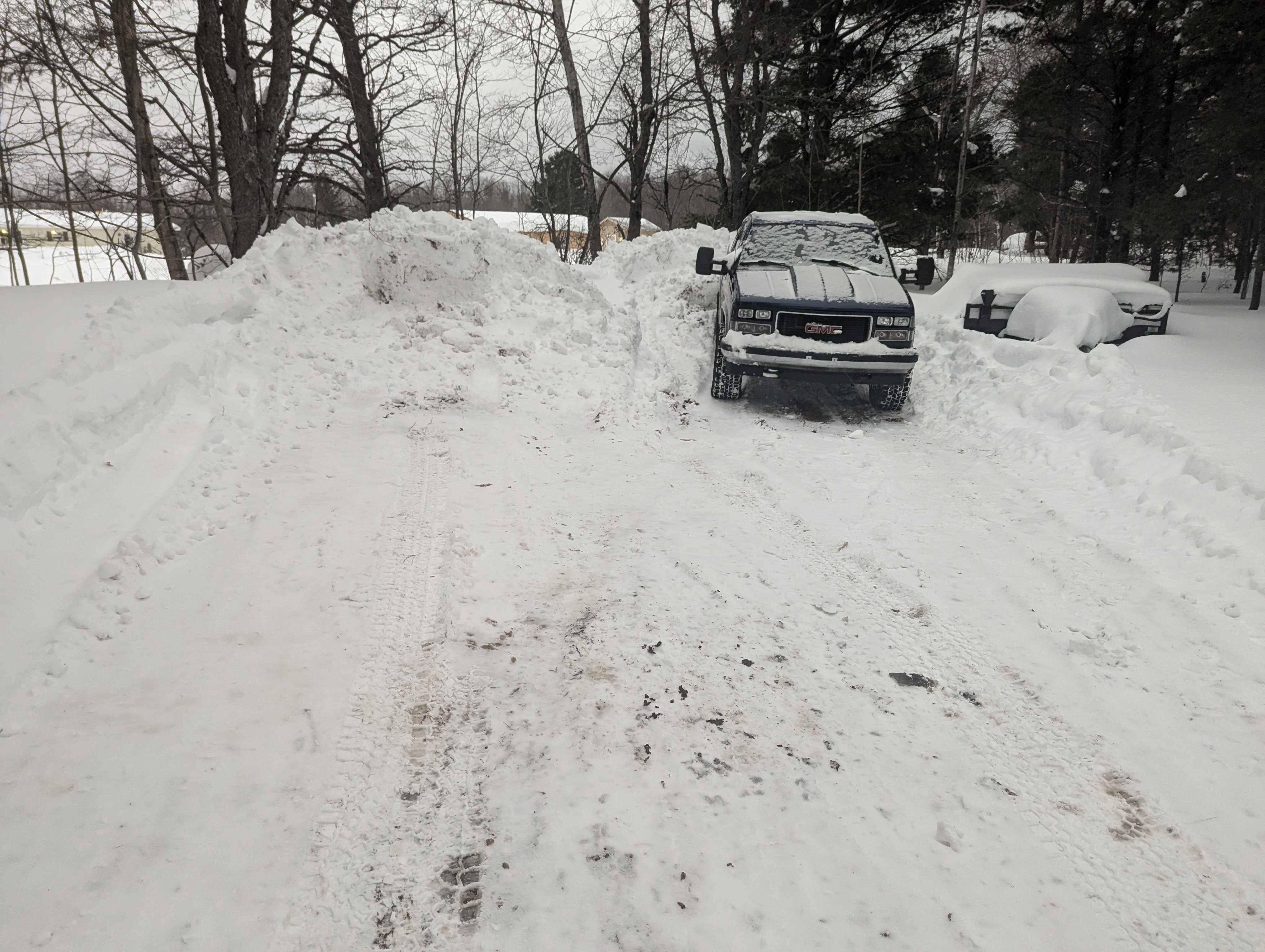

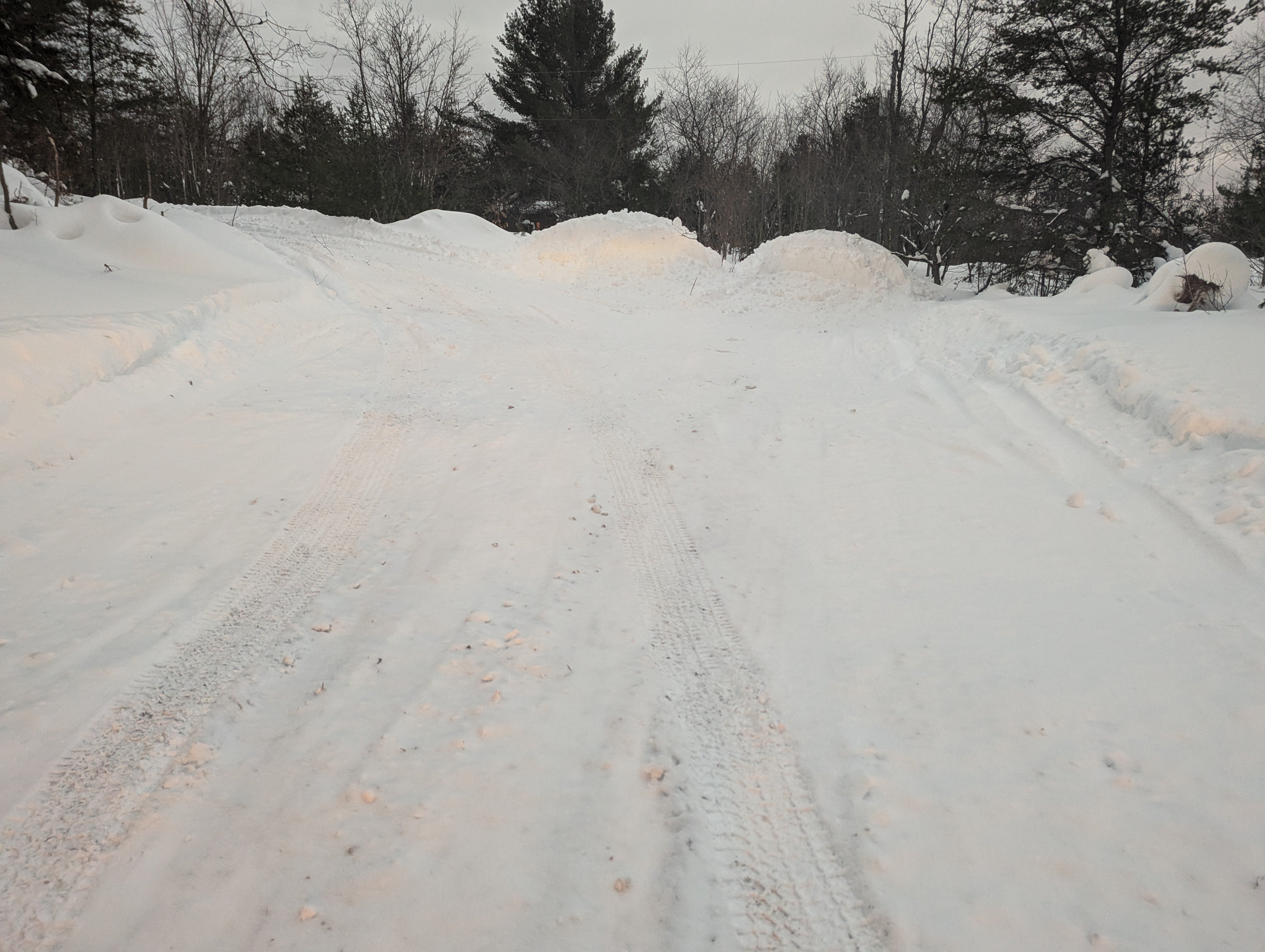

Plow works again. Makes a new ticking noise, so that's fun. But it works. I put about 34oz of fluid in the reservoir, Idk what the spec is. It's an old western cable plow setup. The detail sticker is long gone.

Probably supposed to be either ATF or hydraulic fluid.
