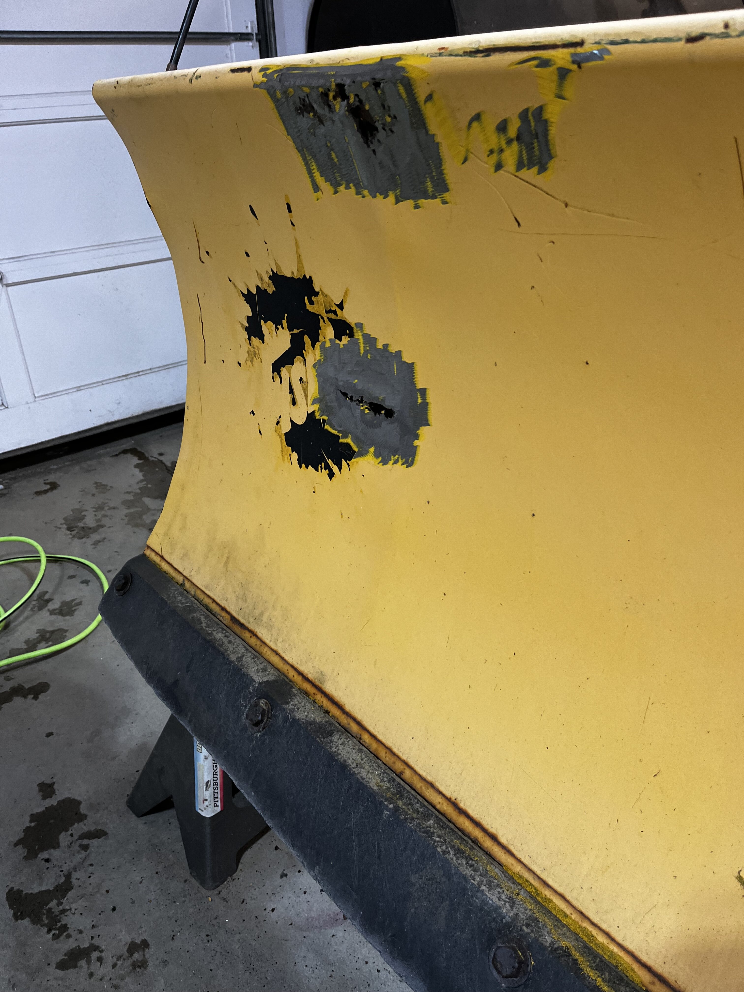

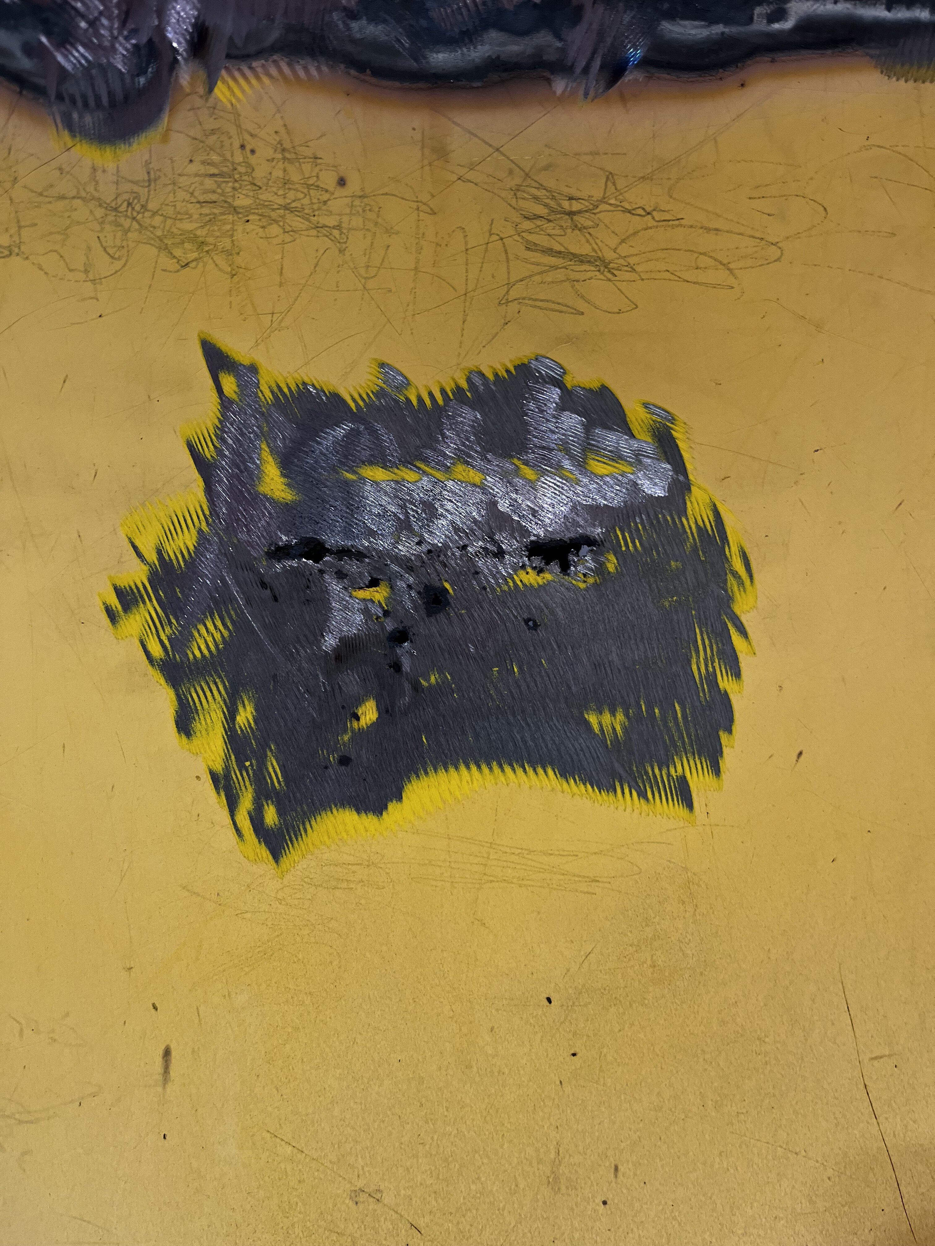

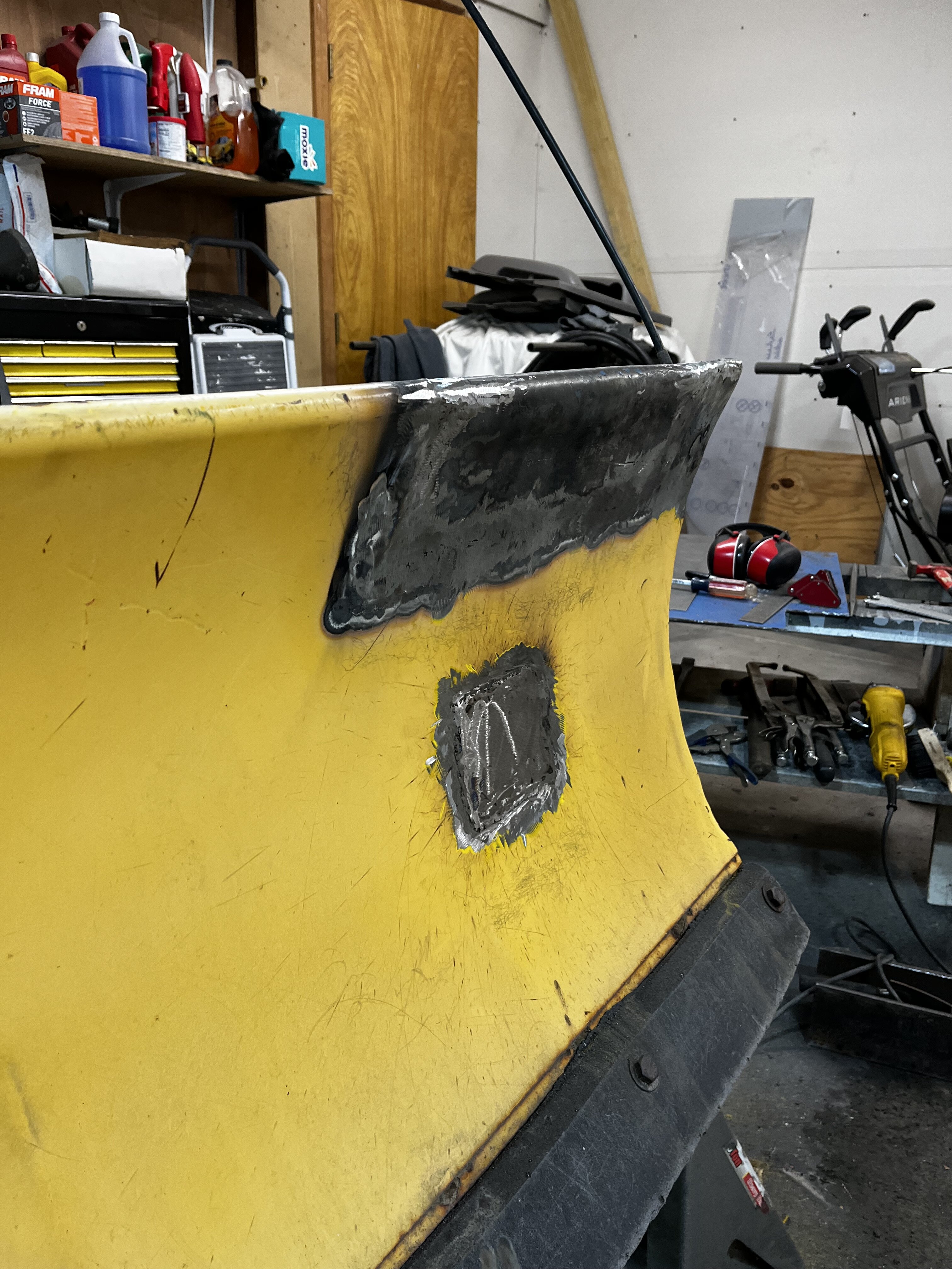

Been having fun rebuilding the plow. Started fixing it with metal I had (1/8”). then bought some 16 gage that the plow is really made of. Patching lasts two years, I’ll be happy. Got the wrong mig wire and will never weld with flux cord again if I can get away with it!
View attachment 250013View attachment 250014View attachment 250015
my flux core has treated me very well. It's a harbor freight titanium 125 flux core welder. i think i'm using .030 wire, can't quite remember. Usually when i burn through i can turn the voltage down and wire speed up a toooouch and fill the holes.
Should be able to step down to .025 on that thing. I really want one for the trailer and other small jobs so I don't have to deal with the 220V extension cords every time.
It just had way too much spatter but I also (after reading instructions) saw I was supposed to change a power conductor around,but was better with the gas shielding on. I’m guess I’m used to gas shielding to weld, and should have read under the hood instructions? This is only the second time I’ve used it. My main one is a Miller 210 and ran out of gas after 5 years 😵‍💫
