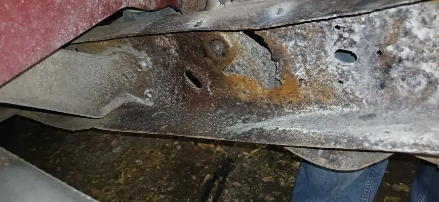

Fixed the bed mount, the frame I thinking just gonna clean it up and put a plate over the backside. Weld it and bolt it perhaps. Idk what will get skewed if I remove brackets.

I wouldn’t remove any brackets. Make the plate overlap your hole, turn your welder up to 11 and burn it in from the back. You can even weld from the front at the edges of the rust hole to try to seal it up and get a bit more hold on it.
