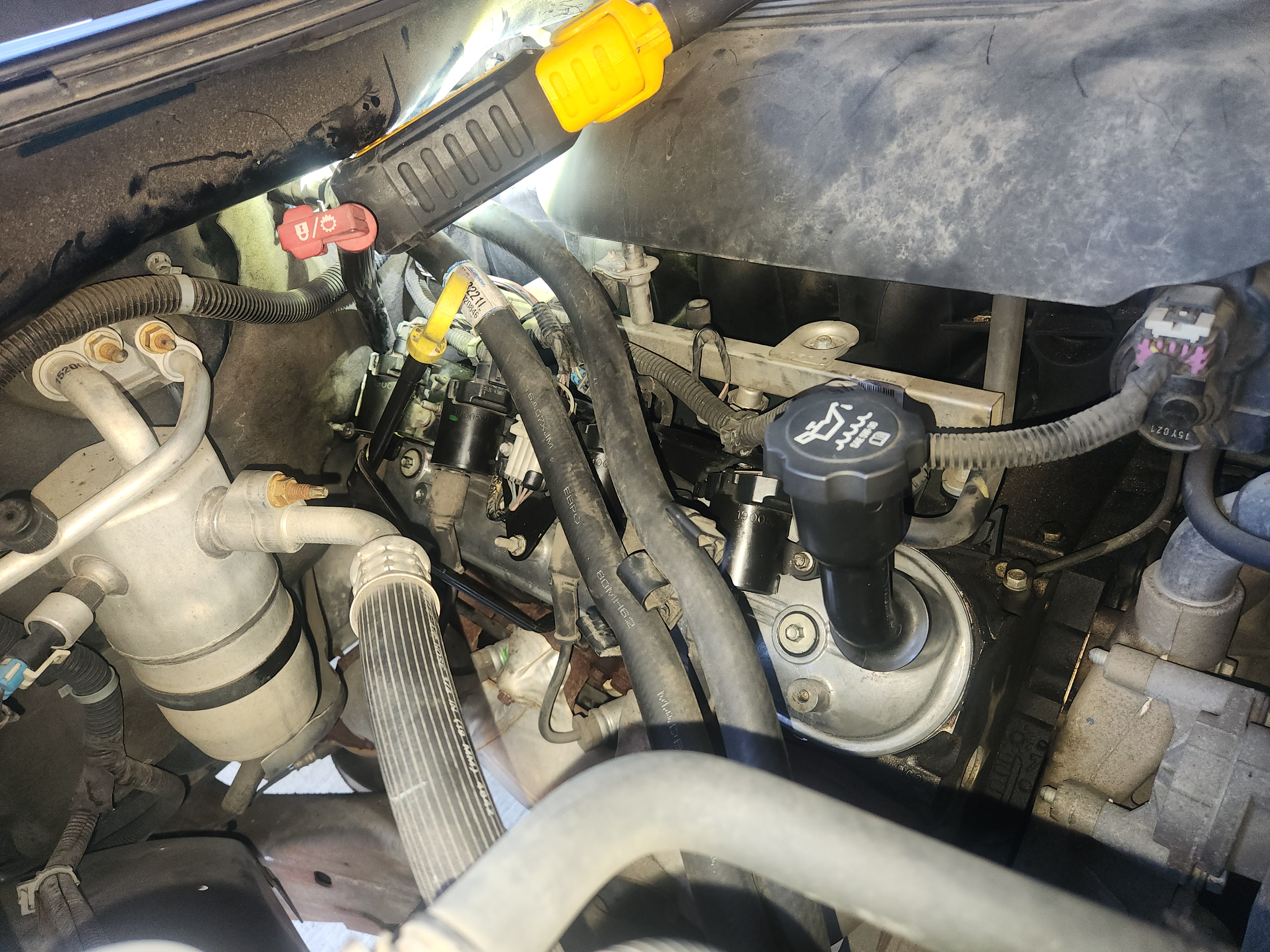

Took good Friday off. Went to Dad's and replaced the valve cover gaskets on his 06 Sierra this morning. It's had a pretty significant oil leak for the past few years. A few months ago I replaced the oil cooler block off plate on the oil pan. Dad says it's much better but I'm not so sure. I'm certain the passenger valve cover was leaking. I'm pretty sure the driver wasn't. I did them both, just the same, because. I'll let him drive it the next few months and see if/how it dries up and how it does on oil consumption. My gut says it needs an oil pan gasket, but we'll see....

Cripes that's buried about as bad as the valve cover on the 4.6 that originally came in my 92 Crown Vic.

It really wasn't that bad. Pull the plug wires off the coils, pull the coils as an assembly and then 4 bolts and the cover is off. Cleaning them up was the biggest chore. Dad didn't realize they should be bare aluminum. He thought they were painted black, if that tells you anything.
