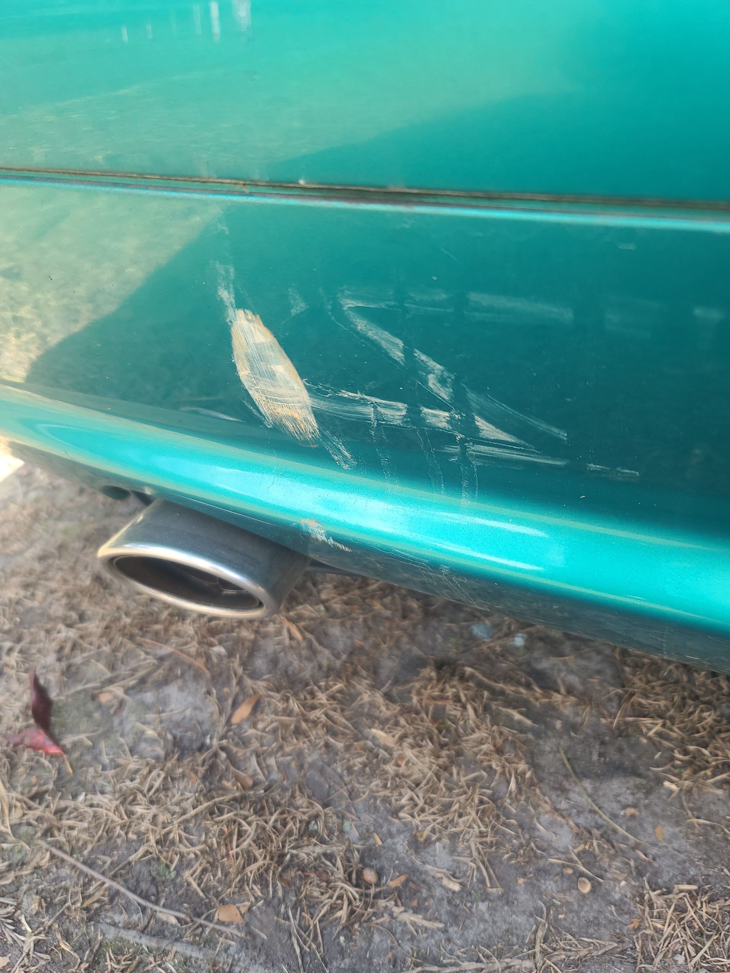

So, the SLK looks to have taken a hard whack:

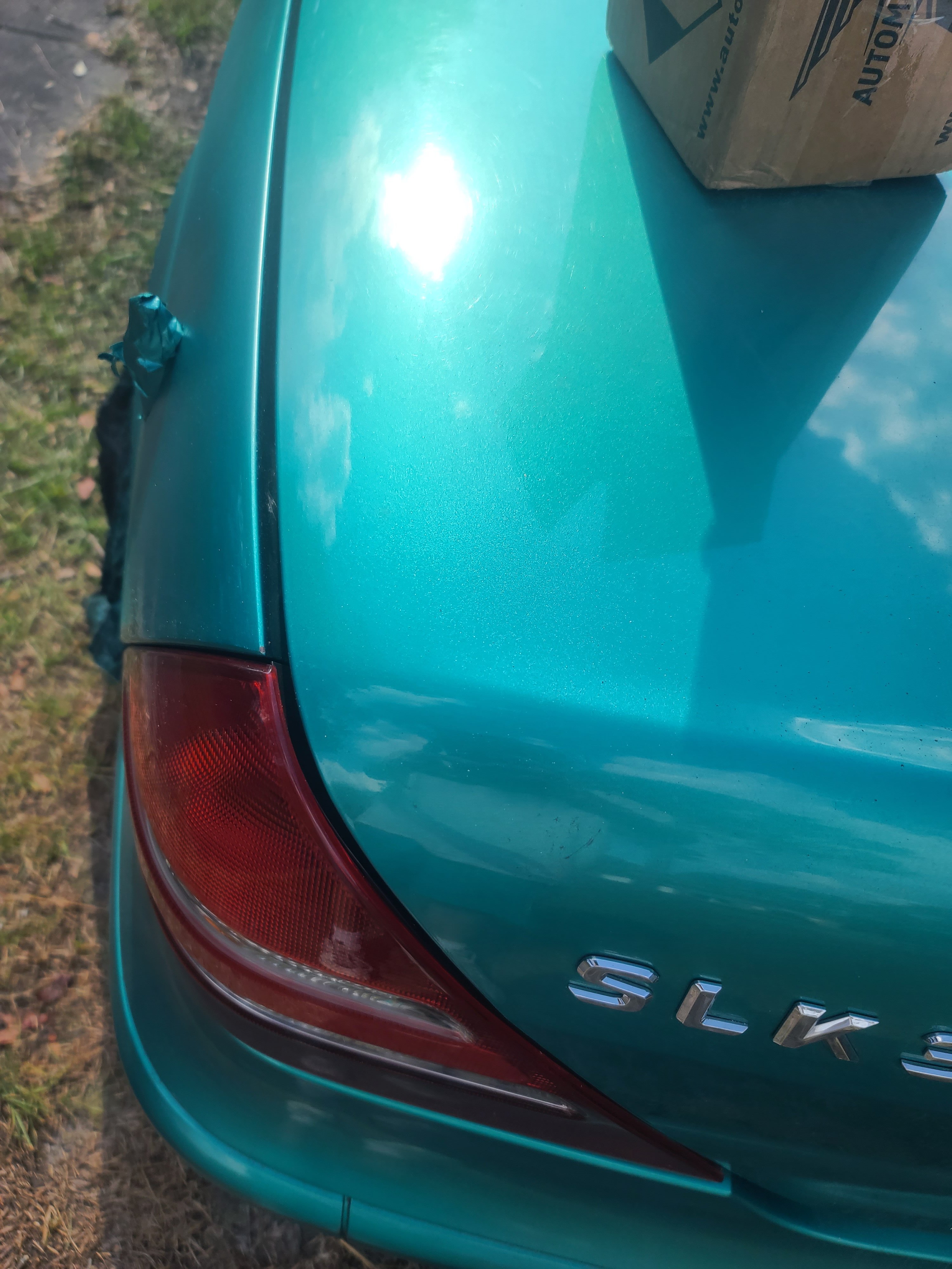

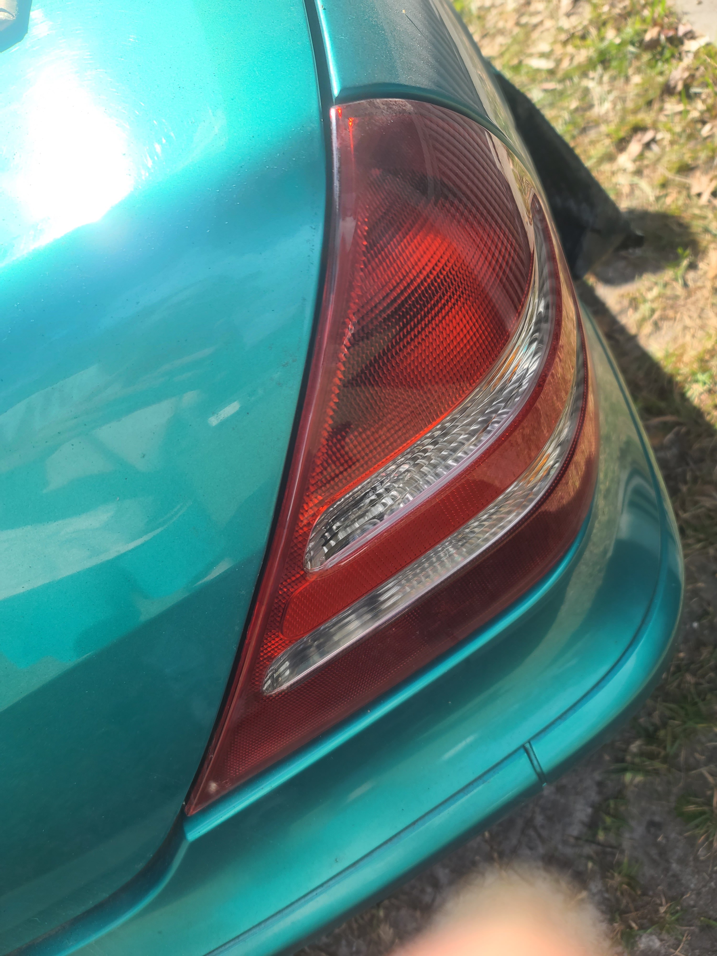

The part that's concerning is the trunk gaps:
Maybe hard to tell but the left side has a MUCH bigger gap than the right, and the decklid sits up higher in the air there as well.
Not a good sign on a power retracting hardtop. Cars only got 60-someodd thousand on it, and, was a very limited production color (only made a couple hundred over the years it was offered.

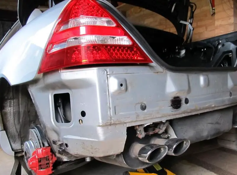

Tomorrow the bumper cover will come off and tell a bit more to the story, but, these cars didn't have your traditional impact bar on pedestals with a honeycomb. It's just a thin composition plastic backer and straight to the tailpan:
(Generic pic for reference)
