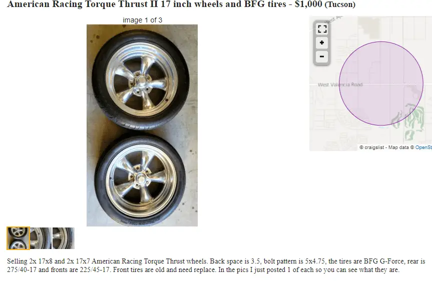

FOUND THESE IN TOWN "FOR ME ANYWAYS " WIDTH IS 7s AND 8s but b/s is 3.5" is this and no go ?
