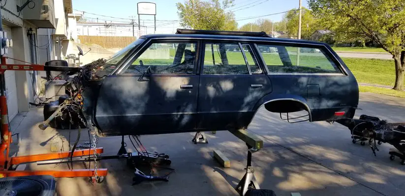

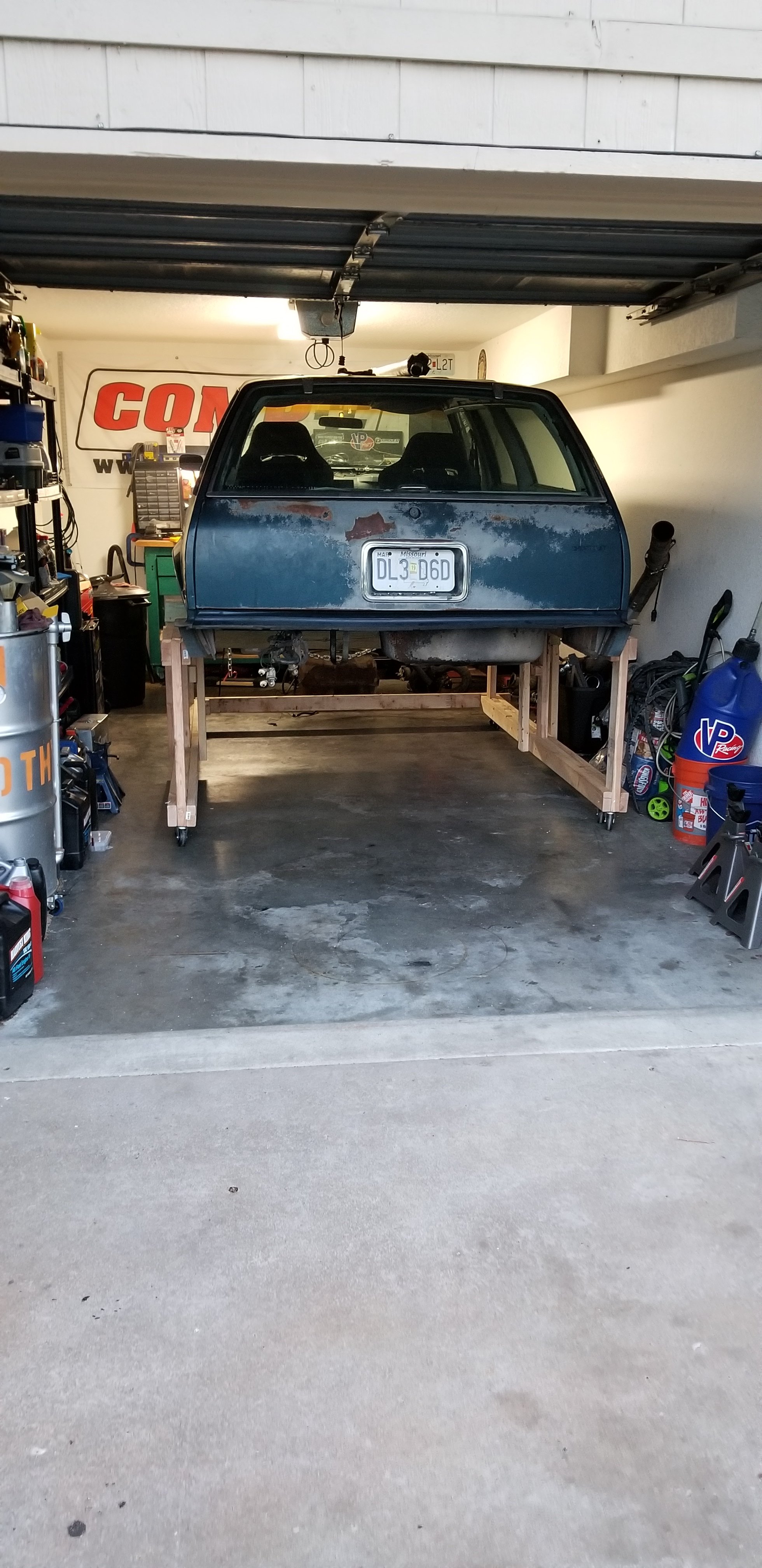

So I "finished" my wagon about this time last year. 5.3 turbo/4l80e combo. Had a lot of fun for a year but the car was running low 11s and needed a cage. Was just going to put one in but then it dawned on me. There is a lot of stuff that needs addressed on the frame and body that I won't be able to do with a cage in!
So the snowball has started rolling. Going to be addressing a lot of things like rust inhibiting, frame strengthening, notch, etc etc.

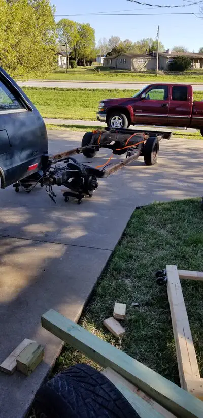

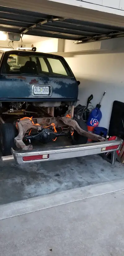

All I have is a single car garage and can't store either part of the car outside (I rent and ya know, landlords).

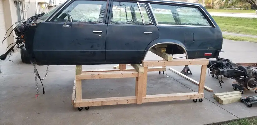

So I built a dolly with the mission of being able to store both in my limited amount of space. It was more of a PITA than I expected. But happy with the result!
And oh man are these wagon bodies heavy on the rear. Center of gravity is not where you would expect it

Nice. Good old common sense that unfortunately isn't so common

Nice set up I also did something like that 17 years ago when I was living at home and was using a shed that was in the back yard to build my regal.

You certainly used your ingenuity to be able to fit the frame and body in the one car garage. ...nice work! Great solution. I'll be sure to follow your progress.

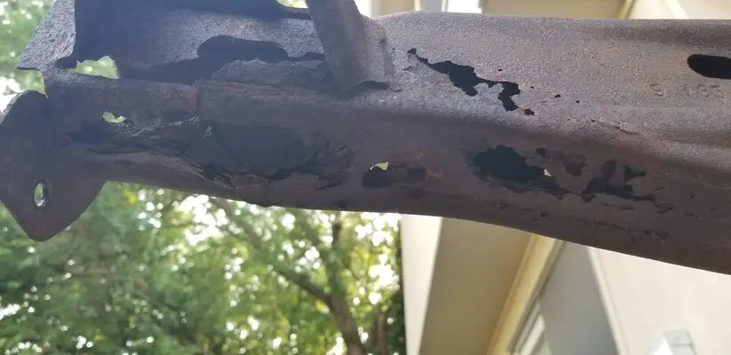

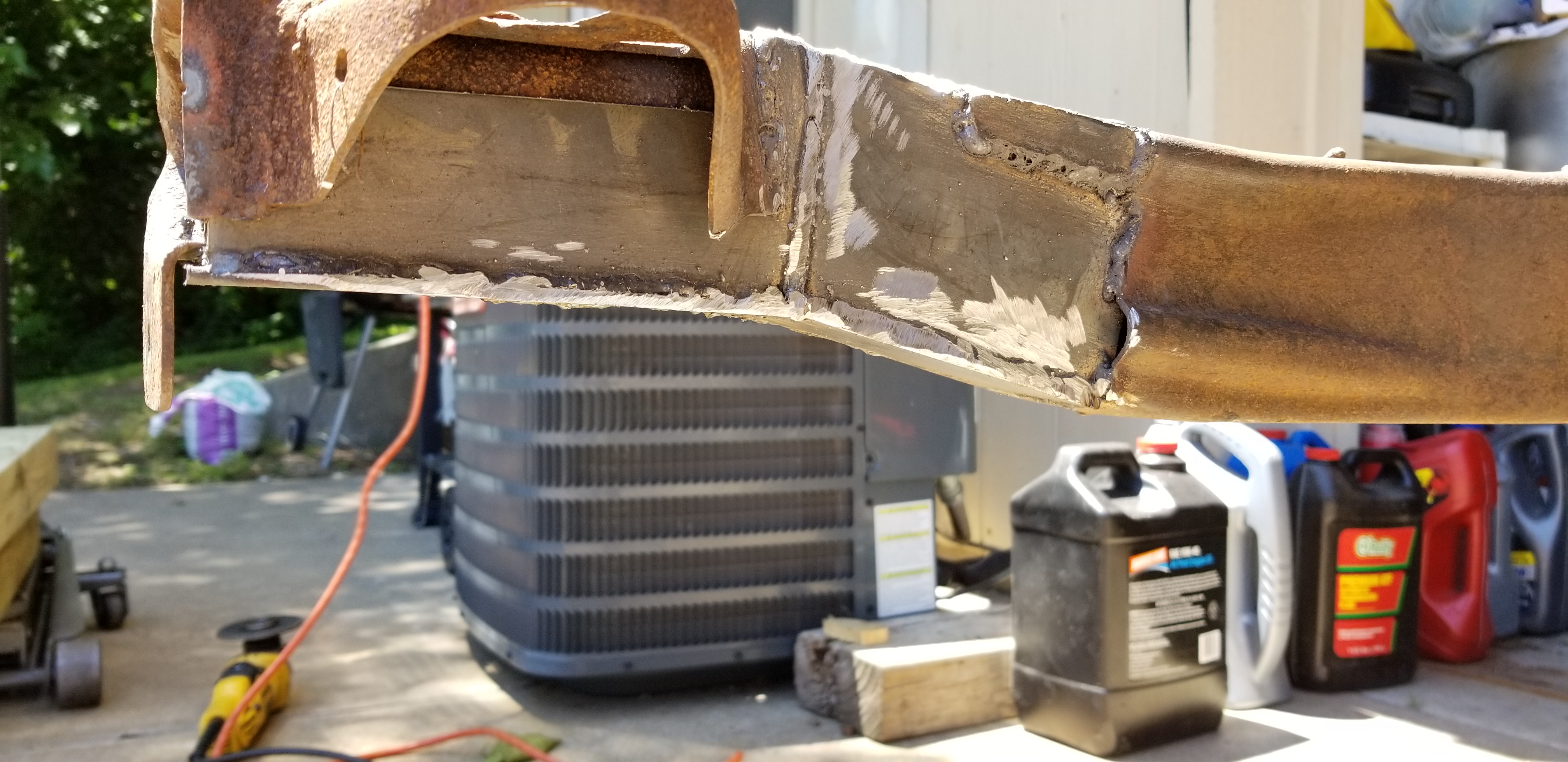

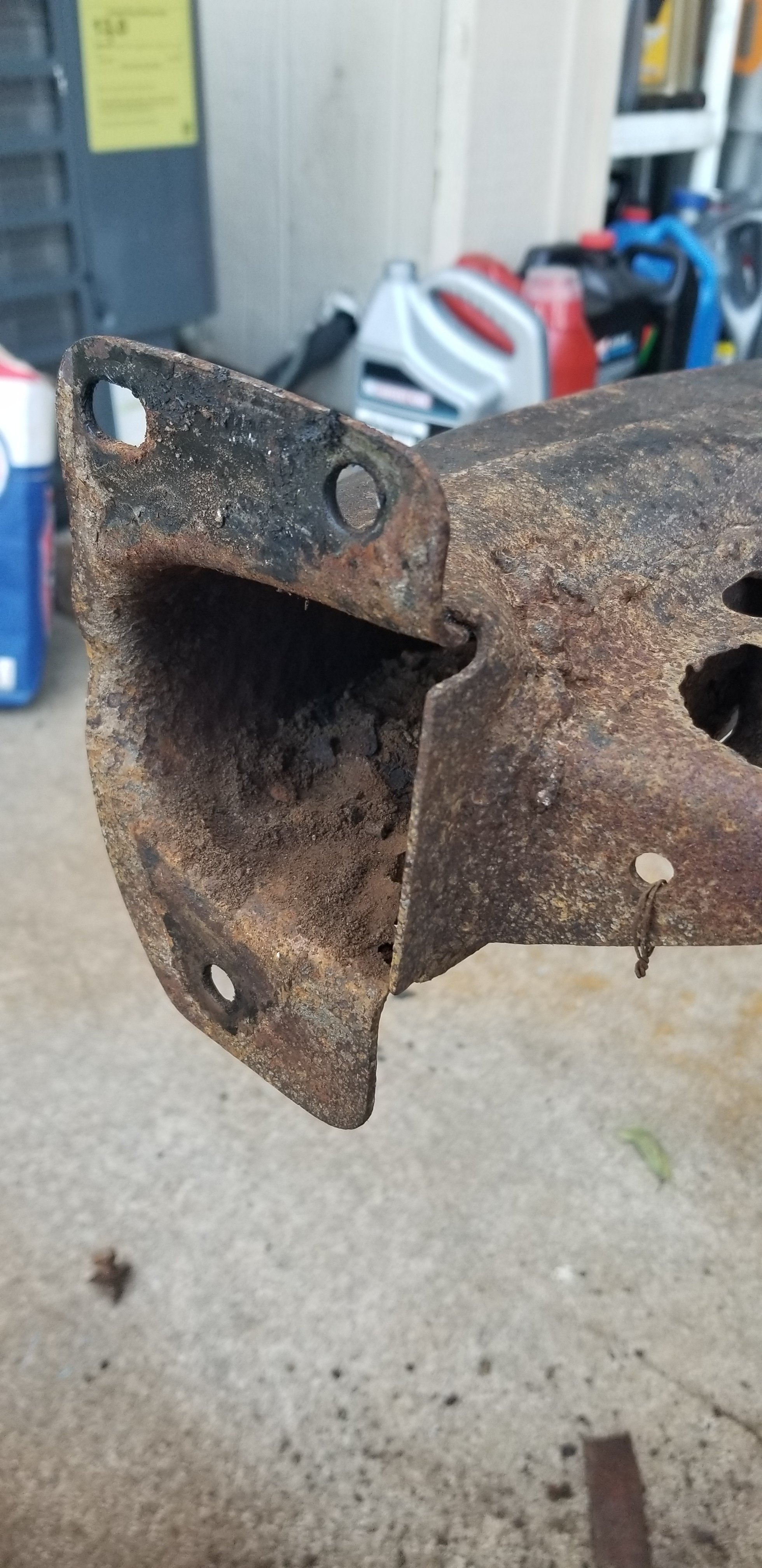

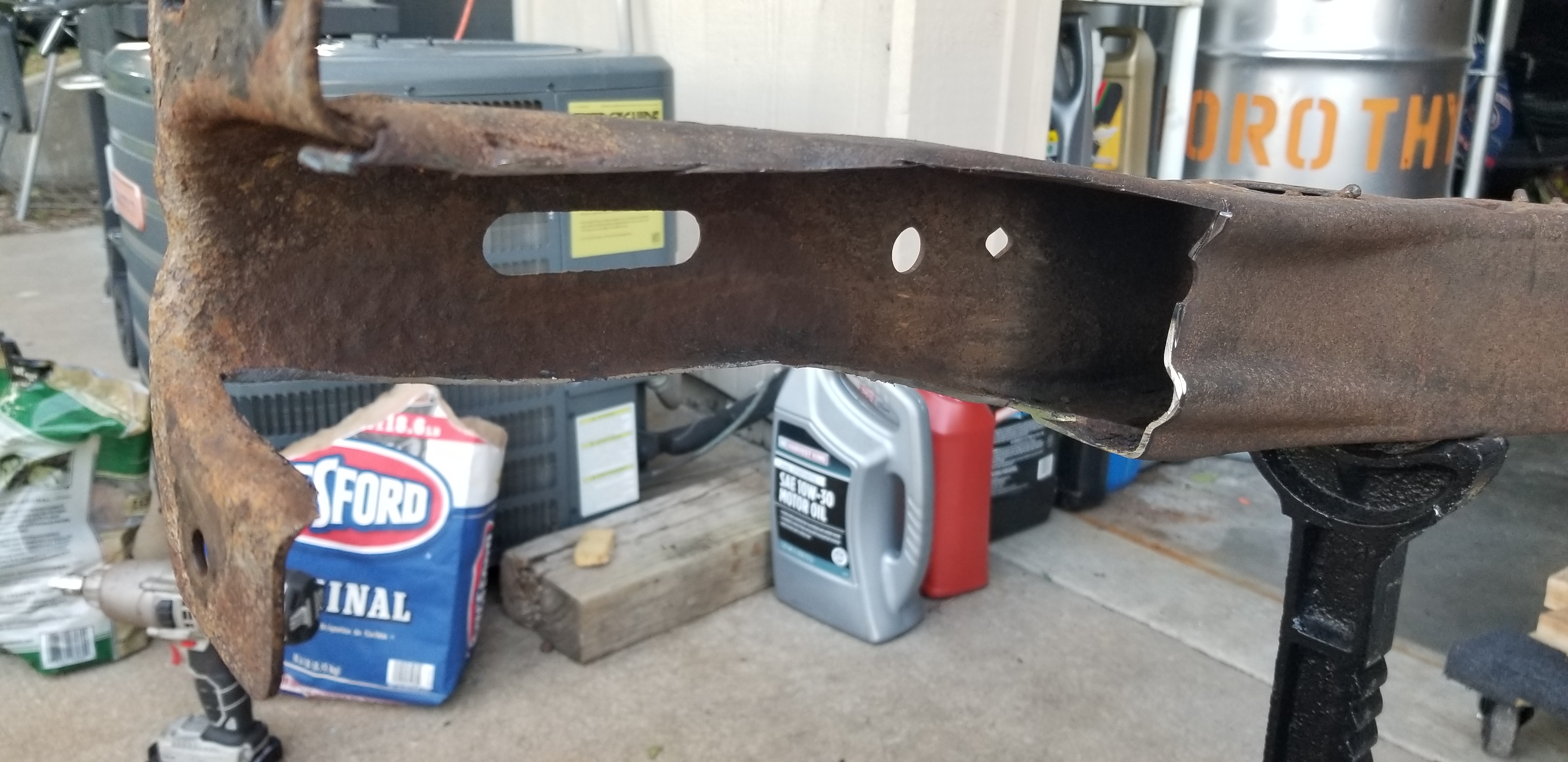

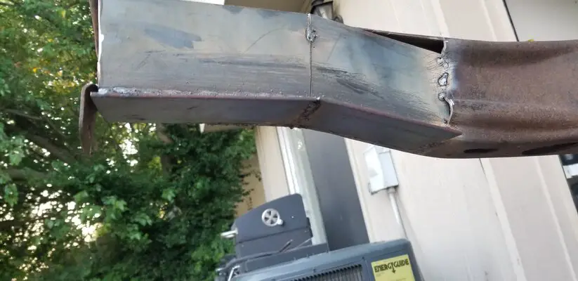

Did some frame repair on my left rear horn. As all wagon owners know, replacements are almost nonexistent and donor cars are few and far between. Thankfully it wasn't TOO bad, so I used what little fab skills I have and repaired it with some 1/8 in steel.

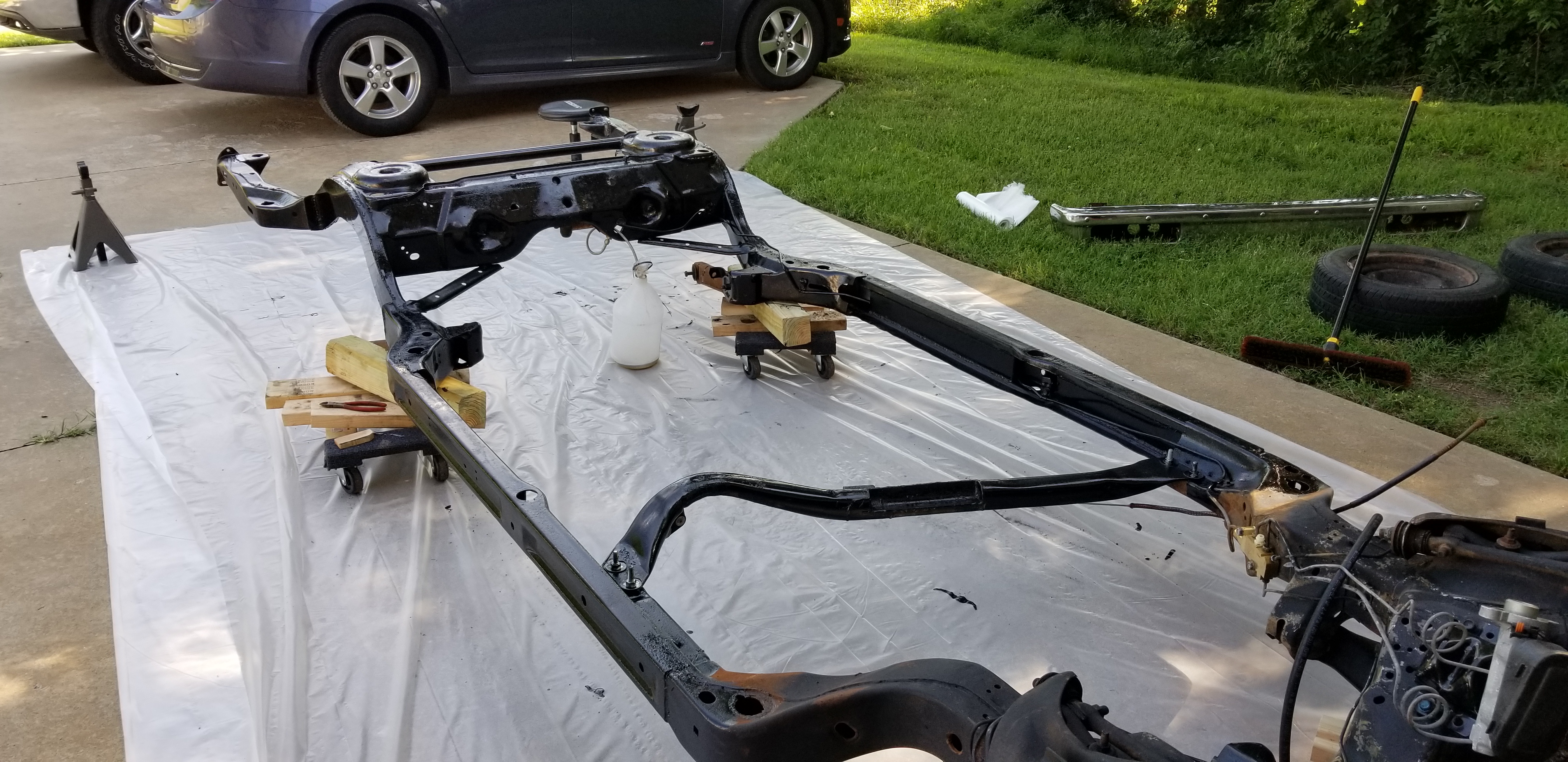

Coated the frame with POR 15. First time using the stuff and was very impressed. Goes on well and dries hard.

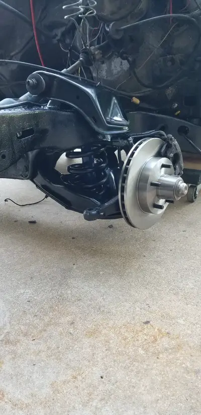

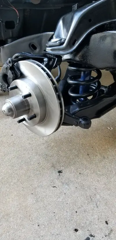

Got the body back on the frame with new Poly bushings. Then turned my attention to the front and rear suspension. New stock replacement front uppers, new stock S10 lowers, double adjustable rear uppers and UMI non-adjustable rear lowers. Then of course new springs and shocks all around, as well as new bushings, bump stops. And finally S10 rotors finish out the front.
I reused my stock front sway bar, which much to my surprise is a lot beefier than research lead me to believe. For a plain jane, sparsely optioned car, it has a 1 1/8 in diameter bar. Probably should have measured that before I ordered bushings for a 15/16 bar lol.
