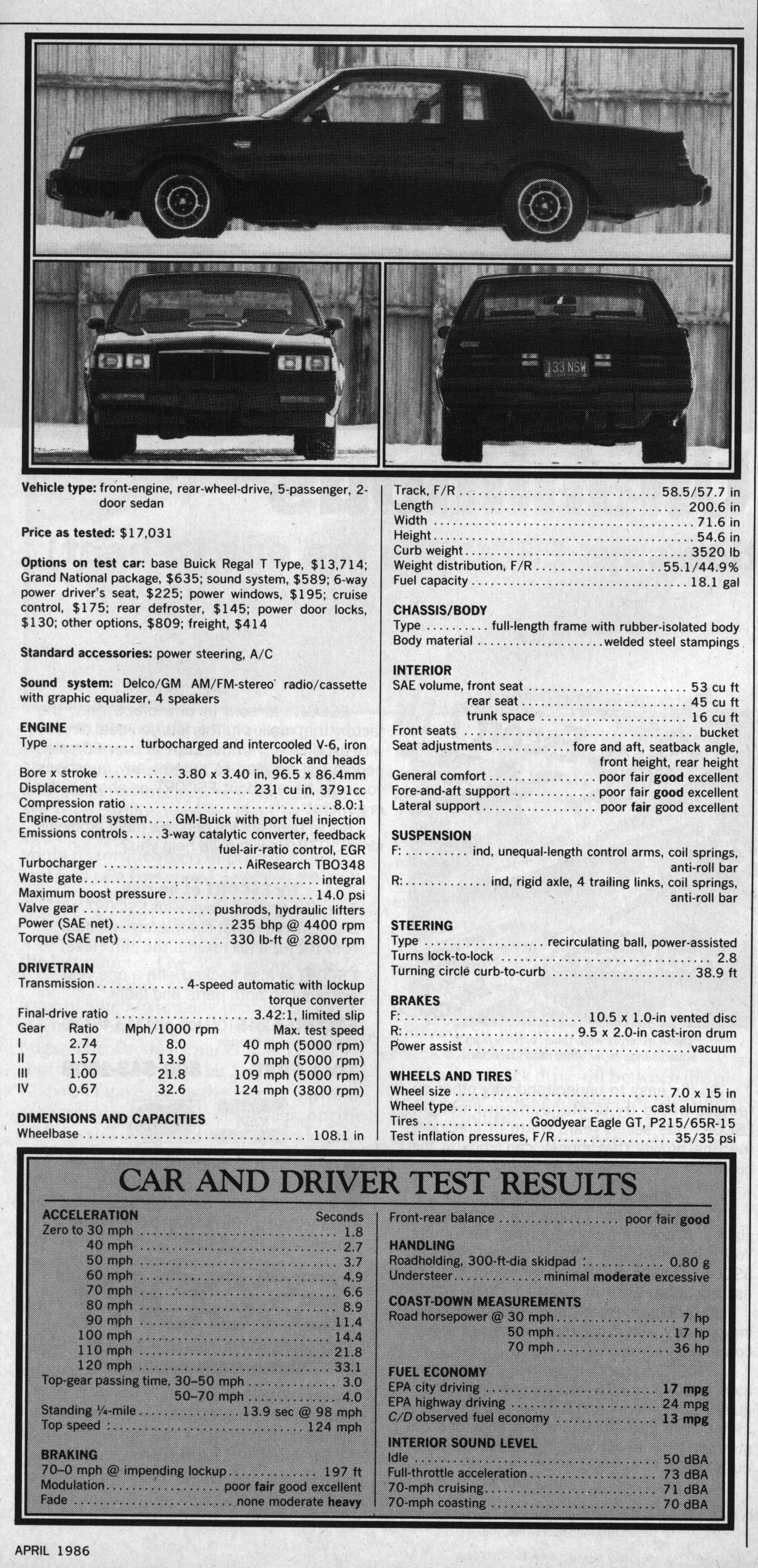

The lighter motored/heavier rear axle GN would have had great weight distribution as an aerocoupe. Stock weight distribution was 55% Front / 45% Rear for an '86 GN
