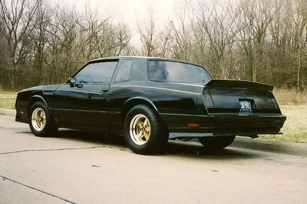

Here is an old picture of my Monte with 15 x 8 ARE wheels and 245/60 and 275/60 tires.
You still have that car man?...it sure is sweet
