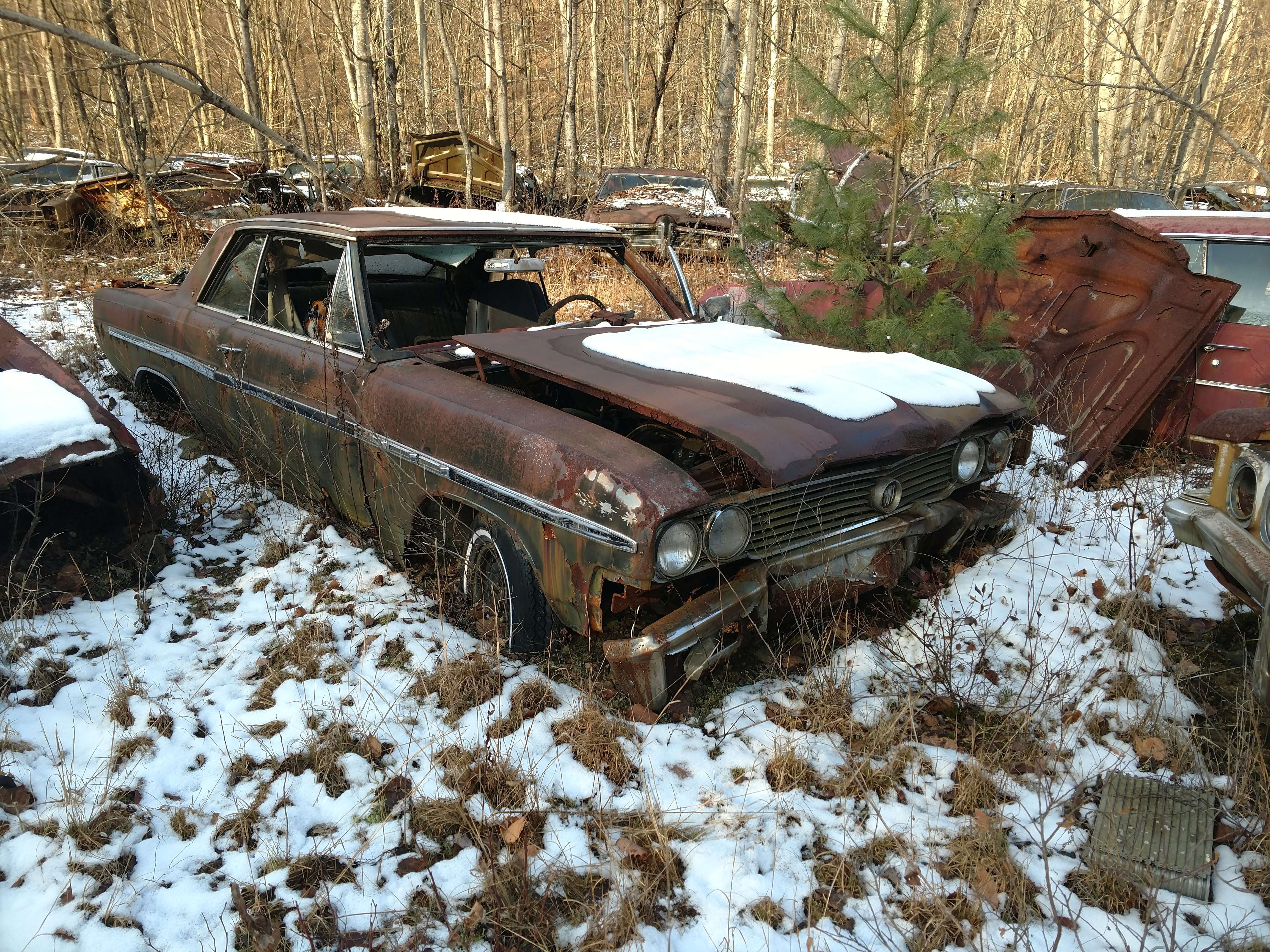

Was just looking at some old junkyard pictures I took a few years ago and came across this. Wonder if it is still there. pagrunt you up for a trip to Renick's?
Well I won't be far from there Friday morning. Was already thinking about a trip after my VA appointment.
