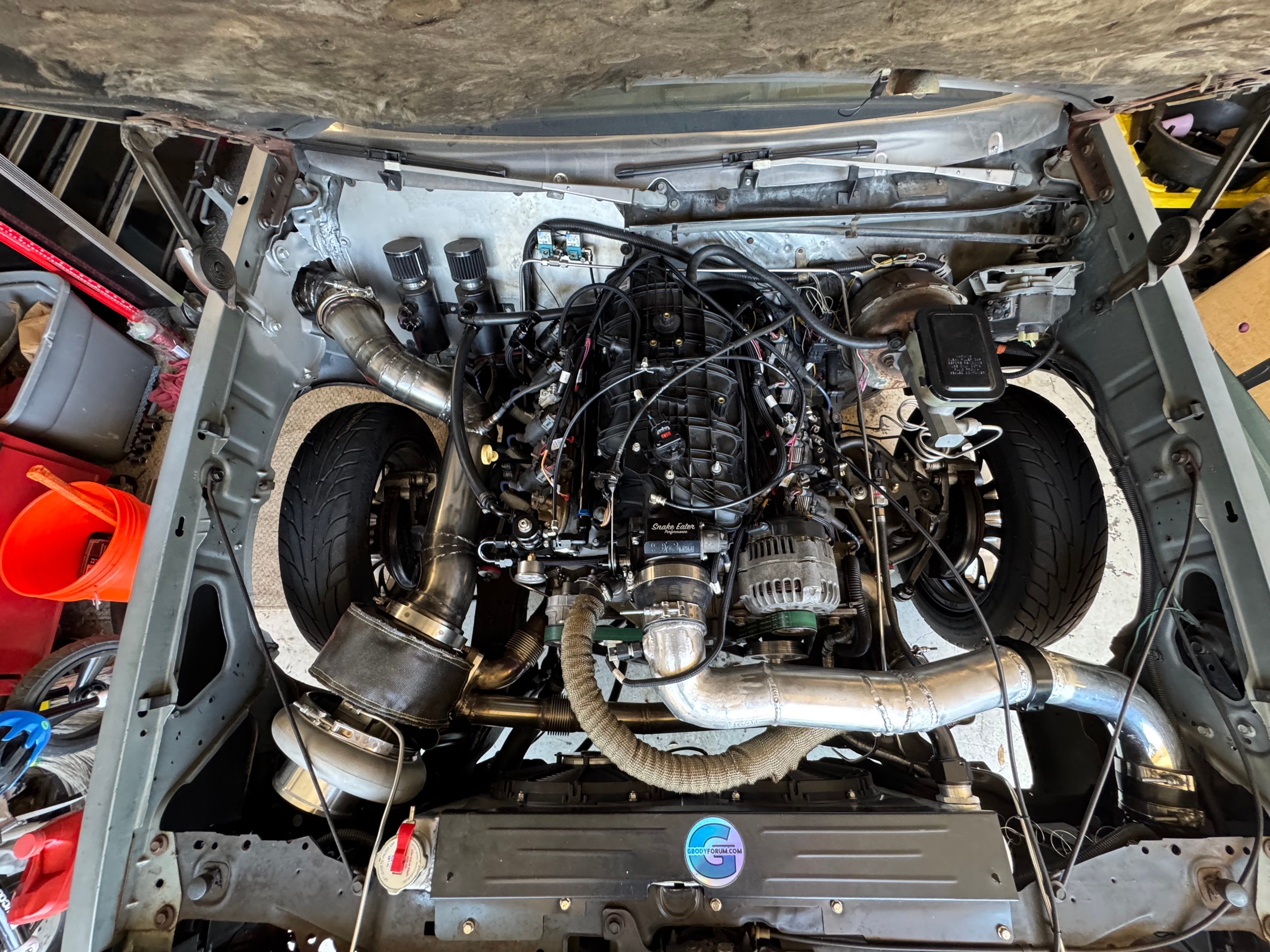

Sweet stainless merge by Ace Race Part:
Trying to get better with this stainless TIG welding; it is NOT easy:
Drivers side set up:
PS manifold done:
Will keep on, keeping on!
Had to fill a gap due to imperfect fitment:
Worked out pretty good!
