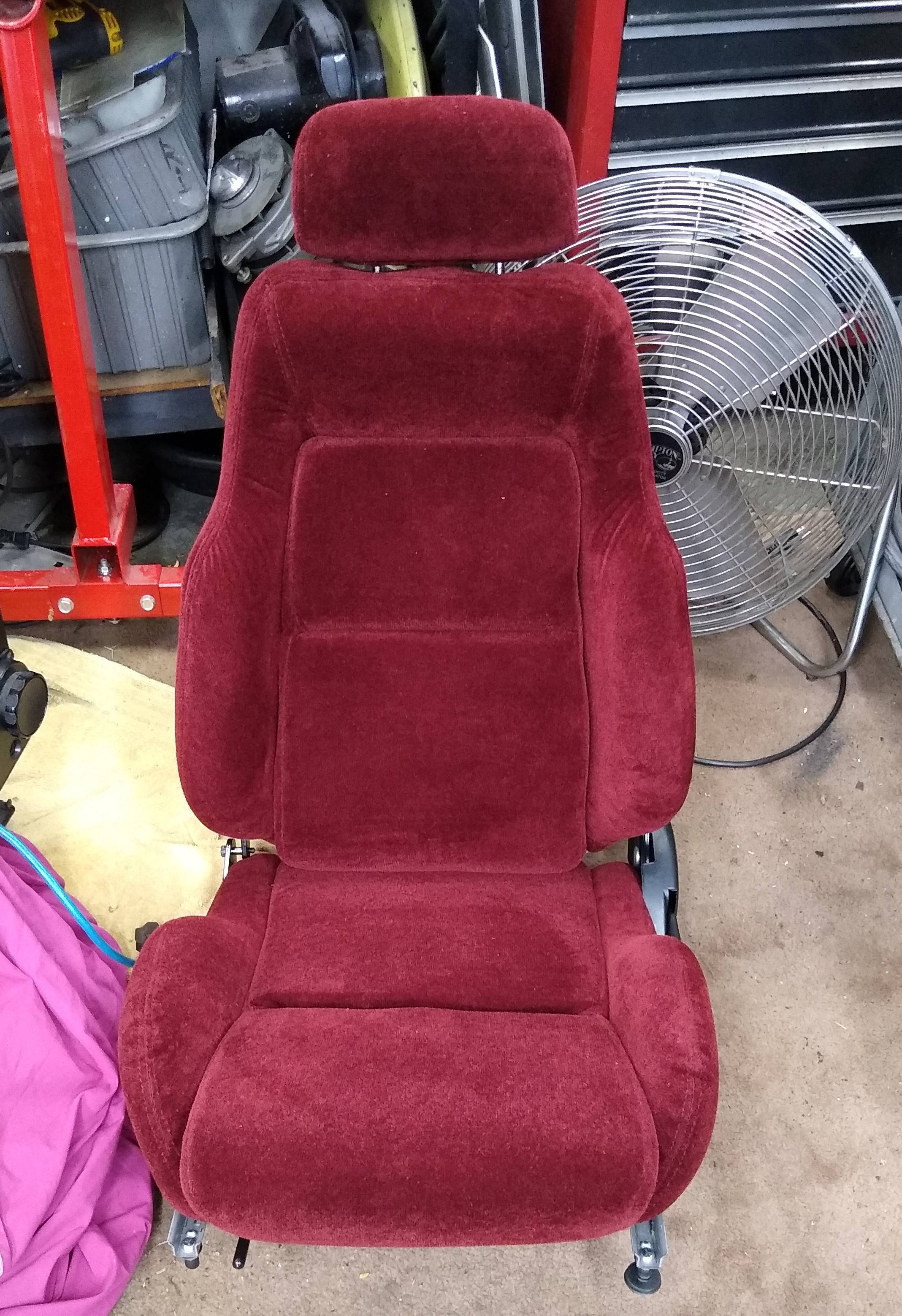

Those look nice, I have been trying to think of a replacement to mine since I hate how much I slide in them when drivingSo I have really just been driving the Regal and realized pretty quick that as nice and comfortable as these new pillowtop seats are they suck for corners so I decided to have Cerullo make a set of their GT buckets for my Regal. (Newer design of what is in my Monte)

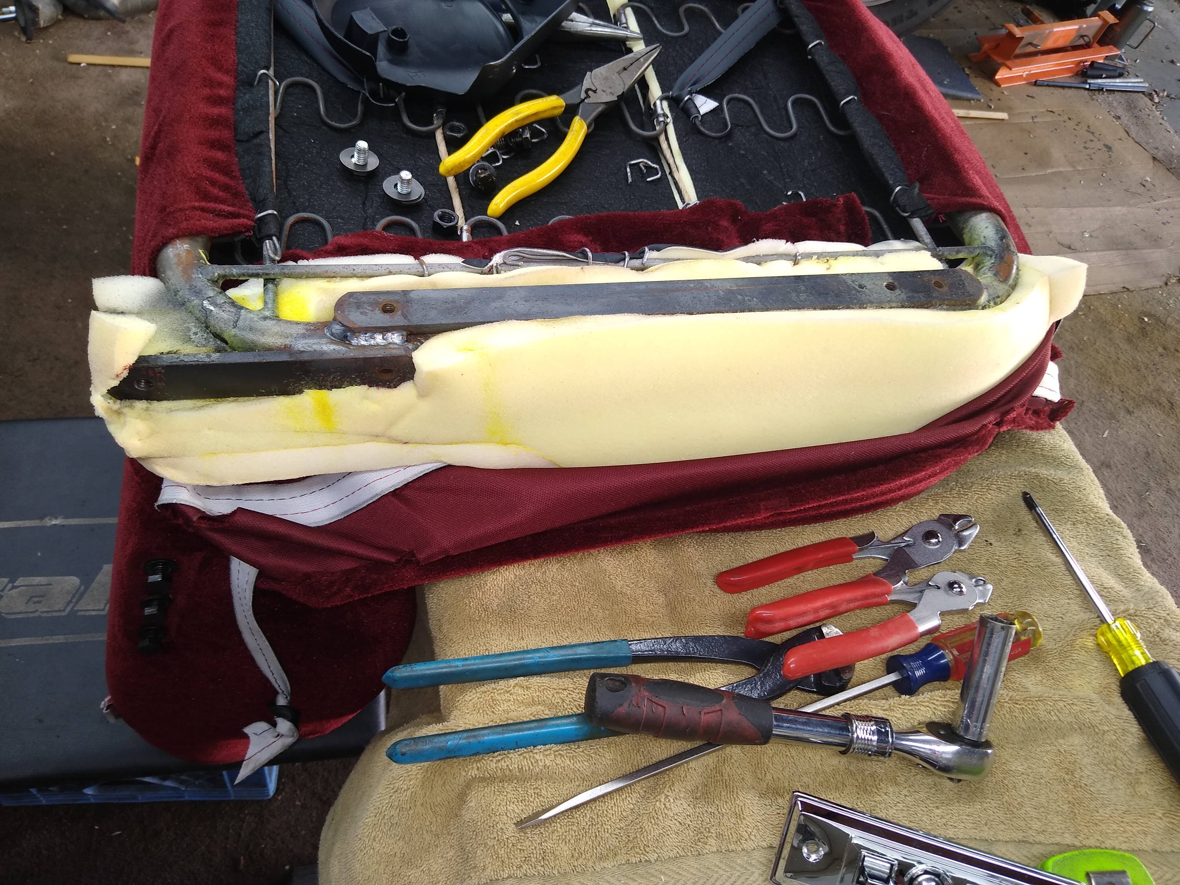

I knew I was going to make both seats power using the new units that came on my other seats so I had to disassemble the Cerullo's and make a plate to mount the control unit and then wire it , once that was done I had to make adapters to mount the seat to the tracks.

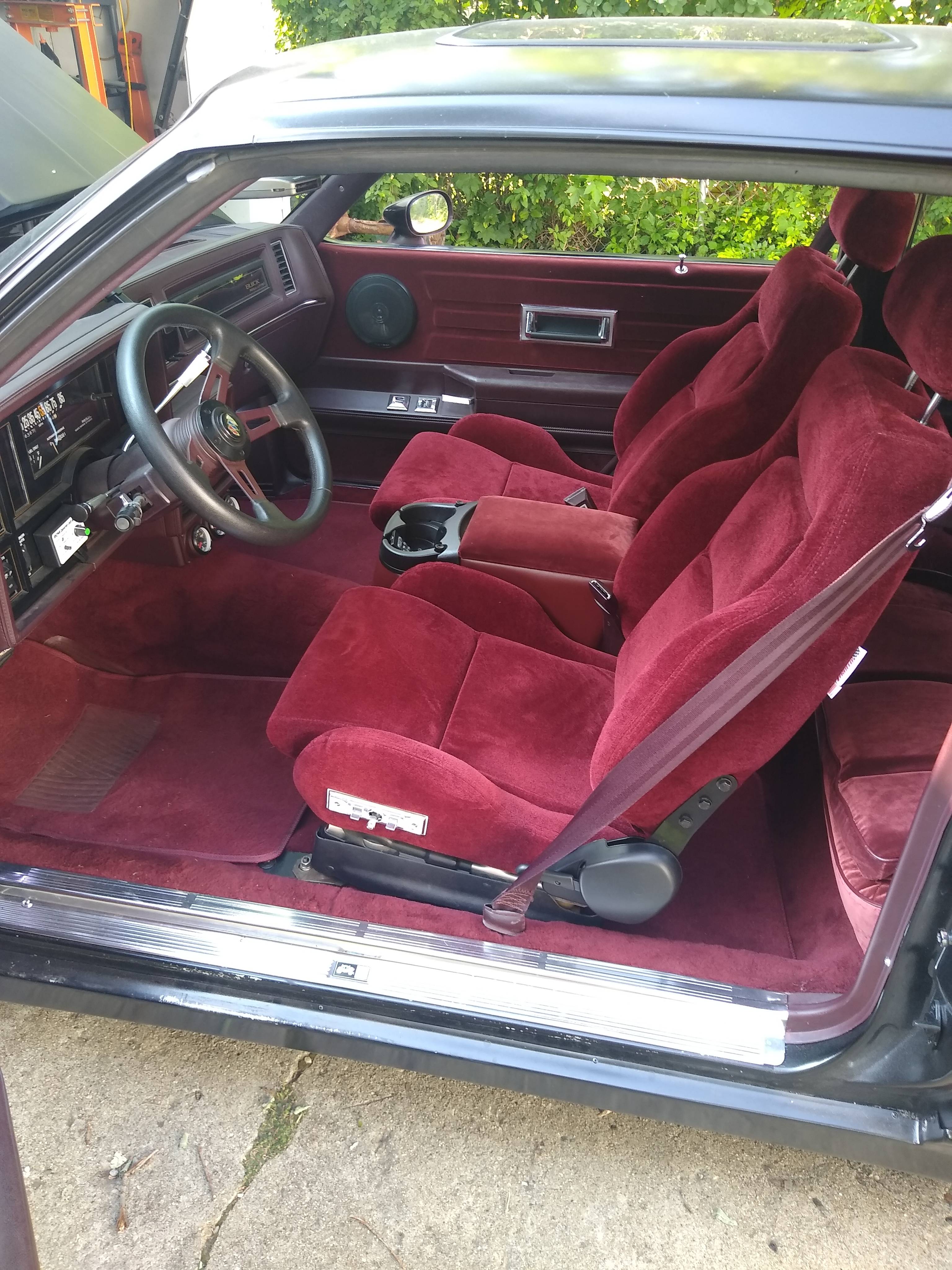

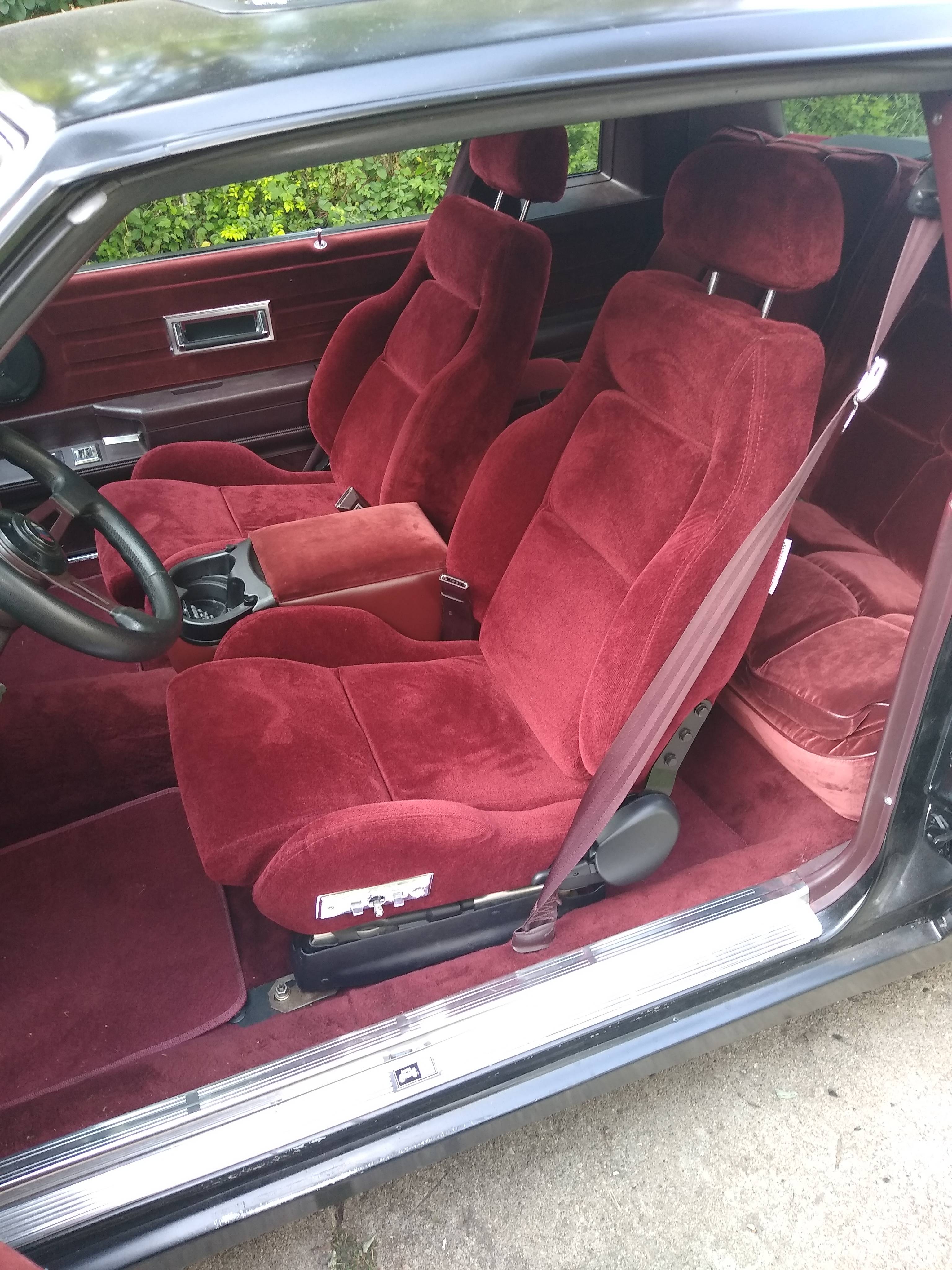

For now I put the cupholder/armrest I modified for my other seats in the middle until I get the center console modified to fit and install the floor shifter and floor mount steering column.
I also have new matching rear seat upholstery ordered so I will R & R the rear upholstery when that shows up.

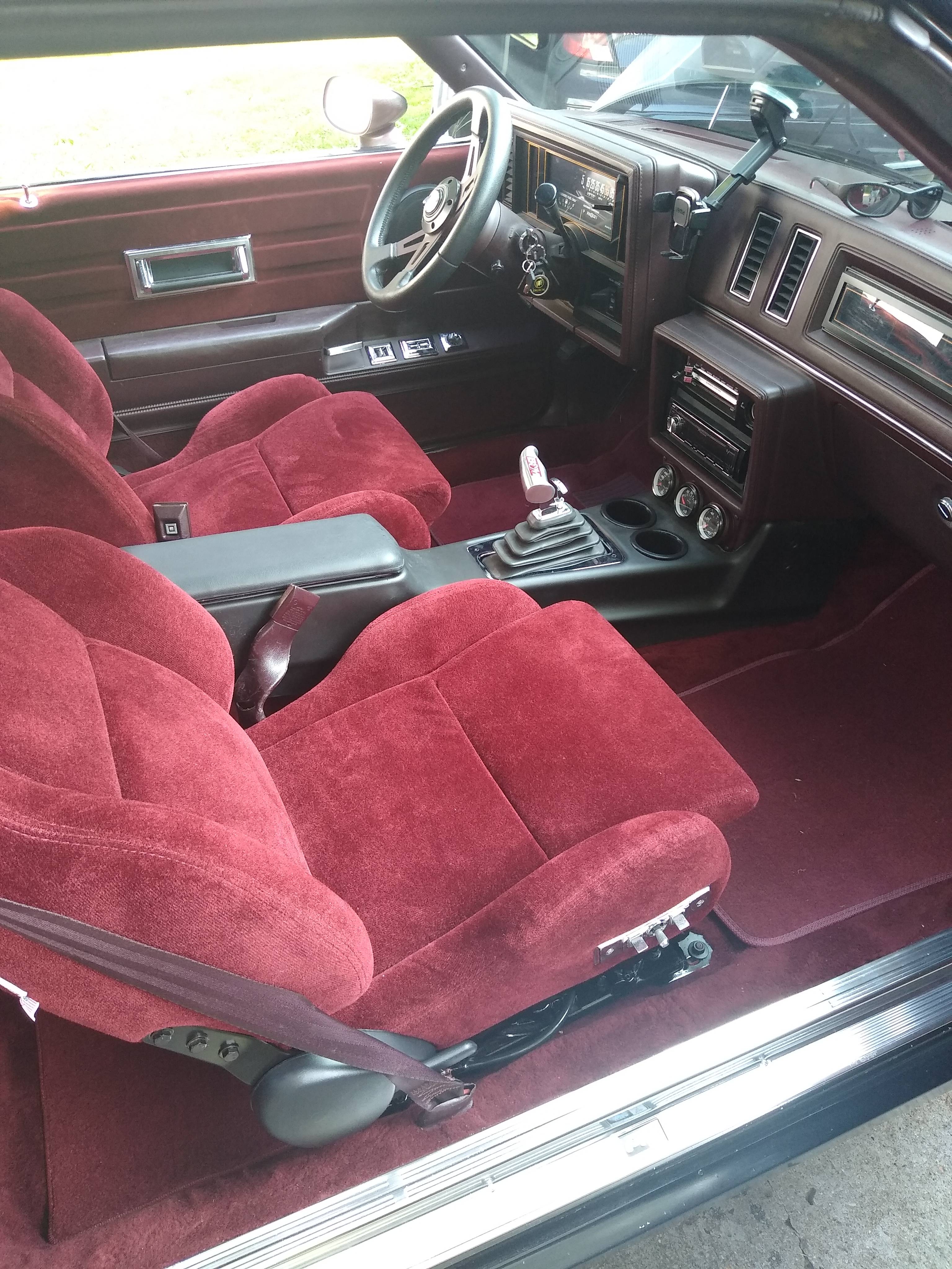

I should've found one of those consoles! I like the cupholders, but I've never seen one in a junkyard worth saving.So this evening was my first time driving the Regal since installing the new seats and even though they are firm they are even more comfortable than my pillowtops, but before I went out for a drive I wanted to get some mock ups done on the center console and shifter so I can paint the console.
View attachment 181961 View attachment 181962
The one in my Monte is very nice, I bought this one off Ebay a couple years ago for $60 but it took a bit of work to get it where it is now.I should've found one of those consoles! I like the cupholders, but I've never seen one in a junkyard worth saving.
Thanks, the console is a 2nd gen Fbody, the same set up I have in my MonteWhat is the console from?
And really nice - looks great.
