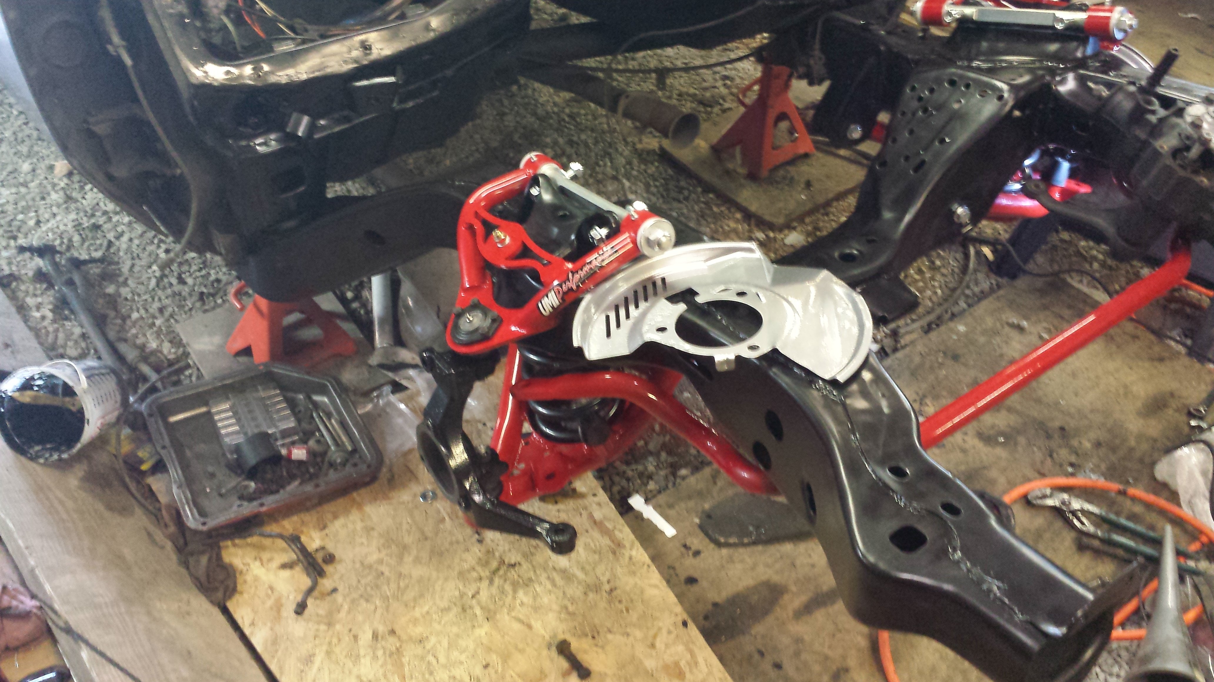

Ah yeah that was the setup i originally had on the car all the front suspension was UMI performance stuff with blazer spindles and backing plates. Really good stuff if you are looking for upgrading your suspension i highly recommend them.
