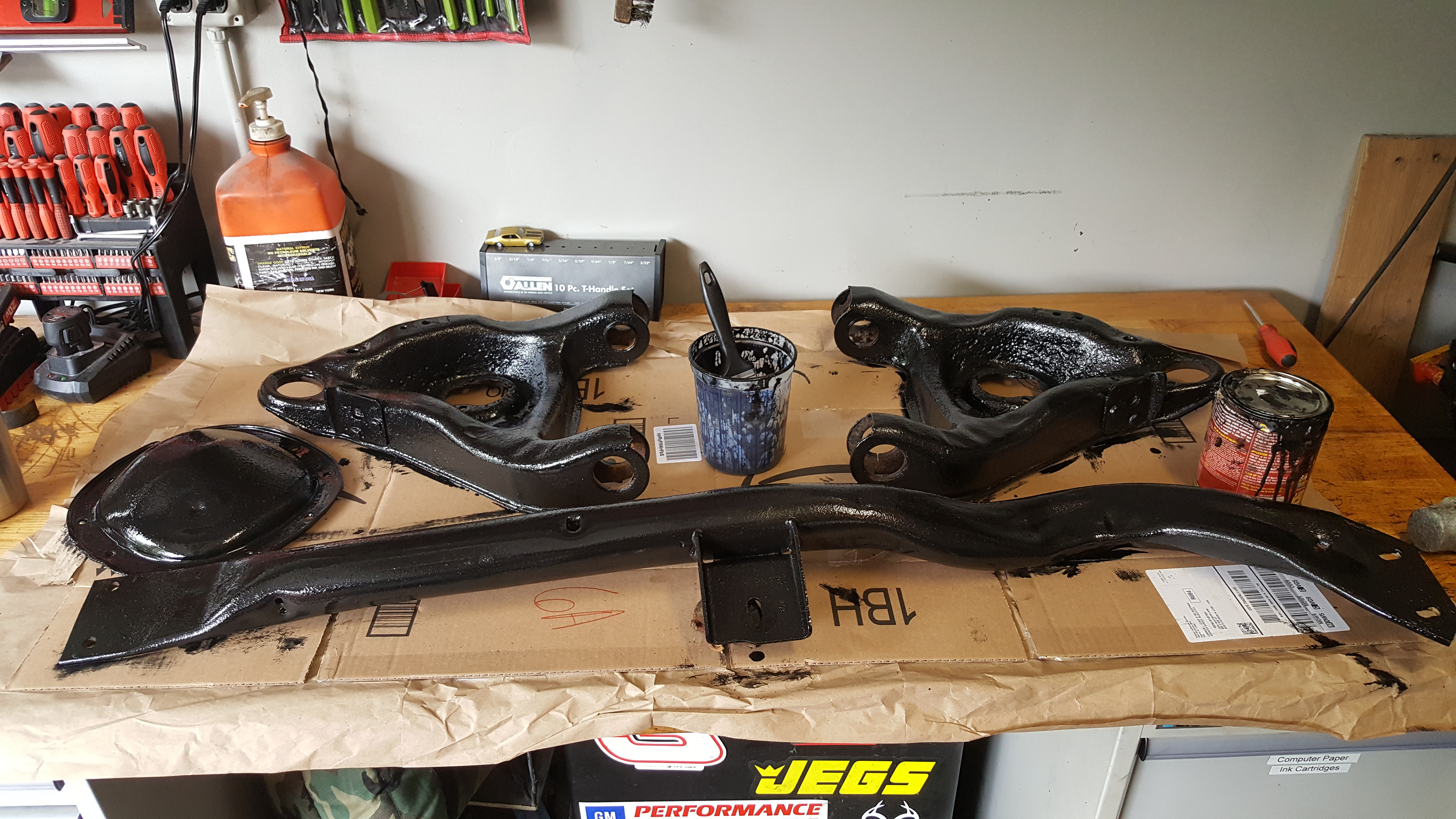

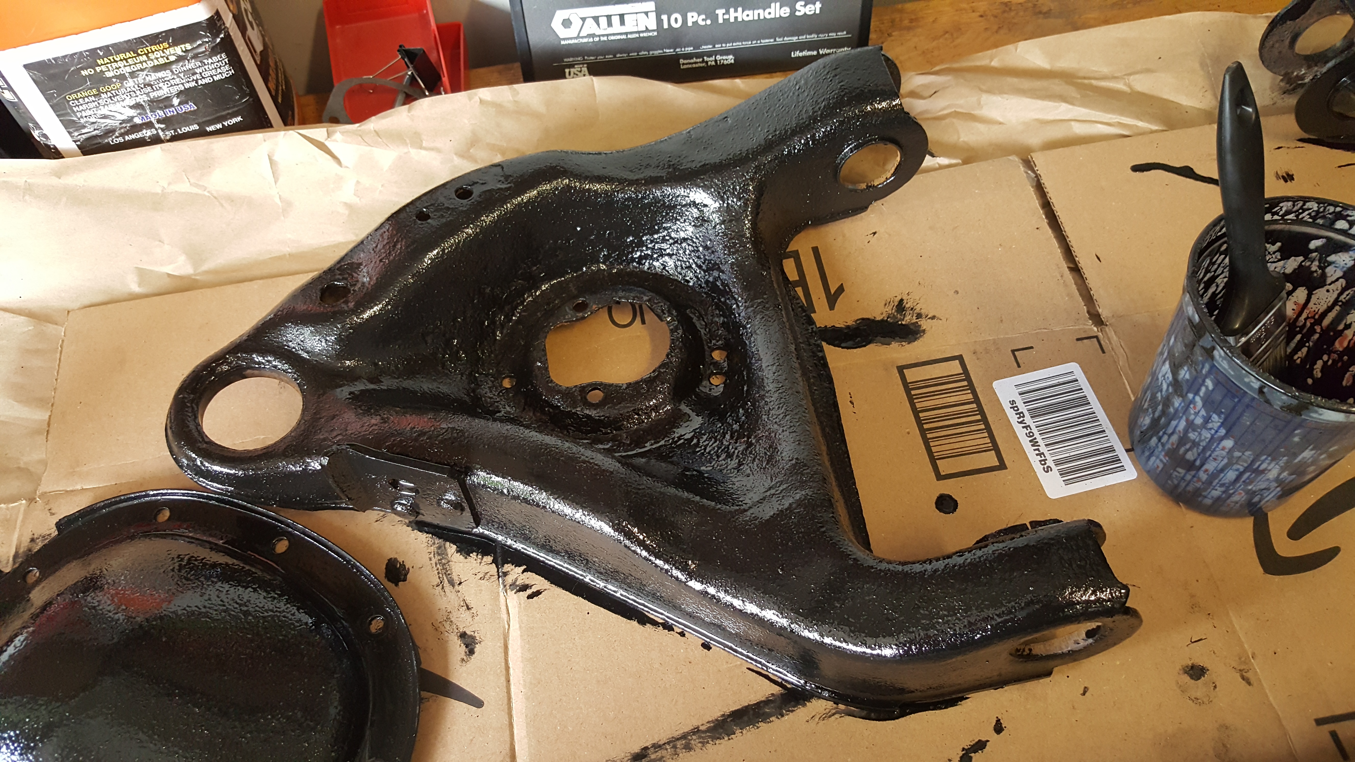

So now time for a coating of POR 15 to seal everything up and they aren't looking too bad. Even got the wife to help View attachment 122291 View attachment 122292 View attachment 122293 View attachment 122294
She's ( the MISSUS ) is A KEEPER !!!
