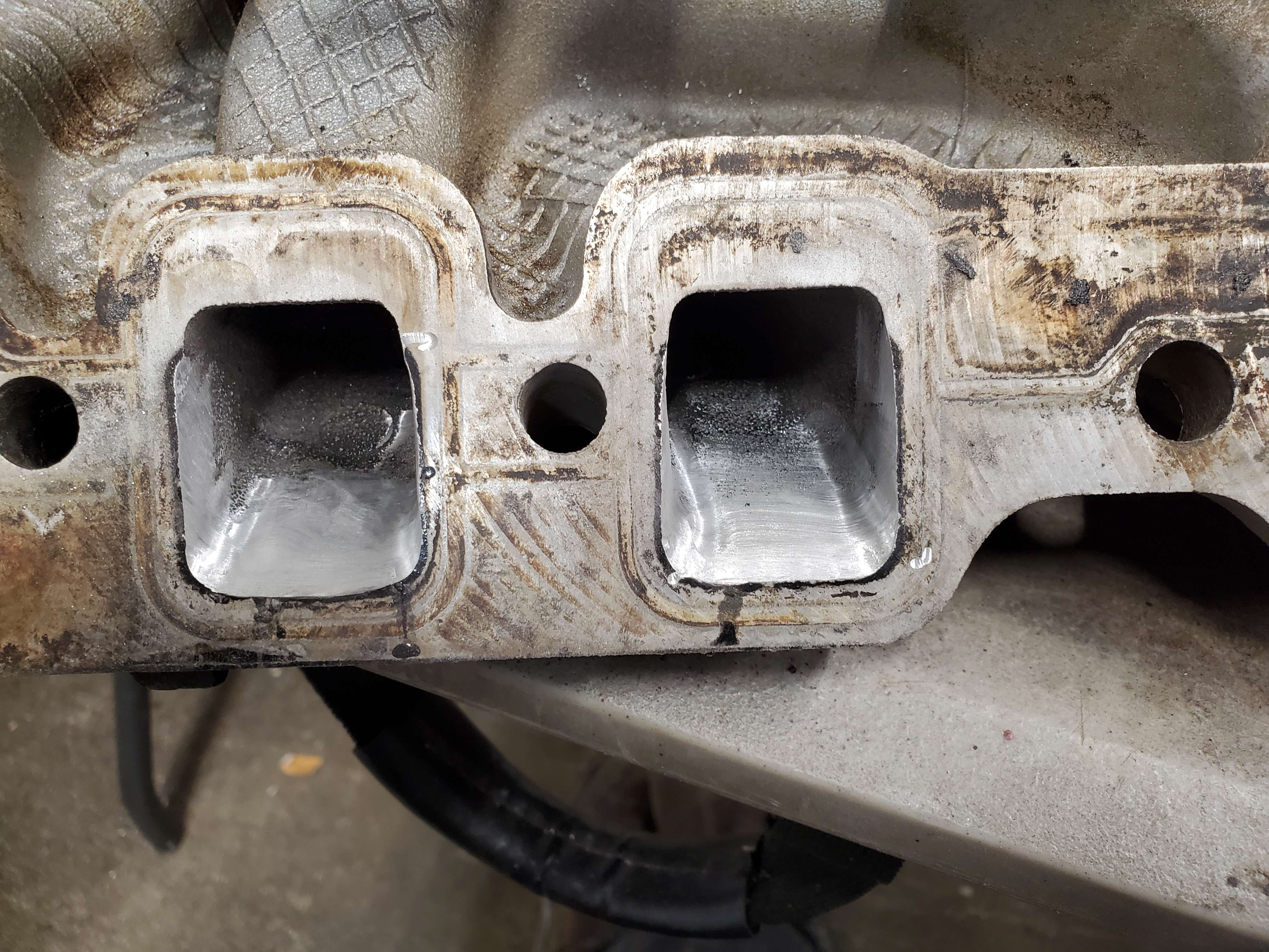

Okay so on to making a 307 intake fit a 260. So as everyone already knows the 260 only came with a 2 barrel carb and the only intakes that will fit are the stock one and the SP2P. Well not being able to find another SP2P I set out to make a A5 307 intake fit. So first I started out by painting on the intake the port difference.
You can see where the black paint is that the 260 port is quite a bit higher up than the 307 port. So a little port work and I had that area solved.

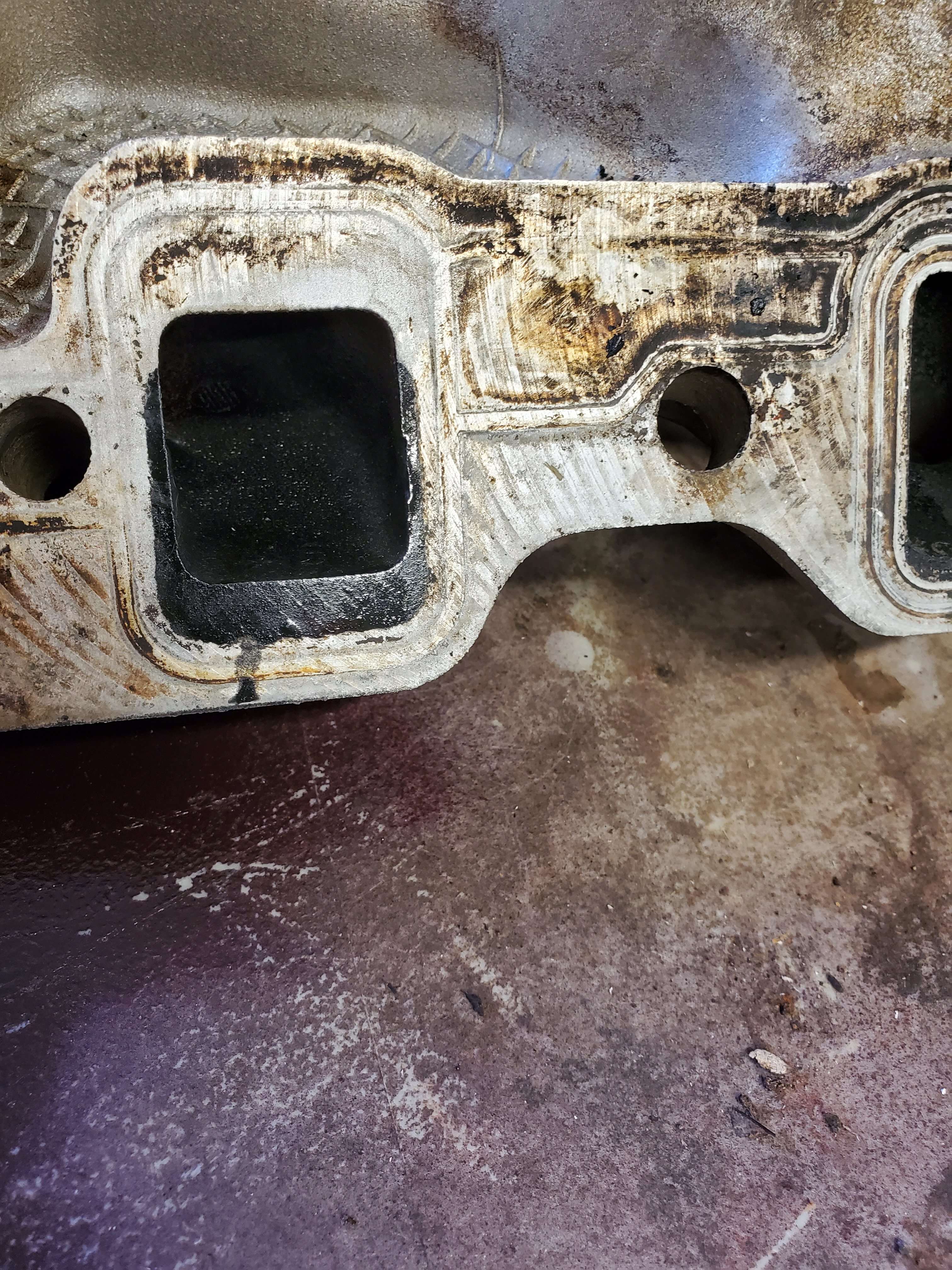

Now you can see that the port roof has been raised to match and the gasket now matches at the top.

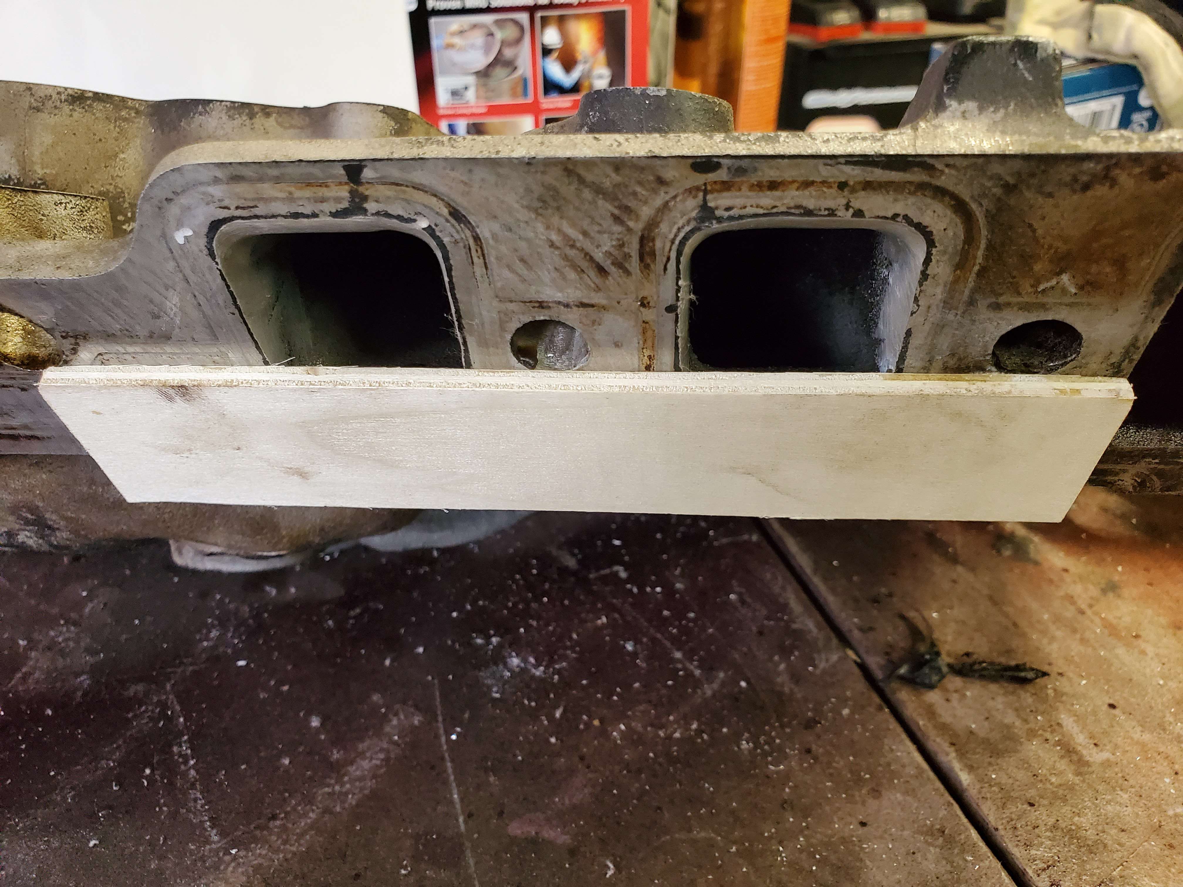

So now onto the fun part which is raising the bottom of the port. I got some wood straps and marked just above where I wanted the port floor to be and then glued the wood to the intake

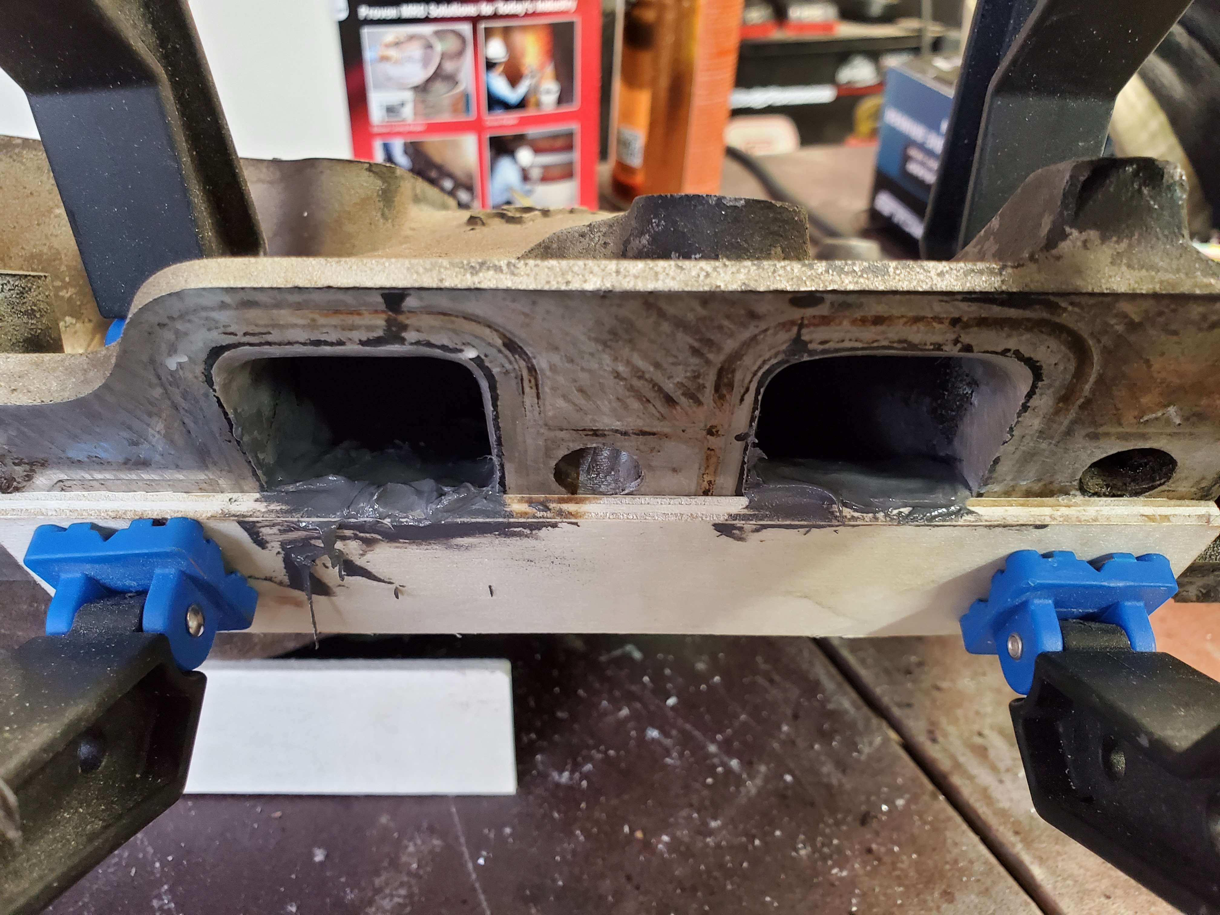

Next I added some Devcon epoxy and flowed it in to where I needed it

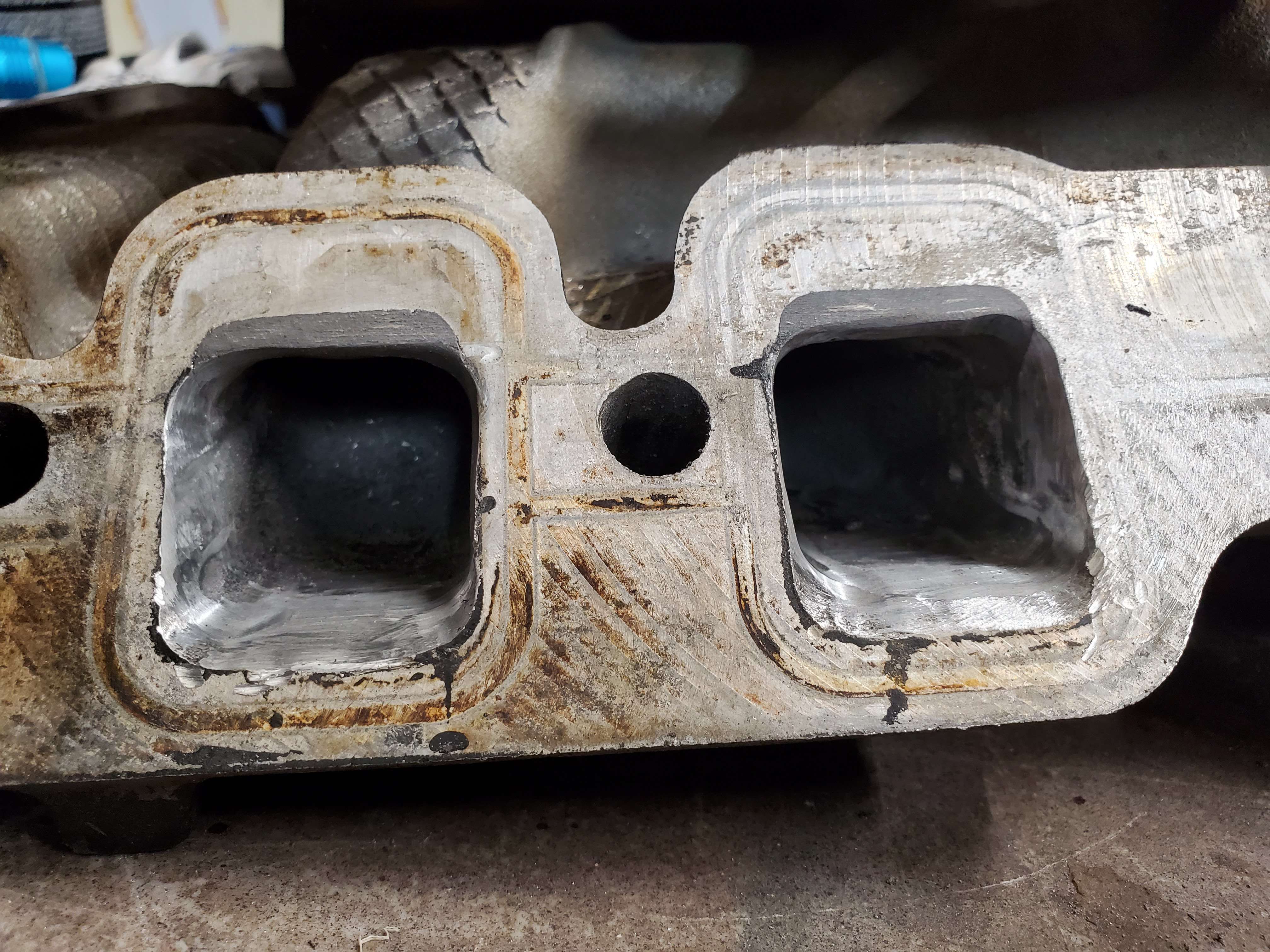

After all was said and done all I had left to do was more port work on the newly created epoxy floor and just like that the 307 intake now will fit a 260
Okay so on to making a 307 intake fit a 260. So as everyone already knows the 260 only came with a 2 barrel carb and the only intakes that will fit are the stock one and the SP2P. Well not being able to find another SP2P I set out to make a A5 307 intake fit. So first I started out by painting on the intake the port difference.View attachment 210266
You can see where the black paint is that the 260 port is quite a bit higher up than the 307 port. So a little port work and I had that area solved.View attachment 210267
Now you can see that the port roof has been raised to match and the gasket now matches at the top.View attachment 210268
So now onto the fun part which is raising the bottom of the port. I got some wood straps and marked just above where I wanted the port floor to be and then glued the wood to the intakeView attachment 210269
Next I added some Devcon epoxy and flowed it in to where I needed itView attachment 210270
After all was said and done all I had left to do was more port work on the newly created epoxy floor and just like that the 307 intake now will fit a 260View attachment 210271
I know one guy on Classic Olds just raised the port to match and left the bottom unfilled. I can see you want to keep max velocity out of the intake. I always thought the 260 raised port made more sense than the lower 307 port for performance🤣🤣🤣. Not sure what the logic was in dropping the port.
Reactions: MalibuDavyou5
Yeah i didnt want that big lip from the gasket on the transition from the intake to the head. That kind of port misalignment will cause fuel pooling and flow issues from the air/fuel mix hitting that lip and having to change directions.
