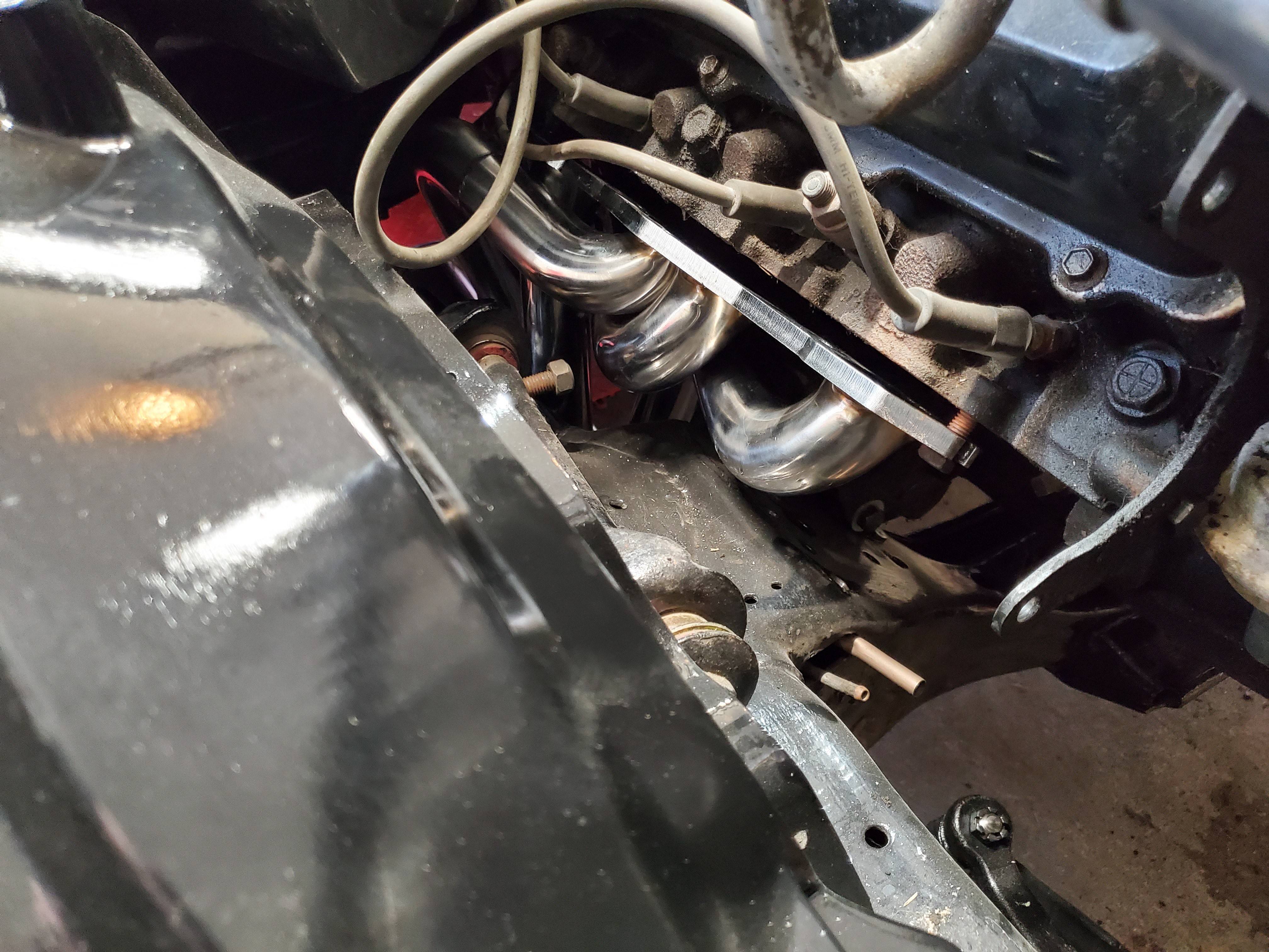

So yesterday got a little surprise for the old 260 that i dropped in this car. A set of shiny new headers! Took a gamble on these since they were listed for A body only but they seem to fit just fine. Had to take the oil filter adapter off the passenger side of the block but ive got them at least sitting in place until i get some new bolts in. Pretty happy about this because now i can run the engine longer than a couple seconds and can actually see how everything is going to do. So now with all of the cars I have around here as long as these hold up well ill be installing them in all my Olds powered cars. Keep in mind for all those who think im nuts there will be a 307 going in this spot after its rebuilt lol
So yesterday got a little surprise for the old 260 that i dropped in this car. A set of shiny new headers! Took a gamble on these since they were listed for A body only but they seem to fit just fine. Had to take the oil filter adapter off the passenger side of the block but ive got them at least sitting in place until i get some new bolts in. Pretty happy about this because now i can run the engine longer than a couple seconds and can actually see how everything is going to do. So now with all of the cars I have around here as long as these hold up well ill be installing them in all my Olds powered cars. Keep in mind for all those who think im nuts there will be a 307 going in this spot after its rebuilt lolView attachment 195502
Are those the $200 stainless Ebay headers? Everyone says there fit and finish is great for the money. I may pick up a set. How is the ground clearance? Those headers are actually a BBO A body header in Chinese Stainless Steel.
Yep they sure are, $194 delivered to my house. Fit and finish actually is surprisingly good to be honest, i was expecting complete crap. Ground clearance is actually really good. They tuck pretty tight to the floor and don't hang down super low like i've had a lot of headers do.
