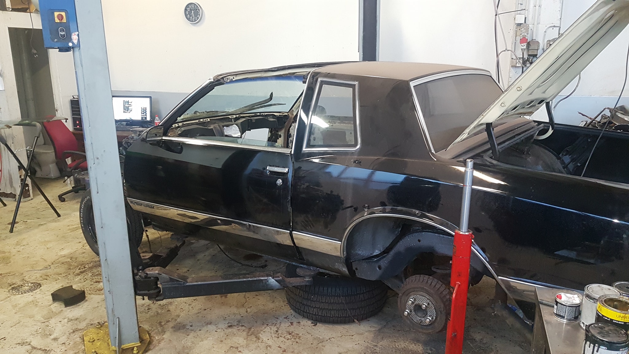

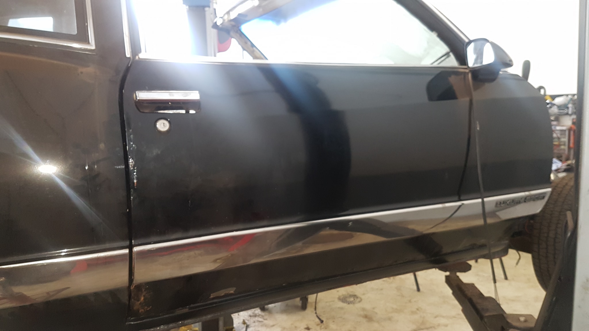

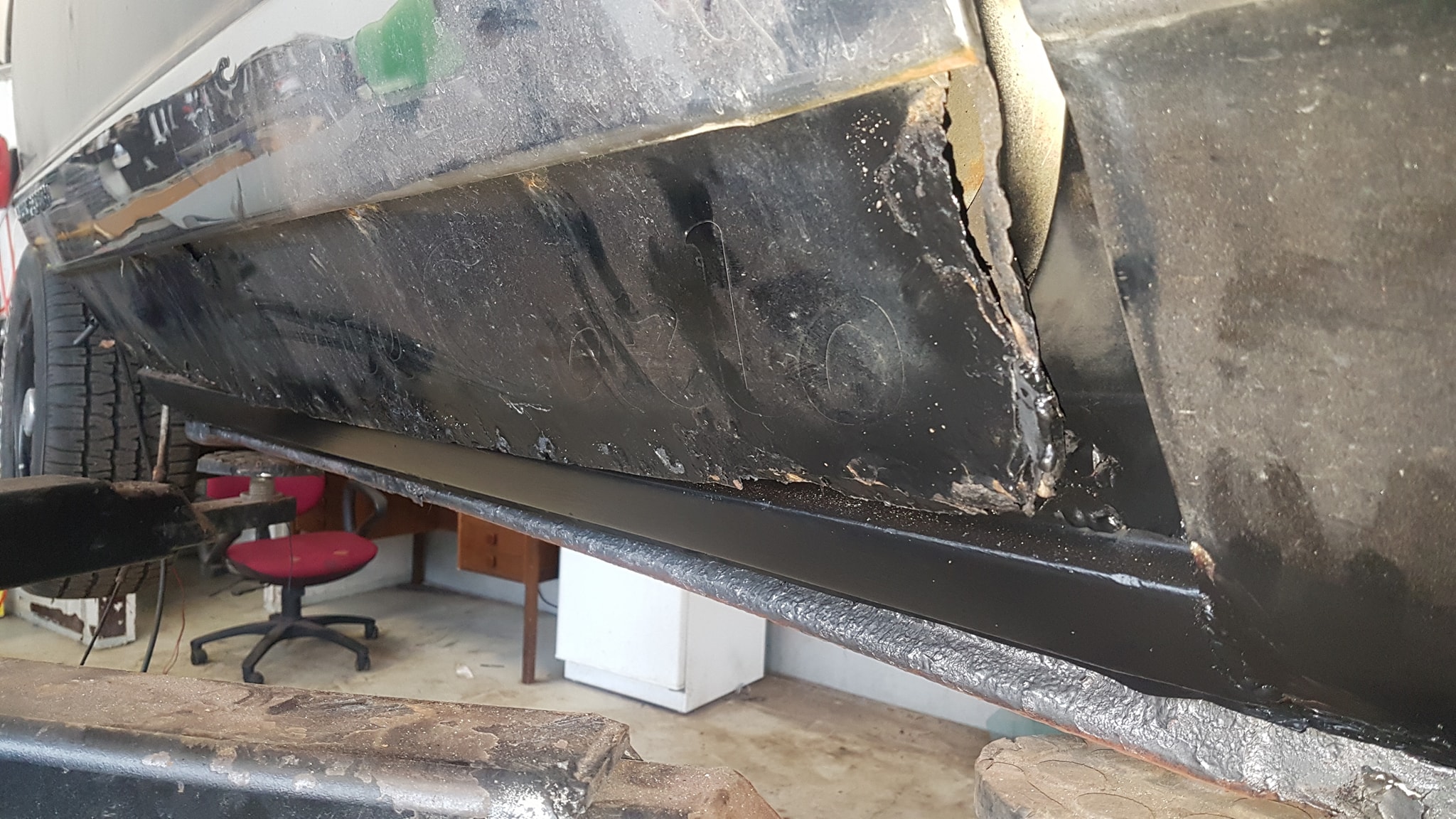

In other news, I test fitted the doors which I have, even though they are ruined, I had to try to mount them just to ease my mind... After all that cutting, and because there really was no point in reinforcing the body before taking out the rockers and welding new ones in... because there was no strenght there before I started cutting anyway... but everything fits flawlessly.. What a relief!
We got a door on, Winning !
But both of them are ruined 🙁 once upon a time I'm sure they looked great, cream yellow with the Chevrolet Monte Carlo in classy writing on there!

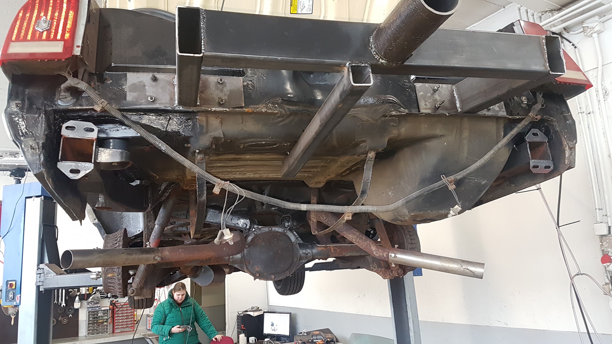

The body finally attached to the frame by all body mounts, rigidly and safe!
It's getting to be a car again!

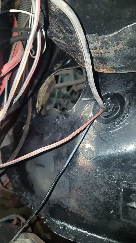

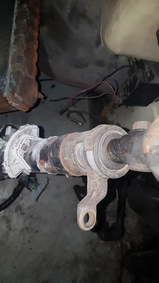

yea, but isn't there a rubber grommet aswell, that goes around the shaft to seal it through the firewall, I would imagine with only this one there would be a huge gap around the shaft
I don't understand. The column has a plate that attaches it to the firewall. That foam seal goes in between. There is a dust seal at the base of the steering column where the steering shaft exits it....
http://www.mikesmontes.com/Reproduction-Upgraded-Steering-Column-Bearing-Kit_p_1159.html
Ohh when I got up this morning something was bothering me in the back of the head so I went to the shop and started looking through the bag of goods where the previous owner had gathered his things belonging to the car, some of which he had taken off, and some of which he had bought new and not put in yet...
Such as the tools to fix the steering column, so I did that... But better yet, the piece that mounts the steering column to the firewall, which had been cut off, was there! in two pieces, but I was able to use it and mount it so that it's as good as new! Pheww!
52585255_10158321777802907_427623758786723840_o.jpg51773362_10158324372407907_2851334852584669184_o.jpg51735342_10158324374472907_695208768312442880_n.jpg
Here we have the piece, I'm so glad I dont have to go fabricating that part aswell, I was so happy to park the welder for a while! hehe but I had to bring it out for a few minutes to put this thing together, it was alright. The Gasket is torn but I'll just use some adhesive and glue on foam seal, should work perfect.52347501_10158324376677907_1175773634019459072_o.jpg
