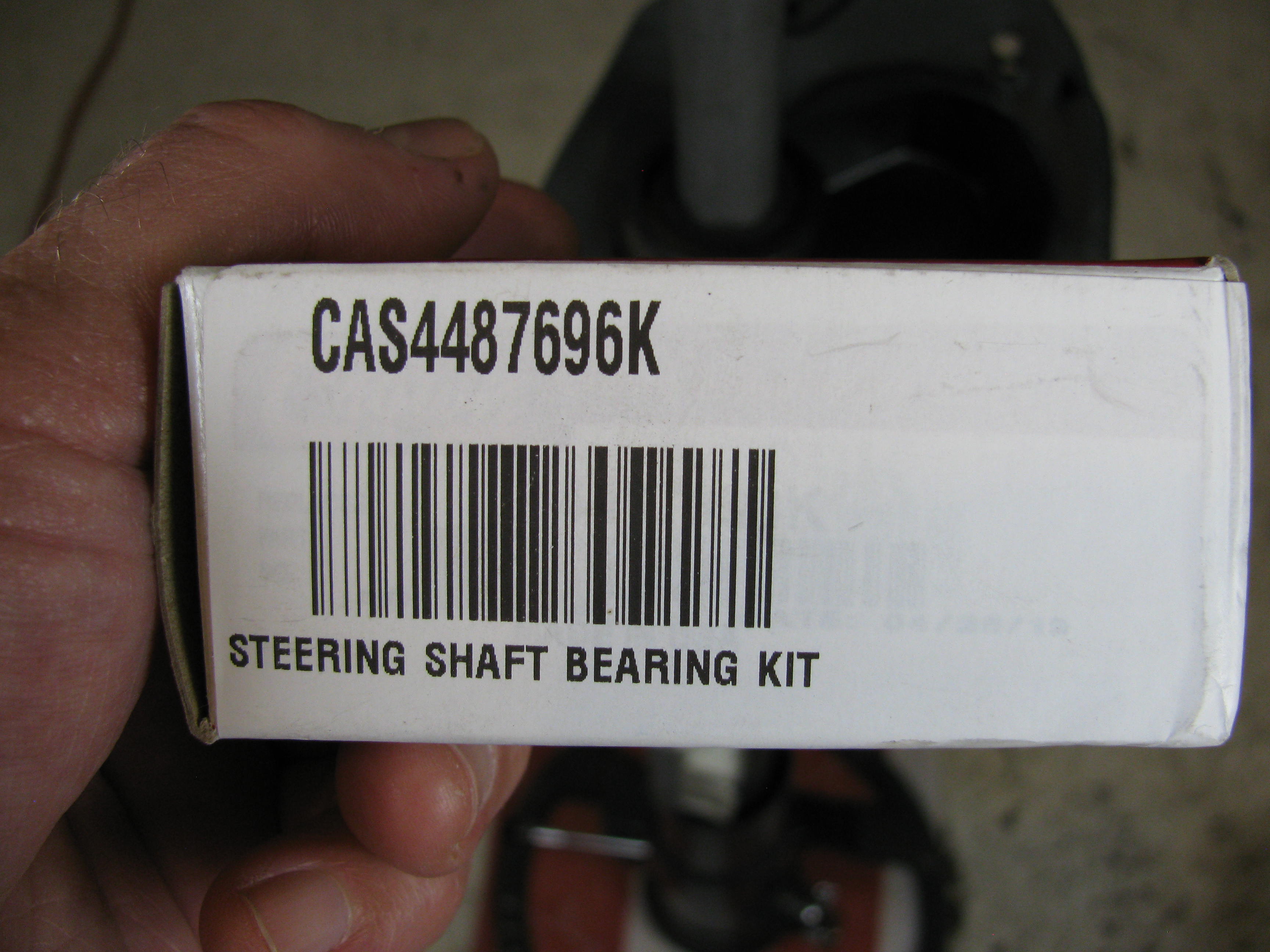

Can this be done with column still in car or is it necessary to remove ? Excellent illustration btwI installed the CJ / YJ Lower Bearing Upgrade.

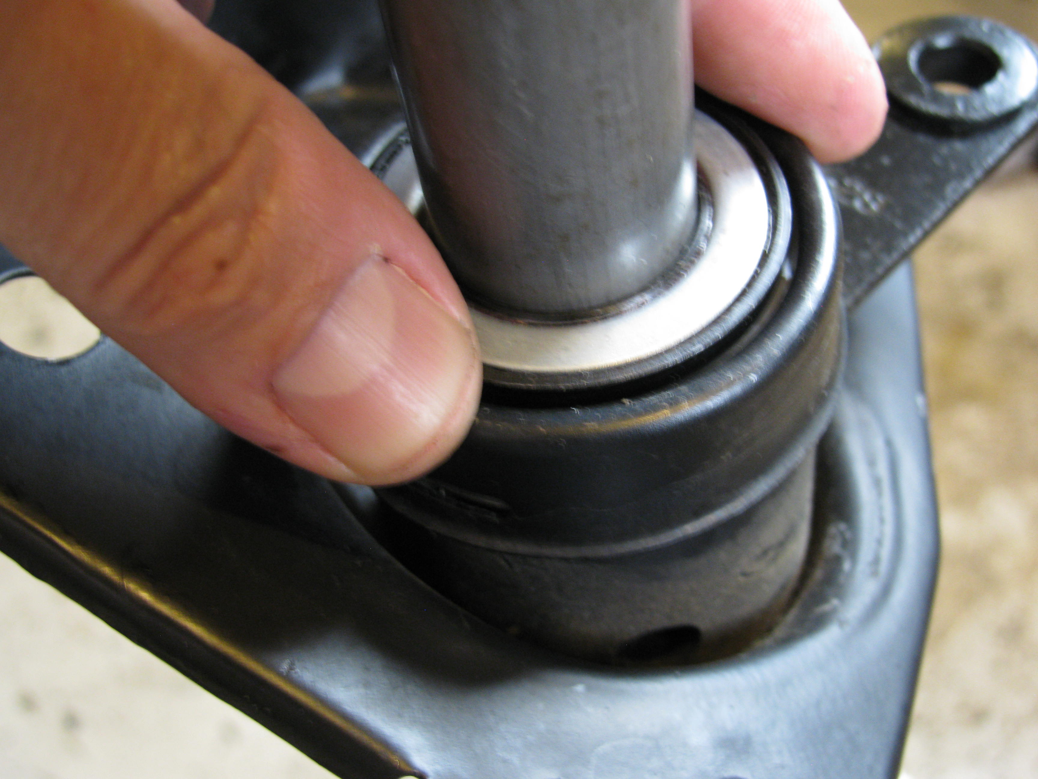

Thought I would do it since the column is out and easy to get to. I took the old rubber bushing "stocker" out.

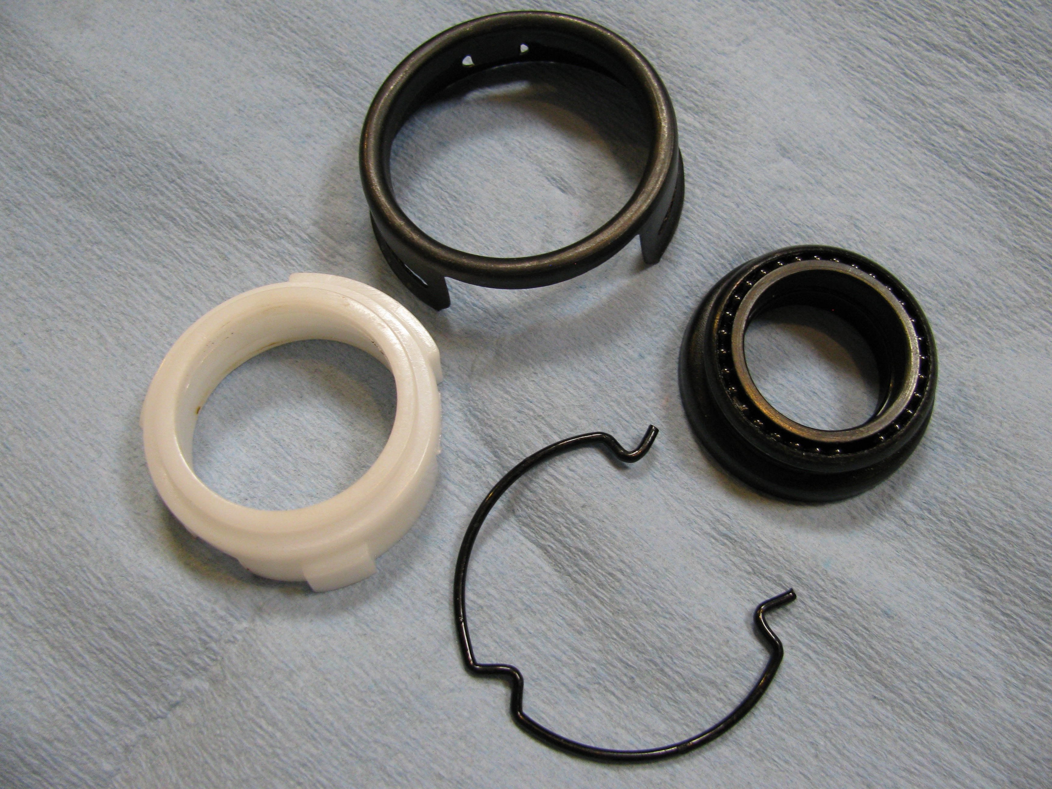

I break out the new Lower Bearing Kit

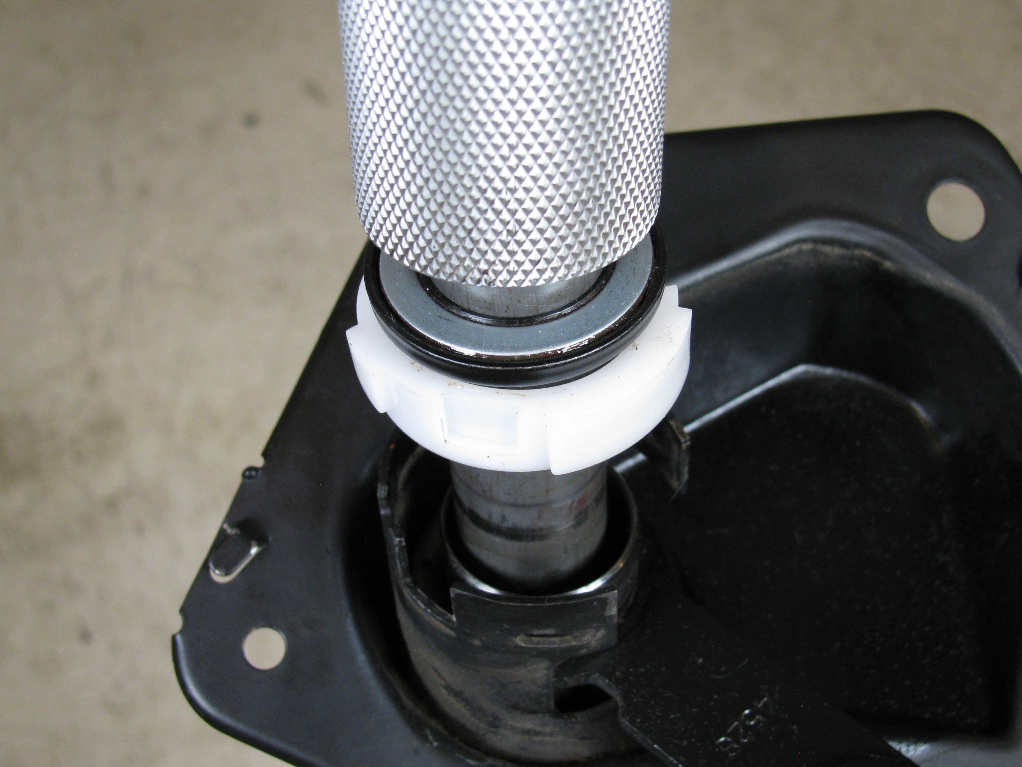

I packed grease into the bearing to help keep moisture and dirt from getting in as well as to lubricate. Then I just snap it into the plastic carrier and install. There's an O-Ring on the inside center of the bearing so I cleaned and lightly oiled the shaft so it would slide on (grow up). My jack handle worked well to tap it down.

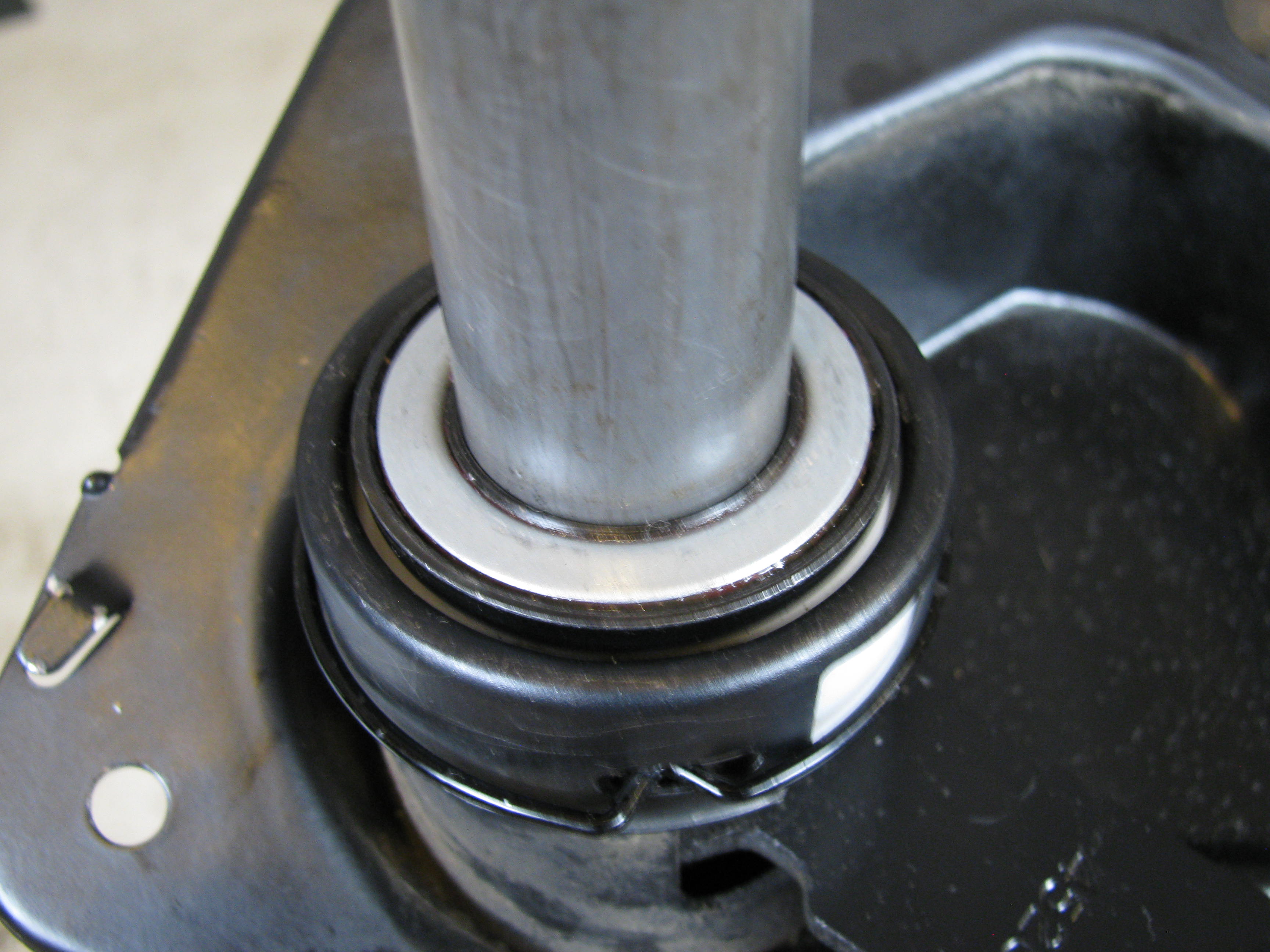

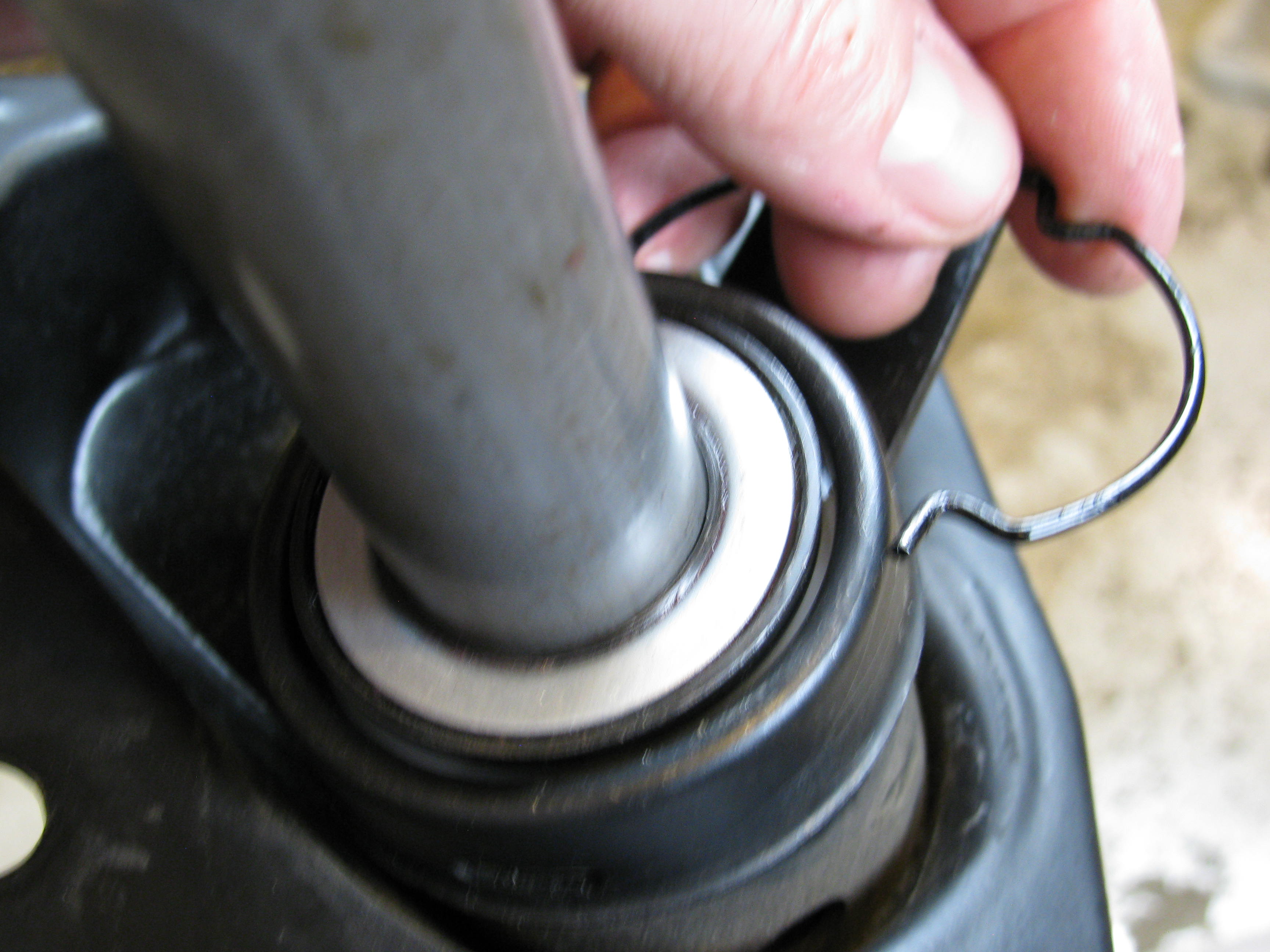

Once it's seated I just add the collar and the retention clip and I'm done.

You would have to remove the intermediate shaftCan this be done with column still in car or is it necessary to remove ? Excellent illustration btw
