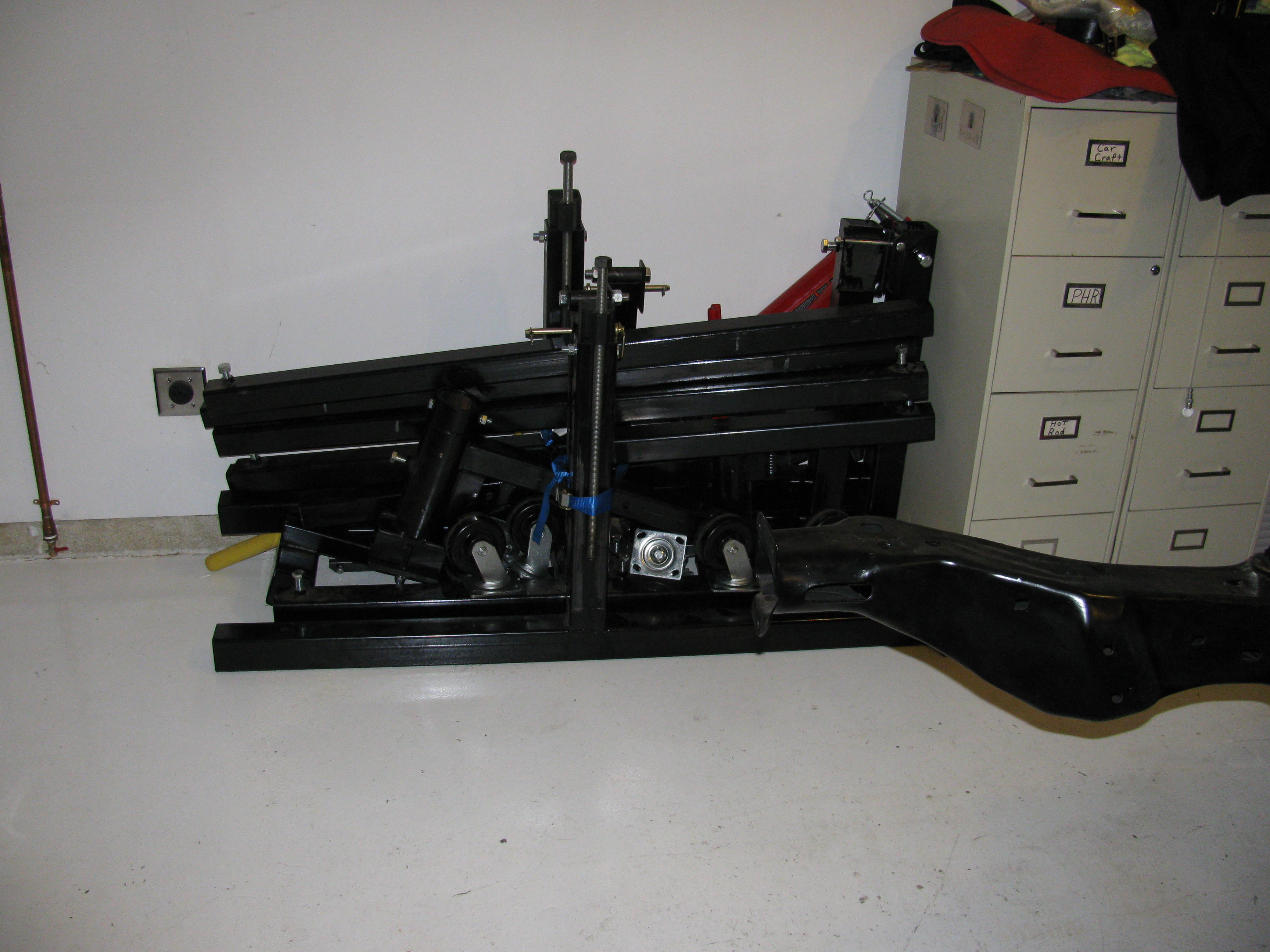

Sooo..my weekend was interrupted by family time (good prob to have). Here's a quick pic I took of the Accessible Systems Rotisserie all broken down.

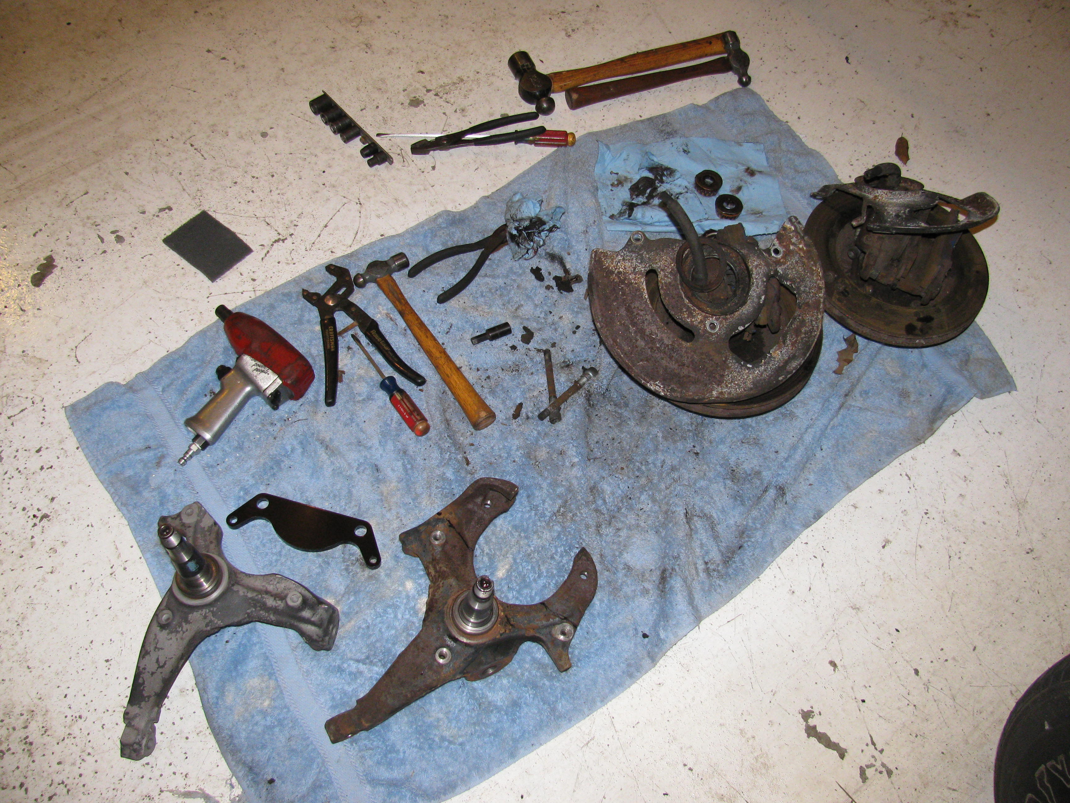

I did get a chance to take apart my spindles that have been sitting in a bag with calipers and rotors still on them.

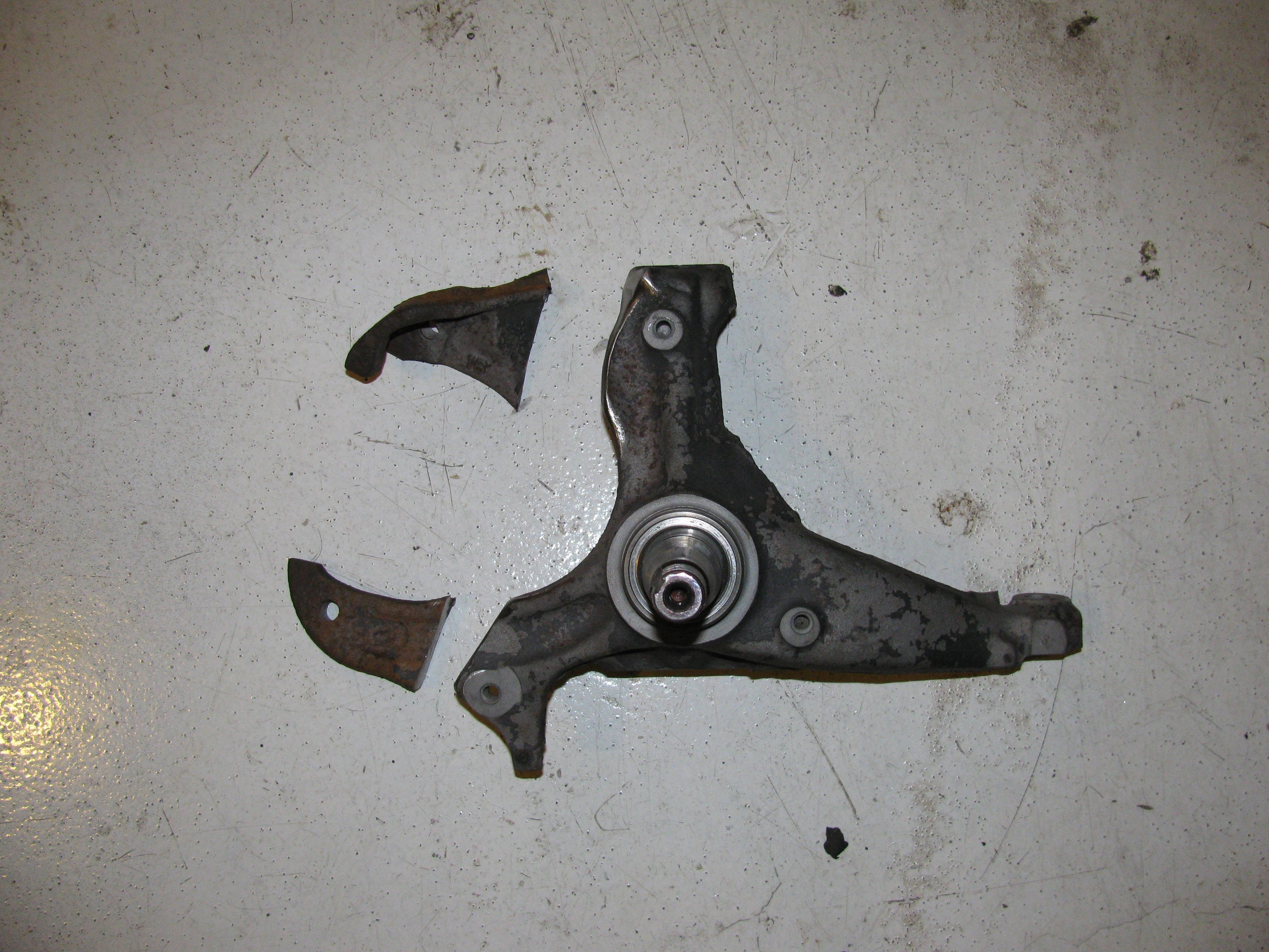

I cleaned them up and then took my cutting wheel to them.
I did this...
To get rid of this...
So I can put on that...
Huge difference!
