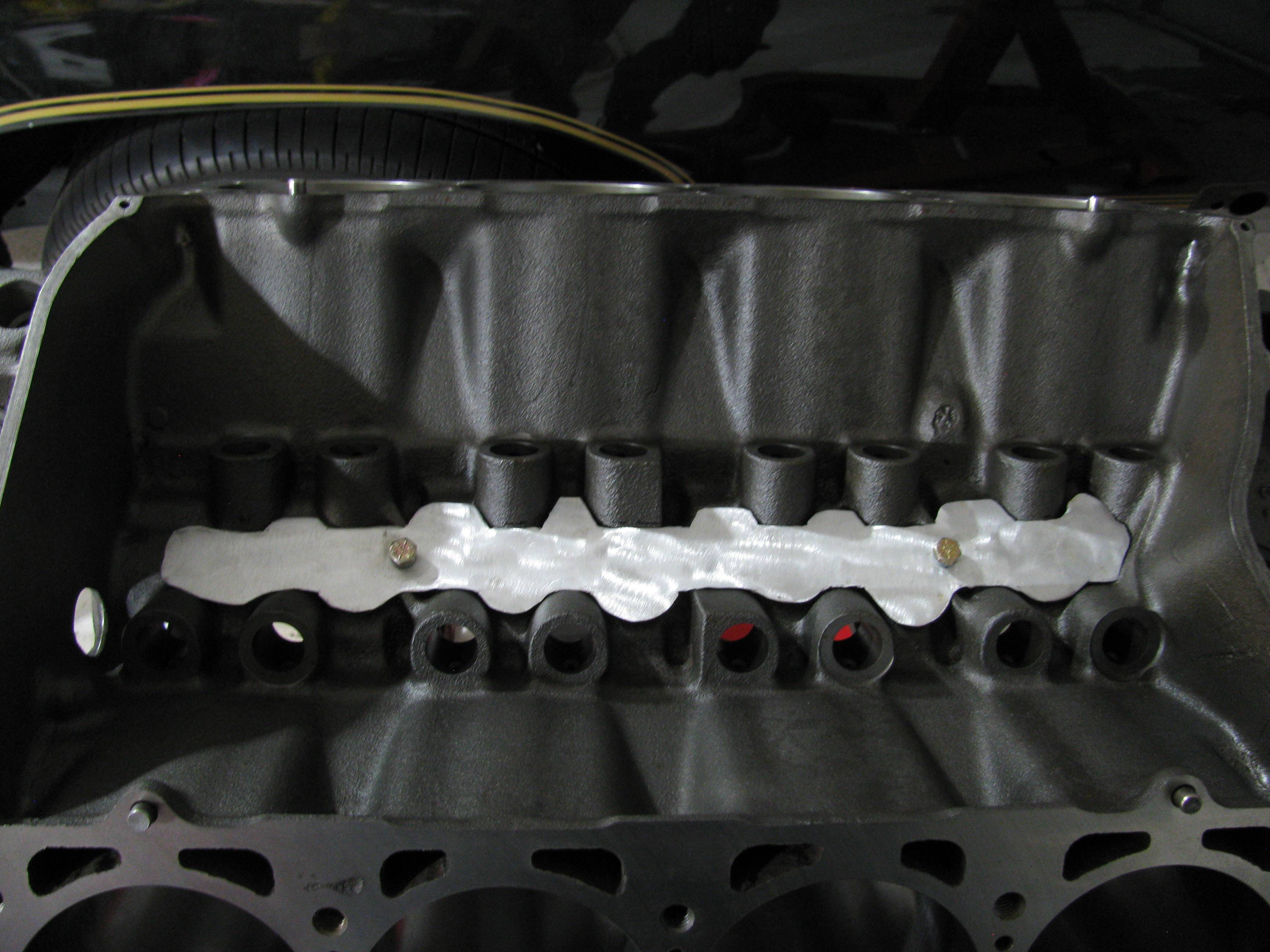

Excellent job 👏 👍Here's something I did right off the bat. The Lifter Valley Oil Baffle was MIA when I bought it. I found one on ebay, and the guy wanted $150.
No thanks!

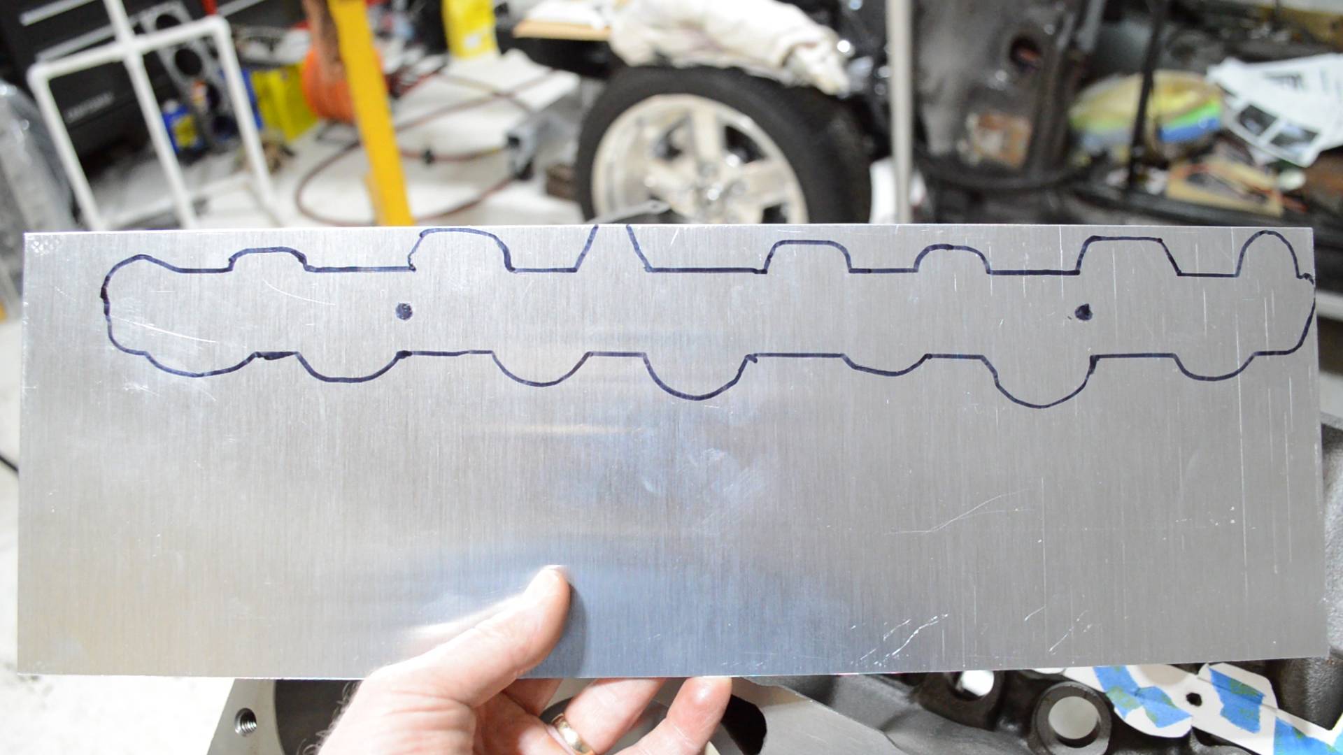

So I just made my own with a sheet of aluminum and some paper to make a template.
After crafting a working template I just trace it on the sheet.
2 Grade 8 bolts, a sheet of aluminum and about 40 minutes of my time and done. Prob cost me $6.00.
