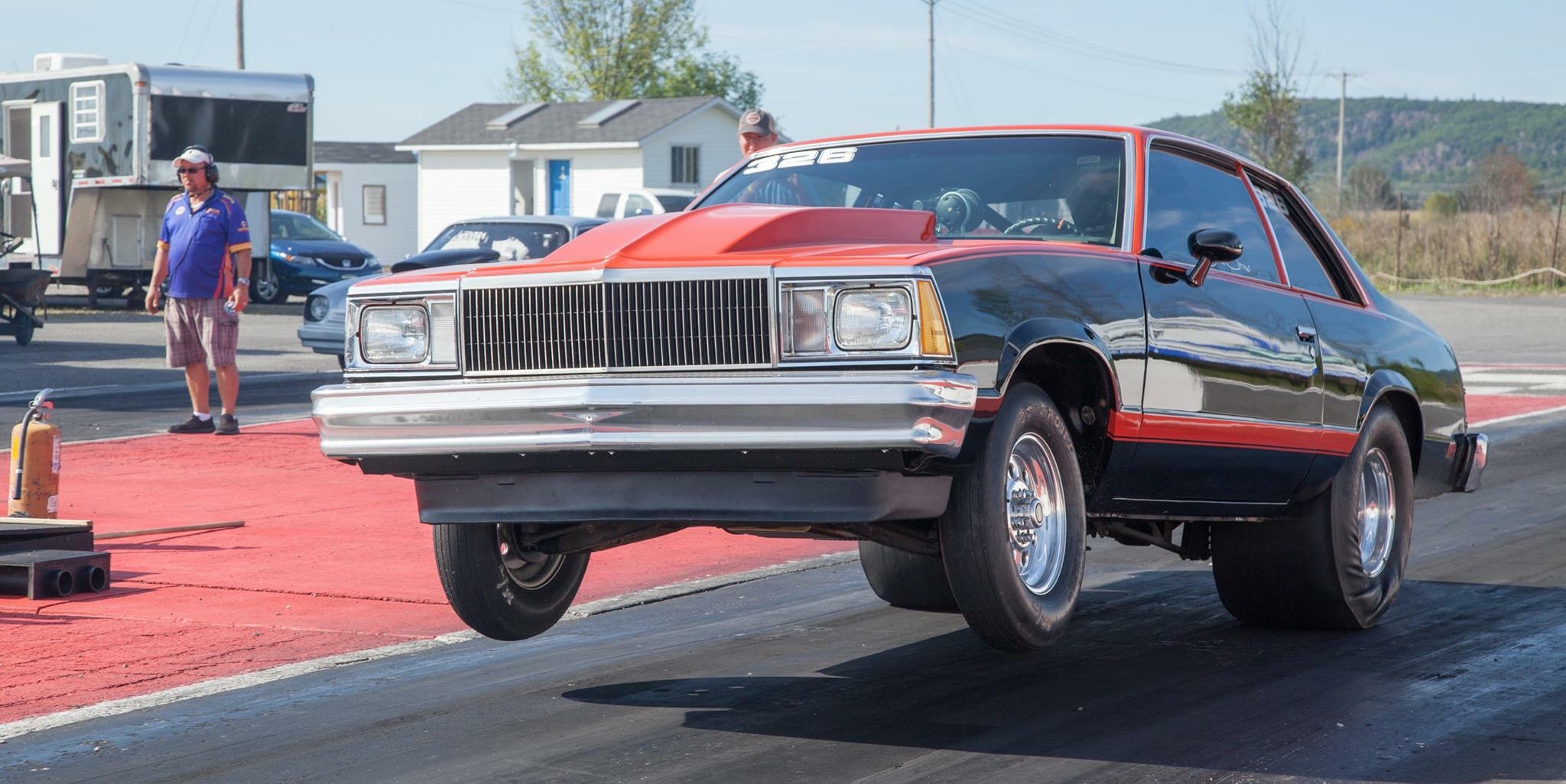

REAL 600HP is LOTS on the Street. The SBC in my Malibu I'm guessing (not dynoed) is around 575hp. And it ran 6.65 in the 1/8th this weekend, that's 10.30-40's in the 1/4. All steel but the hood. 3250lbs with the driver.
The motor isn't anything crazy but not really streetable either...383, 200cc cast iron Dart heads, 680 roller cam, 12.5:1 compression, Victor Jr Intake, Rupert 850cfm Alcohol Carb
Not to mention the big *ss tires.😎
You're probably pretty close on your guess. We did a 383 about 20 years ago that DID dyno at 575 hp and in a 68 Chevelle that weighed 3170 w/driver it went 10.40's.
